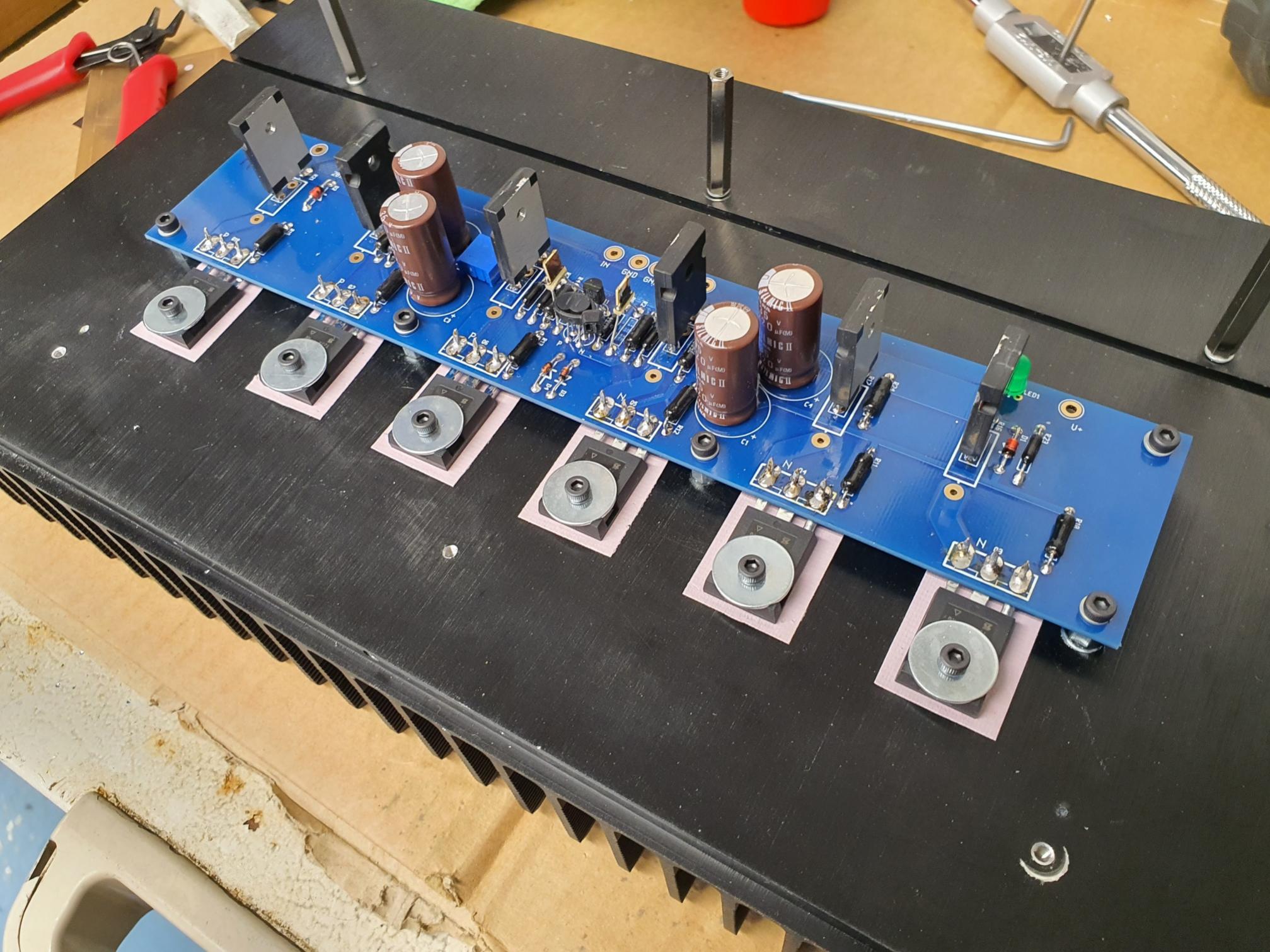

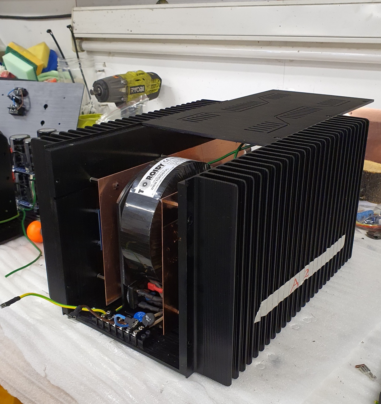

The case is takachi's HY177-33-33SS.
This heatsink is a bit smaller for F4 so I reduced the bias a bit.

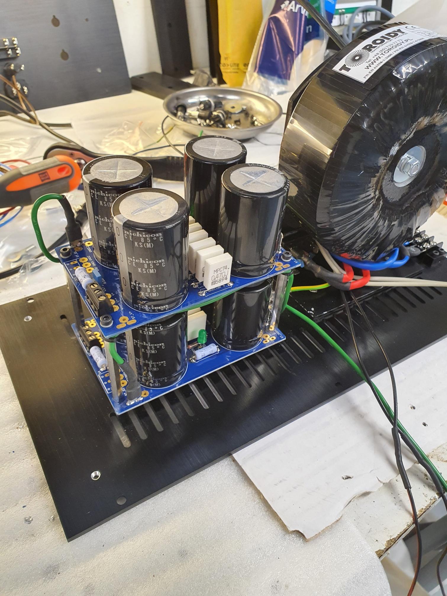

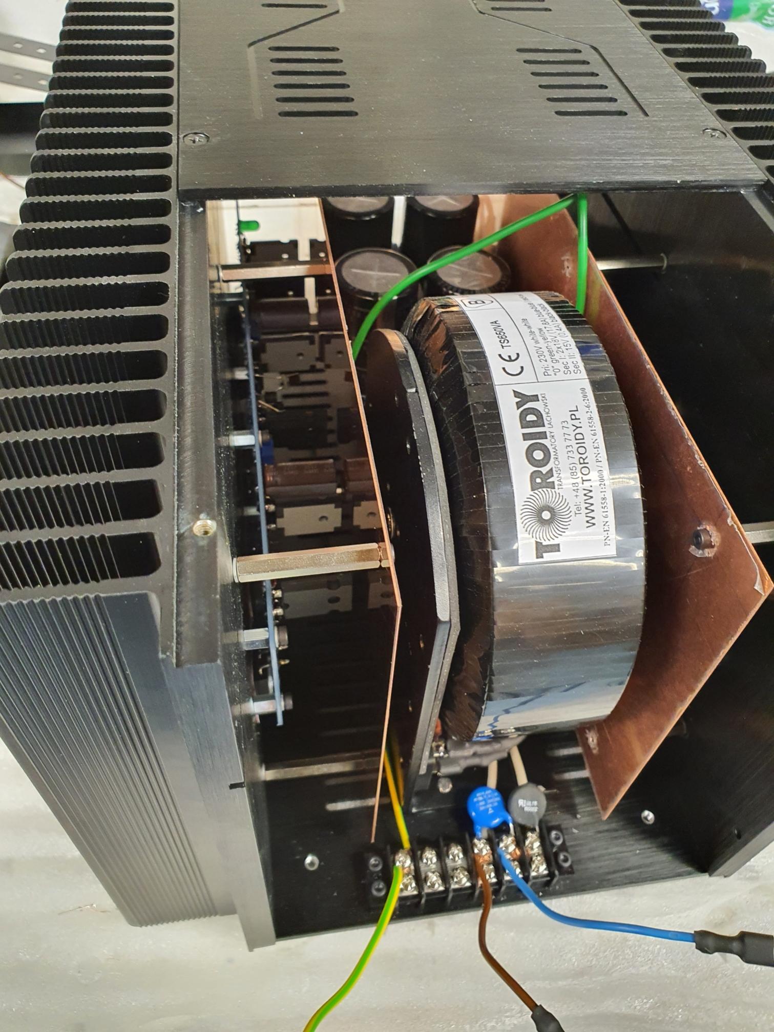

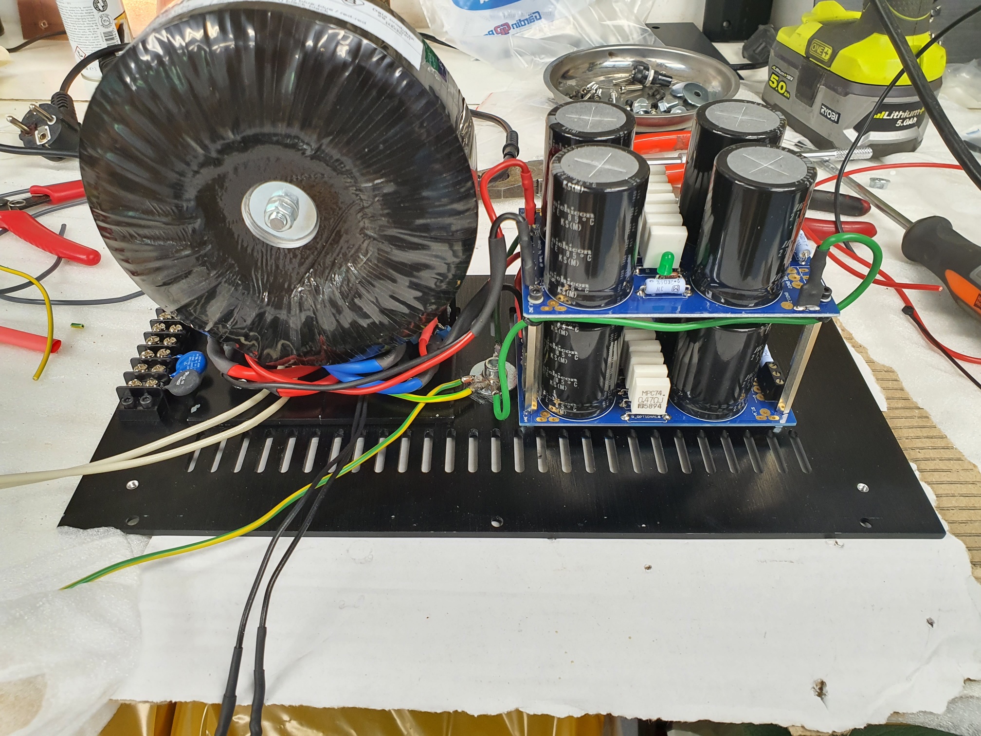

The R-core transformer was custom made by Phoenix Corporation. They are popular for DIYer in Japan because they accept custom orders for amateurs.
However, they do not seem to accept small lot orders from overseas.
It would be nice if the Store handles it.

Fantastic build Norrlands Guld!
Really well thought layout!
Looks like you have nice big heatsinks, maybe 5u height and 35 cm length?
Re. Previous distortion discussion, you can always crank up the bias to decrease the distortion if you wish: 650 va transformer has a big headroom!
