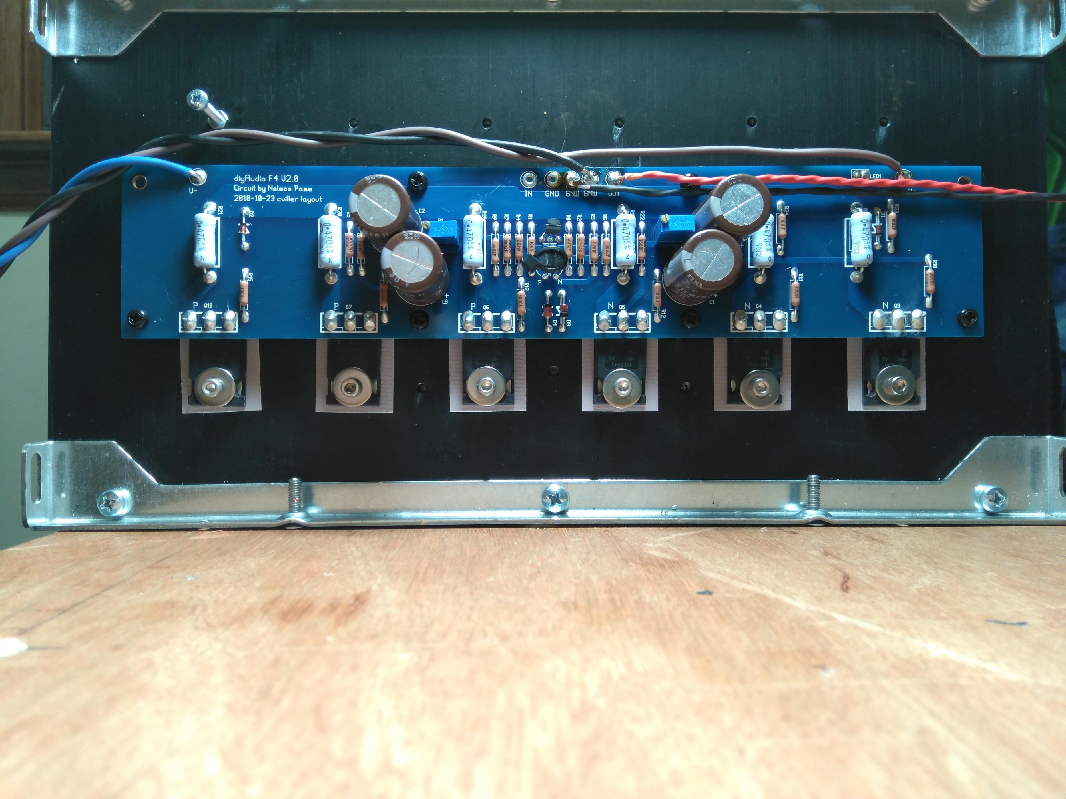

Change R8 from 22.1K to 27.4K should give you more room for biasing.
Where (which source resistor) are you measuring the 90mV? My guess is that the
mosfets on one polarity are on and those on the other are still off.
Hi Dennis. Thank you for the quick reply.
I checked on a few source resistors, I didn't note if p or n.
Why would one polarity be off?
I had exactly the same bias until I changed R8. Now I can crank it to beyond 400mV 😀, which is of course not necessary. Papa states in the service manual that the target bias is 200mV (cold @130mV). I run mine at 300mV, where it’s very smooth, warm, and open sounding after 1 hour of operation.

Dennis and Greg. Many thanks for the pointers. I will change the resistors today.
