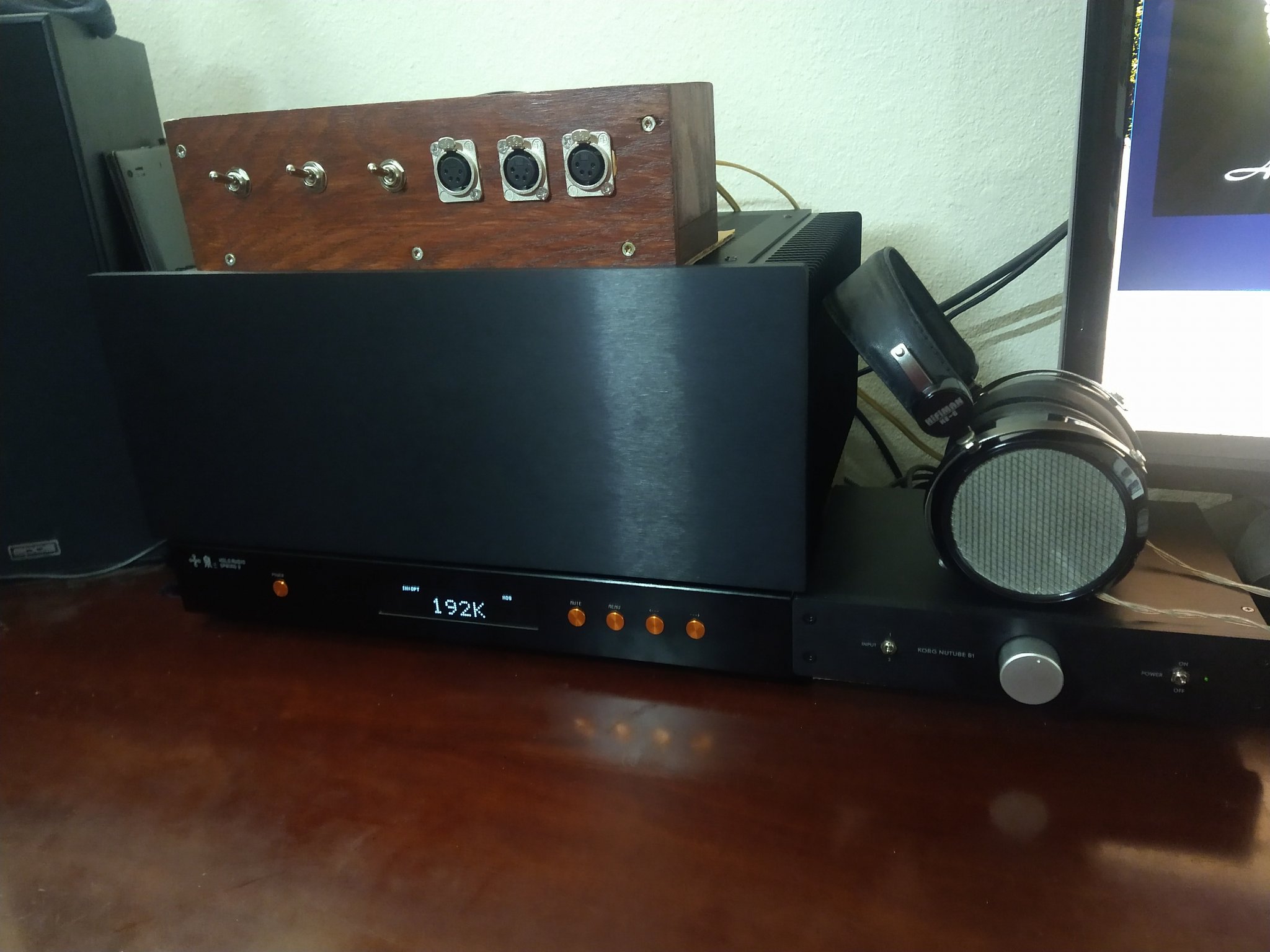

What is that wooden box?

It sounds fantastic, noticeably better than the dual mono ACAs I was using previously, and better than the vintage receivers previous to that. My dac, a Holo Spring 3, outputs 2.9v for the single ended, maybe thats just enough to be useable with the B1K. If i plug my phone into the B1k, it is definitely not loud enough, but digital sources are ok. I'll probably build a BA3 pre to replace the B1k, sometime.
My headphones are actually harder to drive than my speakers, and with some quieter tracks, I have to turn the B1k up to almost full volume.
The wooden box is a speaker/headphone switch. I can toggle between speaker outputs and headphone outputs, and the multiple xlr jacks are for different attenuation, so I can plug easier to drive headphones in as well.
