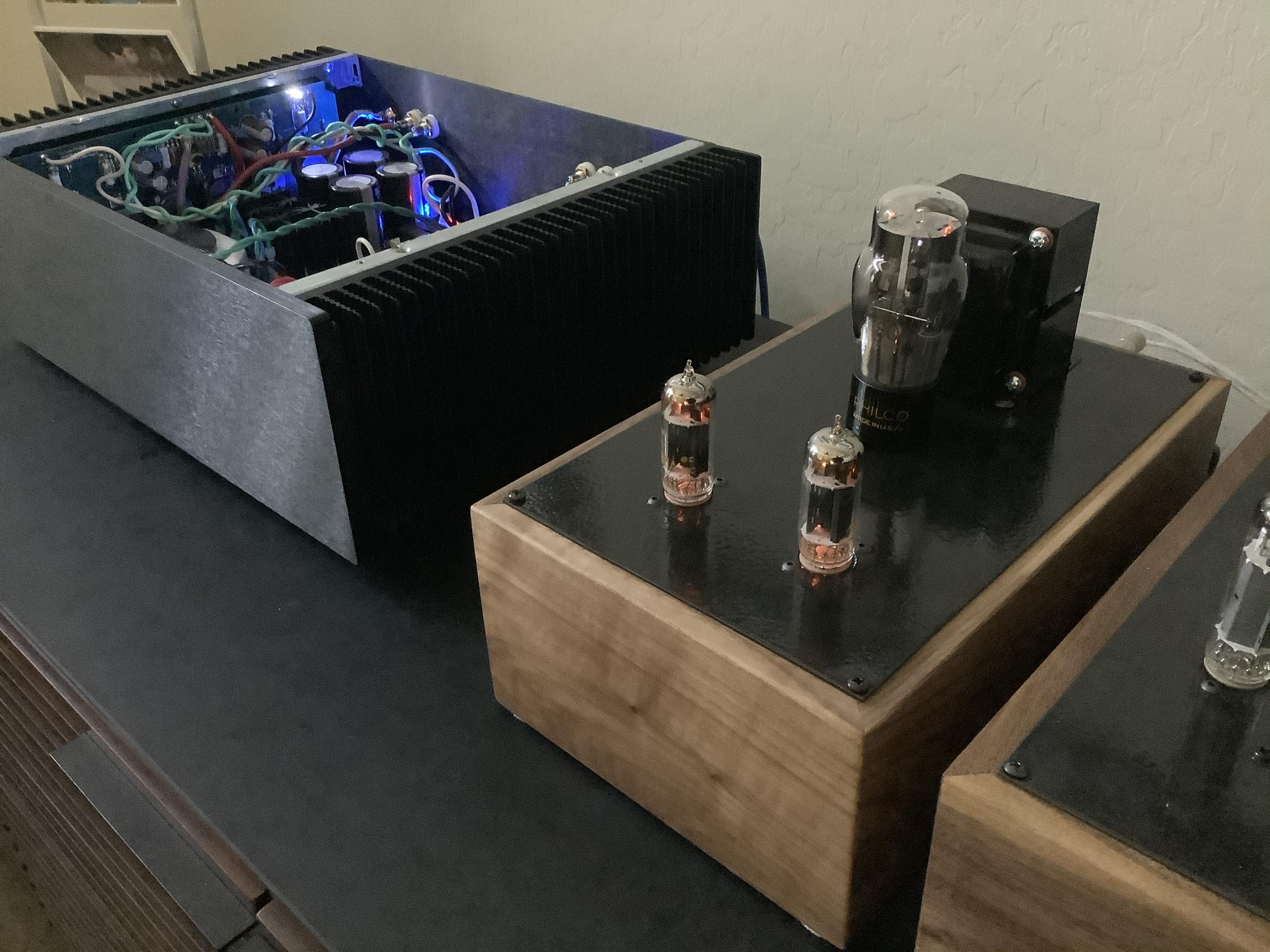

Okay, some more amp porn. Just finished another tube amp to drive the F4. This time an even simpler design: a 6CY7, which is a dual triode (driver and output) in a single envelope. I chose again to use the fabulous Type 80 rectifier and 4 ohm secondaries on the OTs.
If you guys haven’t heard the F4 driven by a flea amp, you should ;). The distortion products of a tube amp I think go beyond descending levels of H2, H3....so on and so forth. Meaning you can’t just add H2 and H3 (as I have tried) to get exactly the same experience of having and an actual tube. Credit goes to Matt for his great and very affordable design.

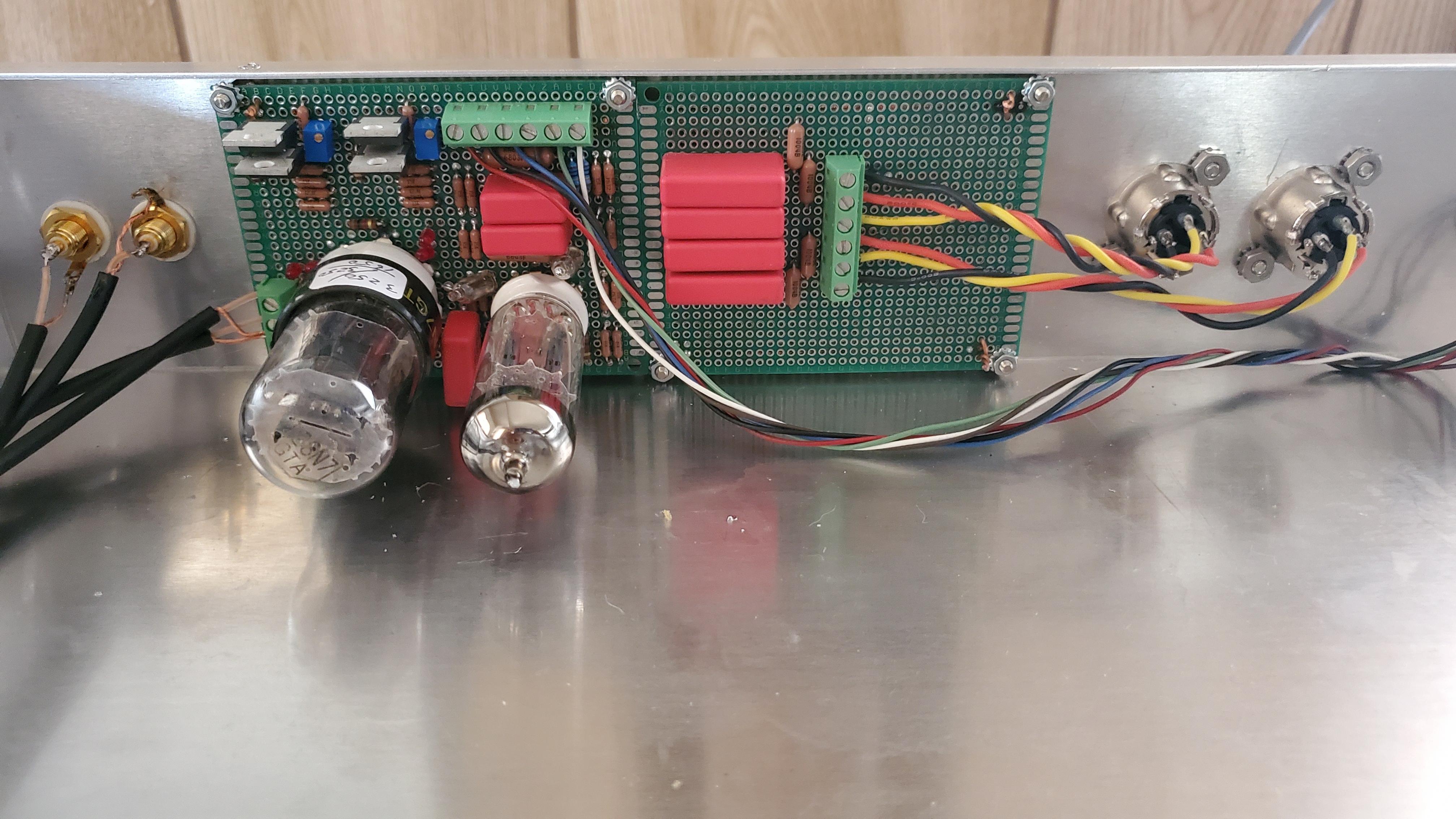

I finally got my resistors today and, It works! It sure is nice to have 100 watts per channel. Now I can crank it up a little more.
I'm driving them with an ImPasse preamp. What a great sounding preamp! I omitted the input transformer and have absolutely no hum. I'm using an ECC99 output tube because it has a 200V heater to cathode rating. It seams like the perfect tube for this preamp. I wish there was a board available. Building it on perfboard was tedious and time consuming. I wanted to have some boards produced and maybe sell them on eBay, but I can't make head or tail out of any of the PCB software.

I clicked on the link at the bottom of the audioXpress article and it was dead, so I assumed it was no longer available. Oh well. I wanted to build it very compact so it would fit in a 3" high chassis. I also used quad resistors instead of power resistors which are supposed to sound better. It has separate filament connectors so I can opt for a 12SN7, and a trimpot to adjust bias. The power supply is in a separate chassis, one of those crazy Chinese tube jobs.
It seems like it would be pretty easy to make a PCB with a similar layout by someone who knows what they're doing.

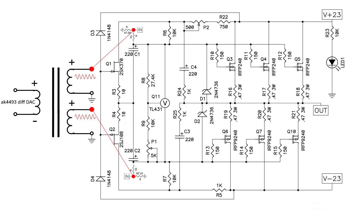

Guys,
Could you please validate my idea.
Basically I would like to get rid of 220uf coupuling caps from sigal path in F4.
I got DIY ak4493 dac with transformer output. Audio output transformer is special. It has one primary and two seconderies. This means it can output two same signals (not differential signals).
I need no preamp because I got high efficiency speakers 95db and direct ouput from dac is enough.
With all above, could I connect output signals from transformer directly before 150R gate resistors and right after 220uf cap? Please take a look a the attched picture and let me know please if it make sense. The picture represents one channel.

With potentiometer P1 set to 0 ohms, the voltage across Q11 is 9.35 volts (using the equation in the TL431 datasheet)
With potentiometer P1 set to 5K ohms, the voltage across Q11 is 7.07 volts (using the equation in the TL431 datasheet)
About half of that appears across C1 and the other half appears across C2

Unless specifically designed and made to have DC in the core, for example a single-ended vacuum tube output transformer, having any DC in the transformer is a good thing to avoid.
I've not seen any small-signal transformers that are made to handle anything aside from uA of DC.
The long story made short is C1 and C2 are absolutely essential for the operation of F4.
To bad then ... :( Thank you.

as you drew it (phases, not going in details will you burn xformer secondary or not in that way) , you practically have M2 - xformer driving source follower OS
