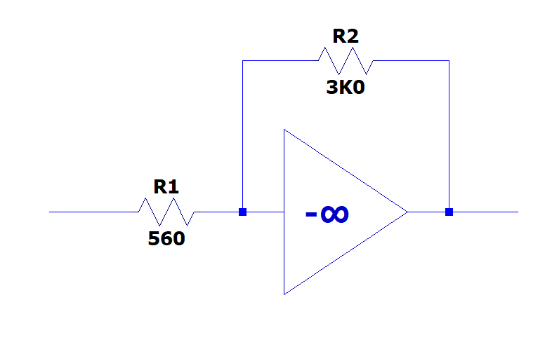

I need a good output amplifier for a generator. Specs are pretty normal: 30Vpp output, 1MHz bandwidth, 50 ohm capability, but I also want sub-ppm linearity performance, which seriously complicates matters.
However, thanks to the topology, I only need an inverting configuration, which somewhat eases the problem: no need for a NI input, and no common-mode induced distortion.
This makes me think that I could get away with a relatively simple configuration, whereas an opamp-like topology would require two or three dozens of transistors.
I didn't find any satisfactory solution so far, neither of my own nor internet-inspired.
Does someone have a good (clever) starting base to propose?
The impedance level is relatively low, which should also simplify the problem.
This summarizes what I am looking for:

How much gain are we talking about as well?
As indicated on the sketch, around 5x

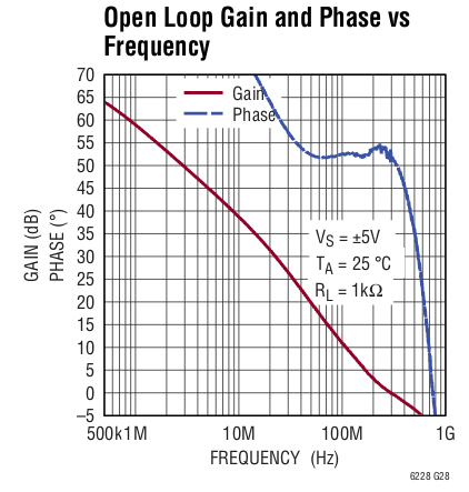

I think the LT6228/6229 works best as a voltage follower because it then has a larger loop gain than in any other configuration. With its gain-bandwidth product of 890 MHz, its loop gain is about 890 (or -890 j) at 1 MHz and 445 (or -445 j) at 2 MHz as a voltage follower and half of that when the closed-loop gain is set to -1 or +2.

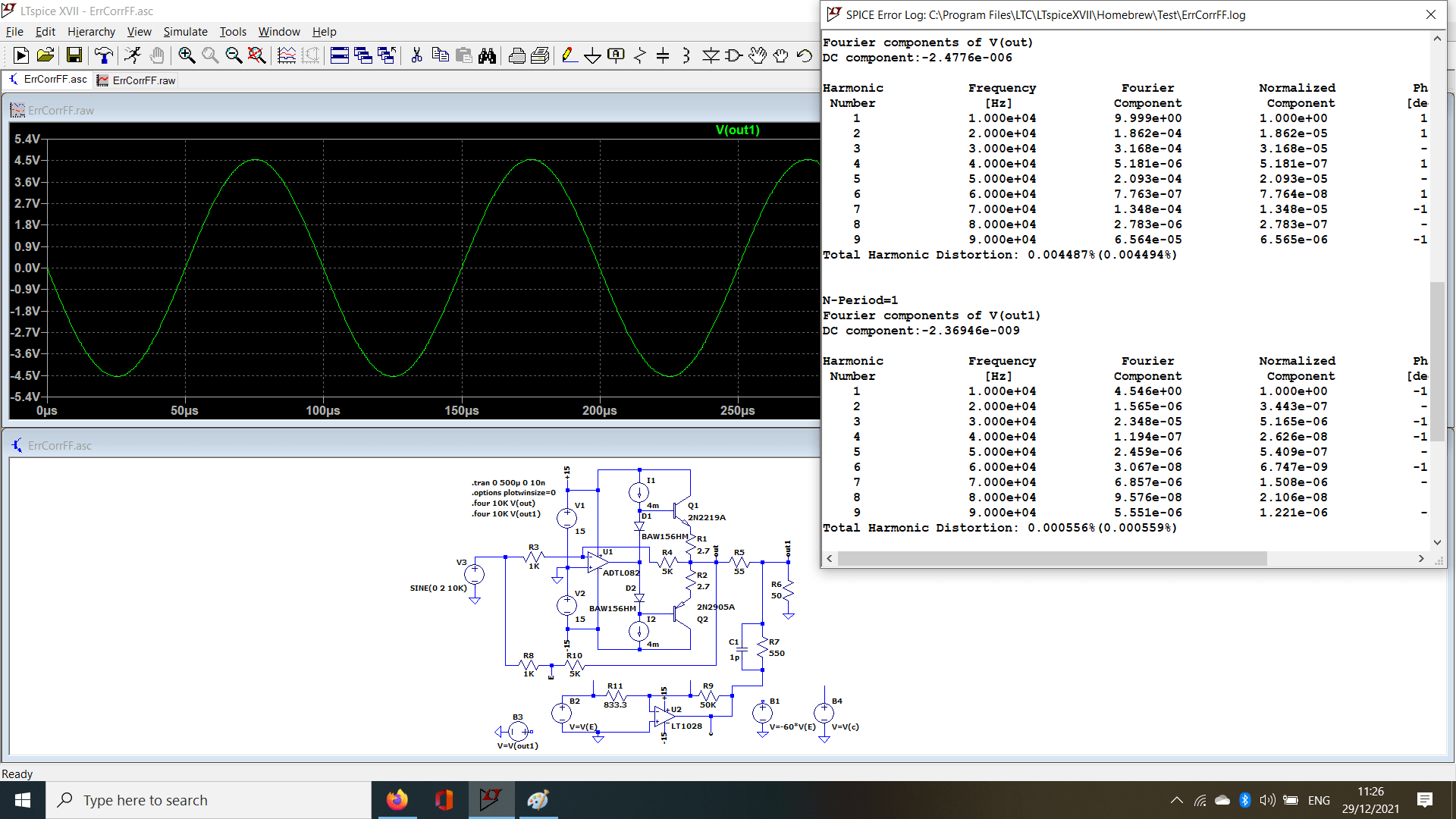

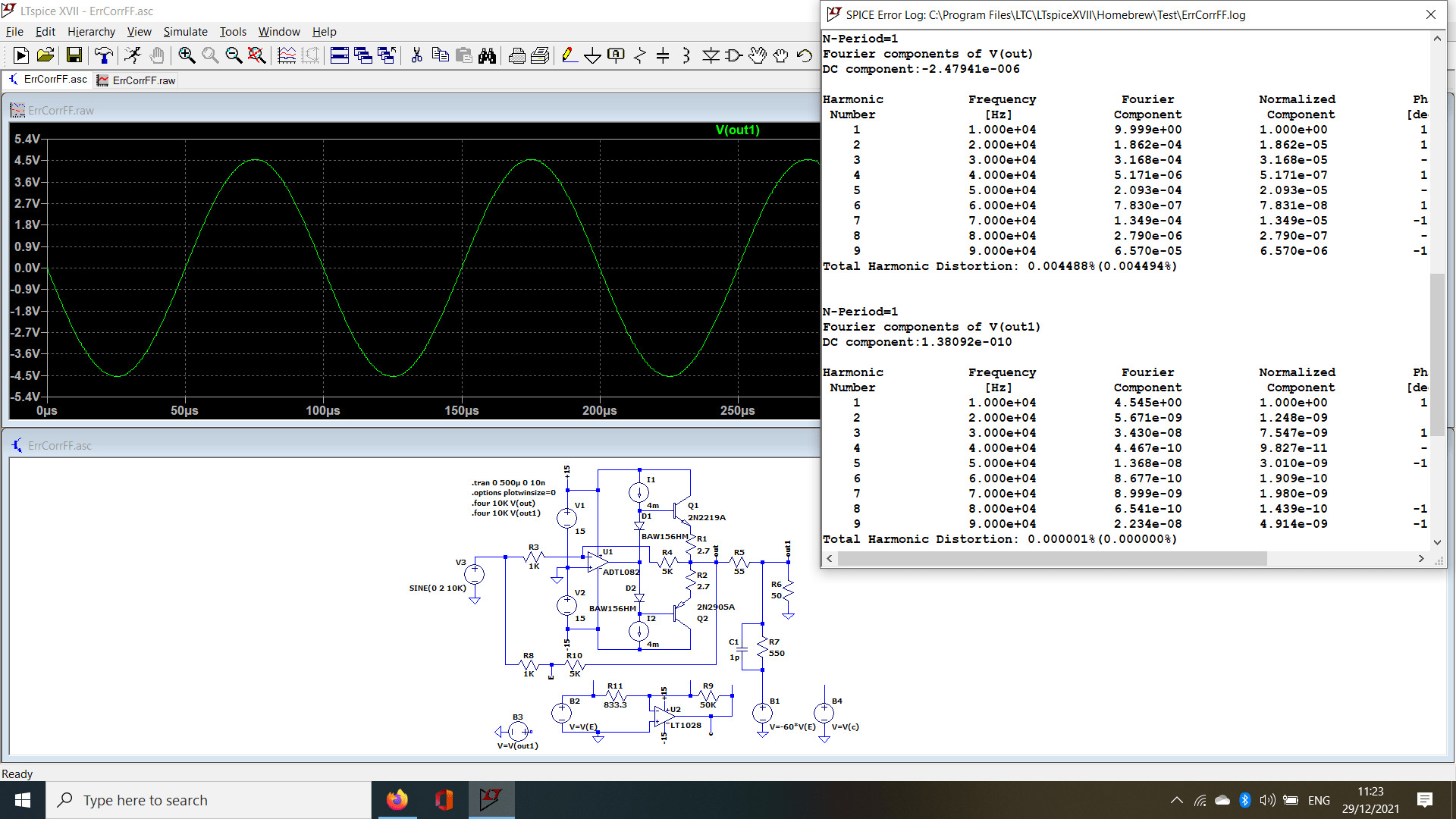

I have explored the error-correction idea.
As a model, I have used a low-performance main amplifier, to be able to see easily the imperfections and the way the correction deals with them.
The main amplifier is U1 and a discrete buffer, and its output is summed with the correcting amplifier via a resistive summer made of R5/R7.

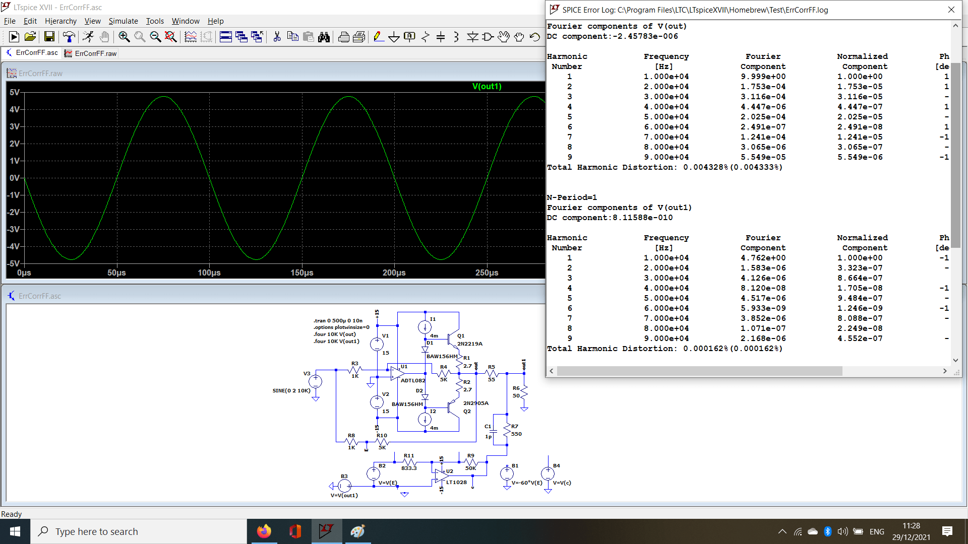

The correction amplifier has various options: B1 is an ideal spice amplifier, and it gives good results obviously:
A real opamp (U2) is another possibility, but things degrade very quickly when used directly:
One of the problems is that the corrector's output is ~0 (ideally anyway), but it is connected to the full output voltage via R7, resulting in a large output current.
In the sim, this can be fixed by referencing the corrector to the output, but in the real world things would be much more complicated:
Another fix is to insert an ideal spice buffer between the corrector's output and R7:
All of this seems to indicate that the corrector amplifier needs to be exceptionally good, although it shouldn't in theory: it only deals with small voltages, and its output is diluted in a 1:10 ratio.
With a simple gain block, like in post #1, the impedance has to be zero so that only the 50ohm resistor defines the external output impedance, very much like most signal generators.
The 30Vpp is open-circuit.
With a more complex arrangement like the error-correcting one, the requirement is to have a final equivalent impedance = 50ohm.
Since the output has to tolerate a short, the amplifier(s) needs to be able to drive 50ohm
You could also use a combination of series and shunt feedback to set the 50 ohm output resistance, although I don't see any advantage to doing so in this case. As the circuit has to work well with shorted and open output, the output stage still needs to support 30 V peak-peak and 600 mA peak-peak.
A synthetic output impedance might ease voltage swing constraints, but replacing a purely passive component with active ones is probably going to add non-linearities; not absolutely certain though: a very clever circuit might simulate the output impedance AND reduce the non-linearities, but for the moment I do not feel clever enough to implement such a wonder.
I need to sleep over it, once, twice, or more, maybe the illumination will come...
For the moment, what I find disturbing is the required quality level of a possible error-correcting amplifier: back-of-an-envelope calculations seemed to suggest that it should be relatively unimportant, but even a sim already shows that it is not the case
I have used a crappy TLO82 as a main amplifier, to be able to observe realistic flaws and the effect the corrector has on them, but operating the same amplifier at 1MHz is science-fiction.
Other truly 1MHz-capable amplifiers, (native in the LTspice library), give such impossibly good results in the sim that they are not usable to test a correcting scheme: they already pass with flying colors by themselves, but I know for sure that the reality is quite different.
Therefore, I use a "small steps" approach: when I find a good, effective and tolerant scheme working at low frequencies, I can adapt it to higher frequencies

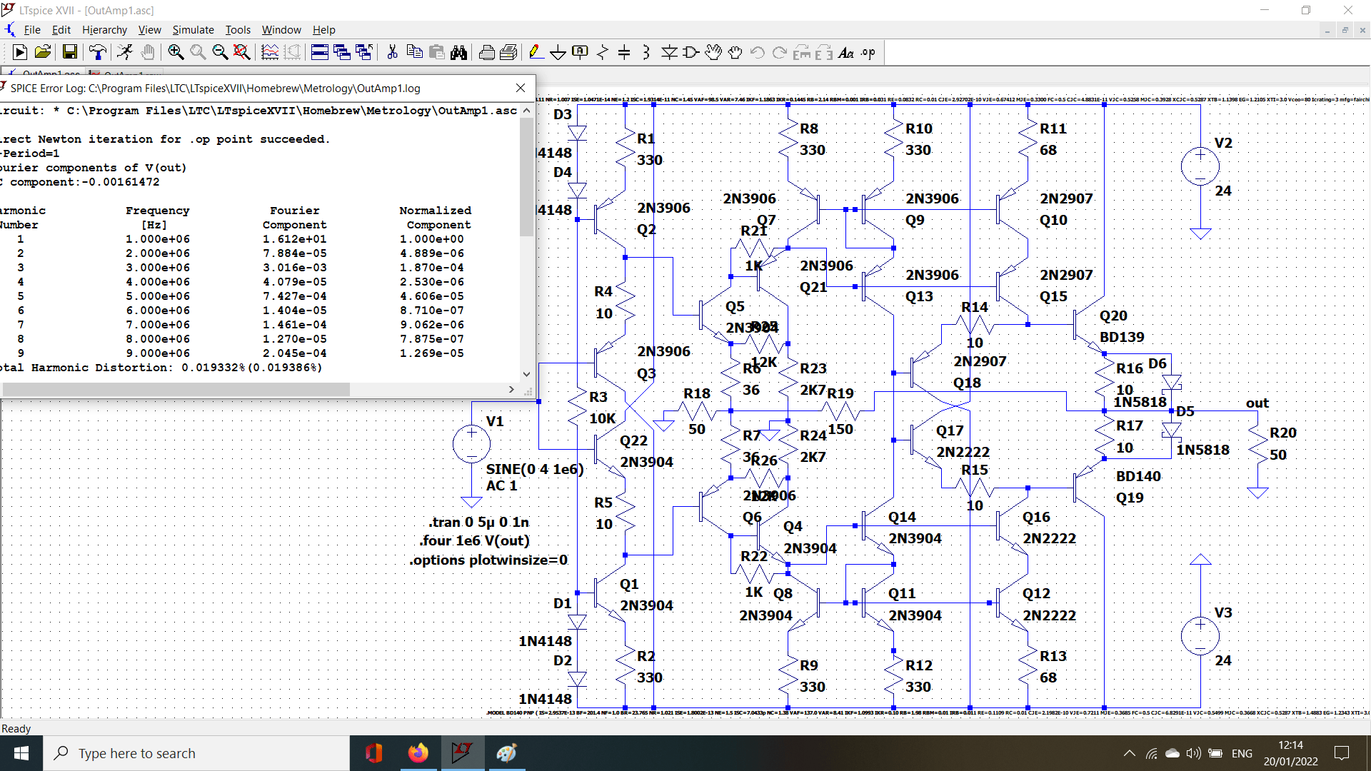

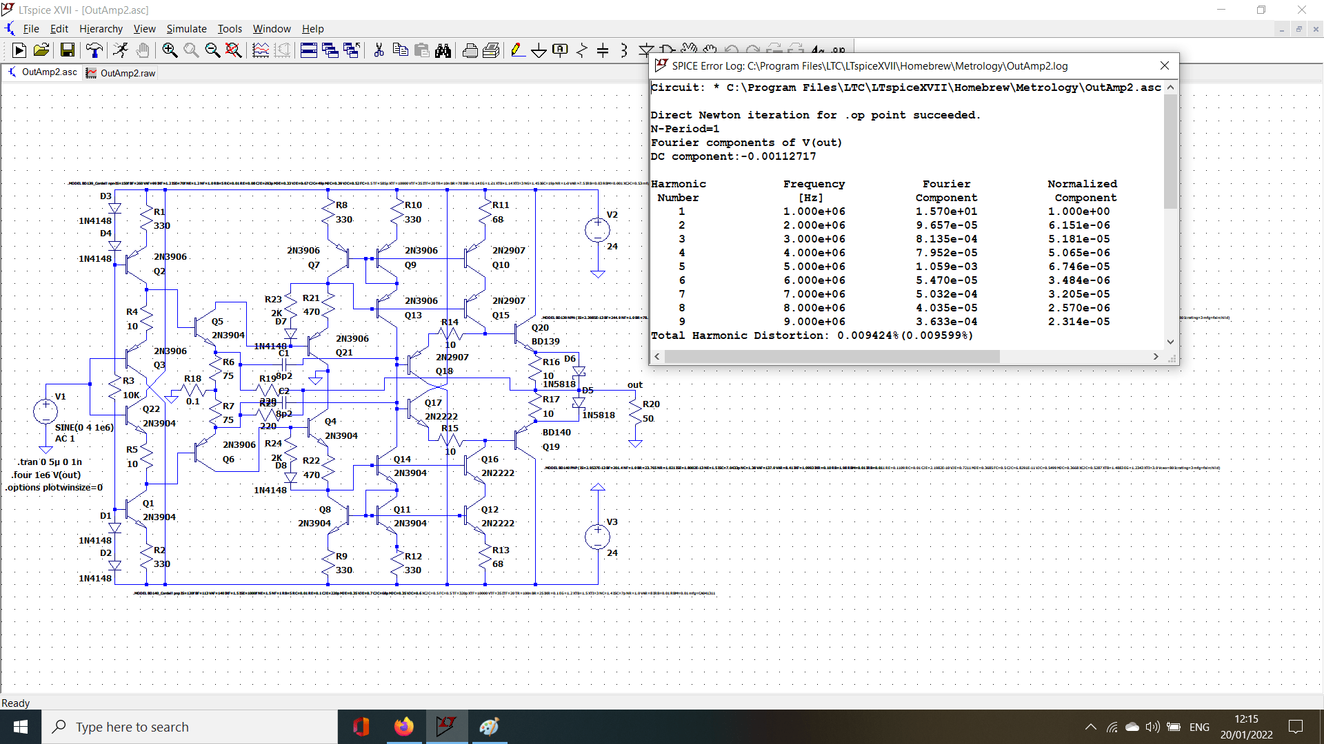

I am currently exploring another promising circuit, courtesy of Suzyj:
https://www.diyaudio.com/community/threads/does-anyone-recognise-this-topology.302358/post-4954495
It is already quite good in its original form, but I need to improve it significantly.

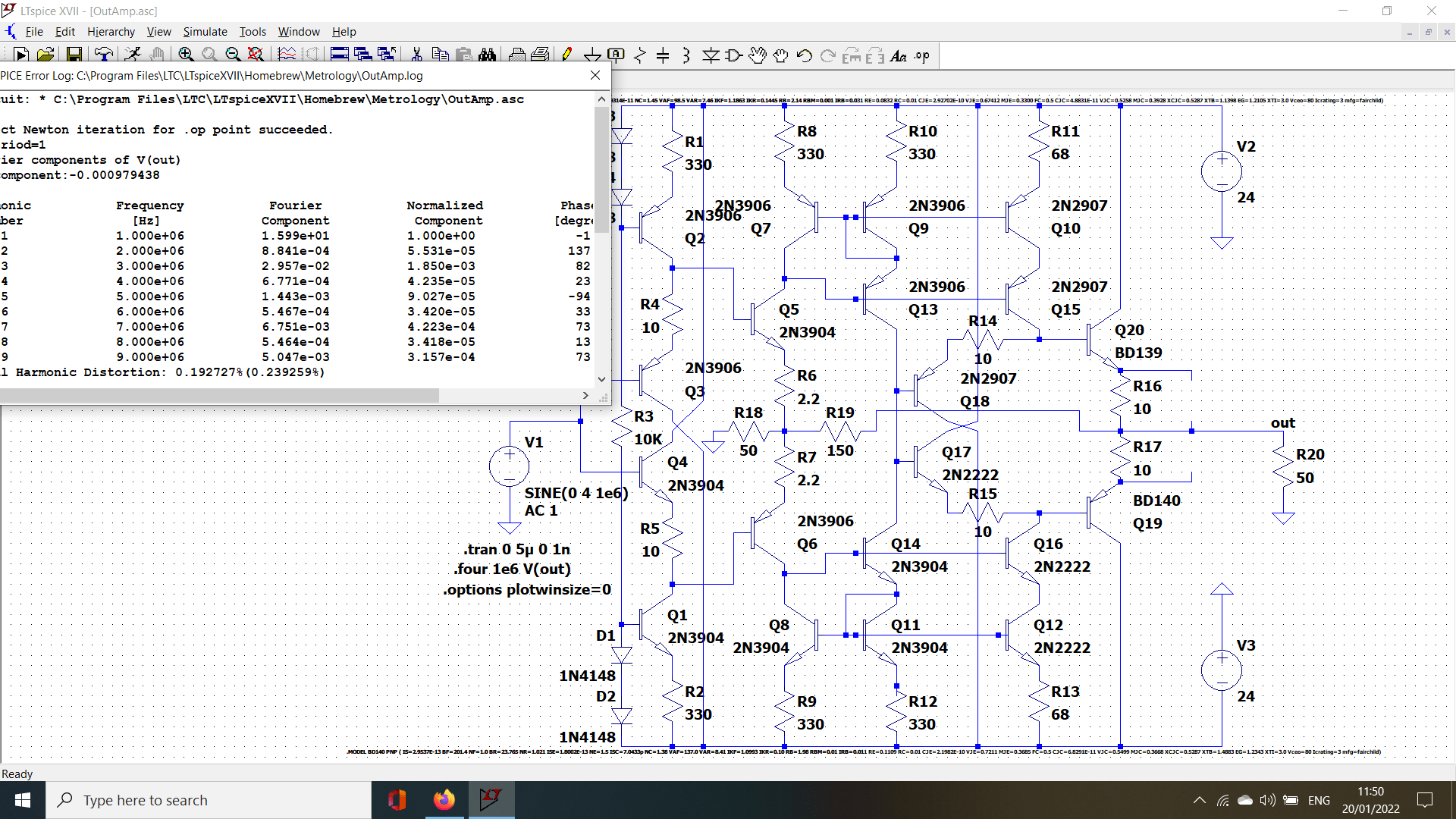

With 24V supplies, it manages 0.2% THD @1MHz:
One of the causes of distortion is an imperfect crossover: the output transistor that was conducting doesn't turn off instantly, and this conduction tail influences the output because of the 10 ohm resistors.
By shunting them with fast diodes, the newly active transistor immediately takes control and eliminates the artefacts.
The result is a reduction to 1/3rd of the THD:

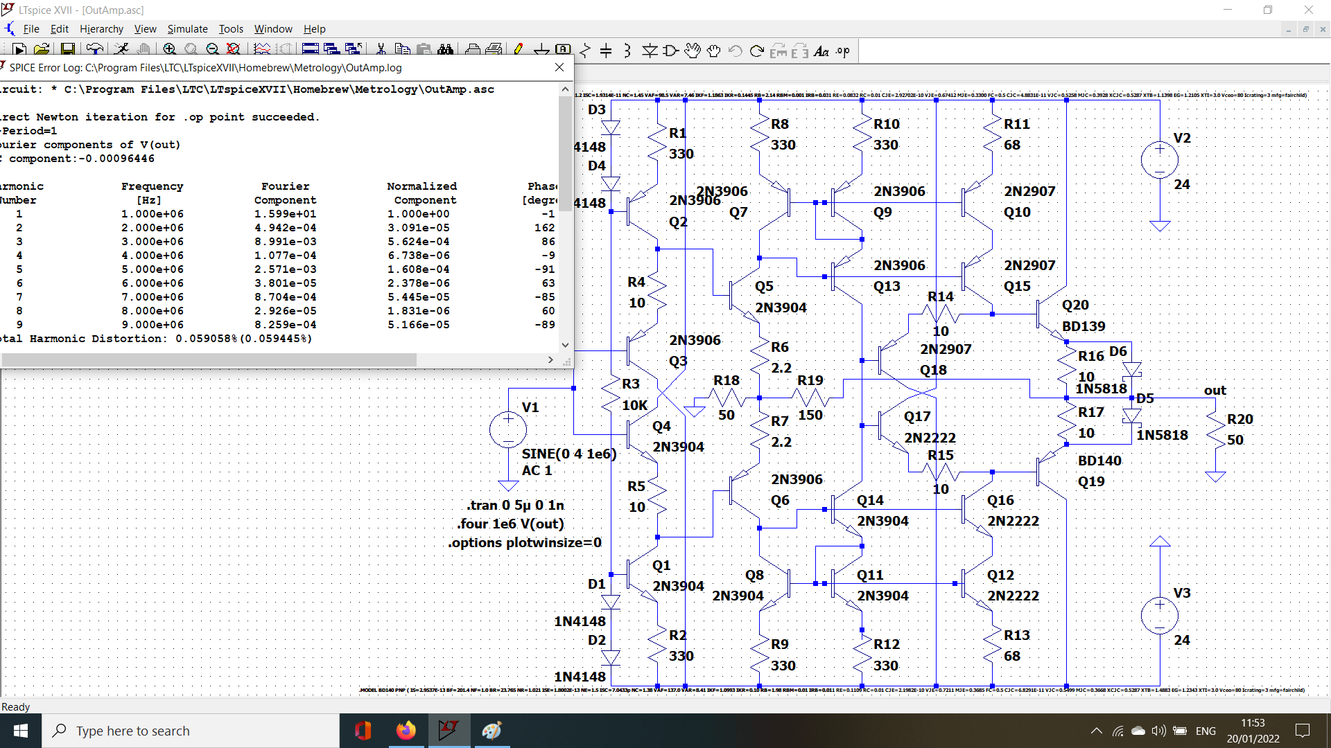

Another issue is the loading of the feedback divider by Q5/6.
Reducing the resistors values is not a realistic option, but by including a CFP-inspired buffering layer, the THD can be reduced by a further factor of 3:
A similar approach is to insert a fixed current gain in the collectors of Q5/6:
The THD has now dropped below 10ppm.
Ideally, I would like to drop the non-inverting input, which would be possible in a 50 ohm environment, but much more difficult at 560 ohm, unfortunately: it would have simplified the circuit, and reduced the non-linearity even further.
Does anyone see other low-hanging fruits to be picked somewhere in this circuit?
