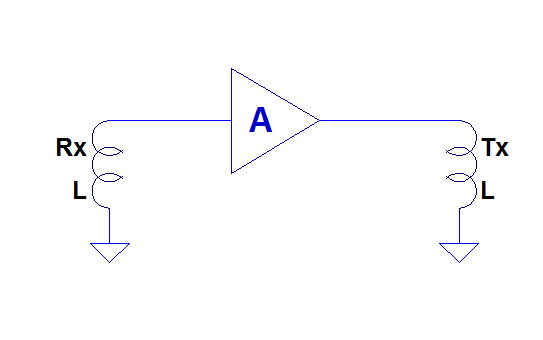

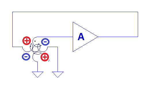

This sketch outlines the electrical configuration:
attachment.php
Nothing is particularly unusual: it is an amplifier looped back on itself, except the positive feedback is nonexistent, because the input and output inductors are not coupled.
Thus, such a circuit has no chance to oscillate, but then, where is the catch?
The answer is in the geometric configuration of the coils: they are magnetically orthogonal, meaning their coupling coefficient is zero.
This is a more faithful representation of the physical configuration:
attachment.php
It is now obvious that no coupling can exist between the Tx and Rx coils, but how can such a configuration oscillate in the end?

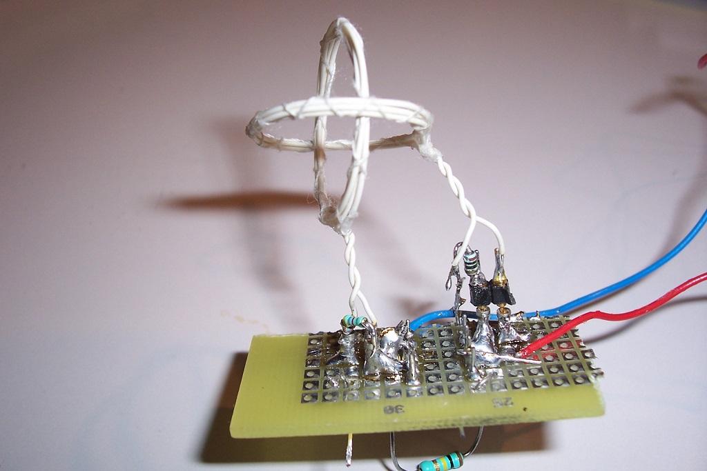

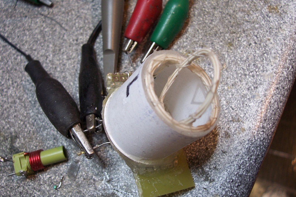

The two coils divide the space into 4 quadrants: a picture of the prototype should make things clearer:
attachment.php
The two coils of this prototype are ring-shaped, about 27mm dia, and comprise 6 turns of wire-wrapping wire. Their inductance is a little under 2µH.
If a tuned circuit is present in any of the quadrants, it will be able to interact with both inductors, because it will not be orthogonal.
The transmission coil can induce a resonance in the tuned circuit, and in turn, the current in its inductor will couple to the reception coil.

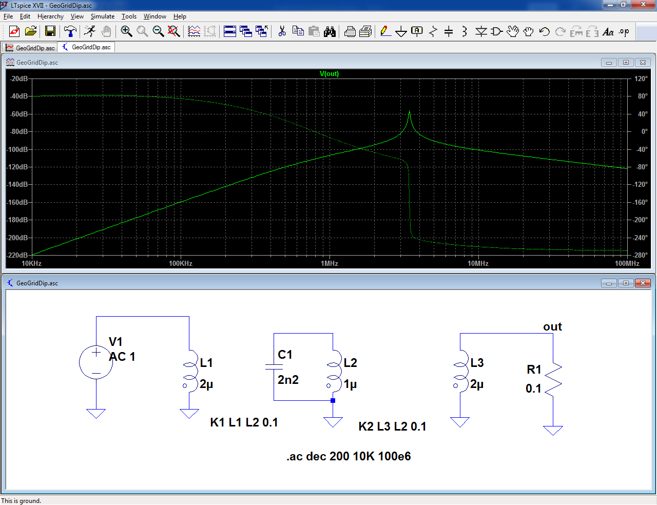

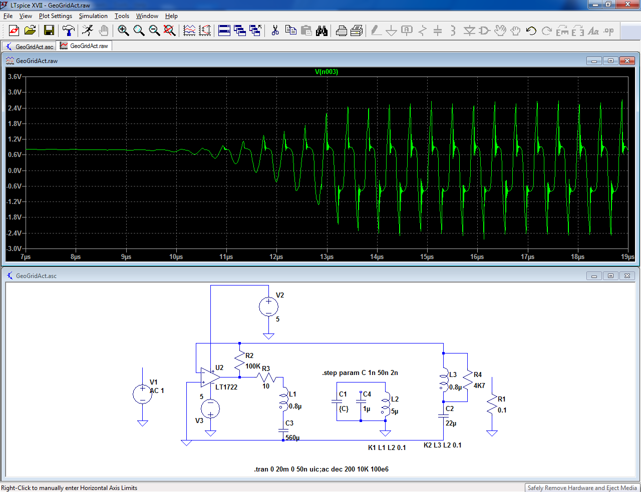

This is shown in this simulation:
attachment.php
Coupling coefficients are only defined for L1/L2 and L2/L3, yet the signal from L1 manages to reach L3.
To summarize, the Tx and Rx coils do not see each other directly, but the Tx coil can “illuminate” the tuned circuit, which then becomes visible to the reception coil.

The principle of the pseudo-grid-dip look simple enough, but as always, the devil is in the details.
In this sim, you may notice some peculiar details:
820124d1582663208-geometry-based-grid-dip-meter-emulation-emugrdip2-png
L1 is driven by a voltage source, nothing particularly unexpected there, but the Rx coil L3 is ~shorted, and operates in current mode. This is no coincidence: to oscillate, the circuit needs to satisfy the obvious gain condition, G>1, but the phase condition is equally important: there has to be a frequency where G is >1, and φ=0 simultaneously, and preferably at the resonant frequency, otherwise it defeats the whole point of the project.
The reason for those driving conditions is that at the resonance, the tuned circuit introduces a 90° phaseshift.
It is thus necessary to adopt a hybrid Rx-Tx scheme: one of the ports has to be current controlled, and the other voltage controlled.
Here, the input (Tx) is voltage-driven, meaning the current (and mag flux) is in quadrature (delayed).
At the resonance, the tuned circuit creates an additional 90° phaseshift, because the resonance voltage overwhelms the initial induced voltage (assuming a sufficient Q factor and loosely coupled circuits).
And finally, the current induced in L3 is in phase with L2, meaning the two previous phaseshifts cancel one another.
The other option, current drive + voltage sensing is also theoretically possible, but is problematic from a practical point of view: when the frequency is lowered, the current drive remains identical, but the dΘ/dt in the tested coil is proportionately lower, as is the induced emf at the output. This results in a loss of gain.
With a voltage drive, the current is inversely proportional to the frequency, and this automatically compensates for the loss of gain.
The voltage drive/current sense has another advantage: both coils operate in low-impedance, quasi-shorted conditions, meaning their parasitic parameters like parallel capacitance become almost irrelevant: with the 2µH coils of the prototype, normal operation remains possible at more than 40MHz, which wouldn't be possible otherwise.

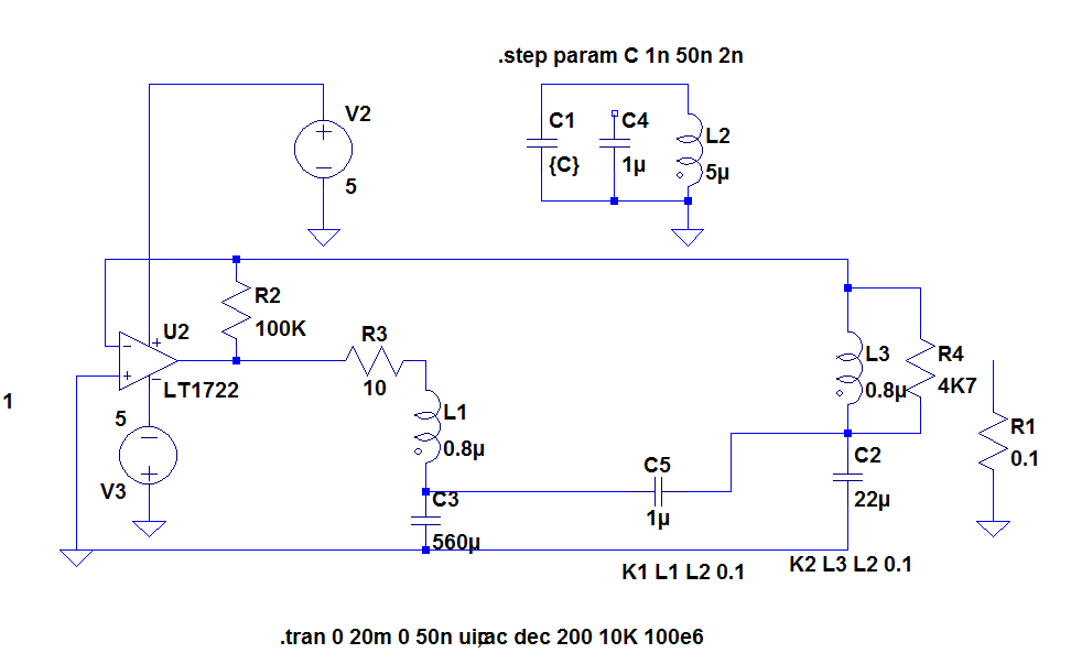

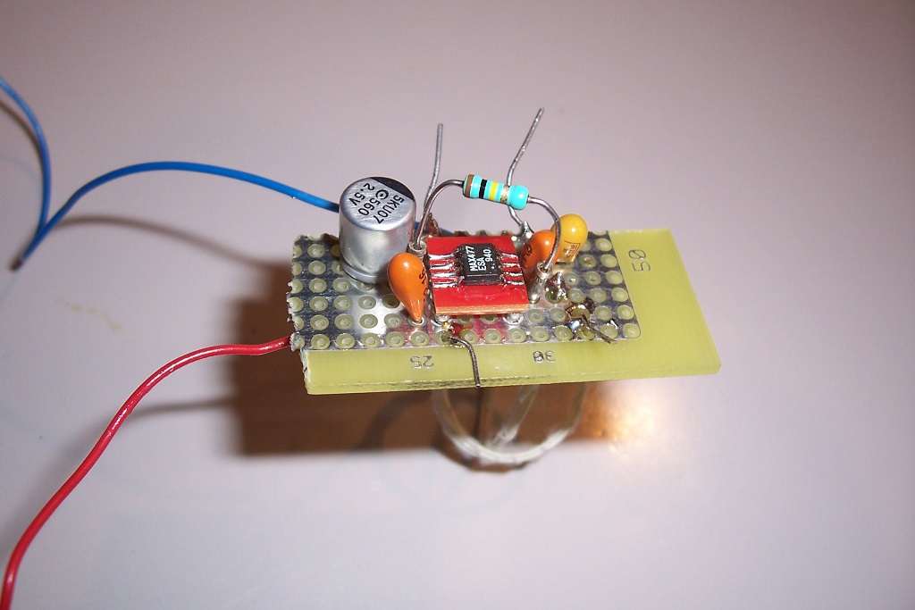

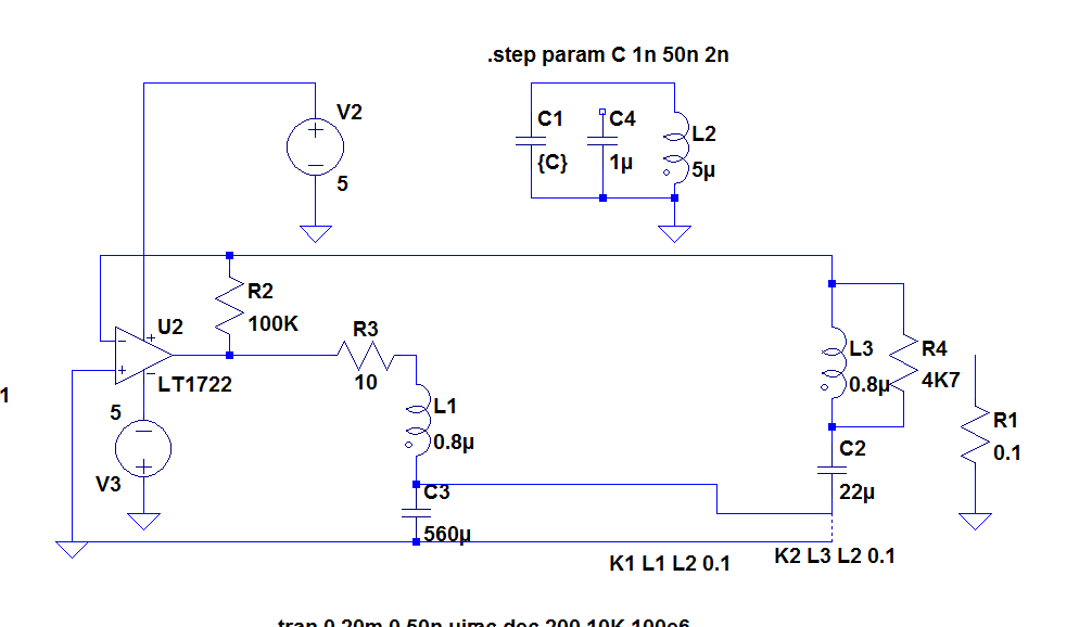

Here is the implementation I opted for:
attachment.php
It uses a fast opamp as a gain block, which is an easy/lazy solution: in fact, there is no need for the amplifier to be operational, as the circuit does not require closed-loop stability or DC accuracy, but it is convenient and nowadays, it becomes difficult to find general-purpose, non-operational amplifiers.
A non-op amplifier has no restrictions on its high-frequency gain or other characteristics, and can be simpler for the same level of performance, but they are a rarity, whilst HF opamps are ubiquitous.
I chose a LT1722 in the sim, but in practice I tested many other types: OPA620, AD849, CLC420 and MAX477 in VFA.
The circuit can also work with CFA types, and I tested a number of them: AD811, EL2020, EL2120 and EL2160. I expected them to work better than VFA's in this role, but I was disappointed: they required a modification of the coupling caps configuration to ensure their LF stability, and their gain was inferior, making the circuit less sensitive.
The highest performer was the AD849, but it had annoying quirks, in particular a DC shift in the presence of a HF signal which made its stabilization a nightmare.
I tried my my best to tame it, but in the end I gave up and opted for the MAX477, which has inferior performances but is much more docile.
The practical circuit needs some arrangements with the theory: the main one is the series resistor, R3.
It is required, because at low frequencies the reactance of the 0.8µH coil is tiny and acts as a short at the output of the opamp.
This is not healthy for the opamp itself, and even if it tolerates it, the signal recovered becomes too small to be reliably detected or measured.
The presence of the resistor changes the phase characteristic below a certain frequency, and this modifies the condition of oscillation: below 1.5~2MHz, the phase becomes reversed, meaning the tuned circuit has to be presented to another quadrant of the coil assembly.
There is no gap however: between 1.5 and 2MHz, the circuit oscillates indifferently in both quadrants.

I have retained the "armillary sphere" coil configuration: it is the simplest and most obvious (many others also result in a zero coupling), but it looks well suited for the intended purpose.
Here it is, enclosed in its protective plastic shell:

The coil assembly looks complicated, but it isn't really, and it is fixed: you only need one for all the frequencies.
Two times 4 turns glued in an orthogonal position is not really difficult, and the exact size or number of turns is not critical.
The only critical aspect is the orthogonality, but it is easy to test and to glue in place.

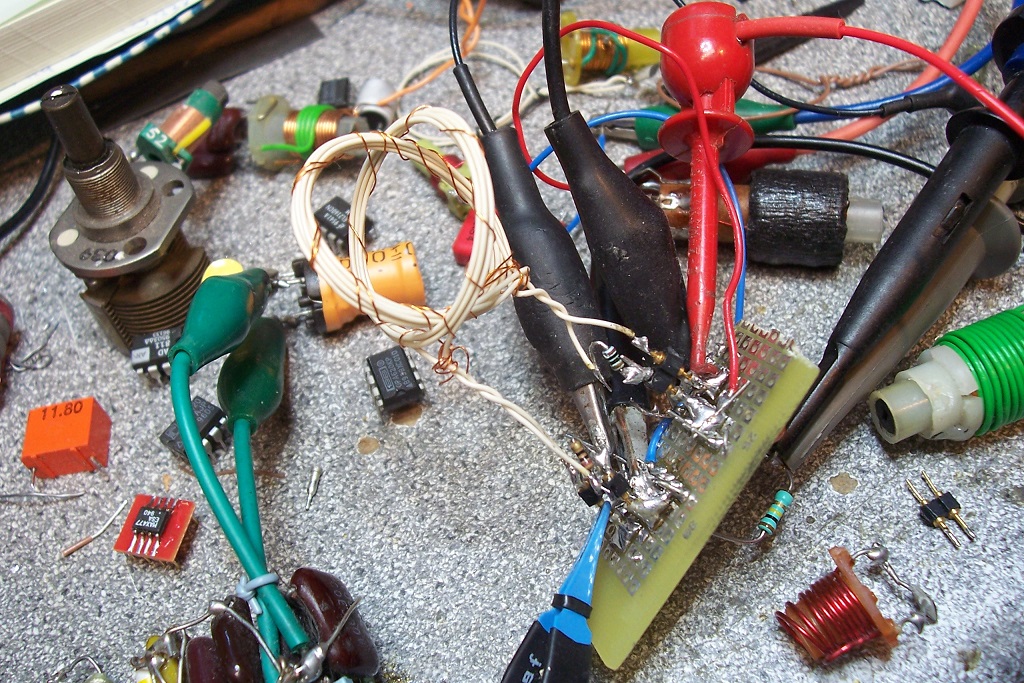

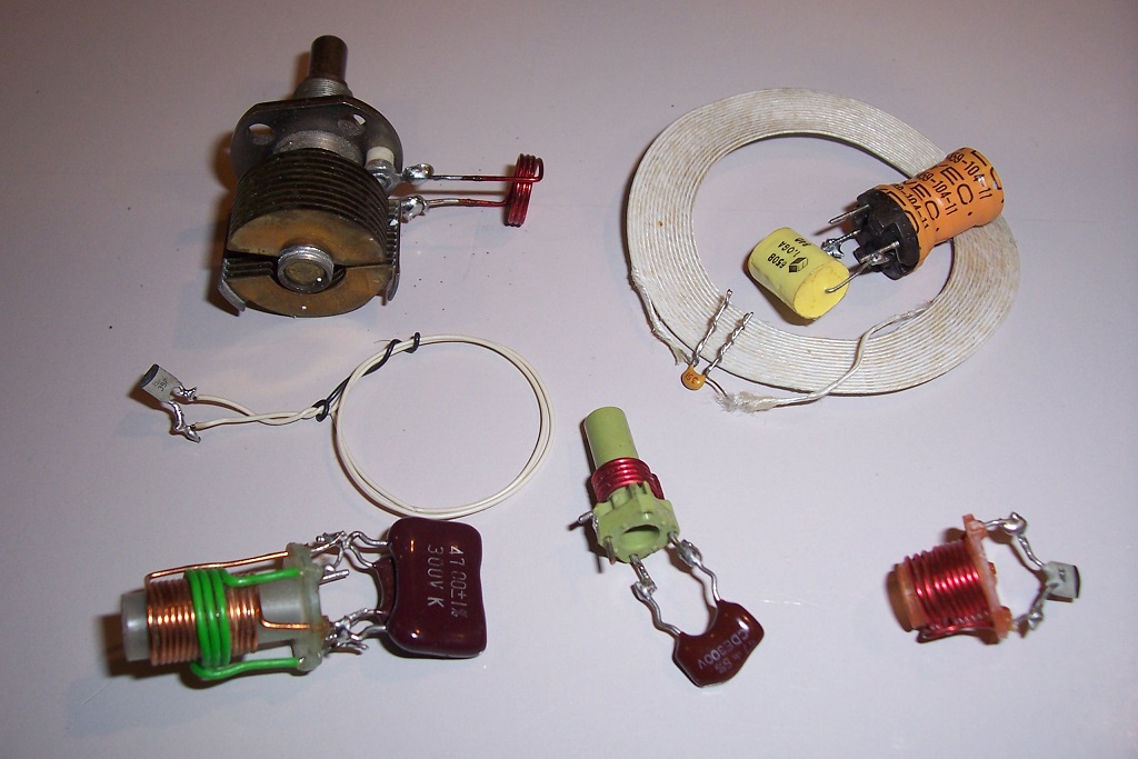

Here is a random selection of some of the tuned circuits I (successfully) used for the tests:
attachment.php

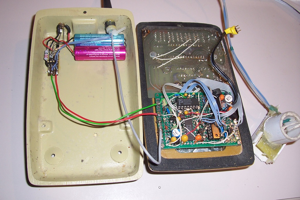

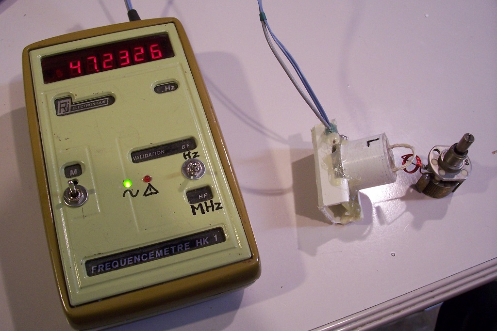

I have built the prototype into a real, usable test instrument:
attachment.php
It is grafted inside an old, worthless frequency-meter for convenience and includes all the necessary bells and whistles to make it comfortable to use and reliable.

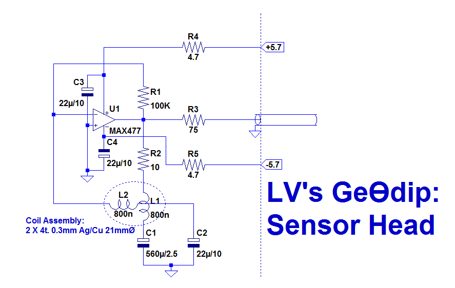

Here is the schematic of the most important part, the sensor head:
attachment.php
The rest will follow soon

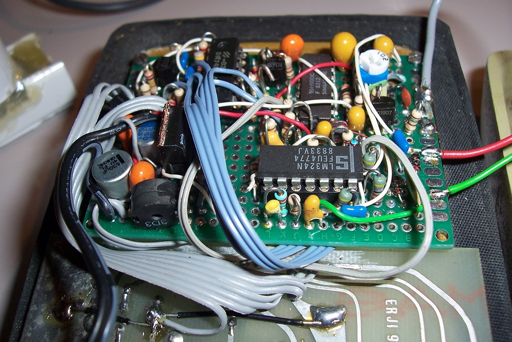

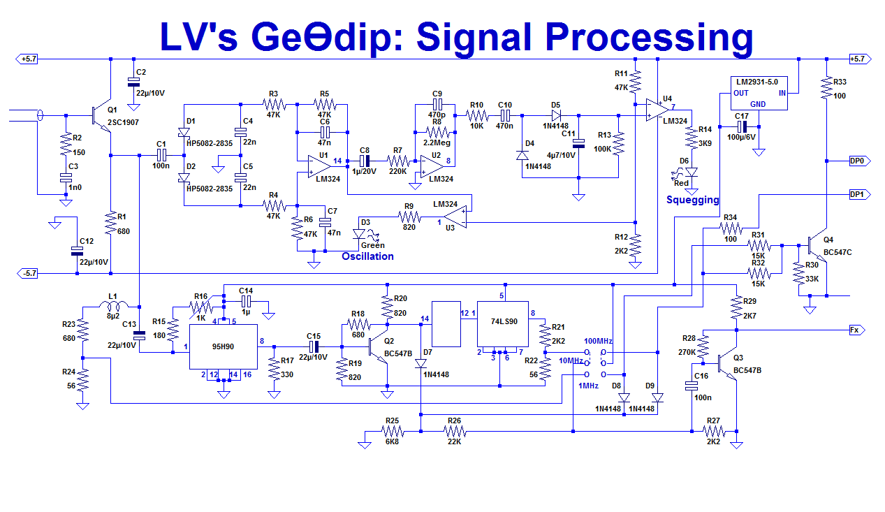

Here is the signal-processing part: the oscillation and quality detectors and the frequency dividers string:
attachment.php

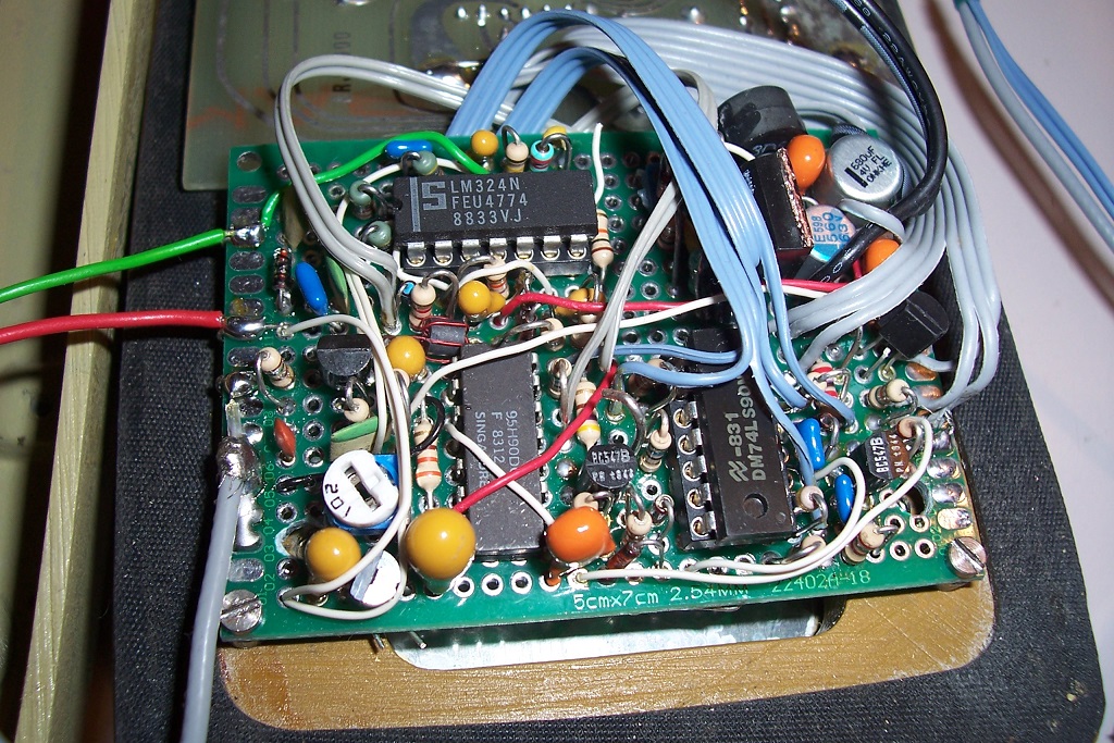

Here are some pics of the circuits:
attachment.php
attachment.php
attachment.php

Some explanations about the signal detection: it looks overly complicated, but for good reasons.
LC oscillators can be affected by squegging, and this one is no exception.
Squegging is a form of semi-chaotic relaxation LF suboscillation that modulates the base frequency.
It is generally caused by an excess of positive reaction: oscillations build up sufficiently to shift the DC bias point, because of grid/gate/base rectification, driving the oscillator into cutoff, but as long as there is room for increased amplitude, the buildup continues until saturation occurs. At that point, the bias shift continues to increase until even class C oscillations are no more sustainable.
Oscillations then cease, and the oscillator needs some time to recover and oscillate again.
The whole process then begins again and a new cycle starts.
Sometimes, this condition is induced on purpose, as for superregenerative receivers (the process is partly chaotic, and very sensitive to initial conditions), but it is generally an annoyance.
With the Geodip, the feedback conditions vary hugely, meaning squegging is a possibility.
The MAX477 is particularly well-behaved, and squeggs only occasionnaly (I'd say ~2% of the times), but it is important to detect the condition: I built the Geodip as a standalone instrument, with no monitoring output, and the frequency-meter will average the frequency, meaning it will miss a number of cycles when squegging occurs.
The squegging detection is made by detecting LF modulation over the already detected DC signal.
Here, the situation is complicated by the fact that the Geodip operates down to the kHz level, and squegging rate can be as high as a few hundred Hz.
For that reason, U1 operates as a full-wave, frequency-doubling detector to minimize the ripple. U2 amplifies any modulation which is detected by U4 and lights the warning LED.
When squegging is signalled, one just has to move the tuned circuit back slightly, to reduce the coupling and the positive reaction.
Normally, the red LED flashes briefly at the transitions, when the oscillations start or end (unless you have Parkinson's disease, of course)

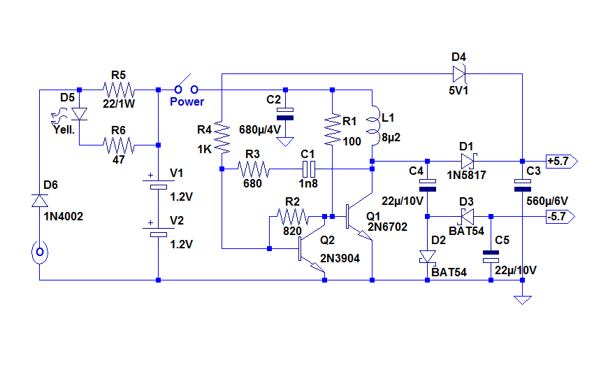

This is the power supply:
attachment.php
A DC-DC converter supplies everything, which looks radical but is completely logical: a converter is necessary anyway to generate the negative supply, and the difference between a low-power crude converter and a medium-power crude converter is just in the components size: slightly bigger.
So, instead of using a 200mW converter and 5 NiMh cells, I used 2 cells and a 2W converter.
The converter is a very low-tech, self-oscillating one, based on the FB topology.
The frequency of operation is comprised between 80 and 100kHz.
It is crudely regulated.
I used a 2N6702 (with the mounting tab snipped) as power element, which should be completely unsuitable based on the datasheet, but the ones in my stock shine, and work remarkably well for a largish, HV type (other sources would probably behave dismally).
A more sensible choice would be a ZTX---, but I had no suitable type in my drawers.
The average output power is ~2W (the vintage display, prescalers and analogue circuits are power-hungry), resulting in a 1A consumption on the 2.4V input side.
When the oscillator runs at its 145MHz maximum, it rises to almost 1.5A, but this is relatively unimportant: with ~3Ah elements, the autonomy is still 2~3h, which is ample considering the type of use of such an instrument.
Initially, I had used a standard drum-core choke for the 8.2µH storage coil, but the open magnetic circuit leaked too much in the environment.
I first changed the other 8.2µH RF choke for a custom-wound one on a closed magnetic core (a ferrite bead), but the sensor head was also affected, and I had to wind the power choke on a miniature, completely closed potcore.
This solved the issues.

Here is a small video showing the Geodip tested with a number of tuned circuits, from 1300Hz to >100MHz.
YouTube
It can of course test and ping any resonant circuit-based device, including RFID tags, NFC interfaces, wireless power systems, transponders, anti-theft devices, E-tickets, etc.
The "normal" operating mode, as described in the first post, starts at ~1.5MHz, but it doesn't extend to the maximum frequency: above ~65MHz, there is another phase inversion, probably caused by the phaseshift in the opamp and the parasitics of the sensor coils.
The maximum frequency is 145MHz, but the tuned circuit needs to pushed inside the "armillary sphere".
For the low-frequencies too, at 1.3kHz, the tuned circuit has to be inside the sphere because of the very low Q.
The display only has 6 digits, meaning that for frequencies >100MHz, the overrange LED acts as a "1". I didn't want to add a range just for that

Ideally, the size of the sensor coils should broadly match that of the tested device.
That is valid for any magnetically-coupled device: it maximizes the common field and thus the coupling.
If the main interest is E-tags, E-tickets, wireless or NFC interfaces for example, a diameter of several cm would be ideal.
For general VHF/ham applications, 1cm would be more appropriate.
The 21mm I opted for is an excellent general-purpose choice: as you can see in the video, it easily adapts to large and small coils, from a few mm to more than 10cm.
As I mentioned earlier, other configurations are possible: an off-centered armillary sphere for example, to make more room for the DUT or overlapping loops in the same plane, as in metal detectors.
In fact, all the configurations used in IB metal detectors would be usable (but not necessarily practical in a grid-dip meter).
The number of turns should suit the frequency range: here again, 4 turns is OK for a general purpose instrument, but for VHF/UHF application, 2 or even 1 turns would be preferable.
For lower frequencies, a larger number is of course preferable.
One could also make pluggable sensor assemblies, but this would defeat the main purpose of the project: one-size-fits-all for a > 1 : 105 frequency range.

A grid-dip on the verge of oscillation can make a sensitive, tuned field-strength meter. This substitute is an extremely sensitive magnetic sniffer (= field-strength meter), and it does not need to be tuned: it displays the detected frequency directly.
If "difficult" amplifiers like CFA's are used, VLF instabilities can occur.
To stabilize the circuit, it is necessary to use a different coupling caps configuration.
This is the most radical (and effective), but it will limit the LF performance:
attachment.php
A less violent (and less effective) approach will leave the LF performance mostly intact, but it has to be adapted to the opamp used:
attachment.php

The Geodip concept has interesting "philosophical" implications: it can detect a tuned network in its frequency and space range, but it does so without emitting or receiving any apparent signal.
Conventional devices like card readers or grid-dip meters need to send a stimulus, a signal of some kind.
By contrast, when the Geodip is idle, it is as inert and passive as a lump of wood or a concrete block: it emits absolutely no detectable signal.
The target too is completely passive and inert, yet when they are within range, the Geodip wakes up and emits a signal at the correct frequency.
Imagine a similar situation in the optical domain: someone sits inside a completely dark room: not a single visible photon is present.
A color sample is then unveiled; it is just a pigment and emits no light of its own, yet in the complete darkness the person can tell exactly what color is the sample.
Intriguing, isn't it?
Of course, there is no magic: it is just a peculiar type of oscillator having its elements physically separated, but it is nevertheless amazing.
The concept could be used to make "stealth" reader: a regular card reader or anti-theft system betrays itself by permanently emitting an exploratory field.
With the Geodip, the oscillation only appears when the two elements are close enough.
Your analysis is ignoring thermal noise and amplifier noise. You optical analogy isn't realistic as optical light is not thermally activated in normal situtations. Substitute far infra-red (which is thermally active at normal temps) and you'll realize there is no "completely dark room", all objects are glowing with their
own colour spectrum and lots of photons are always present!
The amplifier is broadcasting its noise to the output coil, the tuned circuit is emiting and receiving em radiation constantly with its environment, ie has a colour (unless its completely reactive, unlikely). The correlation the amp sees
between the input coil signal and the noise it sends to the output coil is going to lead to build up an oscillation favoured by the tuned circuit.
Yes, I agree completely, and I mentioned it myself:
The starting mechanism is the same as for any other oscillator, but having the elements physically separated gives an impression of weird, spooky effects (perfectly explainable in a hard, rational way though)
