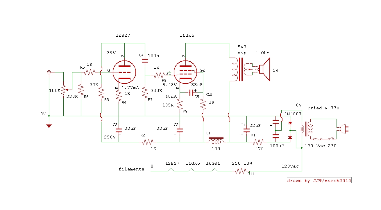

Hi, Stalker , note that in the original transformerless, the schem claims for 145V just after the diode, and feeded from an unknown wall socket, while I've got measured 132V at the same point.(under load). Why do You think this guy Rosen used a single diode?
To found some 400V caps is not a problem , but It's worth it to do so?.
Maybe in a second unit. I started this one more like a joke, and never suspected that the sound could be as good as it is.
Ok, I did the math 120 × 1.4 is 168 volts. Too much for your caps. Worth it?
Who knows, in any case too soon for mods in my opinion.
Rosen left that diode as it was, no mod there.

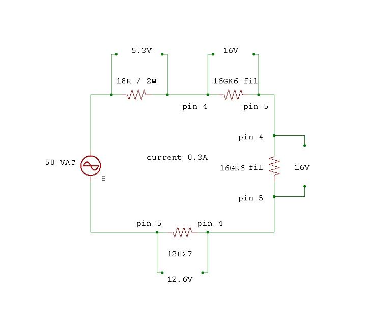

Well, I would like to try a variant on the Fleabreeze amplifier.
A full wave tube rectifier(CV574),16GK6's at the output, and the 12BZ7 as input tube (I like their tone a lot, it rape my mind)
So, by first thing I go and check that the filament current where the same for the three tubes, in order to use the the series filament string ( I already got a Power Tx with a 50V secondary)
Obviously there is a separate 6.3V secondary for the rectifier
I'd Done the right math, or there is something missing?
Thanks for any guidance..

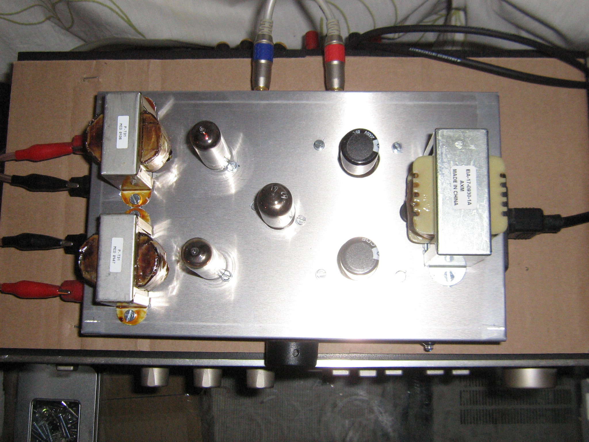

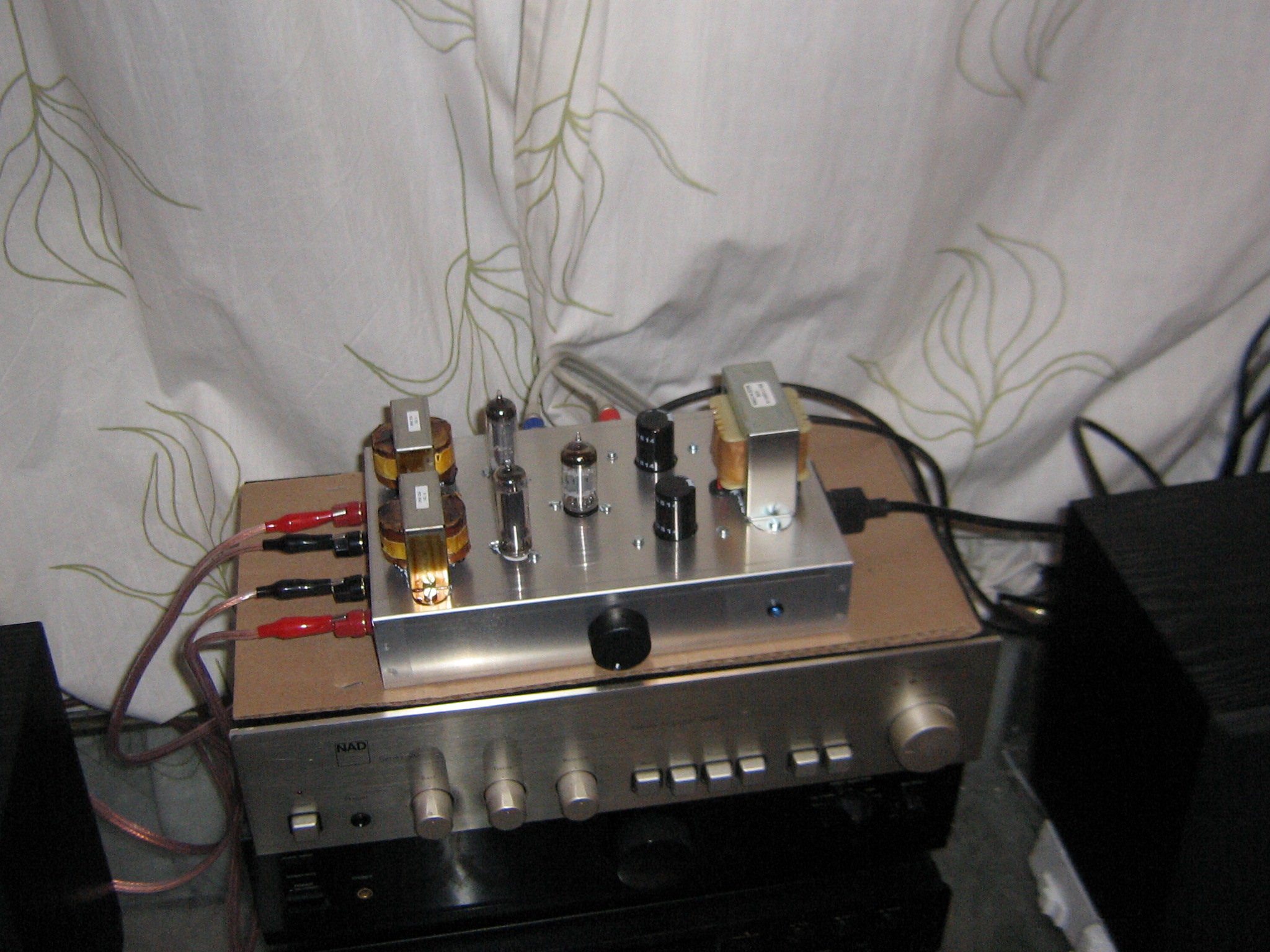

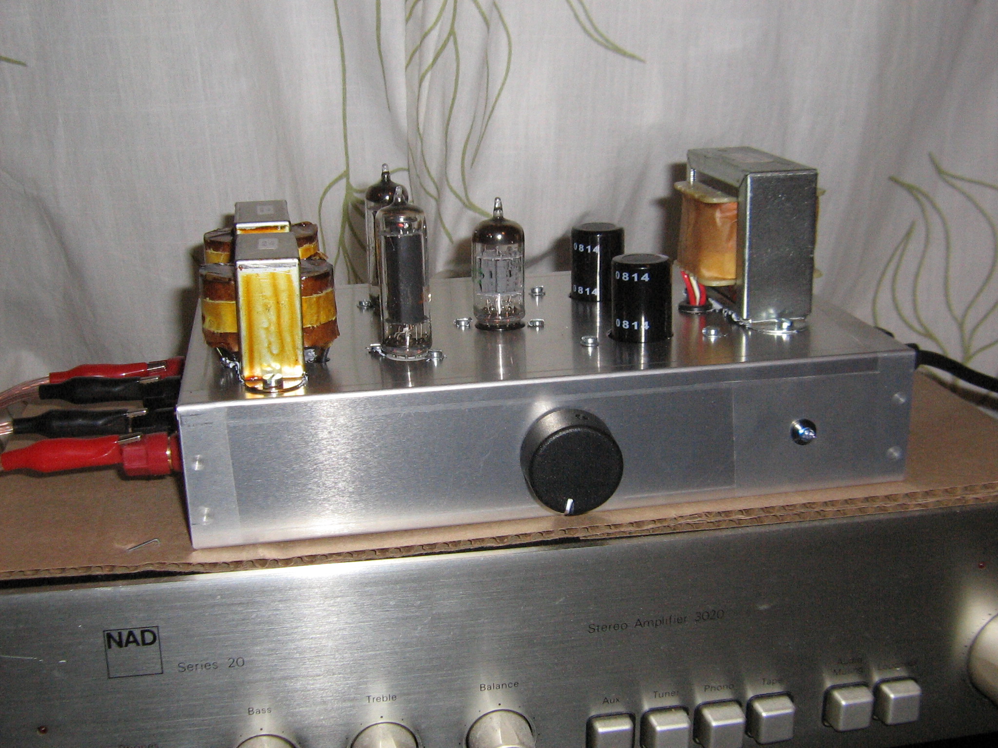

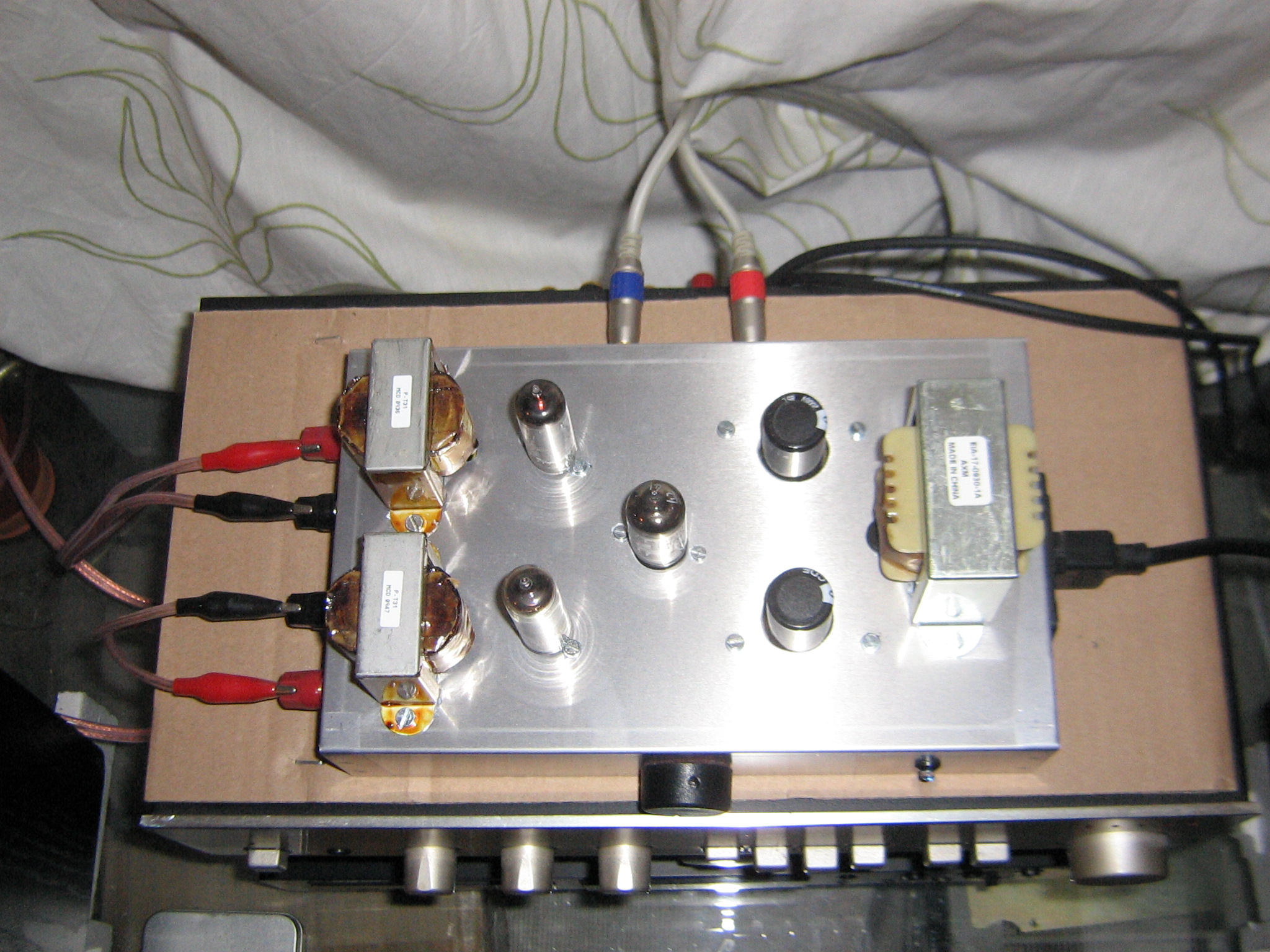

Fleabreeze completed
Finally completed and as the original design.
250K pot (thanks to Littlerick) permits an usable turn range of the volume knob.

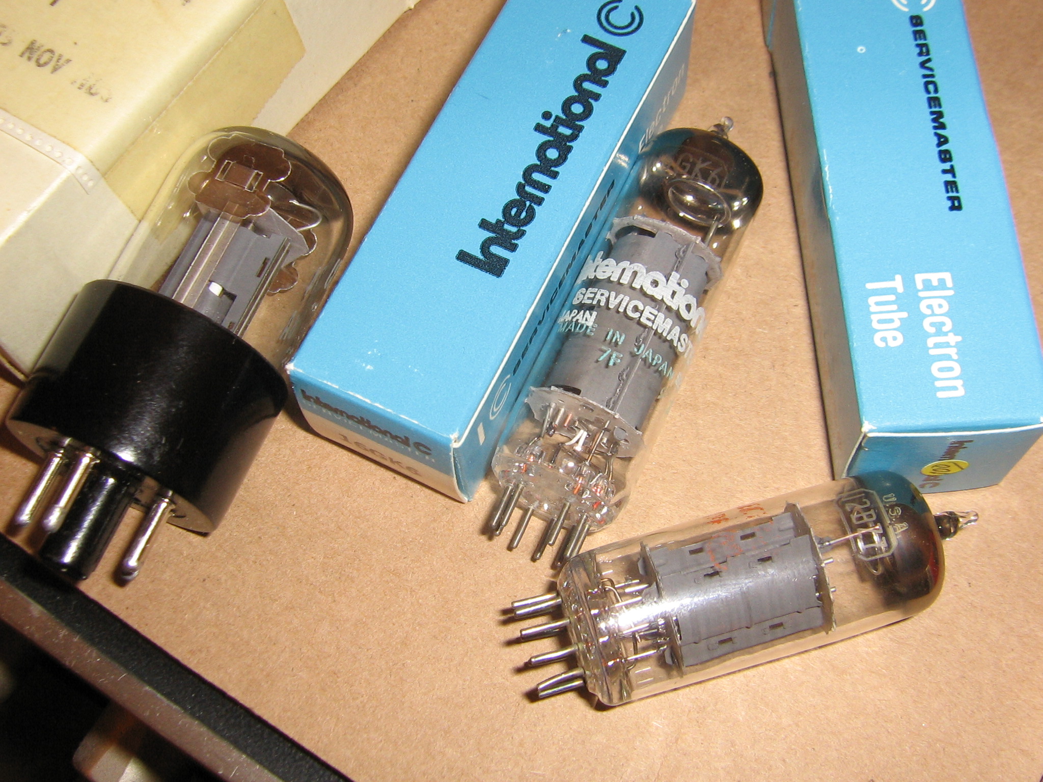

First tube now is a HP 5751, as the original design call for.
A really good sounding little amplifier.that dare to drive 84 dB, two way ,4 ohm mini bookshelf speakers, not only high efficiency single drivers.
