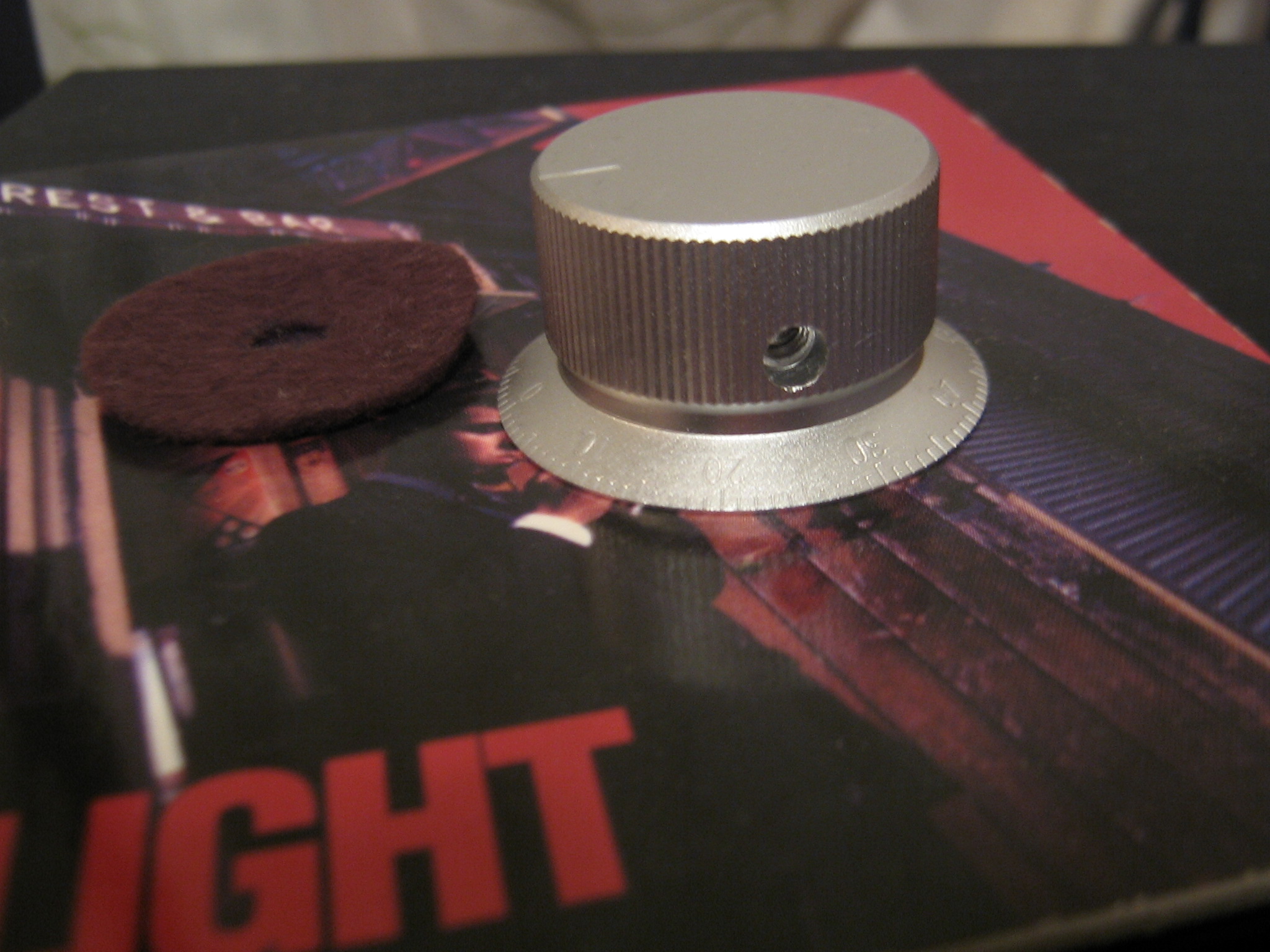

Once the tweaking is finished, I'll paint the chassis (Hammond 1444-16) with this lovely mate grey primer. And change the volume knob for this one:
Maybe it is better to keep this one as is, original. I'm thinking to repeat the concept (single secondary, series string filaments) but using better transformers, a couple of 16GK6 japanese tubes that I own, full wave rectifier 🙂 and cathode bias input stage

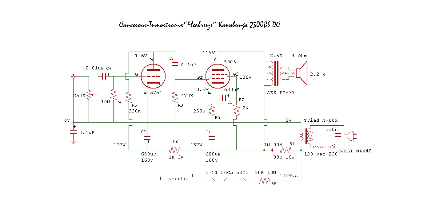

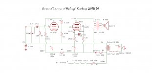

How did you create this schematic ? EAGLE uses dots where signals meet, lack of dots means the signals just cross one another. You somehow managed to create a schematic where some signals are missing dots while others have them.
Hi, That's not Eagle. Now I think It's clear where the signal jumps

Thanks for the info. I'm waiting for a couple of JAN5751 that are on arrival, so the amp will become exactly as referred on the original schem.
I draw the schem using this one:

The right tubes are in the family 5751/12AX7/12BZ7, and this is coherent with the original design. I was judging too fast, based in a faulty 12BZ7 , that the 12AT7 were better. Now the amp was provided with another BZ7 sample, and is singing like the angels! I ordered a couple of JAN5751 from an Ebayer in order to have the amp fully as designed to
You need a 250K pot. I'm providing for that.
Yes, as Planet 10 said, the socket is 7 pin. I used sockets that mount from the underside and solder most pieces directly to the sockets
Note that I've posted an updated schema with the measured voltages for various circuit nodes.

Ah, it looks incredibly like Eagle. You might want to give it a try (if anything, it appears to be consistent when drawing connections in schematic mode), it's free and tubes library is also avaliable for download on their webpage in Download section.
Thanks! I'll try it. I've get downloaded LTSpice as well, but I 've not figured yet how to make it work. By now I've learned how to use the Variac 🙂
