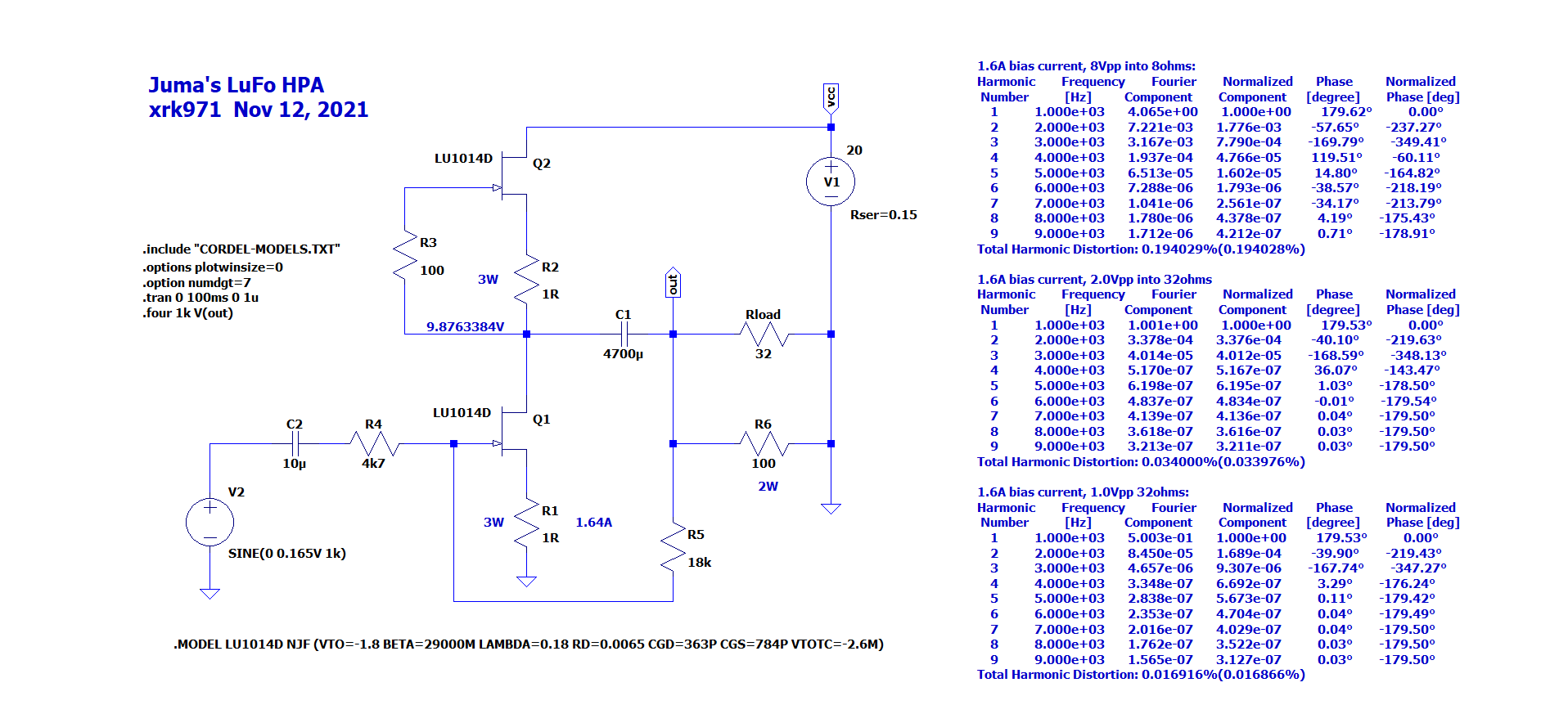

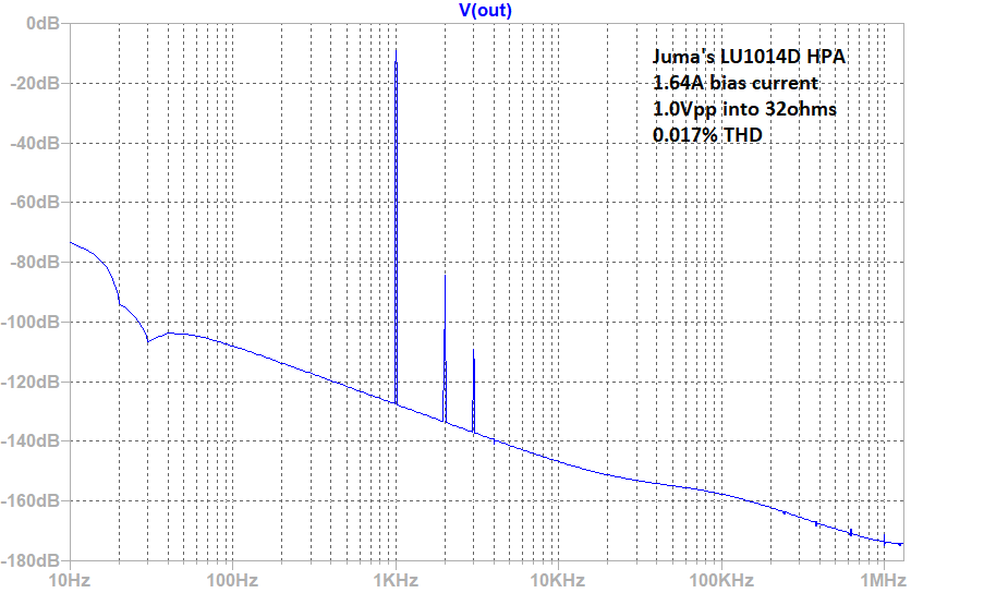

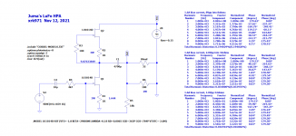

Here is Juma's LU1014D HPA that Adason was building in LTspice. Seems to work well as a headphoneamp with a pretty heavy 1.64A bias current. Changing the source resistorsto larger values (they need to be the same value though) will drop the bias current. 10R will get about 175mA, for example. One thing that is strange is that the gain changes with the load. This is not good for speakers or headphones that have variable impedance - it will cause a non-flat frequency response. For example, at 8ohms, the peak output is about 750mVpp whereas the output was 1000mVpp for 32ohms. This is with 330mVpp input.
Schematic:
attachment.php
FFT for 1.0Vpp into 32ohms:
attachment.php
Looks like a nice harmonic profile.
Schematic:

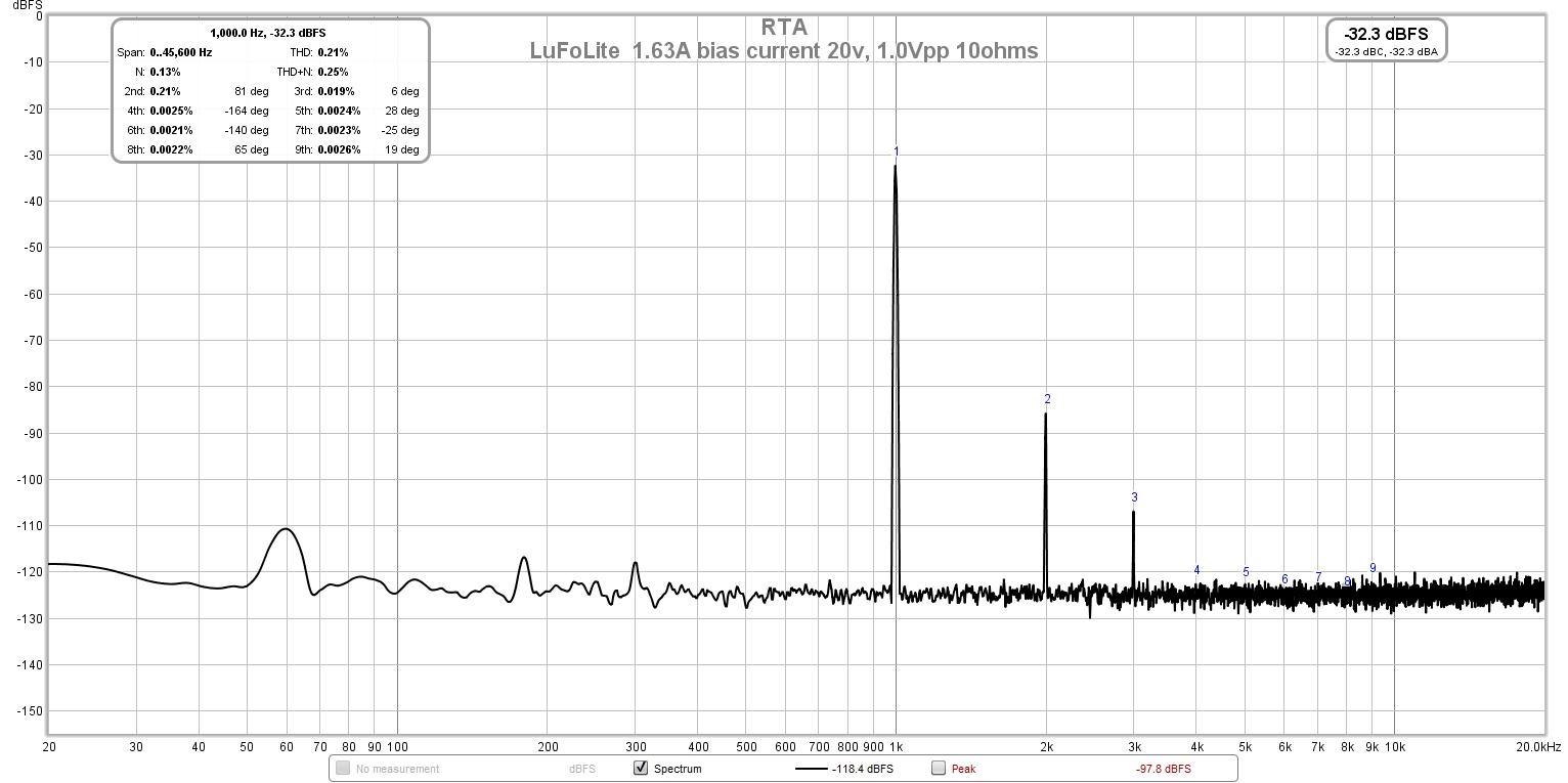

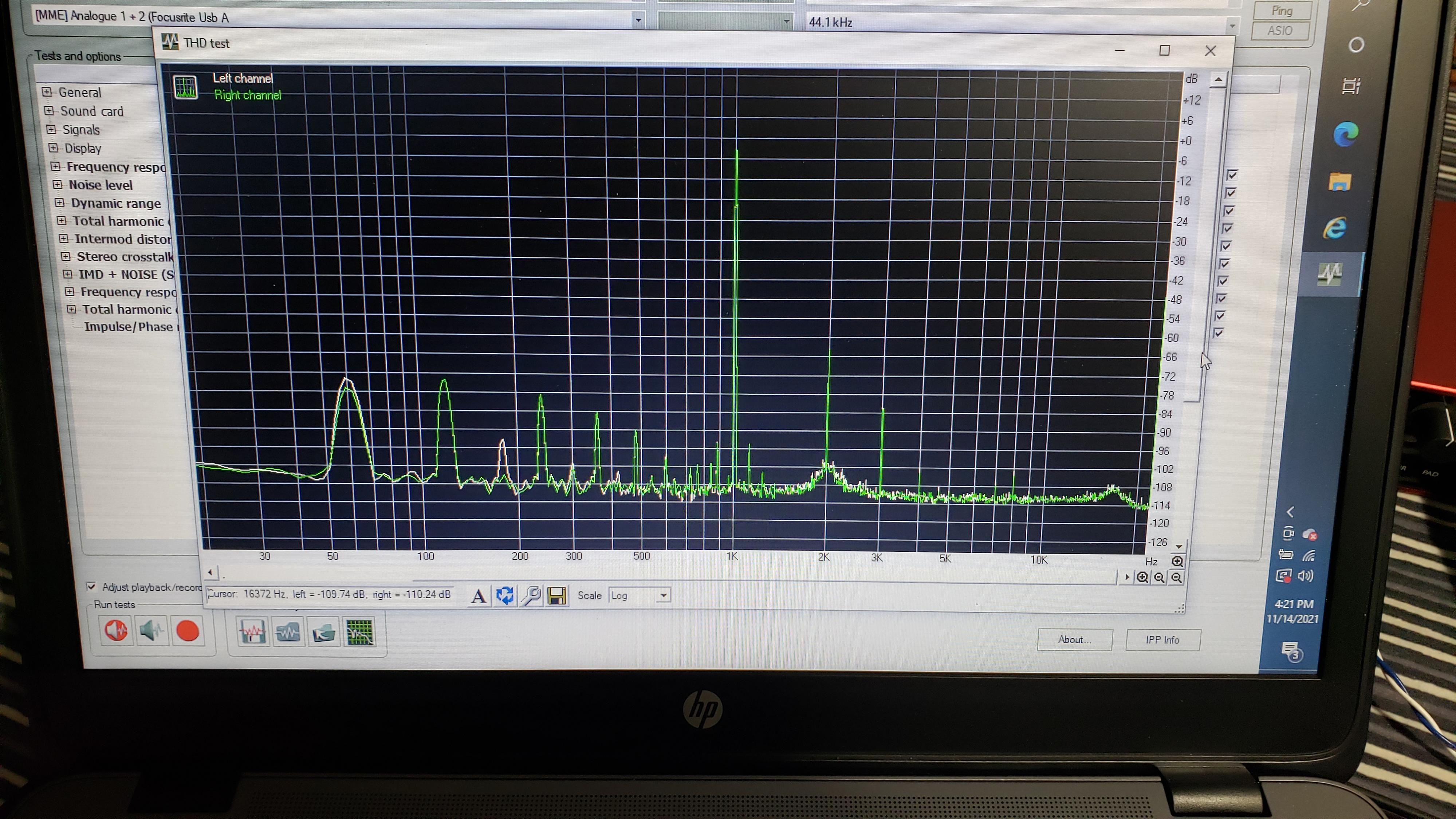

I got this measured.
Why do you say resistors needs to be of same value, just curious. Upper current source can be independently set.
Its interesting that feedback can cause non-flat response with variable resistance load, weird.
Thanks for doing the simulation.
Few comments. Juma specifued 100ohm resistor, parallel to speaker, as 2watts. There is absolutely no voltage on output, no current through that resistor, no need for wattage.
On the other hand, those 1-2ohm resitors he specified for 2 watts, need to be 20watts.

Hi Adason,
In my simulations, when I made those resistors non equal, the output clipped and was very asymmetric. Thanks for making measurements. The THD is quite low. Maybe the parallel resistor to the load is to ensure that it never drops below 200ohms in which case something strange happens?
How does it sound to you? Is there any strange frequency response anomaly as headphones in general don’t have flat impedance curves (except for planar magnetic or AMTs).
