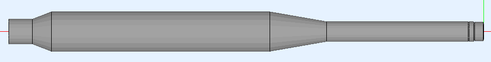

Here's a basic attempt to reproduce the B&K correction curves for the 4135 capsule (plus 2619 preamplifier) without its protection grid.
First, some images of the model (axisymmetric). Full view:
Close-up of capsule (side view):
Close-up showing the diaphragm:
Some of the dimensions are just eyeballed as the dimensional drawings don't specify everything (the exact unsupported diaphragm diameter is not given, for example).
As expected, using a weighting function to account for the nonuniform diaphragm motion is important. Here are the results with no weighting (i.e. assuming uniform axial motion):
Not a great match.
At least at lower frequencies (where the pressure is relatively uniform), I figured it was probably reasonable to assume a catenary shape for the diaphragm. According to the cutaway drawings I can find, the backplate doesn't quite extend to the edge of the diaphragm, so I further reduced the weighting of the outermost segment. Here are the results using this modified catenary weighting:
Much better, but not quite perfect. Nonuniform pressure over the diaphragm surface at high frequencies probably explains at least some of the remaining error.
Not a great match.

Wow, actually quite good, I'd say. Given that the actuator response won't be exactly equal to the pressure response. I believe I read that their correction curve takes that into account (by being derived by comparing reciprocity measurement to actuator response)
That's correct according to the B&K Microphone Handbook (be1447). However, it also states that the actuator correction is insignificant for microphones smaller than 1/2" due to their high diaphragm impedance. A few actuator correction curves for 1" and 1/2" capsules are given, but they only go up to 20kHz. I wonder if the difference is still insignificant at 100kHz for a 1/4" capsule.I believe I read that their correction curve takes that into account
