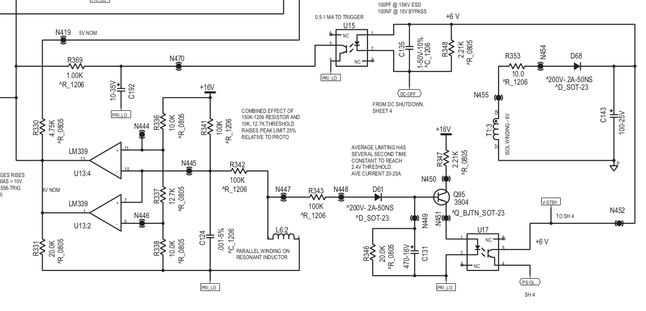

EDIT: the "similar threads" below actually suggested something that is probably close to my idea QCS PLX series:
http://bee.mif.pg.gda.pl/ciasteczkowypotwor/SM_scena/QSC/QSC_PLX_Series_Service_Manual.pdf

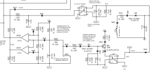

Look at the schematic for the PSU and locate the resonant inductor L6. There is a "sense-vinding" on L6 to trigger STBY.
Kind regards TroelsM
Schematic of the LLC resonant converter, based on a SOI HB power module... | Download Scientific Diagram
This hints the idea of measuring the current in the primary resonant circuit with a current transformer. There is no separate inductor so they do not use a measurement winding on a separate inductor but a dedicated current transformer.
I believe that MorbidFractal once more is right. The "burden resistor" on the measurement winding should be translated into a resistance in the line where you wish to measure the current and that affects your resonance in the LLC-circuit. I am sure MorbidFractal is much better in such principles than I.
The gain with your idea would be to avoid a dedicated current transformer and instead use an extra measurement winding on an existing inductor, if it works. A small economical gain but nevertheless a gain.

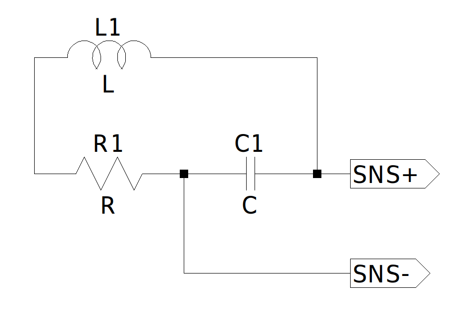

It's not something I have looked very hard at but there is a lossless sensing mechanism found in VRMs where a current sense signal is extracted directly from the phase buck inductor using an RC network. It is meant to recreate a facsimile of the voltage across the ESR of the inductor across the capacitor by selection of circuit time constants.
If your sense winding reproduces the voltage across the primary in a faithful manner then it would seem to be possible to implement a similar scheme. This would appear to be what QCS has done and what you are proposing. Nominally the secondary is only lightly loaded and you presumably could introduce gain based on turns ratio.
I would be inclined to read up on VRM lossless current sensing for further information and sums.
Maybe a bit late but it might be helpful for others:
Behringer implemented a peak current detecting circuit in LLC SMPS of the B815neo, B812neo and B912neo series. I do not attach the schematics because they mention copyright, but you can easily find them for the Behringer B912neo.
The circuit looks very similar to the one of QSC, except Berhinger added a latch circuit that is triggered and prevents the PWM generator from starting unless you did a full power cycle of the unit.
Therefore they omitted the average overcurrent protection (at least I could not see any).
