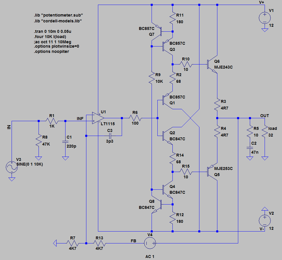

Oh all right then...
"I cant get MJE243/253, can i use..."
I've used BD139/140 and MJE15032/3 with this circuit as well. The usual devices used as driver transistors in power amplifiers should work.
"BC847/857 are surface mount, can i use..."
I've used BC546/556 during prototyping. Any good small signal transistor should work.
"I cant get LT1115, can i use..."
I only used that in the simulator. I used OPA2134 in my actual build. Any opamp should work but a FET input one means no appreciable offset voltage. C3 wasn't needed with the OPA2134.
If you wanna use a bipolar opamp you'll probably need a capacitor after R7.
My build also has a 3u3 Wima MKS2 input coupling capacitor "just in case".
"How do I alter the bias current?"
Adjust either R11/R12 or R2/R14. As shown should give about 40mA of bias, which will run most 32 ohm headphones in Class A.
"What about....."
This is DIY Audio... build it on breadboard and experiment 😉
In addition, you can connect the collectors of Q1 and Q2 to the emitters of Q5 and Q6 respectively, which lowers Q1/Q2's dissipation and improves THD a bit too according to LTSPICE.
I couldn't actually hear any difference, so I used this arrangement simply because it lowered the heat dissipated in Q1/Q2.

It should stabilize (thermally). Those extra two transistors +diodes (near Q5-6)
will absolutely lock the class A dissipation of Q5-6 and make the output
short circuit proof.

You could explicitly set the junction temperatures in simulation and find out whether an increase in driver temperature results in an increase or decrease in output stage bias current (in simulation). You could try this for various different choices of device types (.MODELs) from different semiconductor vendors, to reduce the possibility of incorrect conclusions resulting from bad model parameters. For example I find wide variability in the simulation models of BD139 from different semi companies.
Sure, but in fact I do not need simulation to be able to broadly predict the effects of individual temperature changes: if the T° of one or both drivers increases, it will decrease the quiescent current, and vice-versa for the OP's.
The real difficulty is to understand the complete system with its interaction of self- and induced-heatings, the thermal resistance of the various devices and their mounting, and the thermal resistance and inertia of the heatsink.
The whole think seems to be stable without emitter resistances, but it goes somewhat against common sense, and I am reluctant to draw general conclusions from two examples

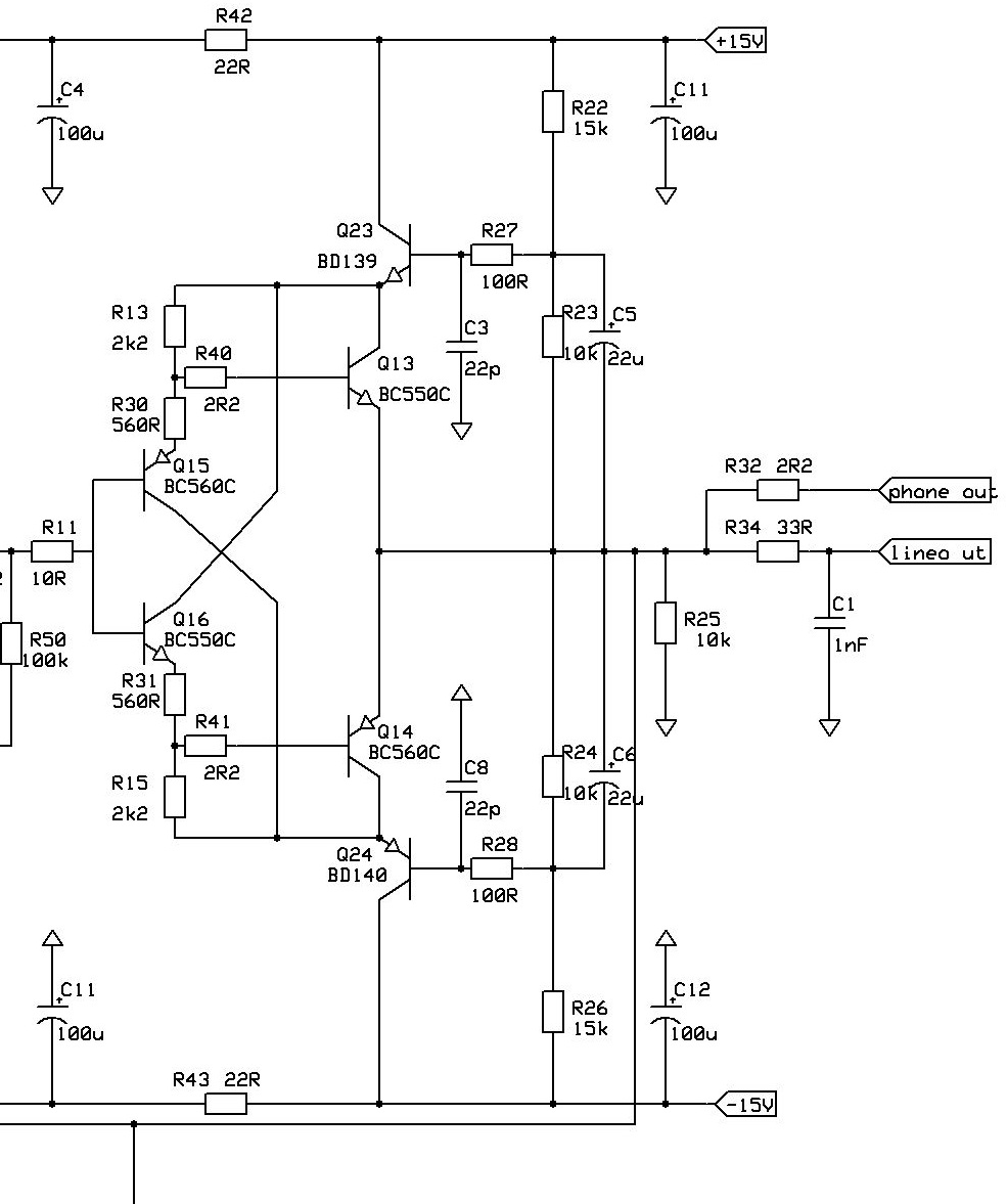

This one is used in my GainWire preamp with no emitter resistance and is thermally stable, just thermally connected Q15-Q13 and Q16-Q15.

why is this diamond buffer stable without emitter resistors whereas the traditional EF with bias spreader for thermal feedback is not ???
I haven't found satisfactory theoretical explanations so far: I can just see that in reality, it seems to work.
There is certainly more than just compensation at work here, because as we all know, with discretes, just a bias spreader and no emitter resistors is a very fast path towards molten silicon.
The very high quiescent dissipation in the drivers seems to be a (big) part of the answer as to why, but I do not see exactly in which way.
Anyway, the provisional prototype I experimented was so successful that I am currently casting it into something permanent, with a case, supplies, controls and connectors.
Maybe I am too optimistic.... future will tell

Regardless, we can always design a Vbe multiplier / bias spreader to have enough temperature compensation. So why do we still need emitter resistors ?
Is it that the junction temperature of the power device still changes too rapidly for the thermal feedback loop to operate in time ? I don't think this is it.
AND
did you / can you try placing the drivers not on the heatsink but on top of the power devices so that they sense the temperature of the power device directly ? - they would run hotter of course but are essentially still being cooled by the heatsink via a 'hot' washer !
That is what happens when the thermal feedback includes the main heatsink. The response does lag the action by a significant amount. This is why the thermaltrack devices are such a welcome advance. If you use those diodes as temperature sensors you will be closer to the thermal event. Why not start there?
-Chris
The high driver current is the key, as they are pre-empting any temperature rise in the output stage. I suspect that if you did the same in a conventional bias spreader and made it into a significant heat source, it would work the same.
I think that this technique would fall down if the output transistors power dissipation was considerably higher than the bias spreader though, but happy to be proved wrong.
