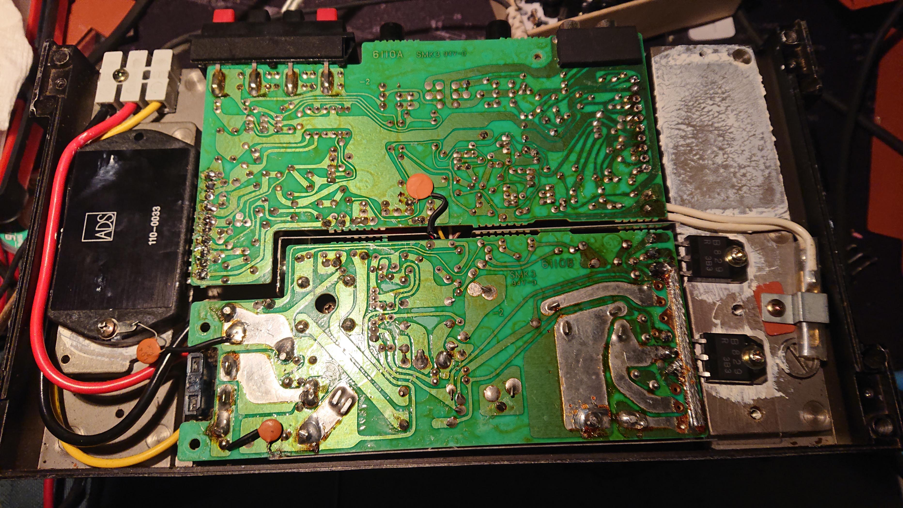

Hey everyone, new here. Ive got a couple amps I am using to teach myself how to repair them. One is an A/D/S power plate 80 and the other is a 120. They both use these STK (80 is STK082g and the 120 is STK086g) output ICs. I have made some progress with them, but I want to just focus on the 80 right now. The 120 seems to be of similar construction, so hopefully learning one will lead to knowledge to fix the other. I have read up a bit on bcae1s website to get a better understanding, but since we have output ICs here, Im a little in the dark.
So, here is the story on the 80 and what I have found and done. Initial power up, no current draw to speak of. Replace two transistors (one had a hole in it) with the part number B829. Attempt to power up again. Massive hard 20A current spike. So, shut power off, desolder both ICs and current is fine when powering up the power supply board. Resolder ICs one at a time and find teh defective one. Removed that and left the (what I presume to be good) one in. Power it back up. massive draw gone, but what I assume is protection mode is present. Audio is cutting in and out of that channel every second or so. So I desolder what I *think* are the rail voltage wires coming off of the bridge rectifier and the protection mode seems to be gone. No more blip on the current meter on the power supply. So, I wait for the replacement STK to arrive and install it. Now both channels are doing the same thing, so we have some progress. Measure voltage across the output from the bridge rectifier and I am getting about +/-33Vdc. Seems normal?
Just for fun, I desoldered the original IC just to be sure it wasnt the culprit and I still have the same issue. Any idea what I should check next? Thanks for any help!

Look up the datasheet for the modules and measure the resistance from the output terminals to the rail supply terminals. Do any read near 0 ohms?
Thanks for the feedback. Here is a pic of the 80. My focus is on the 80 and I hope it will teach me to fix the 120 based on the identical symptoms. Yes, I know that identical symptoms do not mean identical causation. But Im learning here.

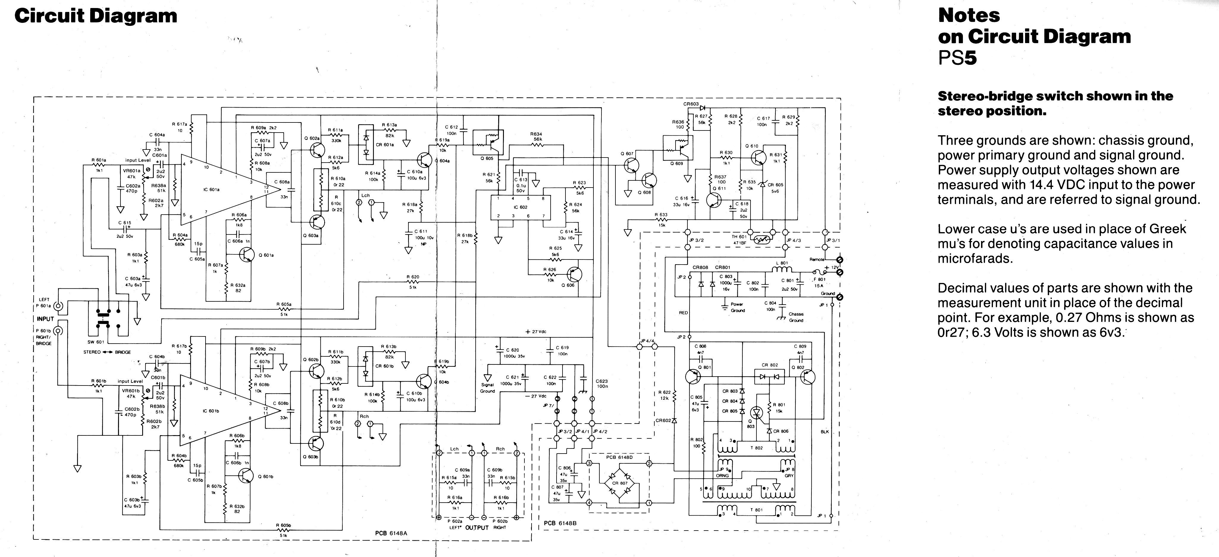

Ok, well im not going to cut them open just yet. I did measure what I think to be the output and rail voltage input resistance at pins 7 and 11 on three ICs. One known bad, one suspected good, and one Unk. All have about 21MOhm between pins 11 and 7. Now, I am new to this, but I suspect I have the right pins. Here is a link to the data sheet. Also, here is a schematic I found on this website that seems very similar to this circuit design.
STK082G datasheet
https://www.diyaudio.com/forums/att...98069-ads-power-plate-120-repair-adsps501-png

6/7 is 3 Ohms on the known bad one. known good one is open.
But still, these are both removed from the amp. Amp still acts the same with known good one (well, at least suspected known good) installed.
