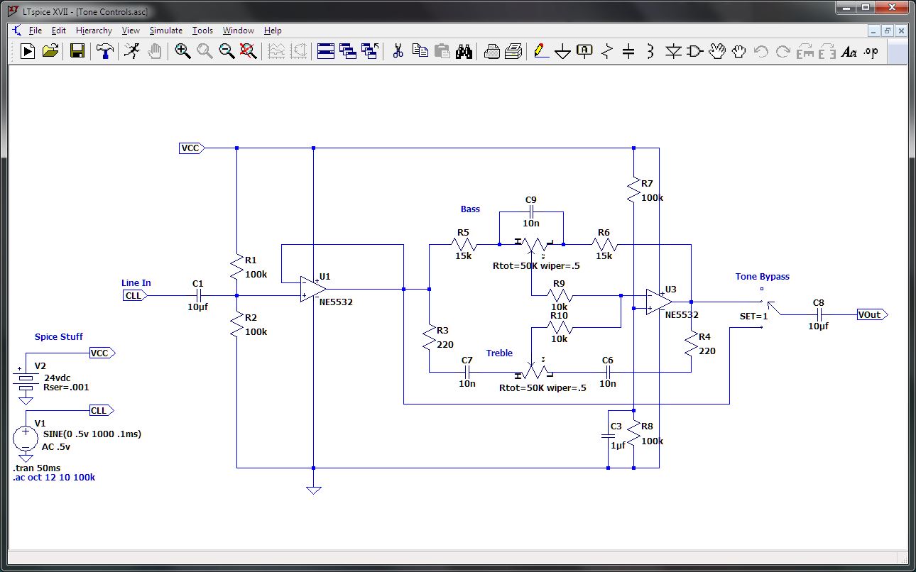

The third is a pretty standard tone control design.

Tone:
The Baxandall circuit is inverting, why not use the 2nd opamp to re-invert the signal, so that both are operating with zero common-mode distortion, and the phase is correct on the output?
Its recommended to keep bipolar bias currents out of potentiometers to reduce noise when turning the pot - if the track is at all scratchy it interrupts the bias to the opamp and causes large output voltage swings. AC coupling the pot will reduce scratchiness to the amplitude of the signal itself, not the supply rails.
JFET or CMOS opamps have so little input current that the input capacitance smoothes the scratchiness away without special measures.
Hope this gives you some pointers for some of the less commonly understood points of design for these circuits(!) I recommend the works of Douglas Self for learning many of these subtler points, esp. "Small Signal Audio Design" and "Electronics for Vinyl"

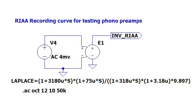

BTW the LTSpice directive is hard to copy/paste from an image.
Ahh, yes, I imagine it would be. Sorry.
The ASC file for it is attached...
This generates a recording side curve, which is what is on the Vinyl.
To use it, include it into your schematic, connect it to your input and tune the pre-amp output to be flat.

Ah, that's useful, haven't played with LAPLACE before. Used it with one of my RIAA circuits, got this nice set of response graphs:
"emf" in magenta is the output of the inverse RIAA, "preamp_input" in red is with the resistance/inductance and preamp input load applied to this showing the modest peaking and ultrasonic roll-off. green "output" is after my RIAA amp circuit, and then blue "rumble" is after the subsequent 4 pole subsonic filter.
( I modelled 400 ohms and 500mH for the cartridge into 47k || 200pF - it shows the cartridge reactance is quite a factor in the accuracy of the response, being about 1dB of peaking )
Thanks for sharing the Laplace directive usage too.

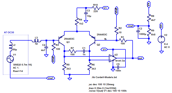

I can share one MC gain stage that I was playing with a long time ago, it was featured in a AudioExpress mag article a few years ago.
iirc it used mpsa12 and its complement mpsa62 for the o/p, I sub'd those because I did not have or know how to make a model for them.

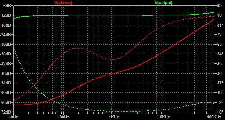

Here are the results from my circuit in the first post. Gotta love that nice straight green output line. It tells me that the recording and playback curves are near perfectly complimentary.
My RIAA simulation is based on this approach, which separates out all the zeroes and poles into separate RC sections, so in theory its a perfect match to the inverse transform (ignoring opamp non-idealities and compensation components):
Followed by a four-pole Butterworth rumble filter using Sallen Key stages.

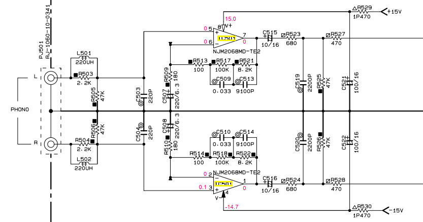

If you fancy a single-chip design, this is what has been gracing Yamaha's more down to earth integrated amps for years:
attachment.php
This is likely to be as low noise as they typically come for MM, short of going for a low-noise FET input stage. (This opamp seems to be at least on par with an NE5534A in the voltage noise department, and possibly current noise as well given the moderate input bias current spec.) Knowing the NJM2068's somewhat limited output driving abilities (less robust than the NE5532's), I would imagine that distortion performance could be improved by including a discrete Class A buffer stage in the loop, headphone amp style. With 280 ohms worst-case, it doesn't have to be super-duper powerful, a pair of BC639/640 (or 2N5551/5401) at ~5 mA or so seems easily sufficient. (You can go AB with some high-beta transistors if you insist, maybe BC550/560 or KSC1845/KSA992.) One might even consider going single-ended for simplicity's sake. I could draw up a schematic later if you're interested.

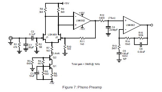

Many possibilities, I posted this jfet composite in another thread, it is from the LSK489 application note. I did discover that I think the 75uS comps are incorrect, C4 should be 22n. If you find lsk489 too expensive you could sub low cost jfets. A DC servo could be used to eliminate C5 and o/p ac coupling cap.

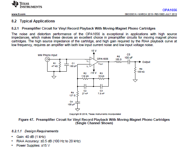

Even the new TI OPA1656 can be used. I called it the new NE5532
