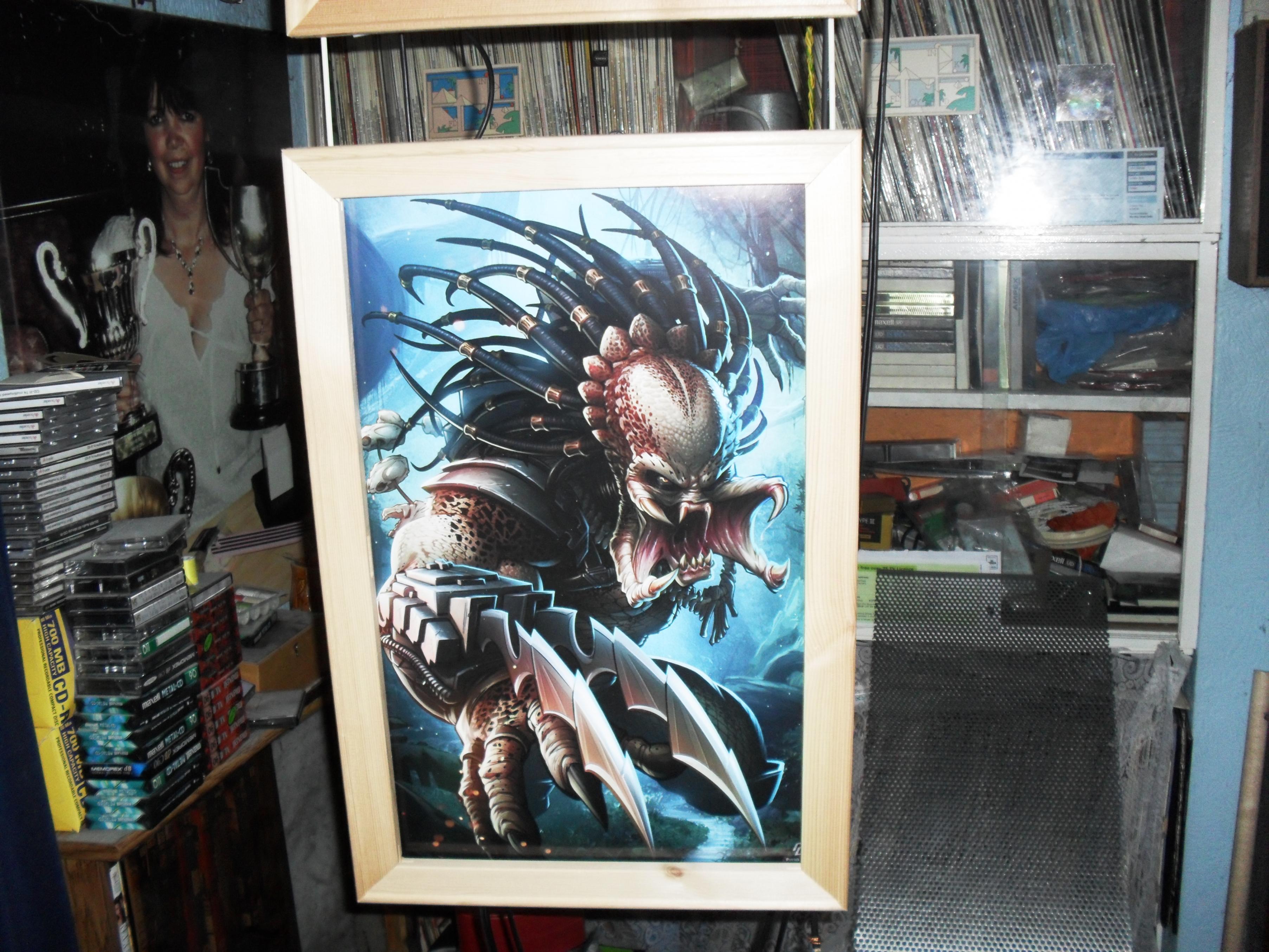

sure, saran wrap. Do a search here, there’s lots of banter about that.
