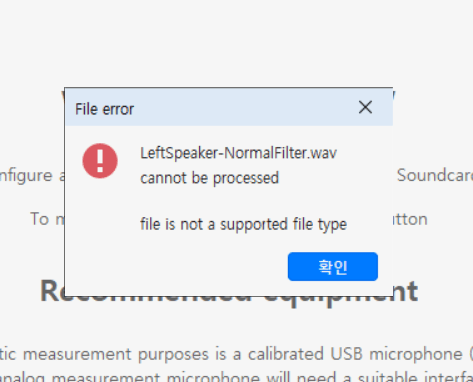

Thanks. Something i'm missing...
I tried like this on CMD.
C:\Room Correction\drc-3.2.3\sample\sox-14.3.2>sox LeftSpeaker-NormalFilter.pcm -t f32 -r 48000 -c 1 LeftSpeaker-NormalFilter.wav
sox FAIL formats: no handler for file extension `pcm'
What I was trying to do was convert a pcm filter file generated by drc to a WAV file.

Sorry, try the following. Had the destination type wrong, it should be "-t wav"
sox -t f32 -r 48000 -c 1 filename.pcm -t wav -r 48000 -c 1 filename.wav
Verify in REW that it is a 32-bit float wav.

@emailtim Thanks. that works. Now i can bring wav file into REW.
@fluid Yes. I downloaed GMAD's file.
And that makes PCM file. But don't make wav file for me.

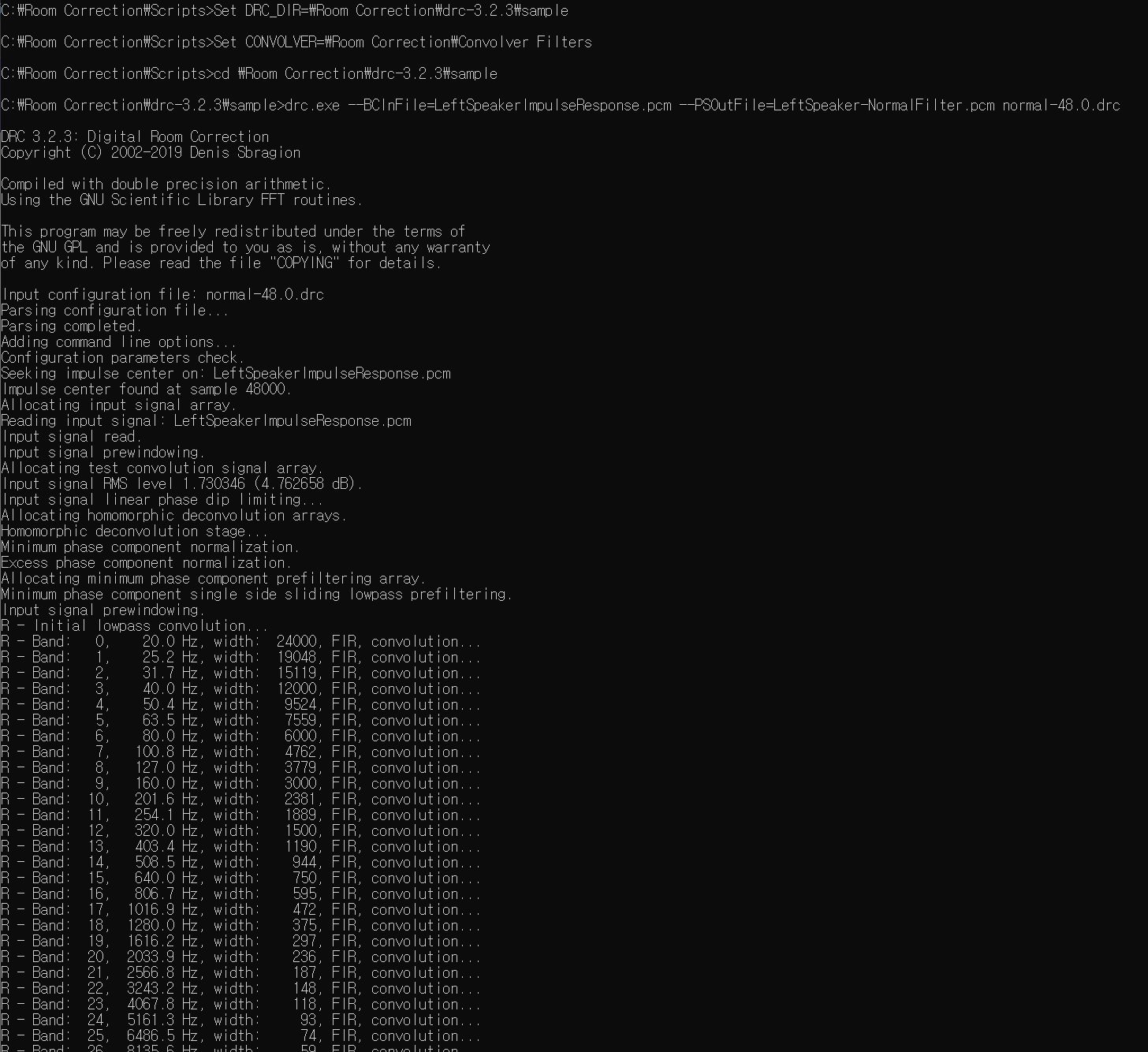

In Script info (Script name is NormalFilter) (I just changed 44.1 to 48.0)
Set DRC_DIR=\Room Correction\drc-3.2.3\sample
Set CONVOLVER=\Room Correction\Convolver Filters
cd %DRC_DIR%
drc.exe --BCInFile=LeftSpeakerImpulseResponse.pcm --PSOutFile=LeftSpeaker-NormalFilter.pcm normal-48.0.drc
pause
drc.exe --BCInFile=RightSpeakerImpulseResponse.pcm --PSOutFile=RightSpeaker-NormalFilter.pcm normal-48.0.drc
pause
sox.exe -t raw -e float -b 32 -r 48000 -c 1 LeftSpeaker-NormalFilter.pcm -e signed -t wavpcm LeftSpeaker-NormalFilter.wav
sox.exe -t raw -e float -b 32 -r 48000 -c 1 RightSpeaker-NormalFilter.pcm -e signed -t wavpcm RightSpeaker-NormalFilter.wav
sox.exe -M LeftSpeaker-NormalFilter.wav RightSpeaker-NormalFilter.wav -e signed -t wavpcm NormalFilter.wav
move /y NormalFilter.wav "%CONVOLVER%
del "LeftSpeaker-NormalFilter.pcm"
del "RightSpeaker-NormalFilter.pcm"
del "LeftSpeaker-NormalFilter.wav"
del "RightSpeaker-NormalFilter.wav"

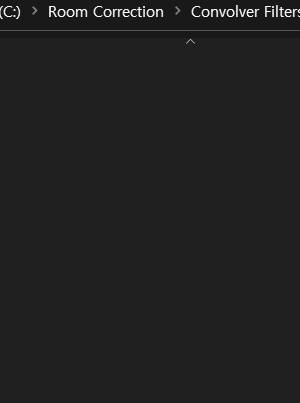

@emailtim As you said, I wrote " afterwards, but nothing changed.
@emailtim I wanted to test by changing the value of the variable directly, so I wanted to check it in REW. Because all the wav files that were created when using Align2 worked normally... I wanted to make a wider adjustment.
@fluid
Nothing in here
@fluid
Nothing in here

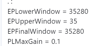

PLMaxGain = 0.1 is Almosy phase correct only right?
If i set 0, it doesnt work??
I want change only Phase...

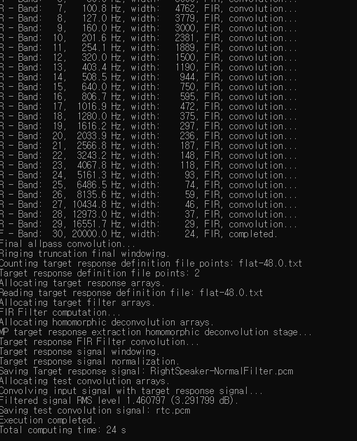

@dingdong3 ,
I haven't tried using setting it that low before.
Are you using the "Test Convolution" output feature ?
If not, you can specify the "Test Convolution" TCOutFile output file, convert it to .wav in your script and then drag and drop it into REW for analysis.
This allows you to compare your input sweep against the applied solution without running it through your convolution engine.
It is a much faster way to experiment with DRC-FIR settings in addition to looking at the (un-applied) correction file in REW.
Test Convolution Doc
