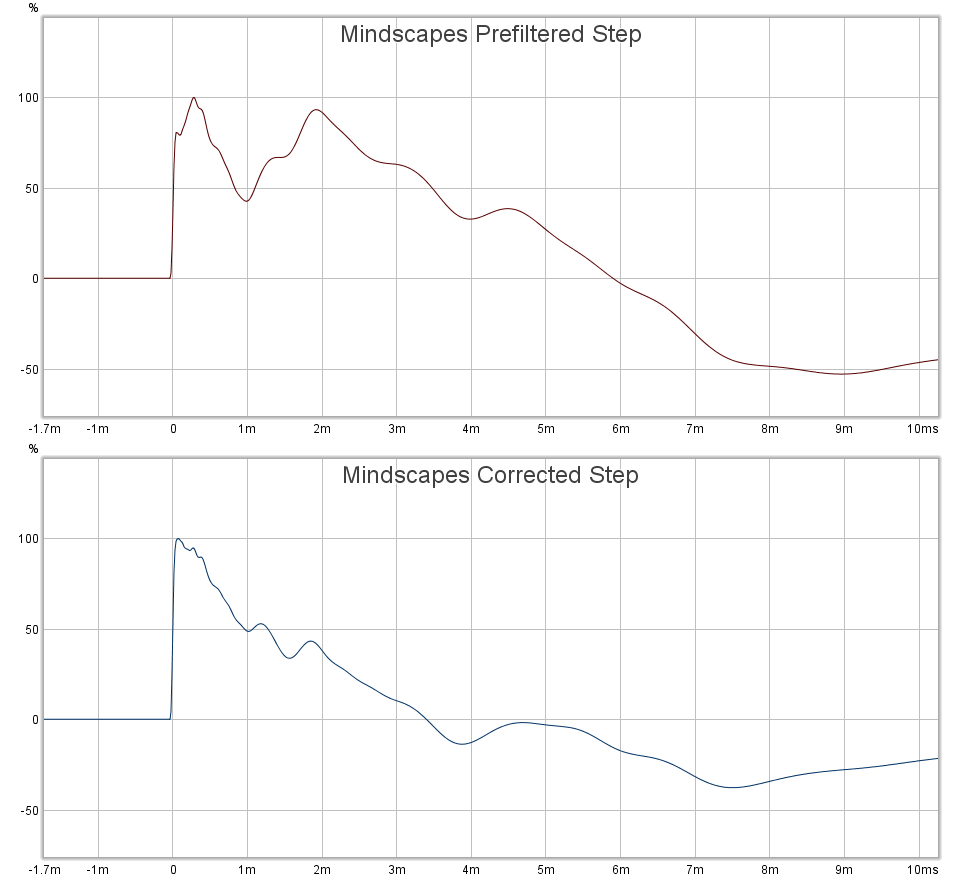

Thanks! I'm talking about convolved results indeed! Take a look. Not the best step in any of the three cases but you can see the minimal filter does correct mids and highs alignment while the psycho remains pretty similar to the uncorrected impulse:
Here i show the filters impulses and their phase correction and after that the step and impulse of the test convolutions.
As you can see the minimal filter corrects 360 degrees of rotation more compared to the psycho filter and i suspect this align the step. If i do a 1 ms blackman window on the uncorrected impulse and the two corrected one, the minimal filter has a linear line while the psycho one shows 580 degrees of rotation from 0 at 20000 hz. So it seems it doesn't fully linearize the direct sound. Is there a way to increase the phase flattening in the config, specifically for higher frequencies? In the low end the phase correction seem pretty similar. I've tried longer windows and it didn't help, could this be because of some other parameter i have to play with?
Or worded differently: what does the standard config that the psycho doesn't to align the drivers? And more importantly, does it matter and should i even bother given that it sounds better aniway?
I'm far from an expert on this subject, but minimum phase filters only correct for frequency response. To correct for phase, i.e. to remove excess phase, you need a linear filter.

Here is your prefiltered step response before and after convolution with the (1/3 oct) correction filter.

Mindscapes,
Oh, i missed the part about the prefiltered impulse, i was convolving it with the original impulse, my bad!
So basically what i'm seeing in my graph is the room wrecking havock, and drc with the standard config making the graph prettier is in reality overcorrecting everything, that's why it sounded worse! All clear now 😎😎
I think that is a bit of an over simplification. gmad's pre-filtering does a good job of removing the room contribution. The correction will work on the measurement it is fed. If this is not right the correction won't be an improvement. Getting the right measurement to feed in does take some trial and error.Oh, i missed the part about the prefiltered impulse, i was convolving it with the original impulse, my bad!

To make another comparison try the prefilter with the minimal to see what the differences are.
The mid frequency correction window length is very important and the window exponent parameter is very sensitive, there is a big difference between 0.9 and 0.95 even if the value does not seem to have changed very much. By putting a pause at the end of the batch script you can scroll back through the command output to see what the window lengths that were used based on the input parameters.

You misunderstood my comment, the graph i posted were obtained convolving the filter with my basic response.
I understand that the prefilter use a frequency dependent windows to remove the room and correct basically only the speaker.
My comment was referring to the fact it didn't occur to me that to see the real effects all i had to do was convolving the filter with the prefiltered impulse.
From the difference you can notice between the step i posted (obtained by the operation in rew basic response*final filter) and the graph gmad posted (same but with the prefiltered response*final filter) i understood that the room has a big impact, otherwise the graphs obtained with the basic response will be more similar to the ones obtained with the prefiltered. The more your speakers are well positioned and the room well treated the more the graph should be similar, even if in practive they will never be exactly the same unless you are in an anechoic room.
It was pretty obvious in hindsight, given that i also already opened the prefiltered in rew various times to see how it changed when i modified something in the file, but i didn't think about it before gmad suggested it to me.
I also already tried what you say, to convolve the minimal with the prefiltered, and it confirm this, the minimal correct more for the room and applied on the prefiltered it overcorrects fr and gives worse results in the step. (even if it's not a completely fair comparison because the minimal doesn't start with a prefiltered response so it's guaranted it overcorrect the windowed one, but still.. i think to compare it more meaningfully you should compare the prefiltered*final filter with your basic impulse*minimal filter windowed with a similar resolution FDW in rew to the one you used in the prefilter)
I understood your comment, I think you have completely missed mine though.You misunderstood my comment...

I was responding to this "So basically what i'm seeing in my graph is the room wrecking havock, and drc with the standard config making the graph prettier is in reality overcorrecting everything, that's why it sounded worse! All clear now"
And the over simplification that because a stronger correction did not sound better to you meant it was overcorrected. The point I was trying to make is that you did not feed DRC the same input when processing and convolving the prefiltered with the minimal was not what I was suggesting at all.
I was suggesting that you use the prefiltered response as the input impulse to the minimal configuration so that the stronger correction was working on an input that was closer to speaker than room.
Comparing these will give you a better insight as to whether you actually like the psycho processing more than the minimal when both process the same measurement.

Yeah it seems it was i that misunderstood what you suggested. I will try it for fun, but i think the original config files are meant to work on the raw measured impulsed. Their windows and configuration are overkill on an already filtered impulse.
It's not that drc overcorrect, in fact with the minimal i think it's doing what is supposed to do: correct the room as the name of the software implies, or at least this is what i understand was the original intention of it's creator. It overcorrects in the sense that as specific a correction has a very narrow sweetspot, but it works there for sure. It's not that it gave bad results compared to listening without any correction, but it seems to me it's a different philosophy entirely compared to what gmad is doing with this procedure so it doesn't make a lot of sense feeding the raw impulse on settings that are optimized for another thing, correcting the room instead of the speakers.
It makes more sense to me to use the minimal settings as they are meant to be used and then window the results in rew, saving the impulse with the fdw used, and reimporting it. Then you can run a wavelet and see what the two different philosophies are doing to the direct sound and compare them objectively.
But who knows, maybe it will sound good, i will give it a try!
EDIT: Here's the comparison between uncorrected, minimal, and psycho that i suggest. uncorrected and minimal are windowed to 1/8 octave instead to account for the lesser resolution of rew compared to drc.
This is my point that DRC works on the the measurement that is fed into it. If measurements taken from different parts of your room vary significantly then any correction will be quite position dependent.
The more you make the correction about the speaker and less about the room will make the sound improved over a greater area.
