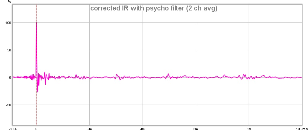

you posted this earlier, which is a very nice looking impulse. do you have a before impulse at your MLP?
My thread is filled with measurements 😉. Main difference would be visible after the main peak. More HF ringing (actually not ringing but irregular arrival of the HF of the array) in the first 0.4 ms.
The above plot looks like an older attempt. From the shape of it anyway. I've posted so many 🙂.

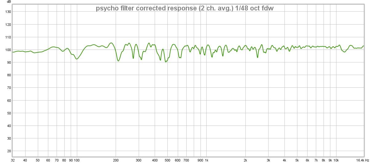

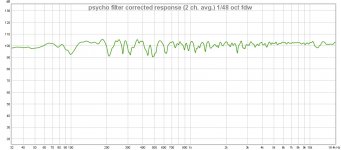

Here's a new EQ method that I'm pretty excited about (I got my "flat" response back) which uses erb windowing and the psychoacoustic target stage (two things I've always been interested in but have not had lasting luck with). Basically, what I'm doing is feeding the PT stage an uncorrected erb windowed impulse response. However, since the PT stage is designed to consider the entirety of the corrected response, we have to start out with an impulse response that is already windowed, and keep any subsequent windowing to a minimum. Unfortunately, this can't be done with a single config file, but I made a script that uses one config file to window the impulse response, and another to actually carry out the magnitude adjustment.
The result is a freq response in which a straight line connects the peaks (rather than the avg of the peaks and dips), and the dips remain deeper than usual. The idea is based on our perception of the timbre of waveforms which is related to their spectral envelope. In this case, the subjective timbral accuracy should be high within a window of time corresponding to the resolution of our ears, yet the filter is not very strong from a technical standpoint.
Subjectively speaking, the center image is sharp, the tone is good, and the sound remains "lively" overall. I'm particularly pleased with the quality of sustained sounds. Objectively, I'm impressed with how well the freq response holds up when viewed through a larger than usual (1/48 oct.) freq dependent window (attached graph), and how closely matched the reflection levels appear between the two channels.
In case anyone wants to try this, I''ve added a link to the necessary files in post #1 (I'm keeping it min phase for now). Note: I think channel balance is better when the peak levels of the corrected impulse response are matched.
