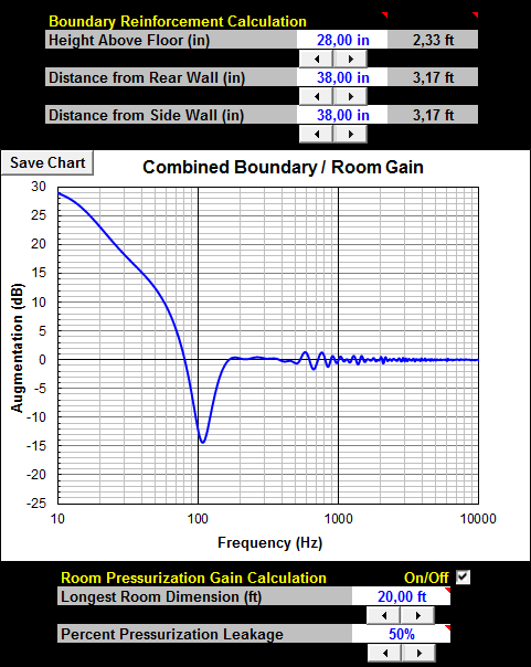

Null moves little higher in frq with new values for speaker distances, first is with longest room dimension as 15' and the other with 20' but this parameter don't change position of null just room gain below a knee at around 60Hz.
BYRTT,
Thanks, I definitely enjoy spending time in the "man loft".
I think your calculated result is definitely close enough to reality to consider the mystery solved. So, the width of the room does not matter here?

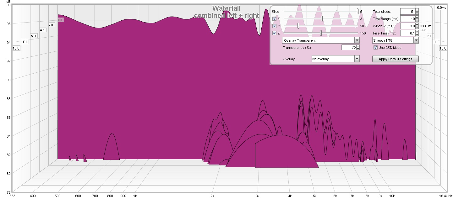

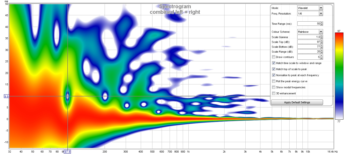

I was thinking the same thing about combined response when I was last posting. I've attached a couple of new graphs (based on the same corrected IR).

Couldn't hurt. Being pleased is good! I love it that you could do it with such simple means. Glad to see REW keeps evolving which also made this possible.
Spreadsheet hasn't a room width setting and the length setting only interfere with null if room is extremely small such as a toilet room size. When playing around in the spreadsheet looks like to get rid of nasty nulls in lows trick is to get the three speaker position boundary distances as different as possible but then speaker position end up a position that is not practical or nice looking.
