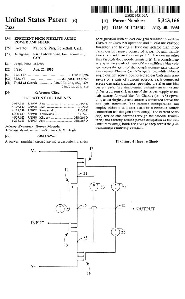

Here is an interesting patient of Nelson's was it ever made into
a working amp?

Does this mean that you can take some `nice' semiconductor and cascode it with a monster hockey puck: some super delicate jfet/SIT/vfet and hang a great big high gain switching lump on the side and get all the nice character of the `audiophile' device with much bigger output?
