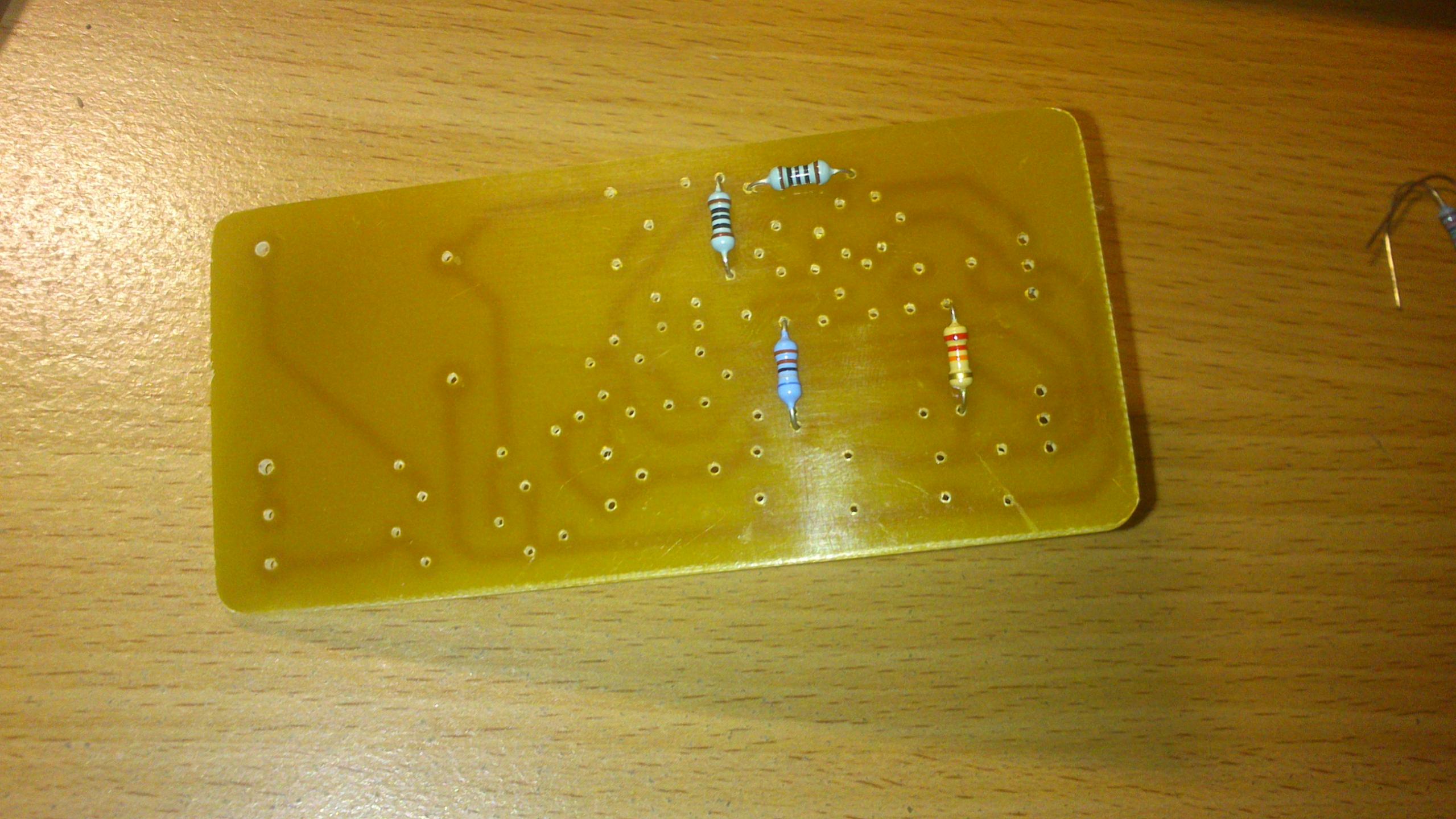

Can you solder through the resin?
Sure I can solder through the resin. In fact it is more convenient. It also preserves the shine of the copper tracks.
Then the solution is easy.
Choose a project for which you can source the correct components.

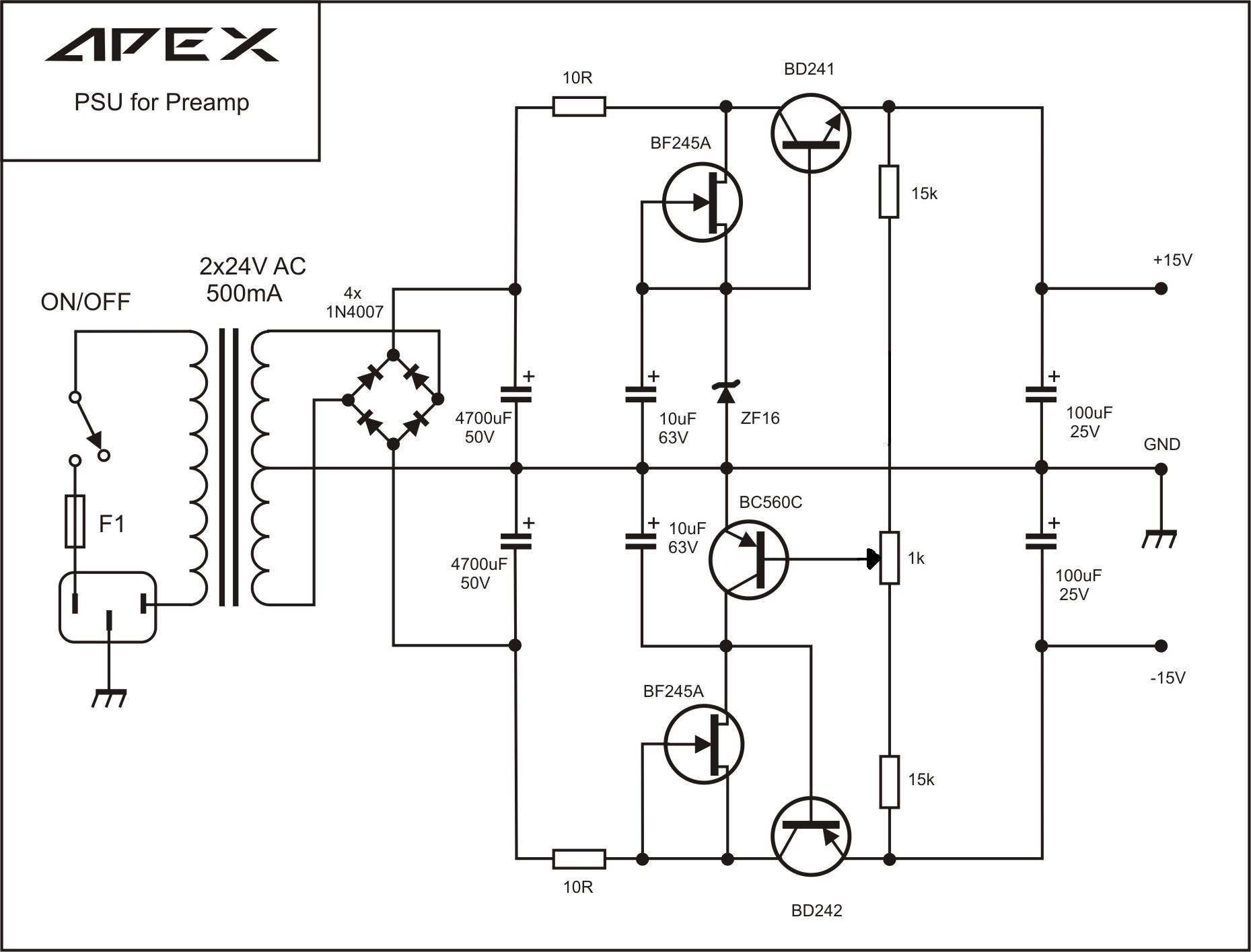

Just found that BF245A is obsolete now.

Perhaps I can find BF245B which has 15 mA drain leakage current in comparison to the 6.5mA drain leakage current of BF245A.

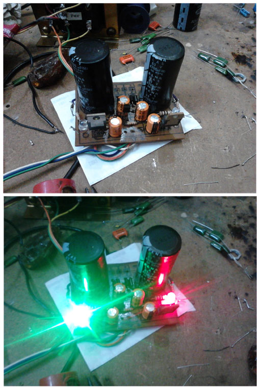

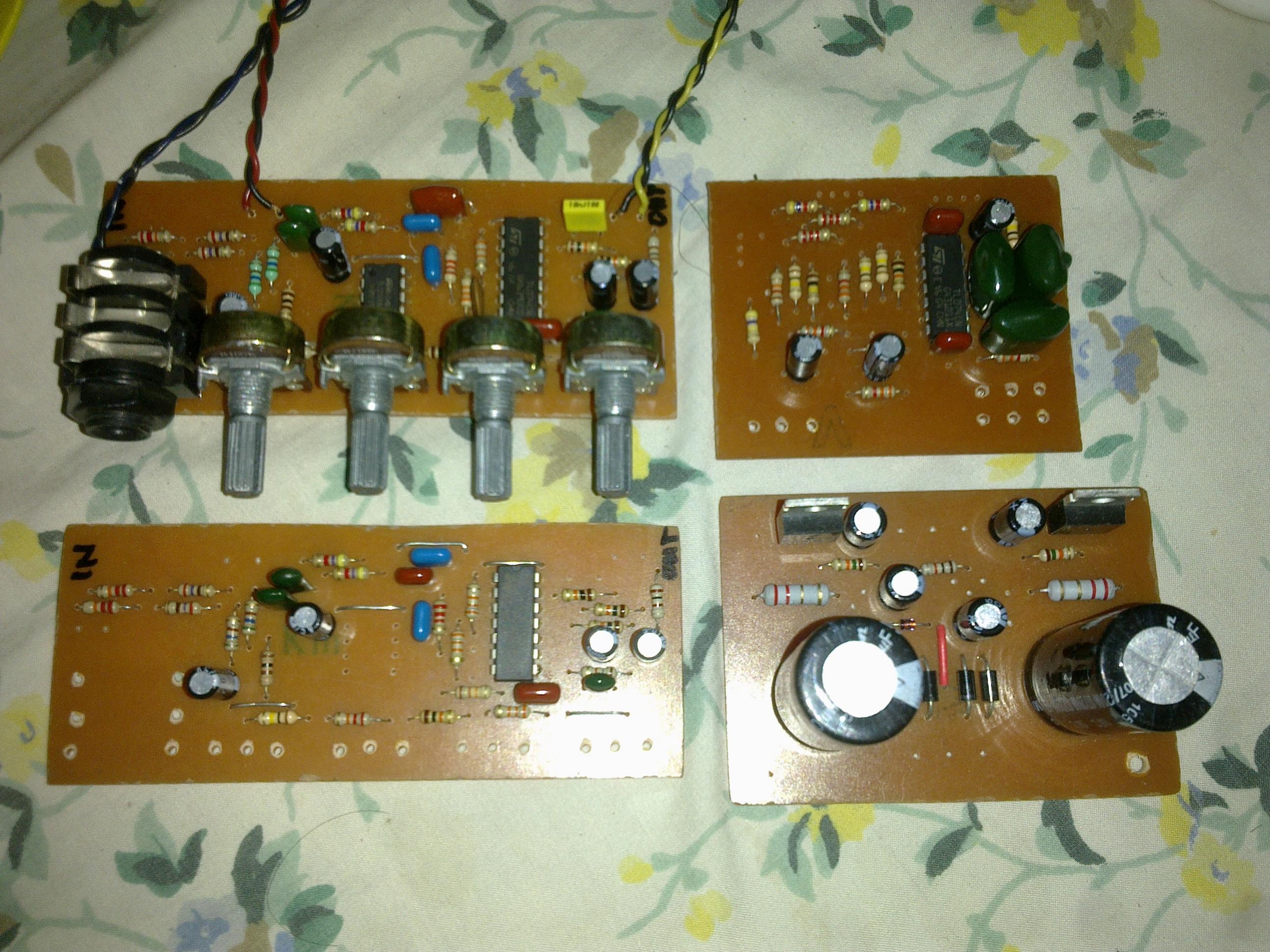

Finally done. 🙂
I used BC557 instead of BC560,
BF245C instead of BF245A,
TIP41C and TIP42 ( from different manufacturers)
I just added two LEDs after the rectifier from the pins of the 4700 uFd caps( Not at the output of TIP 41C and TIP42 ) .
Two ML3 modules are running great as usual with this new PSU
but Voltages are +15.47 and -15.96
Don't know why. 🙁
Thank you everyone for all your patience and help.

Nice work, voltages are ok, this PSU is very stable and low noise, simetry can be set with add trimpot but no need +/-5% tolerance is ok for any preamp.

I want to make a 8 channel audio mixer with 8 set of ML3 modules and your mixer circuit to plug in pc output, synthesizer, microphones, CD player, TV etc. I also want to add two LM3915 based audio level indicators at the output for mastering.
Can I use this PSU for that or anything needs to be changed?
Or which of your PSU designs should I make?

Yes you can use this PSU, it's high current design.

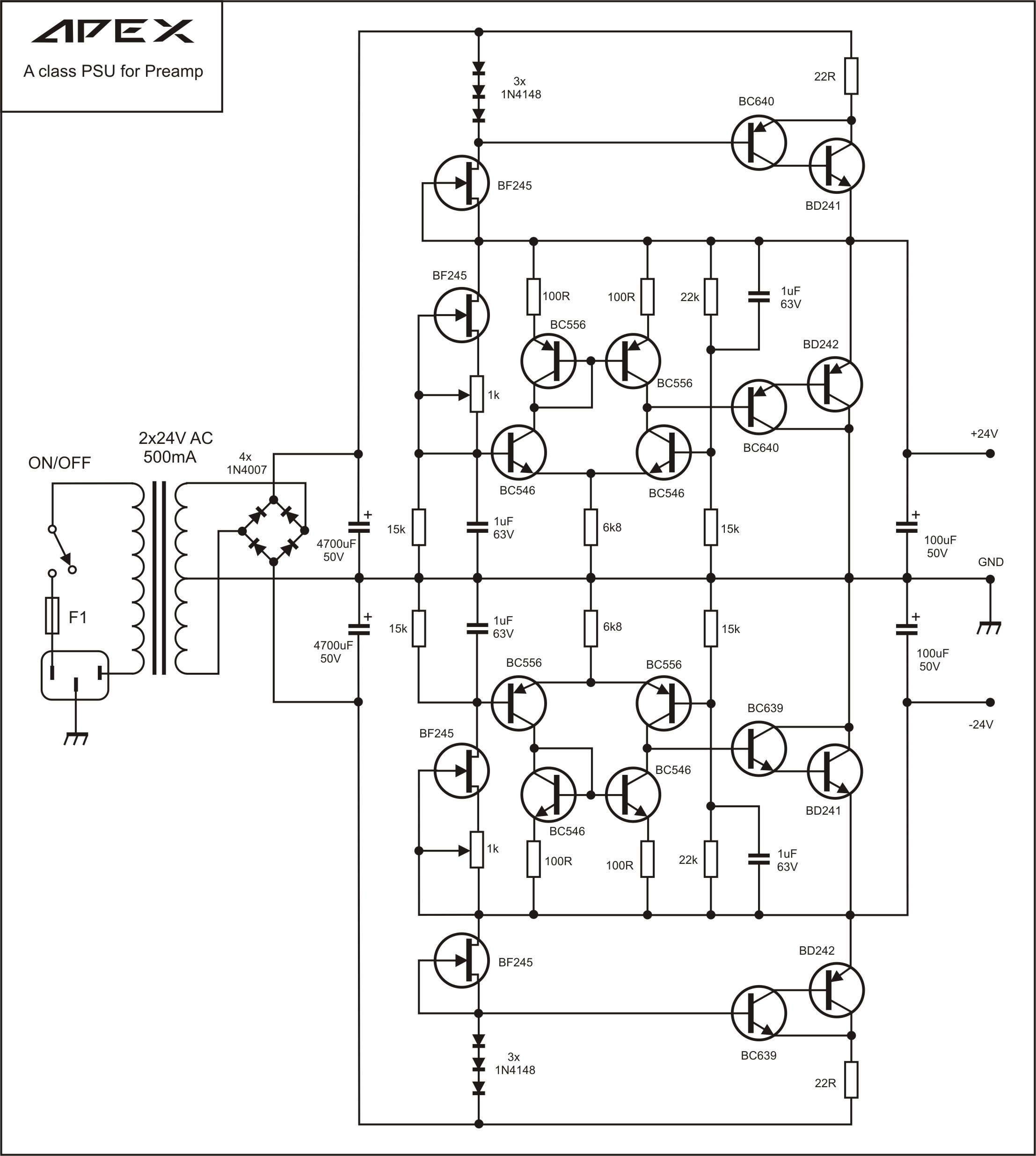

what are the benefits of using a shunt regulated psu in a preamplifier, over a series regulated one? Are there any improvements in sound?
my psu for preamp is based on lm317/lm337 regulators and im thinking of building the A-class Preamp PSU posted here by APEX.
I'd say that the main benefit is that a shunt regulator can isolate A.C. load current to a localized loop area. In other words, it can minimize the A.C. current interaction between various circuit blocks which might stem from any shared primary power supply connections. This also applies to the A.C. current demanded from the power supply elements prior to the shunt regulator, making the ecurrent demand D.C.

Mr Mile,i want a 30V single rail PSU for a preamp so i made a new board based on your class A 2x24V PSU schematic but using the upper positive half.i also added a fuse on the board. do any part values have to be changed for 30V output? on a earlier post you stated that BF245 could be substituted with BF244, 2N3819, 2N3823. does it apply also to this class A PSU?
apex psu
Sir apex any replacement for BF245 /BD242/BD241 this items not available here in my place pls.help. thanks and regards..merry Christmas sir apex..
Use 2SK246 and TIP31/TIP32
