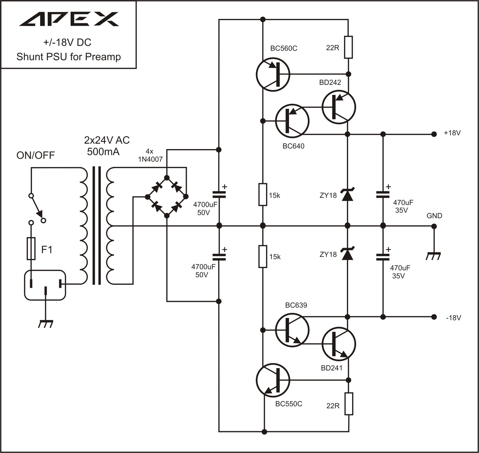

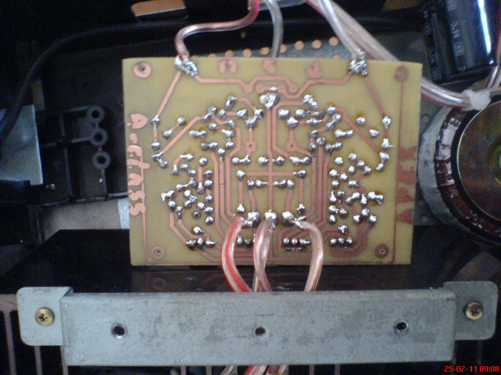

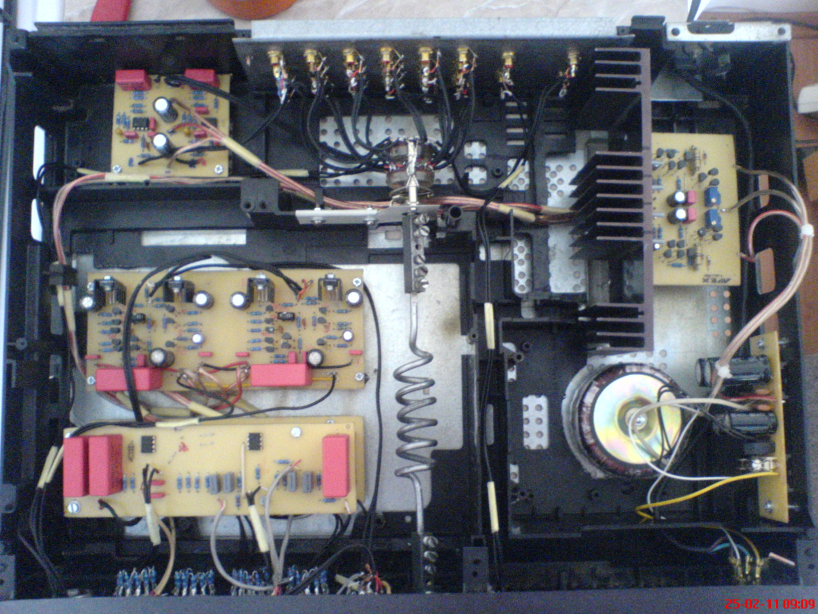

A-class Preamp PSU
A-class PSU,used in Clepsidra preamplifier:
Csom the 22r or 10r have only 650mV across them.
Pd ~ 0.65^2 / 10r = 42mW, 22r is Pd=19mW
That's ~ 7% of the rating of a standard 600mW resistor.
You could 400mW or 500mW here.
If you have ¼W as your standard stock, then use them.
Thank you sir for your kind reply. I will follow your words.
Pardon my ignorance but could you kindly tell me what are the advantages of this circuit over that using 7815 and 7915 in a preamp section made with opamp like TLO72 or TLO74?

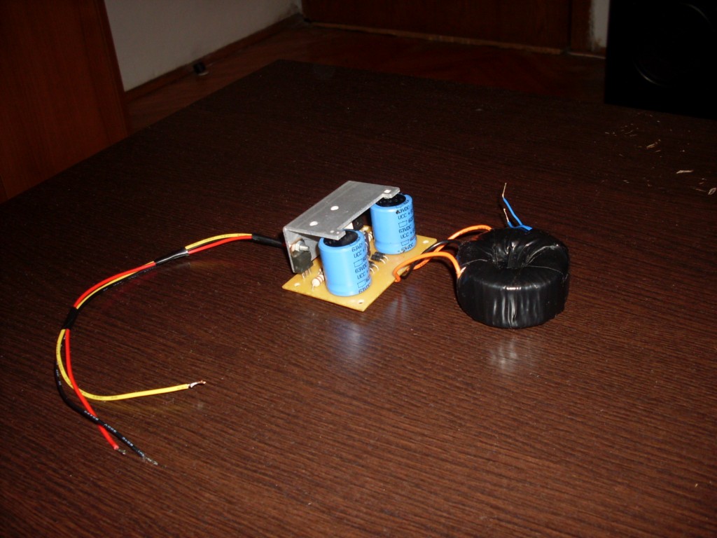

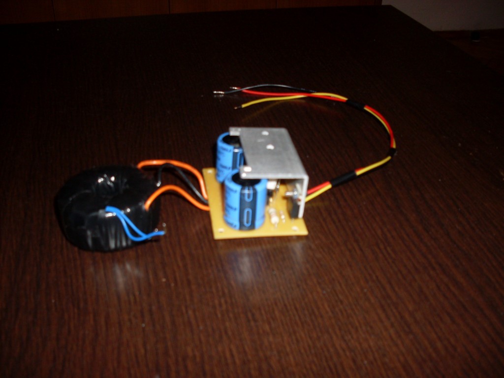

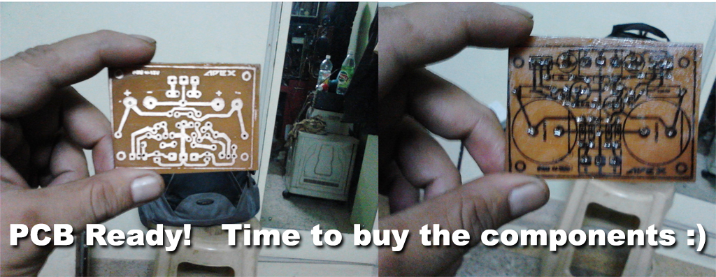

PCB Ready!
Okay! PCB made, drilled.
I also applied a coating of resin dissolved in thinner to protect it from weather corrosion.
I bought TIP41C and TIP42c today.
But BF245A and BC560C are not available in my locality. Neither 2SK246. 🙁

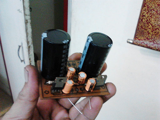

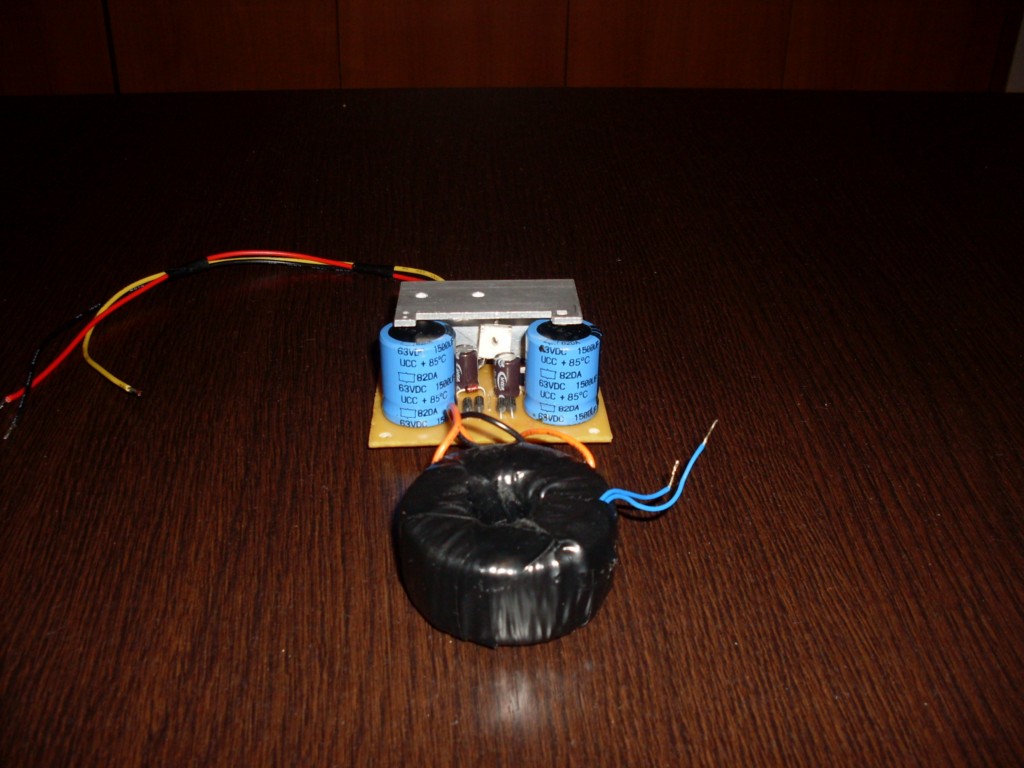

I ordered a local shop keeper to bring me the required parts. Today he reported that BF245A and BC560C are NOT available, neither 2SK246.
Could you kindly recommend any other alternatives?
Thank you.
