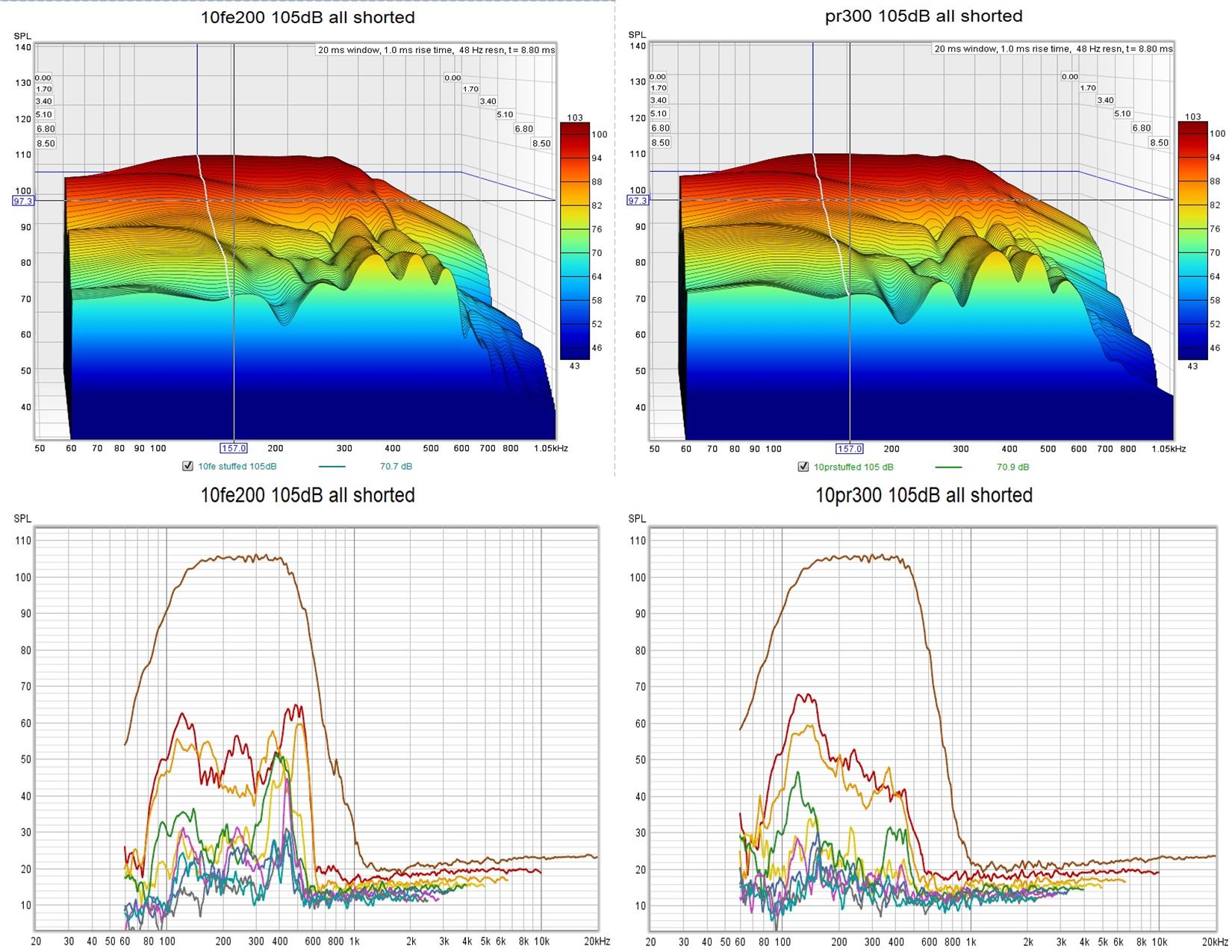

Here's some measurements i took where the two CD coax sections were shorted along with the undriven mid driver.
This was mainly just to eliminate any further potential source of resonances. It is amazing how much mid response changes when one on the mid drivers is left unshorted. Loopback time even moves considerably.
Anyway, below are waterfalls and THD plots taken at 105dB 1m.
I didn't bother with including mag, phase, or impulses, because they all look identical. (again, each driver had it's own FIR correction built.)
The only interesting thing i've noticed from shorting the CD, is how much the THD plot of the pr300 changed. It lost a big spike in 2nd at about 400Hz, whereas the fe200 was rather unaffected by shorting.
Checked this several times because it seemed weird....no clue why....

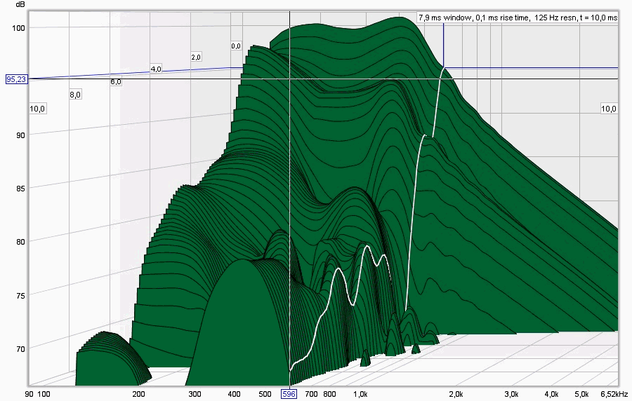

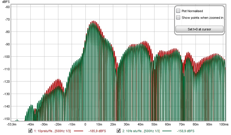

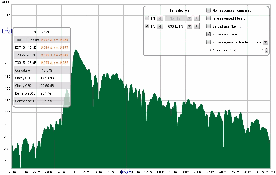

At least there are measurable differences... as some had noted, the biggest difference is at the start of the bandpass around 500-600 Hz.
So I've looked at a filtered IR to see if there were differences there:
and next looked at a waterfall plot after about 5 cycles at 630 Hz:
Clearly the 10PR is following what it's told to do a little better, while the 10FE struggles to keep up. Around 500 Hz that difference has become about 2.5 dB that the FE is lagging compared to the PR.
I see other differences as well, if I look at the signal before the peak (by filtering the IR), but that's 40 dB down and doubtful one could hear it.
I'd say the 10PR does exactly what it's told to do. The 10FE can't help itself and is struggling from the start (well, all relative because it still does a good job, just not as good as the other one).
Look at the filtered IR at 500 Hz and you'll see the 10PR has a nice rounded top while the 10FE seems thin in comparison.

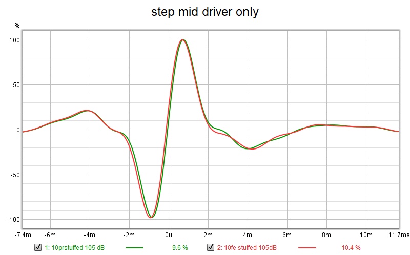

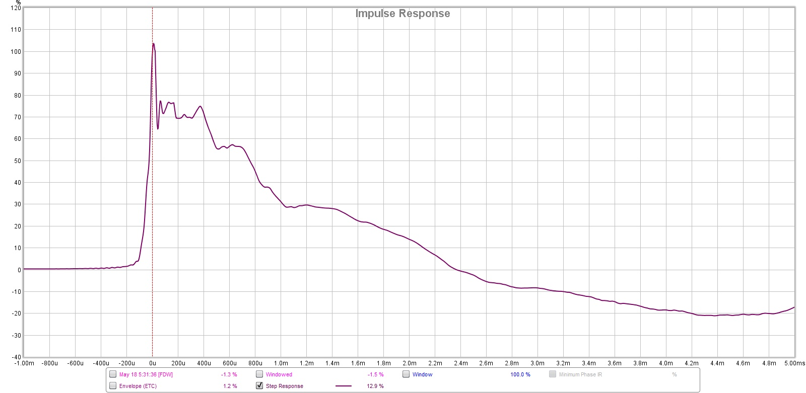

What does the step response look like between the two?
Here you go... seems about as close as could be ???
Do you find much value in step? What do you look for other than the classic textbook slope ?
I haven't found step helps much yet, being too dominated by HF info, and xover rotations when above first order....
But then again, i've been pretty much confined to being a mag and phase junkie for reflection free speaker tuning, and then impulses when bringing room into play.

I look for a right triangle indicative of good time alignment and phase alignment. But if you are running LR4 etc, it’s not going to look like that. It’s my thing with transient perfect speakers. If you are running DSP, there’s no reason why you can’t use a Harsch XO.

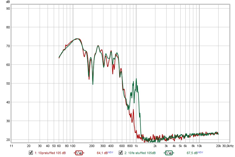

Below about 350 Hz both are performing quite similar. It is above 350 to just past 600 where there are notable differences. Even above that there are indications that one driver is more textbook like than the other.
For instance if we look at what happens before the peak:
(IR filtered before the peak to see any pré-signal, down far enough not to worry about it,
looking closely at the Spectogram/Wavelet shows this too)
See how the 10FE is showing a little pré-signal at 1 KHz? It's far enough down not to be audible, but probably an indication that it struggles a little more than the 10PR to keep the shape Mark wants them to confirm to. The higher H3 is also an indication of that.
I do value STEP response though, however not without looking at the other derived graphs a little closer to tell all of the story.
