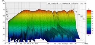

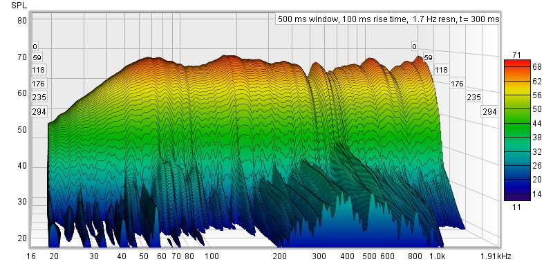

Pair of lab12's on a 50x50 MEH on their own, with a lowpass @250 and a couple of PEQ's to make 'flat enough to have a quick listen'
Also a plot with the mids / tweet included.
The waterfall seems to decay pretty smoothly until it hits the background noise. Again, I'm not a measurement guru so make of these graphs what you will 😱
My lab12's were not rear ported and made the front ports chuff at fairly low volumes. (probably due to me eq'ing up the 50Hz region 😀 )
Bear in mind these were quick measurements in the garden to get a basic 'will it won't it work' measurement sweep and a quick listen to a couple of tracks.

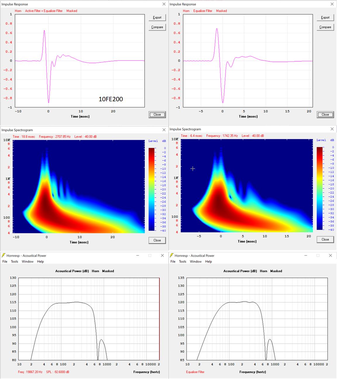

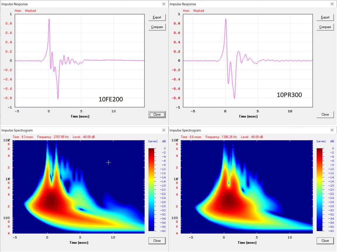

I've since done some HR and neither driver's unequalized response seems to change signficantly with rear chamber volume; they seem to be dominated by the horn. Its hard to choose between the two based on frequency response except for 10PR's ~3db higher sensitivity above 120 Hz. But the IRs and IR spectrogram do show differences that imply the 10PR300 has higher damping and would have better transient response. The orange tail of the 10FE's response extends to 10 ms; that of the 10PR ends at 5 ms
attachment.php
However, when I equalize to approximately the same responses, the differences in IR go away. Any residual difference is because the FRs aren't identical.
attachment.php
The damping hypothesis remains unproven.
The 10FE200 has a weaker motor and a lower moving mass, which implies a thinner cone (winding depths are very similar, although the wire thickness is unknown).
Under high-pressure loading, I'd expect the cone to flex a little, effectively soft-clipping the waveform in a symmetrical way. Symmetry implies odd-order harmonics, which are seen in the distortion charts - the 10FE200 has higher 3rd harmonic than the 10PR300.
There's another factor pointing in this general direction: soft cones tend to be very benign as they get towards the top of their operating range.
Here's the 10PR300:
And here's the 10FE200:
I don't think there's any doubt that the 10FE200 has a much smoother kHz+ range.
For comparison, here's a 10" aluminium-coned Seas driver:
We can see that the more rigid the radiating surface, the higher-Q the resonances. This lends weight to the hypothesis that the 10PR300 simply has a more rigid cone, and, based on Mark's impressions of the sound, that makes it more suitable for high-pressure loading situations.

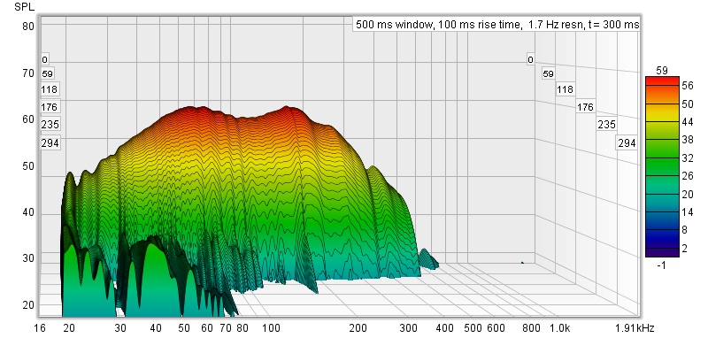

Rob.
