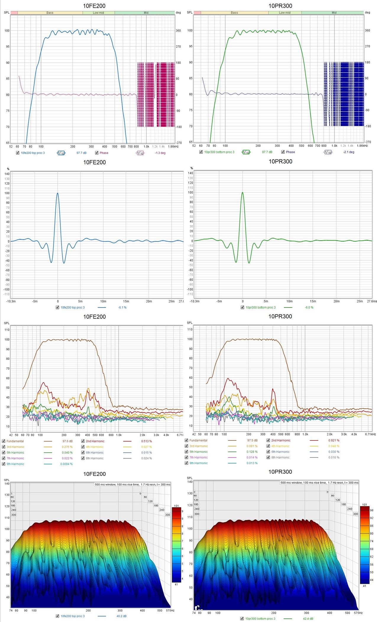

So the point here, of this post, is the 10FE200 and 10PR300 have identical looking transfer functions and impulses, pretty much textbook perfect, along with the whole speaker response.
And again, can there be a power response difference?

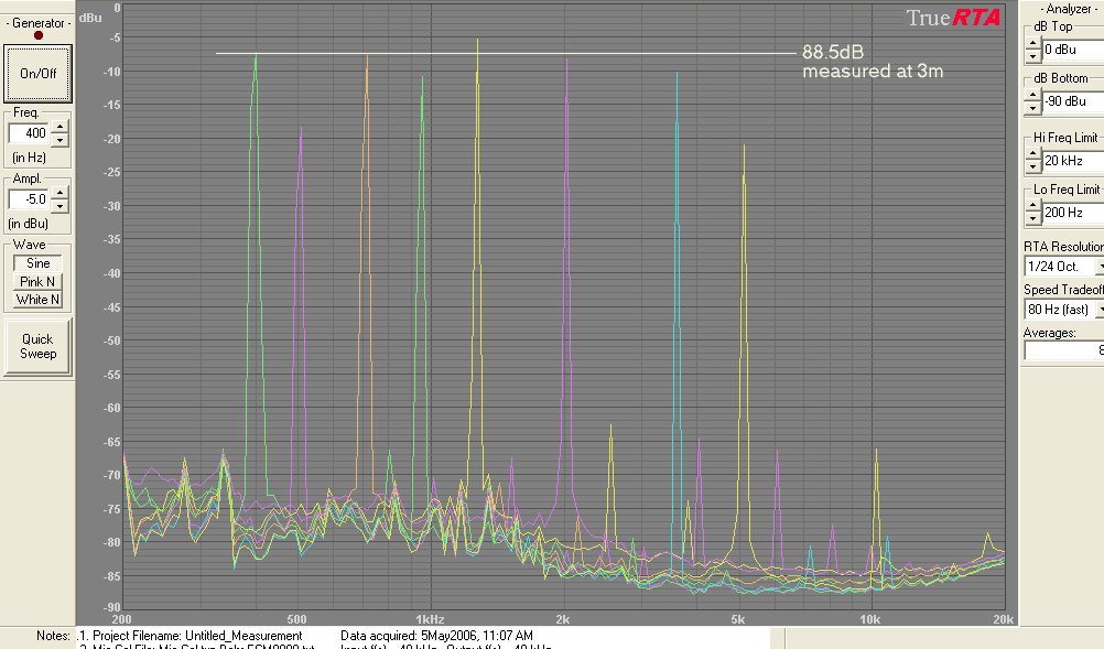

Rob. Here's a pic of my old Edgar midrange horn with a series of tones being played, and overlayed.

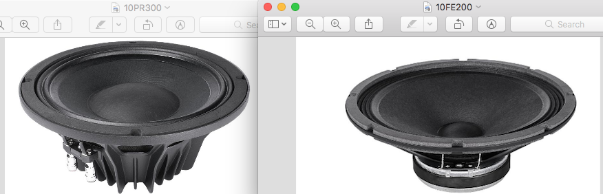

There is far greater motion control/position over the VC with the MUCH lower Qe (higher Bl) with the 300's (particularly with lower excursions).
Harmonics might be it yeah, very different cone profile with these drivers => different bandpass filter with the enclosure? Also, not sure your measurement setup but could there be some variance in microphone positioning? I mean did you measure them the same with exact same mic and dut position? Have you measured the power response? this is interesting thread 🙂

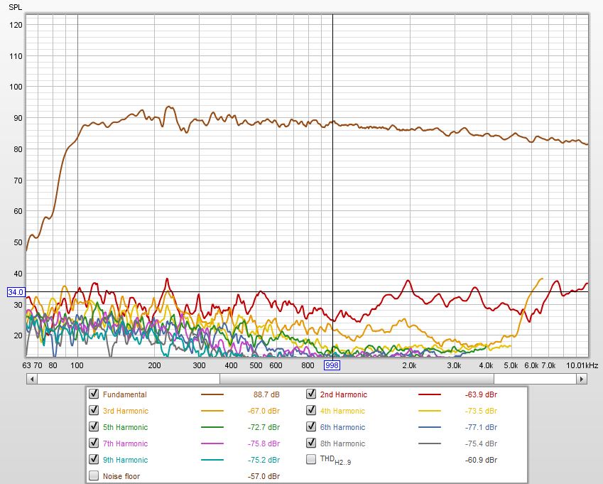

YSDR & RobWells, the only times i looked at harmonics were quick peeks with REW just to see if anything unusual popped out.
Both drivers 80-90dB 1meter looked close enough not to peer deeper. Pretty much around -60dBr throughout.
10pr300 below. In room, got some reflections in the 200-300Hz range for sure. (spl is correct)

Sounds like you are hearing a difference in transient response between the two low mid drivers.
Perhaps that could be measured with square waves in the passband?
Looking at the cone profiles of the two drivers, it appears the lower BL 10FE200 would have a greater VTC (volume of throat chamber) than the 10PR300, making the acoustical band pass lower for it, more stored energy to "overcome" with less available BL.

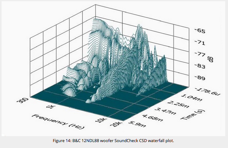

Maybe waterfall plots will show something going on?

Beneath the waterfall plot also the step response might show the differences in temporal response between these drivers.

As phase_accurate and ErnieM suggest, a waterfall chart would show that, like the one below, showing decay time vs frequency.
I'd bet the weaker motor/larger cavity would have longer delay times.
Art
Hi guys, again thx to all for continuing comments/thoughts...
here's some more direct measurements, kinda due to Parts Express sending one 8 ohm 10PR300 and one 4 ohm.
I had installed the 8 ohm in the bottom of the syn7, and when i went to do the top and saw the second one was 4 ohm...I'm like dammit...oh well, stuff happens..poor PE guys are probably running ragged...
Anyway, decided it made a great opportunity to do some meticulous head to head, toe to toe, measurements, one of each driver in the syn7.
Below are the 10FE200 and 10PR300 drivers, measured one at a time.
Just the mid driver measurements.....without the coax CD in play.
Each was individually tuned for flat mag and phase from 100Hz to 500Hz, with the mic centered on the horn about 1m away.
The non-used driver was shorted (which was clearly very necessary)
Nothing moved during the raw measurements, then the tuning, then the processed measurements.
I can't see any differences worth noting, other than maybe a bit more 2nd and less 3rd harmonic out of the 10PR300 ...????
They look damn near identical to me.....
But I'm not all that versed in reading waterfalls...anybody see anything?
The tuning process was the same I always use, and what I've been listening to, when hearing the clear difference in sound between the drivers...
Maybe two drivers running together change things to make this single measurement experiment a bit invalid...dunno....
Just know all the measurements tend to look pretty dang alike after tuning, one driver vs two, this vs that, ... dunno...
But the idea the sound diff is about transient response still smells right i think..

Looks the same....
The only other way I can think of is to compare the actual music waveform to the speaker output and overlay them to see where the differences are. Would have to be zoomed in to see the details.
I believe Barleywater posted measurements of his Linkwitz Pluto clones (with FIR) using this method.
Have you done IMD measurements?
I'm definitely not a 'waterfall expert' but to me it looks like there's almost a 'pulsing' as the sound decays (drops a bit, then blips up a bit, then drops a bit more) (Are these reflections if measured indoors ?)
My own measurements seem to show a smooth decay until the sound levels meet the background noise level. I can pm you a couple of pics of my waterfalls if you like rather than have them interfere with this thread.
Rob.
What do the plots look like before EQ/processing ?
Rob.
Can you filter those waterfall plots? This shows a way too long window to see what's going on. Drastically shorten the rise time and the window. Like 0,1 rise time, 8 ms window and 10 ms time range to start...
