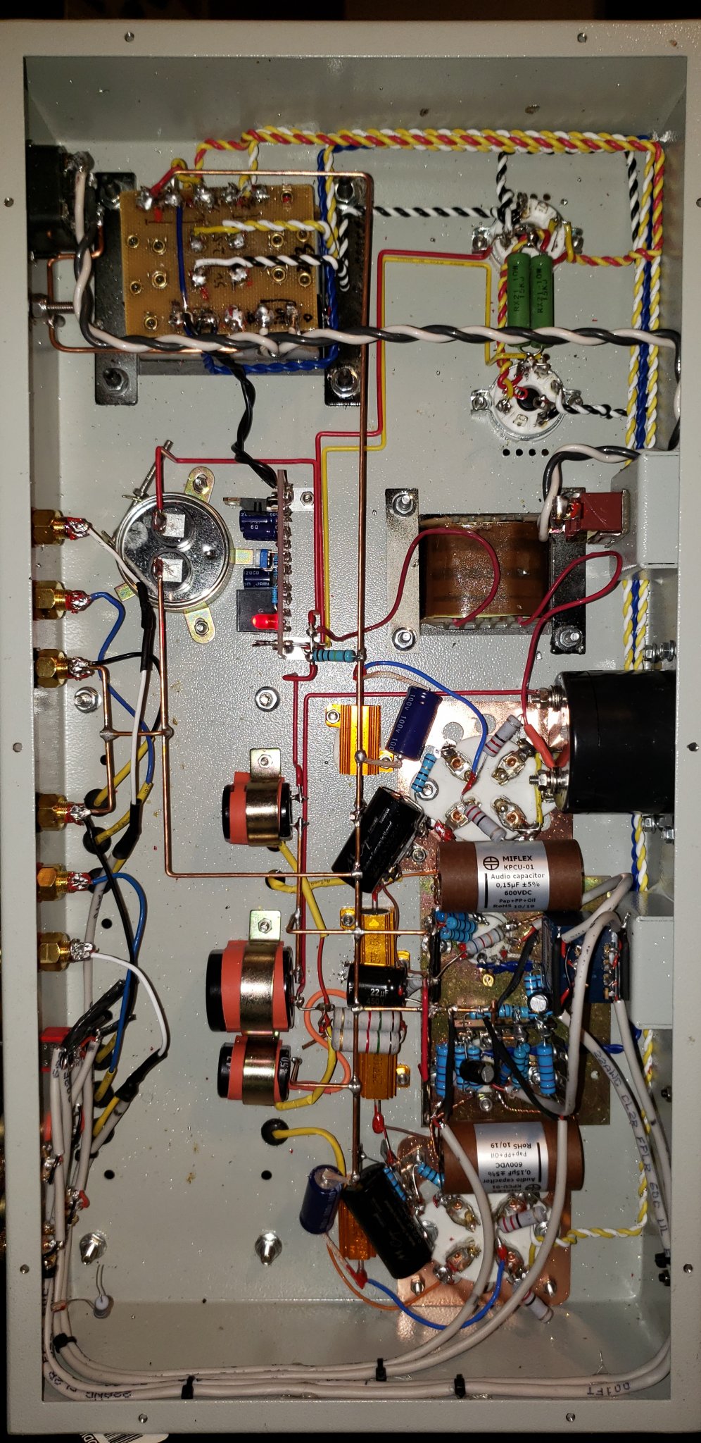

I ended up rewiring the amp because I thought the hum might be heater related being it's 60hz but it didn't help anything. View attachment 1011039

I'm just learning how this stuff works. When I rewired it I just put everything the way it was just cleaned up. Are you saying I should put the center tap from the transformer to the negative on the cap right beside the transformer?
I know I need to change something. I measured 15.9v AC on the B+but at the terminals of the large cap next to the transformer I get 50mv AC. Something is backwards here. That still doesn't address my problem though. If it was noise from the B+ it would be 120hz not 60hz.

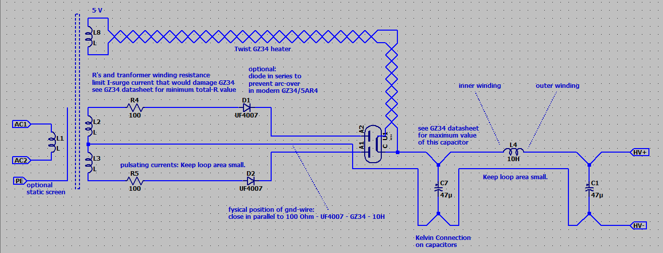

I fully agree with euro21. Attached a drawing to make the power supply cable routing clear.
Connect the rest of your amplifier to the points marked hv- and hv+.
It prevents hum coupling through magnetic fields and through the common gnd-bus.

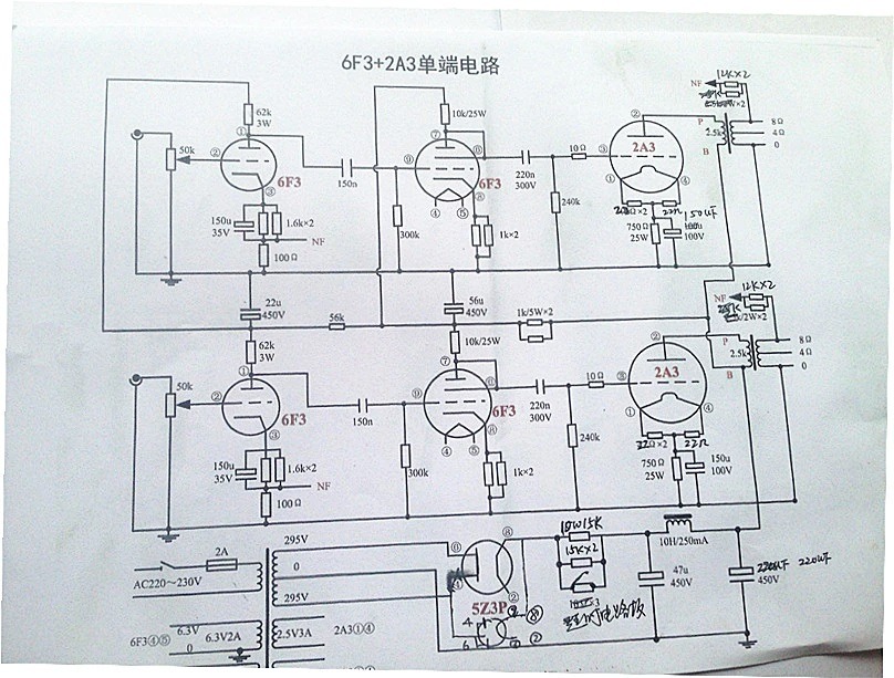

I'm a bit puzzled about your schematic.
Compared to the original schematic, your amplifier uses two 5Z3P's instead of one. It's not clear to me how you connected them exactly. Completely paralleled? Or each 5Z3P paralleled, and the two forming a full-wave rectifier? Or are you only using half of each 5Z3P, and than the two form a full-wave rectifier (that is what your schematic seems to show)?
But what strikes me the most are the values of the resistors between the 5Z3P's and the first capacitor (47 uF). In the original schematic (see post #2) these are three 10 Ohm resistors paralleled, making 3.3 Ohm in total. But in your amplifier there are two 15K resistors paralleled, making 7K5 in total. This doesn't seem to be a mistake in your schematic since these two 15K resistors are visible on the picture of your amplifier in post #9, although I'm not sure if the way in which they are connected is exactly like in your schematic.

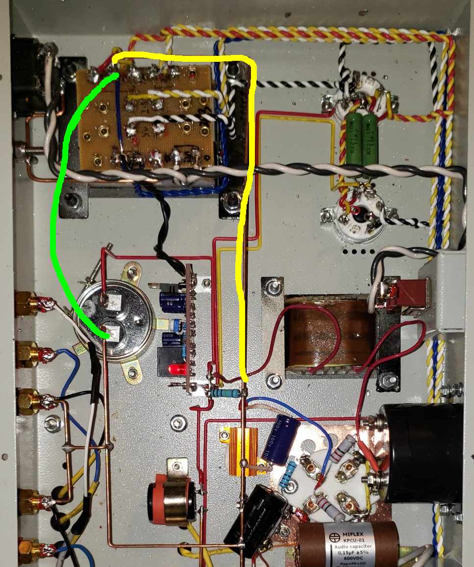

The ground bus should be connected as shown (green), with part shown in yellow removed. Transformer center-tap direct to first cap so that its ripple current isn't flowing in the rest of the ground bus. Insulated wire for green ground connection - it's crossing other wires and terminls; should be kept short. If this is not your biggest hum problem, it will be more obvious when you do fix it!

So then I make that cap the star ground point?
You don't have a star ground - there is no "star point". Keep AC currents out of the chassis, and out of the ground bus, and grounding of everything else becomes non-critical. That first cap caries huge pulses of ripple current. Look at any vintage amp - they connected the transformer or bridge rectifier directly to the first power supply cap, and grounded everything else wherever it was convenient. And there was no hum, even from the phono preamp, which can be tough to get quiet.

Also must remove the connection from loudspeaker terminals negative point to first cap negative !
Instead of it try connecting individual thin wires (there are no current, it's only for safety operation if OPT primary-secondary insulation damaged) from loudspeaker terminals negative points to ground bus (for example at second cap negative pole).
The other -safety- problem, that there are no fuse in HV part. I usually use it between HV CT point and first cap negative pole.
