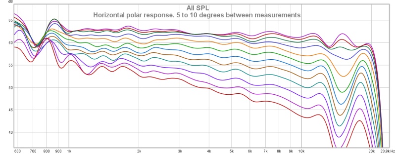

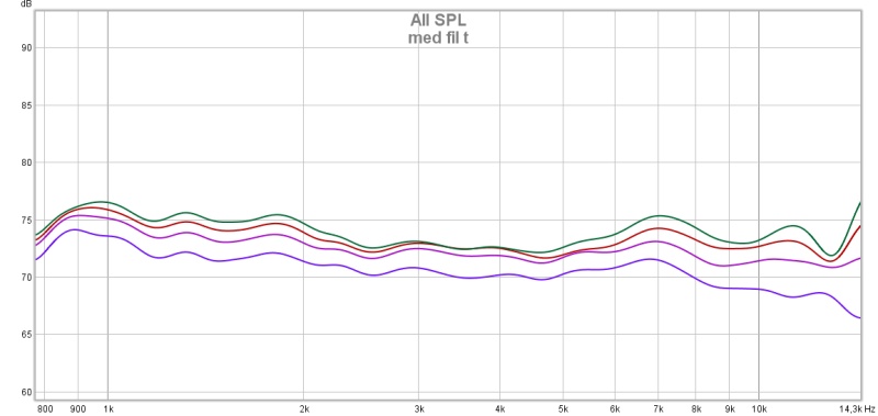

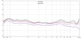

Im not sure the measurements have improved much with the bigger throat. Maybe this has to do with the fact that the new routerbit did not make the diameter much bigger - Only the rounding.
I tried with some thin felt between the wool ring and the horn. One with a smaller ring than the other - So two different sizes. The felt ring seem to "only" mess up the response a little bit. Around 5.1 K. - I did not glue it to the horn.
Im not done with the tuning/EQ'ing yet, but the horizontal polar response looks quite good, right? Distance around 120 cm. Maybe I will add a notch around 1.8 Khz.

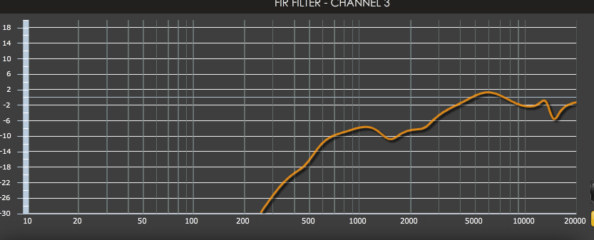

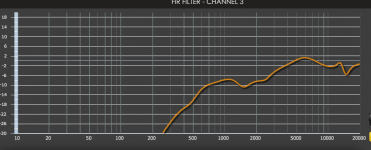

Also attached a illustration of the actual EQ'ing at the moment. Crossover LR48 dB at 600 Hz.

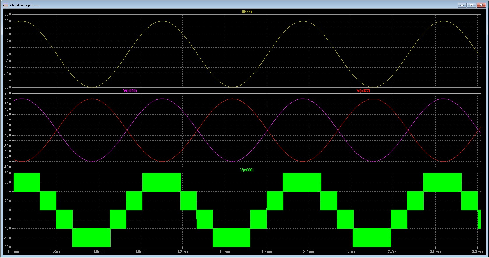

Hi X everything oke there?
I am busy with class d learning and start to make the hybrid, need a case design for it so look at it how to do.
later this year the circlotron get again from stalling.
5 level class D I did try, carrier is then multiplyed by four, in mine case 1.6Mhz.
how it does with the horns?.
regards
