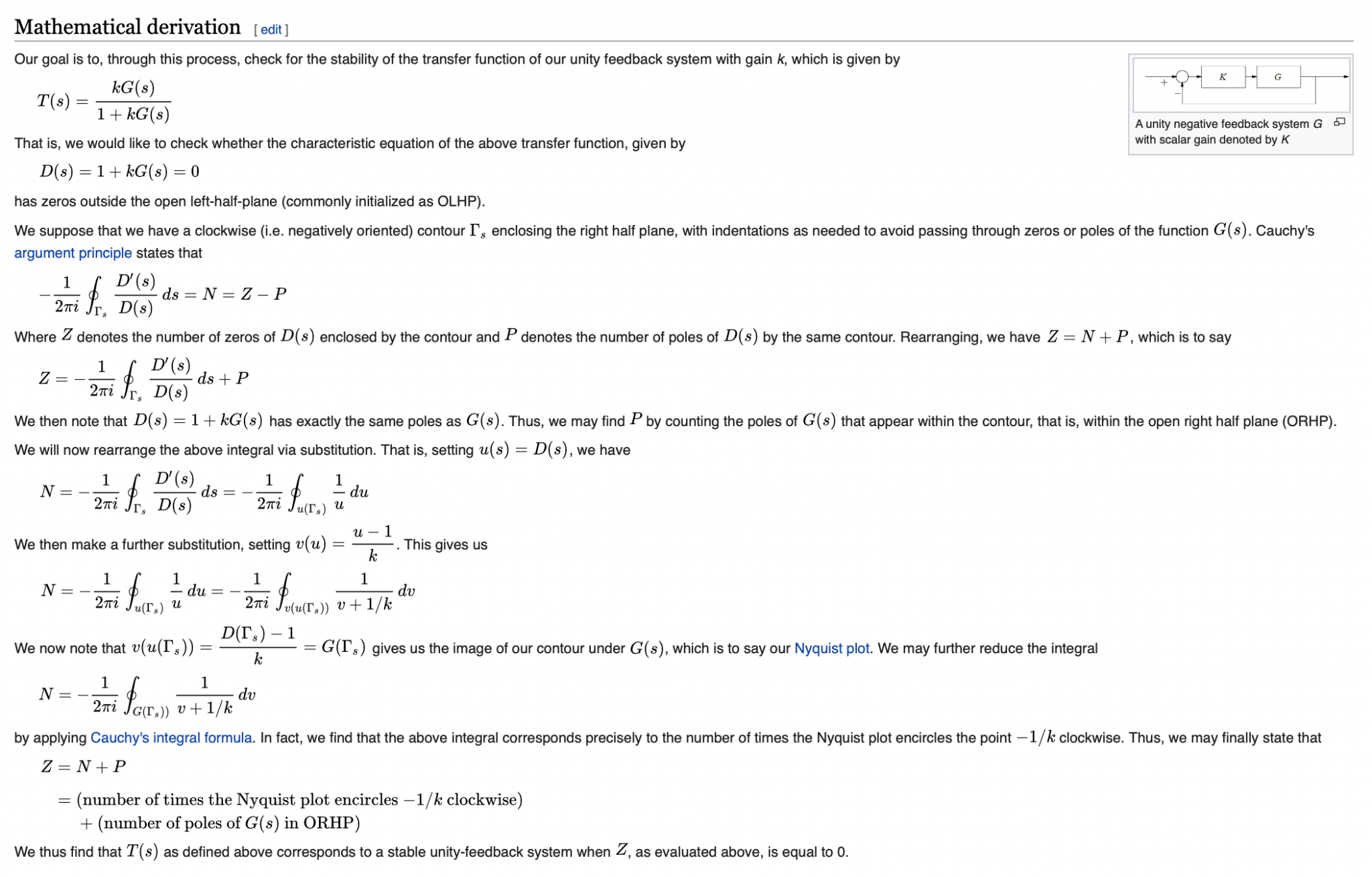

If you are lost somewhere and there is no way out, then you can use maths:
Mathematicians like these and engineers made a religion thereof. However, these make the user make more mistakes than help solve mathematical problems. Therefore, such best not be used and only simple logic is applied wherever necessary. After all, mathematics, as everything else, is nothing, but, simple logic only. Only somewhere, where there is no easy way out, should mathematics, mathematical apparatus and tools should be used.
