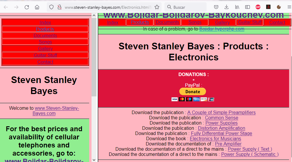

Quote from the first page of this book:
Neither mathematics nor physics nor any other science is necessary in order to understand and design electronic circuits.
Therefore, an attempt has been made to write a book on transistor based Electronics with, mainly, bipolar junction transistors, for which, no mathematics, physics or any science and engineering is necessary. Not even too much Electricity. Just simple logic.
Let's face it, why would anyone read or take anything seriously past this point, but then page 3 doubles down with:
The main objective of this book is the explanations.
Because Analogue Electronics does not contain anything, but, a simple analogue logic ( analogue common sense ) all explanations are, therefore, simple and cannot be complicated. There is no mathematics in electronics ( and in any engineering ) and, therefore, no mathematics is necessary to be known in order to know, understand, apply, design and develop Electronics.
Electronics is a separate science ( engineering ) and has nothing to do with Electrical Techniques Science ( Electricity ). Electrical Techniques Science ( Electricity ) is a separate science ( engineering ) which analyses passive components only, such as, resistors, capacitors and coils, i. e., the linear changes between voltage potentials and electrical currents. Electrical Techniques Science ( Electricity ) conforms to steady parameters of components and is based on the linearity of the main laws of Ohm and Kirchhoff.
Of course, Electronics and anything else conforms to these laws as they are general principle laws of physics with equivalents in any other branch of engineering such as hydraulics and pneumatics.
However, Electronics deals with changes of the main parameters of Electricity ( resistance, mainly, capacitance and inductance ), which changes are caused by the electrical currents and voltages.
Wasting your time with mathematics........well of course you have, page 4 says so:
Although not necessary and incorrect, some have decided to use mathematics in Electricity. Even worse, some have decided to use mathematics in Electronics.
Mathematics.........no thanks.......I'll use Algebra instead......it uses the alphabet:
Thankfully, the used mathematics is not very complicated, yet, still, unnecessary. Also, thankfully, there is no need to understand this mathematics. The only thing necessary for this mathematics is to know a few, readily available, formulae.
Just a reminder of the branch of mathematics called RMS. It's mainly confusing because its half of something of a thing, then you half it again:
RMS mathematics is easy and easily confusing. The confusion comes, because, normally, half of something is this thing, divided by two. In case of RMS, this may not be the case.
I'm worried to read past page 4 in the event I may never recover psychologically...............
I can assure you that the book continues in the same vein. I nearly stopped after the RMS confusion but had to take a peek at his transistor explanation. Everything is "simple" and the bipolar Vbe=0.65V, invariable, apparently. The guy hasn't even measured a bipolar from this gobbledegook. And temperature doesn't appear to be a problem in his world. So I don't think anyone can take this seriously. Or should not.Just beer......you'll need something much stronger to punch through a wall of barely comprehensible text.
