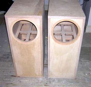

Yes imagine a shelf like on a bookshelf but with holes in it
If Melon is using CSA drawings, the shelf brace is horizontal, parallel to the floor, and about half way up the height of the box. It is attached along all 4 edges to the front, the back and both sides of the box.
Like an internal belt then? Like they use on box kites and packing crates? What does this thing brace against? Because unless there is a crossmember from front to back thru the middle, or side to side thru the middle, or very large triangular corner pieces its not really bracing. (unless its 12" deep)
Half way up you say? If its there to help reduce the vibration of 4 large panels, in the process created 8 smaller ones which are still very big on a box that size.
If I were undertaking a box this big having spent out on the AN drivers I'd do the holey brace for the magnet and several holey triangular braces. Then industrial rubber of various thickness sticking tile/mdf/ply to the various surfaces and jobs a goodun' :drink:
Like this
Reactions: Chakster45
back of the speaker is still gonna be vibrating around with no rearward sink.
go on. brace it. you know you'll feel better
btw those cabinets are way smaller than the 10cuft+ I thought we were talking about. Maybe 1/3 of the volume? nice tho
