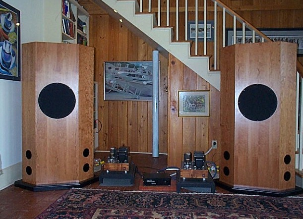

This is what a GRF/Westminster is like.
Seriously unlikely the Nirvana drivers are fit for these, but at least look at what is Time proven.
Rick's Tannoy Autograph Enclosures
these look really nice and quite a fun project too. But 20+ weeks of work (weekends and evenings) sounds like a lot - I think I'd want to hear one of these beasts before starting it.

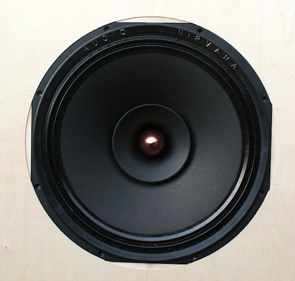

the 12" AN CF in the 5.6 enclosure made with 20mm plywood sound pretty good. they have a 15cm diameter vent hole.
not sure why the 1mm xmax troubles some people, this is a 15" driver we're talking about.
my 12" at 0.5mm has so much output at 40Hz that makes me nauseated. I would not want to listen to the 15" at 1mm.

Your direct experience is good to hear about, always better than theory alone. I'm also confident that 1mm is not going to be a deal killer with this speaker.
Heres a mere 10.3cuft enclosure for a 15" Tannoy DC (not mine)
Ive had 15" DC's in the berkerly cabinet with 100W of solid state class A power up their back ends - the result was beautiful and I'm still in love with big drivers
As for the Xmax of 1mm (each way). It really doesn't matter. I'm using 12LTA's in the Emken and with barely any movement of the cone they are at thunderous levels.
This AN driver in a 10cuft+ box will literally shake everything. I hope you have a big room Bigun so the modes where it gets excited will support the really low stuff. I rattled glasses in all four apartments on my floor on a test run (with owners permission) with the Tannoys 😀
