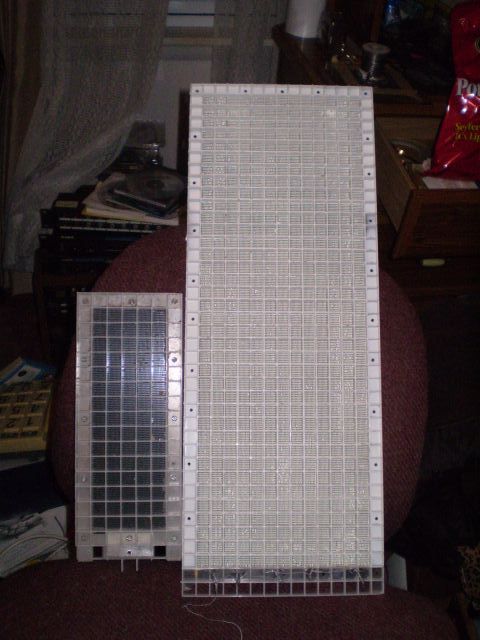

Has anyone had experience with these particular ESLs
Mini Panels ?
I'm thinking about using them with a pair of
http://www.greatplainsaudio.com/downloads/416-8B Spec Sheet.pdf
in 3 cu ft (interior) sealed cabinets. The sealed boxes would limit the 416's low end
to 70Hz. That would likely help limit IM distortion, while they also handle up to around 700Hz. Below 70Hz, a pair of subs would take over. And I would bi-amp the 505s with the Altecs.
There's lots of good words about the 416 here; check out this thread
http://www.diyaudio.com/forums/multi-way/100392-beyond-ariel-781.html
and http://www.diyaudio.com/forums/multi-way/100392-beyond-ariel-1165.html ).
But has anyone ever built something with the 505 ESLs?

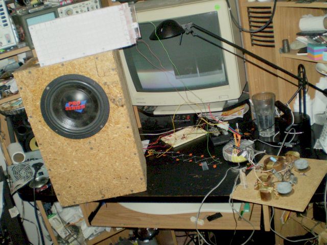

I haven't any experience with that particular panel but the size is nearly the same size of panels that I have made for my very first set.
I get the same performance out of my 4.5" x 10" panels (3.25" x 9.75" diaphragm size).
They mate very nicely with my Radio Shack Optimus PRO-CSW800 8" subwoofers!!!
I think that this size is an excellent combination and will give you great sound without being overly large.

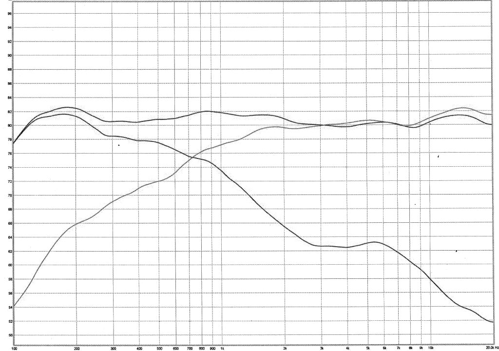

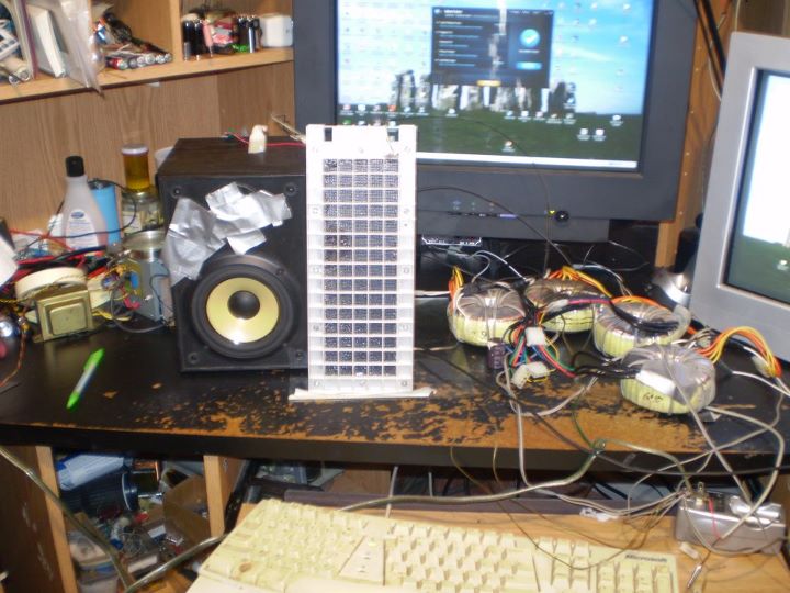

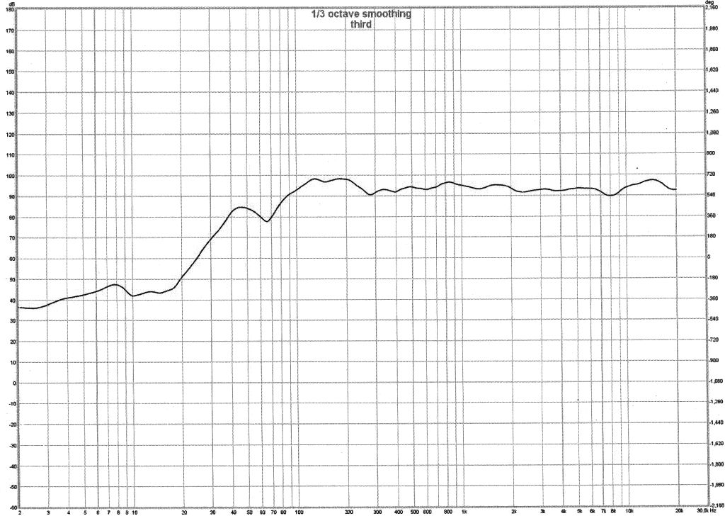

Thanks jer. One concern I have is required power. Even though I'd be biamping the ESLs and the 416s, the amp for the ESLs will be a low power amp; only 25 wpc/8 ohms, 13 wpc/4 ohms. The specs on the 505s say 8 ohms, but no actual impedance curve is provided (though ER Audio said that it, as well as dispersion curves, are in the works). My room is relatively small, and ER Audio claims the 505s have 88db sensitivity. Since you said that your panels are about the same size, if they are also close to 88db sensitivity, what wpc did you need to drive them when listening about 3 meters away?
Here is a Quote of the description I did at ESLDIY as the data was still fresh in my memory at the time I was testing the system.
"The diagphram size of the desktop system is 3.25"x 9.75" using a 5.25" woofer.
This system will do more than 100db and has been measured in excess of 105db at 1 meter.
The large ripples in the Frequency Response chart are from reflections of the desk and monitors as shown in the test setup as I have eliminated these in other similar test setups.
As tested this setup used a 1:250 transformation ratio and about 4.5kv to 7kv of bias with only a 5v to 10v peak signal feeding the step-up transformer."
Using a 6.8KV bias and about 1:160 step-up ratio I was getting about 95db with just a 10Vpeak signal.
jer 🙂
A 5Vpeak signal is close enough but slightly more to the equivalent of 2.83Vrms or 4Vpeak.
At this level I got an average of 88db to 90db with 91db for a few peaks but I consider 89db about the average.
This works out as confirmed by my measurements of 6db more for every doubling of the drive voltage(and bias voltage for that matter).
My FR graph was set with 10Vpeak and at 95db.
I do my ESL voltage measurements in Peak voltage and not RMS because I like to know the peak voltage in case of any HV breakdown of the Stator coatings.
The last four graphs are the most accurate and calibrated graphs I have of the system in the First picture once I got it all setup and tuned in at 95db.
jer 🙂

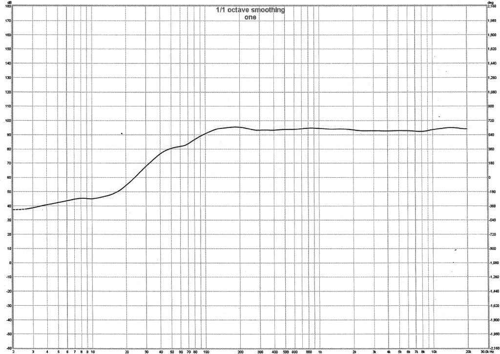

Forgive my ignorance but what is the value of “smoothing” the FR when evaluating system performance? Is it to let you see the overall quality of the performance without “sweating the small stuff”, so to speak? And what software did you use to transform the “raw” response curve into the two or three smoothed ones that you show here?My FR graph was set with 10Vpeak and at 95db.

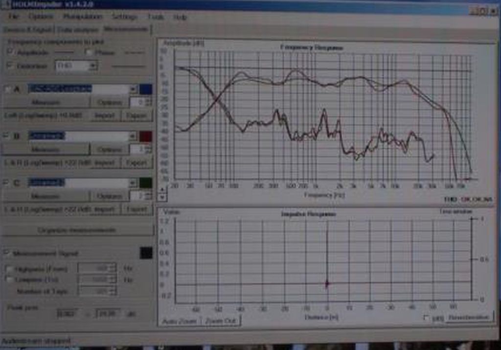

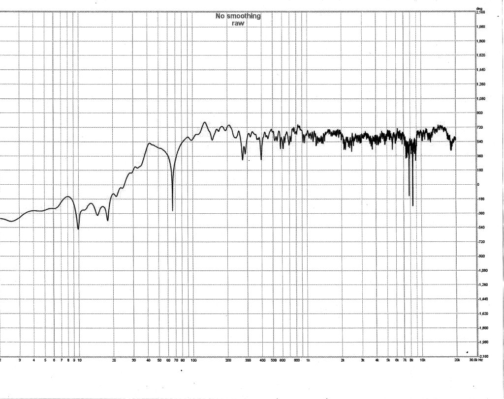

Within about 5db, can you estimate the FR of the larger ESL, minus the woofer?
Yes, You are correct.
Those graphs were done with REW and the db scale was calibrated to my SPL meter at 1Khz.
HOLMImpluse has smoothing as well.
I use both programs.
The First graph shows the response of just the woofer and just the ESL as well as both of them combined operating as one with three separate sweep tests.
That was an earlier measurement and shows some room reflections.
A larger ESL should have basically the same response as an ESL is naturally flat when measured in the Nearfield range.
All of my measurements were at 1 meter with the setup as shown on my desk.
In the RAW chart the dips and peaks are caused from reflection's of the surrounding surfaces.
In the last 3 graphs I did use a blanket to help dampen some of these reflections as well (not shown in the picture).
I used Dayton EMM6 measurement microphone for these charts in 2012/13 (winter).
Back in 2010 I had done a similar measurement's using my Peavey TN520 microphone and surrounded my whole room with blankets to absorb the reflections and it too came out ruler flat for the very same panel at a foot to approximately 1 meter.
I was using Audacity at the time (2010) and I think those pictures are somewhere in this forum as well.
All of my measurements were very consistent even with using a few different microphones that I have, But the EMM6 is the flattest one I have and also comes with a calibration chart.
The low end drop off from dipole cancellation is calculated from the front to back distance of the panel (or where the width of the panel equals on half wavelength).
Adding wings increases this distance helps this by lowering the point of frequency were the response begins to drop due to Dipole Cancellation.
The physical width of the diaphragm itself will determine how much of a Beaming effect at the higher frequency's the panel will present.
If the width of the panel is increased as mentioned earlier by a thicker frame and/or adding wings this has no effect on the beaming qualities and only effects the point of the start of the low end dipole cancellation.
These two factors are not to be confused with one another as they are both completely separate functions of the system as a whole.
jer 🙂

I do know this, when you measure an ESL in the nearfield (to eliminate any room reflections from the measurement) the phase response stays consistent throughout its bandwidth with a flat line for a curve.
The First time I had saw this I was amazed (unless I am just missing something)!!!
Back to when I was using a VST Crossover there was some sort of Phase delay issue going on as I had mentioned and i couldn't keep the signal from localizing the drivers.
I tried various crossover frequency's as I was aiming to get in the 200hz to 300hz range.
600hz was okay although I wanted it lower.
But when I had went back to using the analog filters on my mixer as a makeshift crossover the two drivers naturally crossed over at about 1100Hz or so as shown in the graph.
This is also basically the frequency starting point of Dipole cancellation as well for my size of panel width.
It was at this setting that the two drivers worked in unison with no noticeable phase differences and no localization between the two drivers.
The 5 1/4" driver box used sealed as shown with duct tape and when I uncapped it (as badly tuned as it is from the factory) it was just terrible!!
I am assuming that there is some sort of Phase or group delay issue going on there when the two aren't matching up and working in unison causing localization of the signal with the drivers.
I just never got that far in to investigating this once I got back into it.
That picture was the very last one taken of my setup the very same night I had burned it up!
In fact if you look close enough you can see a big hole in the diaphragm but the stator's were burned beyond repair that time.
The other one got accidentally damaged with a ripped stator screen when something fell of it.
I tried repairing it but I could never get it much past 6KV without it arcing after that.
I got tired of trying to repair them so I just let it go and see how far I could get and the last measurement it was +110db when it failed and the screen turned cherry orange from the heat like a tube filament!!
But Hey, At least I got the data I was looking for for my new design.

It has been said that a sealed or TL bass units mates the best with ESL's if you can't do a full dipole bass setup.
But I believe a ported system can work as well as long as it is tuned to have a very low group delay.
The little panel mated very well to my 8" sub as it was in a small box and tuned very low.
That sub (two of them made) was for my car and relied on the cabin gain as the port only added about 2db or so to the bottom end compared to a sealed box curve.
But the result was a very transient sub and is not ever boomy at all.
Kansas's "Carry on Wayward Son" and Boston's Forepaly and Long Time" was incredible and the panel matched perfectly and very musical with no booming going on.
The Spin Doctor's is another great test and again it was in mono as shown in the picture.
So my findings is that a ported system can be made to work if some thought is put into it and think musically and not worry about getting any lower than 40Hz.
During that test was the First time I got the ESL to match the efficiency of a woofer and both were getting the same amount of power!!
Listening was Grand from there on out !!! He,he,he,he
I didn't have an SPL meter at that time anymore and I didn't have any RTA software setup yet except my ears and audacity.
But, I do know when it is sounding right. 😉
