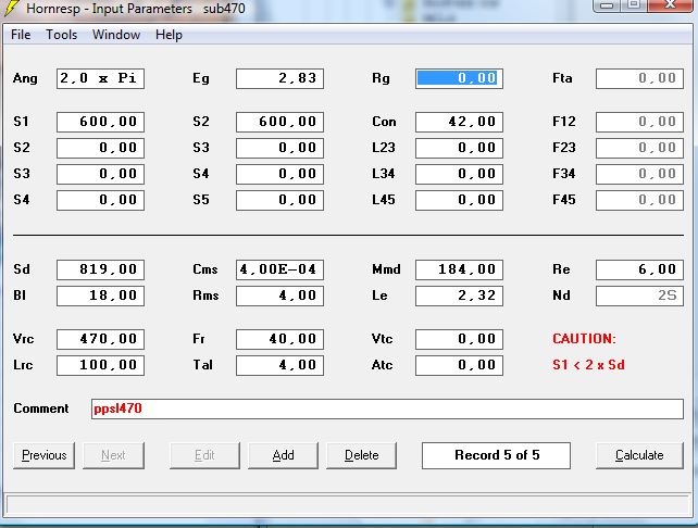

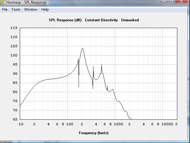

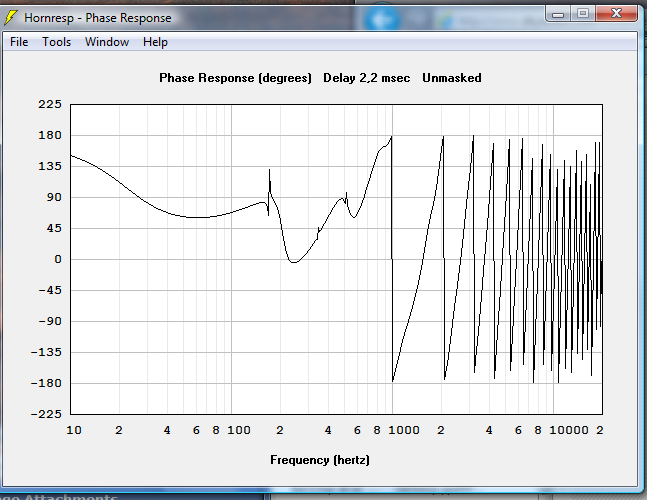

Finally I got some Hornresp graphs. I hope they are sane. Rear chamber effects not masked - I need to put polyester wool inside! Do not pay attention to spl value, it might not be 1W
Some overnight sensations... I put in parameters now a little differently, following instructions in this thread Hornresp for Dum... hmm... Everyone 😉 - Home Theater Forum and Systems - HomeTheaterShack.com

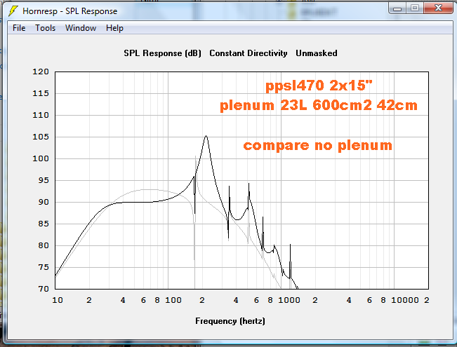

Some changes, I show comparasion of ppsl slot loading effect vs. standarnd sealed, ppsl is thick line. Both simulations with rear chamber reflections causing the trouble at 180Hz (no problem really because of high-pass at 80Hz
There is 2dB slot loading gain at 15-38Hz, wow. But the spl curve is more even than conventional sealed.

I was never bothered by resonances when crossing 80hz@18db or 100hz@24db with a slot large enough for dual 12's or dual 18's.
What's causing the 200hz hump ?
rear chamber reflections you say ?
I assume it is the 3' long box behind the drivers.........
Norman

Norman, yep the 100cm deep cabinet. I'm not at home now but I did a simulation without rear chamber effects too, but only in one direction. This backwave makes huge effect to phase, it disturbes me even more than spl hump.
Hornresp is really pain in the @ss because it reveals box problems. I intend to put an IKEA summer matrass worth of stuffin in the box, I hope that helps a bit.

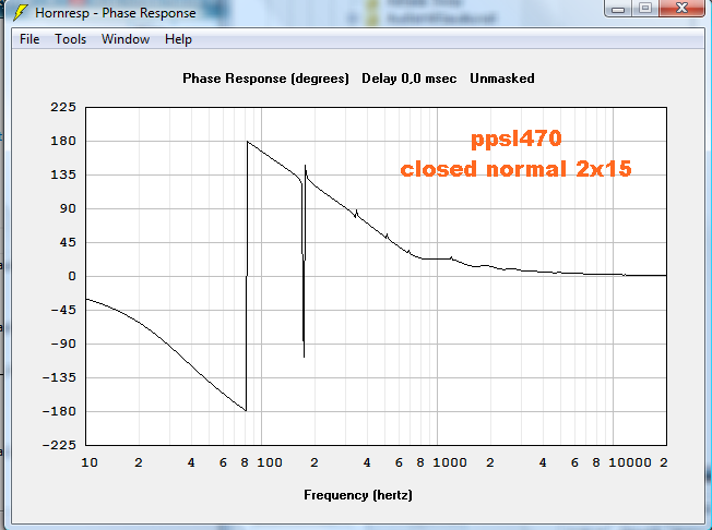

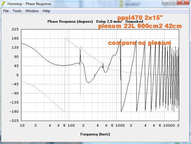

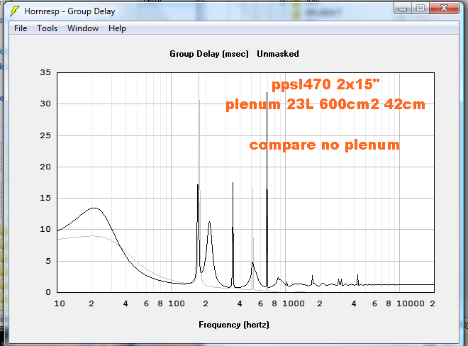

Some more clarification of Hornresp graphs. I did several iteration using differnent values for the throat segment (plenum in this case) The depth of the plenum determines the frequency of "hump", the area of plenum it's magnitude and sloit loading effect.
If the L12 is set to 20cm, the hump moves to 320Hz. and phase shift from 80 to 90Hz.

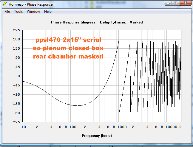

Here is what Hornresp gives to conventional closed box, no plenum, chamber reflection masked/not masked

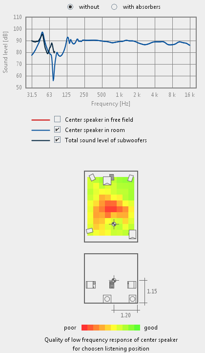

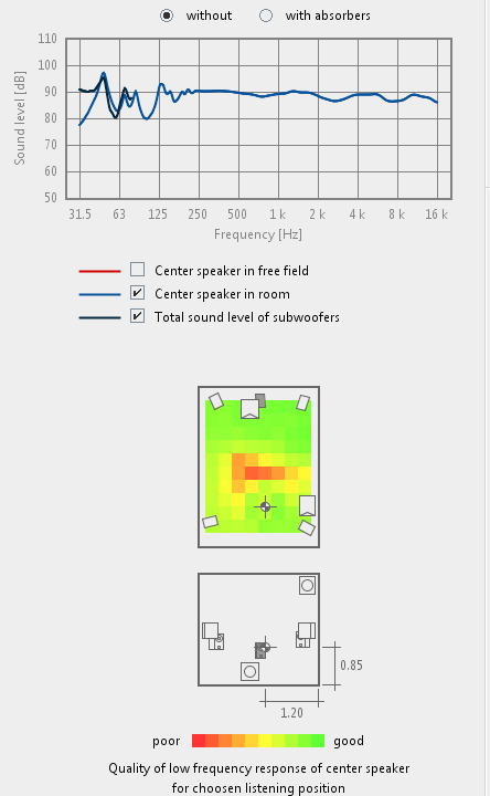

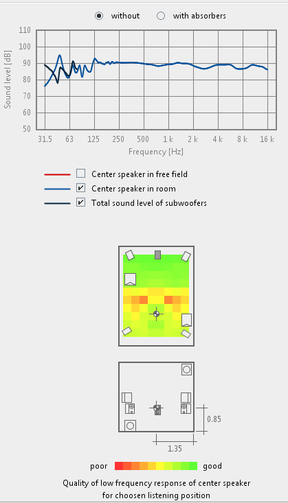

I played a little with www.hunecke.de Loudspeaker Calculator to find the position for second sub and to find best listening position and height.
It seems that the position of my new PPSL sub is almost worst possible. Too bad I can't move it. The second sub is on top of the bookshelf at 2m height and in the corner, it helps substantially. Third sub doesn't help any more really. The listening height seems to be very critical, I must keep my ears at 85-90cm (preferably the lower the better). The worst is 115cm.
The best position for a sub is in the middle of the room or on the long side near wall.

I've done these many different simulations because I still have to wait for the drivers and I simply can't do any measurements!
My bench sub is so huge that I have no other option for placement. I'm asking for trouble! I just checked that I'd have to cut both my now finished cabinets by 15cm to fit the long side of my room (left seen from listening sofa) The right side is covered with a bookshelf. Well, I could tear it and put my bench sub partially under it... But then the whole room needs rethinking.
Simulations and measurements apply only to one spot. My AVreceiver has Audyssey2 and it uses 3 measurements. I think I'll connect both subs psotiioned as simulated above and let Audyssey do EQ. Then I'll listen to it and make some REW measurements.
