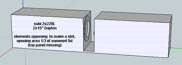

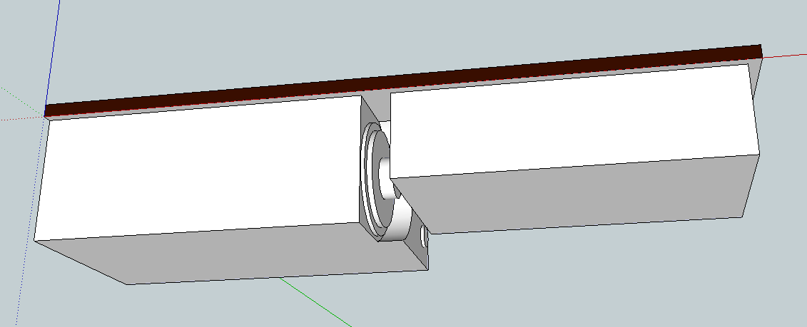

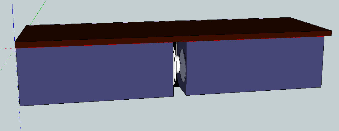

A sketch I made, not precise but helps to get the idea.
I'll make two similar 220L closed boxes equipped with Dayton DCS380-4. The boxes are positioned so that elements are opposing each other an covered with a solid top board to make a bench and prevent vibration. The slot has only one open side to the room. The area of opening is 1/3 of total membrane area 2x819,4/3=546,2666..cm2. No legs for boxes.

I'm not starting yet but it may be wise to make two cabinets. They can be connected to make slot loading sub or used as two separate subs later on.

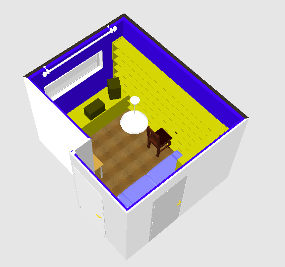

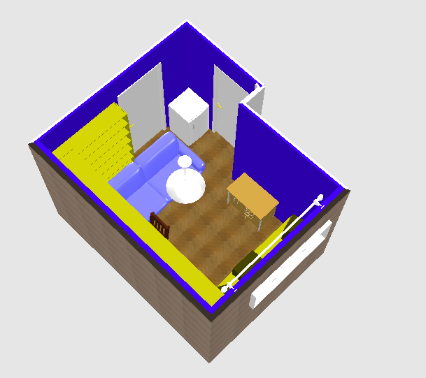

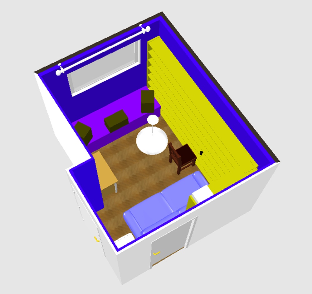

3D skeches of my home theater room where the new sub is sitting below the window
SweetHome3D Sweet Home 3D - Draw floor plans and try furniture arrangements

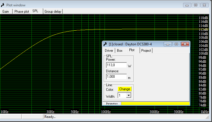

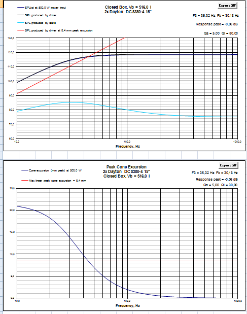

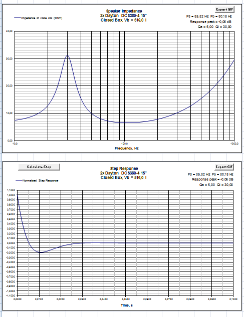

Some more precise calculations and simulations here:
Each box will have volume of 259L and golden ratio, 38x62x100 cm inside
Boxes can be ported to each other with a pipe to make pressure identical
Some WinISD and Unibox simulations, without slot gain, floor gain:
Q=0.62, F3=35Hz, max spl at F3 108dB (113W), nice group delay, phase and step response like all closed boxes
==> a precise and clean, musical sub for moderate levels? Or perhaps even more?

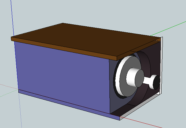

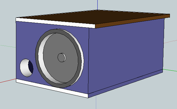

Google Sketches of boxes, to get the idea of making the ppsl plenum
Left side with the plenum filling, chamber-connecting tube and driver magnet out.
Right side with the driver magnet in
Hey, if I some day have the money for two RSS390, I could make this to two vented boxes using the openings for pipe as throats of reflex tubes! Honestly, I am sure that the closed one satisfies my spl needs for some time.

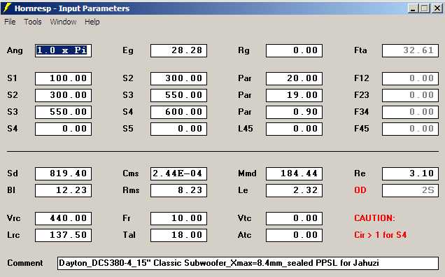

Hi Juhazi,
Post #27: "...downloded Hornresp but I have no idea which values/measurements to set..."
I'll attach what I think is an appropriate Hornresp simulation for your sealed PPSL arrangement. Assuming an iternal volume of 220L per side, you'll end up with internal box dimensions of about 40x40x137.5cm with the driver mounted on one 40x40cm end. There will be some strong resonances to contend with, most of which will hopefully be attenuated by the crossover. This will also require filling the box with some form of "stuffing".
Some of these boxes you'll just have to build, and try.
I'd stay with the sealed box for this one.

I'll make the cabinets using Golden ratio to minimize inside resonances/standing waves, and bigger 259L (h38xd62xw100 cm)
That gives me also some extra space behind the drivers for connecting tube and roundoff filling. Bigger box lowers the Q also which is good for transients and suggested by gurus of ppsl in the other thread.

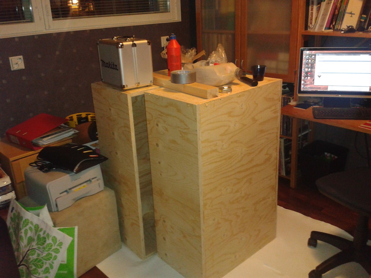

Hello Houston, the Project has been launched!
Just visited a carpenter and hardware store. The sides will be made of 21mm spruce plywood and the cover is a wenge-laminated LDF board, 40mm thick. Plywood will be cut to precise sheets for assembly, I will cut internal braces myself. I'll get the parts some time next week. The front panel might be a sandwich structure, insulation wool and a mdf board. Finally dark blue wallpaper glued onto it, like all walls of this home theater room.
The bench will be born quite soon but the ppsl sub some time next year.
Thank you all, specially "Norman" and Oliver
Juha
Juha

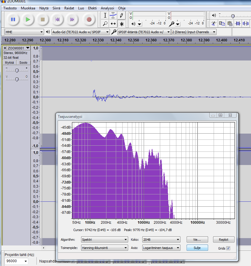

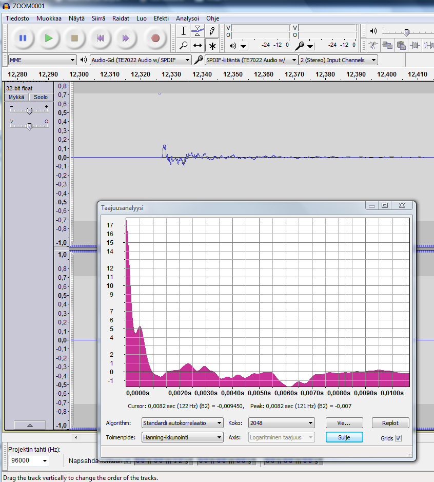

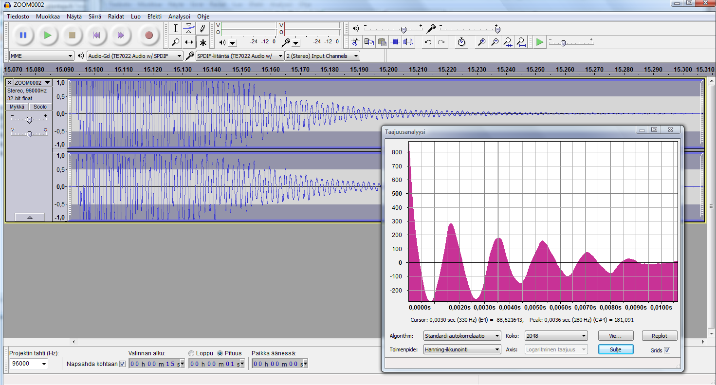

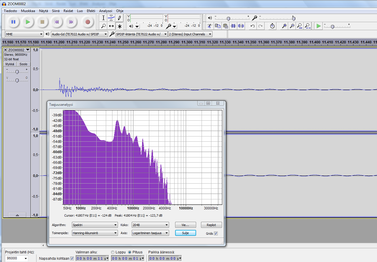

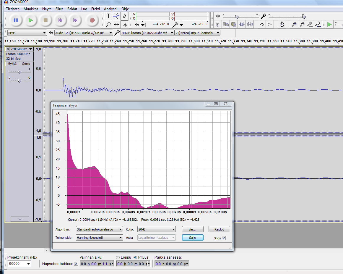

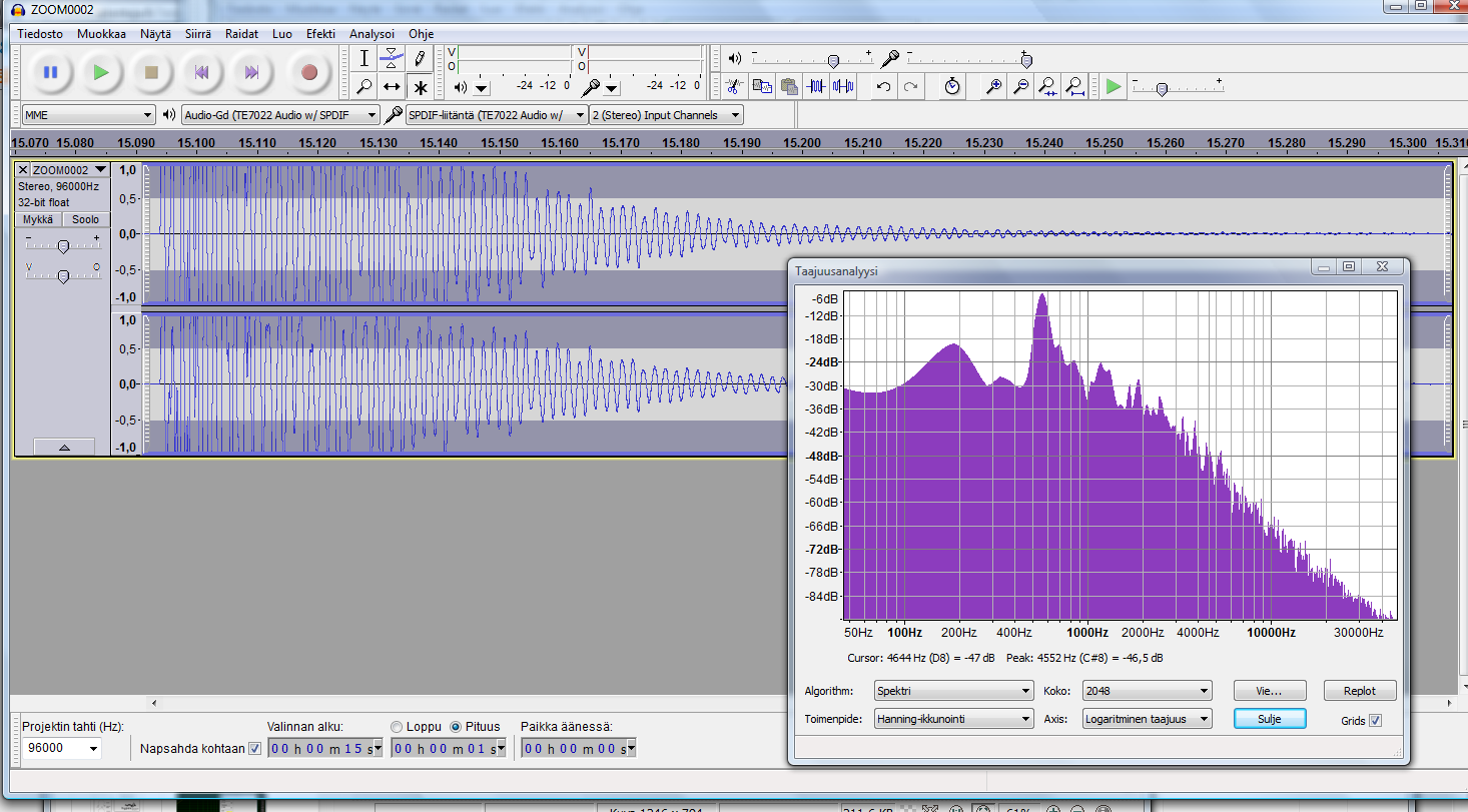

Knock on Wood
Some knuckle knock test i made. Later on I'll post also measurements of finished cabinet walls.
Method:
sheet of board held hanging in air with fingers
Microphone 10cm from the board on the opposite side of knock (knuckle)
Apparatus Zoom Q3, hardware 2.01, Gain L, 24/96000Hz wav-format
Analysis Audacity 2.0.0 Windows 7 64-bit (program 32-bit)
Sorry, the graphs are no in same scale -look at the form of graphs.
Spruce plywood 21mm 42x104cm (the 50hz humming is room mode making the board resonate! I tested aurally in different rooms)
Spruce plywood 31mm 60x40cm (microphone gain H, clipping at knock)
MDF 25mm 40x85cm

Guys, I did the knock measurements inspired by the Harbeth speaker discussion.

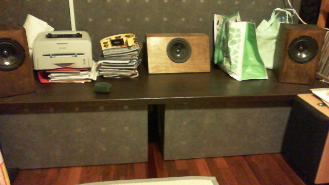

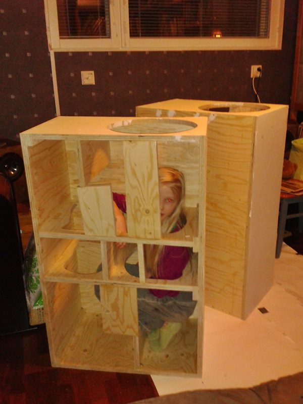

Some progress before the holidays. Cabinets are ready but the drivers are missing. A Hypex DS2.0 will deliver the power with eq and adjustable phase.
You can see my lovely carpenter givng the strategic inner structures the finishing touch.
The cabinets with wallpaper coating and the cover. You can also see some of my multiple bass traps and the minute JBL 10" sub.
Happy Christmas!
Happy Christmas!
