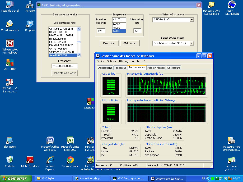

ASIOSigGen is working nice. All 8 channels of the CM6206-based Sweex 7.1 USB Sound Card are nicely individualized. Highly variable CPU usage while outputting the white noise : from 11% to 86% and a few hiccups sometimes. In noticed that the CPU usage is the same when ASIOSinGen is idling, not generating sound. This is because ASIO4ALL is not in pause when ASIOSinGen is idling. As soon as ASIOSinGen windows opens, ASIO4ALL comes alive and stays in "play". The CPU usage is thus the same when ASIOSinGen is idling, or generating a sinus (440 Hz), or generating a Pink noise, or generating a White noise. Do you get the same pattern on your side? See attached .jpg.

Even after copying bass.dll and bassasio.dll in the .exe directory, the .exe sitting in the "Self Contained" \bin\Debug and \bin\Release do exhibit the same symptoms : AB stages only, high CPU percentage, ASIO on pause.
When compiling and generating new .exe, I have no compilation errors, I only get the usual compilation warnings, and the result is the same.

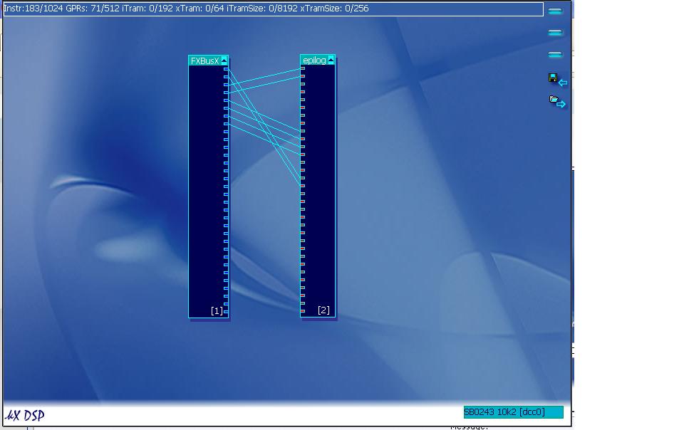

I'm fully aware of this. I was after a multichannel sound card that cost virtually nothing. So the secondhand Audigy 2 ZS works as long as the Kx drivers are installed, otherwise, with the Creative drivers there is the problem of preset direct routing from input to output, which wastes two output channels. Using Kx, you have total flexibiility with the routing. I enclose a screenshot of how to set the routing up for what we're wanting to do. You can actually do it in real time (just double-click on the icon that appears in the system tray when the Kx drivers are installed and select the '4x DSP' button to display the routing window). Unfortunately the Audigy has less-than-perfect resampling to its internal 48 kHz sample rate.
The Creative X-Fi series are much better, specs-wise, but cost a bit more. However, they can be used with the standard Creative drivers, because these provide an 'Audio Creation' control panel that allows you to turn off any direct routing from input to output. Apart from the non-audiophile 'brand image' (they're just not expensive enough) they're pretty much perfect for the job.

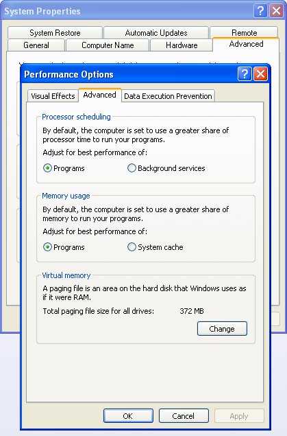

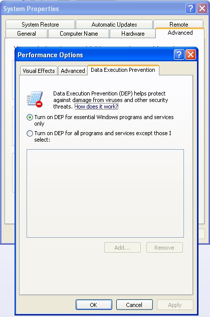

Or perhaps this is my Windows version. Currently it is WinXP SP3 French. What is your WinXP language and version? Are special WinXP permission needed for alowing the callbacks?
I'm running XP Professional SP3. In Control Panel->System Properties->Performance (not somewhere I've ever looked before!) the settings are shown in the attached screenshots.
