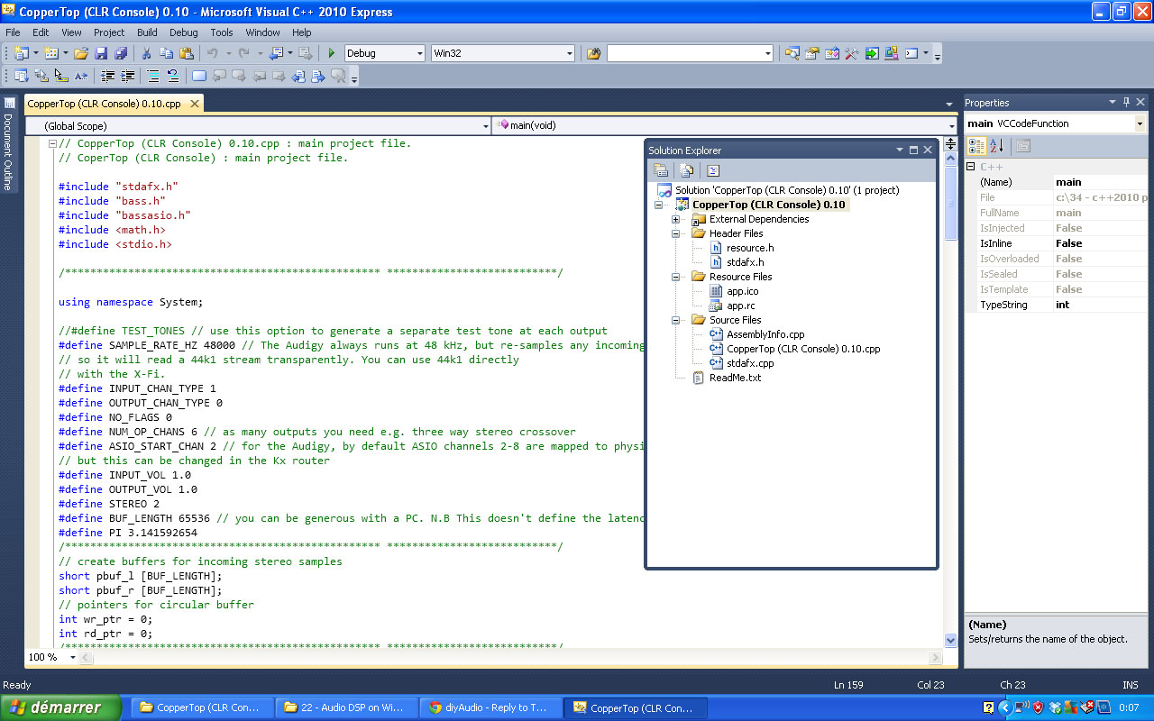

Here is how to build a bare-bones framework for audio DSP.
You'll need:
(a) a PC with Windows XP (or maybe Vista or Linux, but I'm less sure of those alternatives)
(b) a means of compiling programs
(c) a reasonable quality sound card that will let you select any source as input to your software (SPDIF, CD, 'Wave' etc.) and provide enough analogue outputs. Two very cheap options, readily available secondhand are:
- Creative Audigy 2 ZS plus Kx open source driver (very cheap, fixed 48kHz sample rate but happy to resample any other sample rate with 'adequate' quality)
- Creative X-Fi (not Xtreme Audio) and the Creative supplied software (very high quality, can be bit perfect at popular sample rates, perfect resampling otherwise)
(d) The free BASS audio library.
The basic software 'infrastructure' provides a means of doing the following:
- Detect available sound cards
- Detect input sources (SPDIF, CD, Wave), and output destinations (ASIO output channels mapped to physical outputs like Line L/R, Centre L/R etc., and you can change the mapping using the sound card's 'applets')
- Select card, input source and output destinations
- Start 'recording'
- Start 'playback'
Your DSP code runs in between recording and playback, processing the recorded samples and pushing them out for playback over ASIO channels. Latency depends mainly on how complex the processing is. You can use this framework to build your own active crossovers, room correction algorithms, guitar effects etc.
Build your code with the BASS and BASS ASIO libraries (and put the DLLs in with the executable) and use the following basic framework. I've stripped out all the error checking etc. to simplify it; refer to the BASS documentation for gospel info on how to use each function properly! The BASS library comes with quite a few examples, but none of them is quite as targetted and simplified as the program below. Sorry for the disappearance of the tabbing - it was tabbed OK when I pasted the code in.

The above program detects available ASIO output channels and asks you to select which device you want to use for output. A number of ASIO output channels are then 'joined' to form a sample-synchronised group.
The program then detects available recording input devices and asks you to select one, plus the input source. Inputs and outputs should all be on the same sound card.
Two callback functions are set up:
- a recording function pulls 16 bit samples from the stereo recording source and sticks them into a circular buffer
- a playback function continually pulls samples from the circular buffer and shoves floats into several ASIO output channels as a simple demonstration. There is also an option to enable test tones generated at individual frequencies at each analogue output.
The two callbacks produce and use data at exactly the same average sample rate.
Your DSP code can live in either callback function, or the main loop if you arrange it that way.
The above program uses about 1% of a 7 year old PC's processing power. I have found that my three way stereo crossover using very inefficient code and large FFTs takes about 30%. PCs are very powerful!
You can see how the output data is interleaved in the playback function. ASIO channels 2-7 are grouped so that you just have to stuff floats in channel sequence into the buffer. The 'length / 4' is because length is in bytes, but we're using 32 bit floats (could use 'sizeof (float)').
The two sound cards mentioned above have flexible routing allowing the ASIO output channels to be mapped to any physical output(s), and this can be accomplished using the sound cards' own 'applets' (I won't go into it here, but could explain it in another post). For both cards, 'Wave' is routed to the main stereo outputs by default, but can be turned off, thus freeing up those outputs for your processed audio. The Kx driver (and additional GUI-based software) is indispensible for the Audigy, and for the X-Fi use 'Audio Creation Mode' within the Creative-supplied control panel.
In practice, the idea is that you won't get any sound out of the sound card until the program is running.
Programs such as media players etc. will feed the default audio device as set up in the Windows control panel as normal, and it is this device and input that you select as your recording source at runtime.

In order to keep everything open source and ultra-cheap (or free) I just downloaded Codeblocks, an open source C IDE as an alternative to Microsoft Visual Studio etc.
Download binary
(I downloaded the version with Mingw included)
I created a 'console project' called 'Active Crossover' and cut and pasted the program text from the first post into main.c.
I placed bass.lib and bassasio.lib in the same directory as main.c.
In Project->Build Options->Linker Settings I added bass.lib and bassasio.lib. (For some reason I had to select 'No' when asked whether to use a relative path, as the alternative failed to compile.)
I then built the program using the Build menu (there were a few warnings but no errors). I placed bass.dll and bassasio.dll in the Bin\debug directory along with the newly-generated Active Crossover.exe.
I ran a media player program having previously disabled direct routing from 'Wave' to any analogue outputs in my Audigy 2 ZS card (using the Kx '4xDSP' GUI), but I know you can do the same in the X-Fi Audio Creation control panel. I then double-clicked on Active Crossover.exe, selected the appropriate sound card options when prompted, and music came out of my headphones. Hopefully the same would happen for you.
Just spotted an error in the code. Replace the '4096' with something bigger in this line:
while (wr_ptr - rd_ptr < 4096);
e.g. 10000
or you will get glitches. You can set specific callback periods for recording (see the BASS documentation for BASS_RecordStart (..)) and ASIO plyback (BASS_ASIO_Start (..)) which you might wish to do if low latency is important.
Other than that, if you can get the program to compile and run successfully, you're home and dry in that you can now place any DSP processing you like in between the record and playback callbacks. I've been using the FFTW library FFTW Home Page for FFT-based crossover filtering, which could also give you room correction 'for free', for example.

hello,
installed bass.net
created a new CLR Console project on Microsoft Visual C++2010
entered the bare bones framework C source code (from above)
added bass.net in system references using the solution navigator
copied bass.dll and bassasio.dll in project subdirectory
warnings and errors at the .exe generation stage
could not generate the executable
see attached .zip
any advice welcome
  • CopperTop (CLR Console) 0.10.zip
Could you try changing line 162 to this?:
BASS_ASIO_ChannelEnable(OUTPUT_CHAN_TYPE, START_CHAN, (ASIOPROC*) AsioOutProc,0);
Unfortunately, the linker needs to know about START_CHAN. The linker generates the following report :
1>------ Build started: Project: CopperTop (CLR Console) 0.10, Configuration: Debug Win32 ------
1> CopperTop (CLR Console) 0.10.cpp
1>CopperTop (CLR Console) 0.10.cpp(134): warning C4996: 'scanf': This function or variable may be unsafe. Consider using scanf_s instead. To disable deprecation, use _CRT_SECURE_NO_WARNINGS. See online help for details.
1> C:\Program Files\Microsoft Visual Studio 10.0\VC\include\stdio.h(304) : see declaration of 'scanf'
1>CopperTop (CLR Console) 0.10.cpp(143): warning C4996: 'scanf': This function or variable may be unsafe. Consider using scanf_s instead. To disable deprecation, use _CRT_SECURE_NO_WARNINGS. See online help for details.
1>CopperTop (CLR Console) 0.10.cpp(147): error C2440: '=' : cannot convert from 'const char *' to 'char *'
1> Conversion loses qualifiers
1>CopperTop (CLR Console) 0.10.cpp(163): error C2065: 'START_CHAN' : undeclared identifier
========== Build: 0 succeeded, 1 failed, 0 up-to-date, 0 skipped ==========
