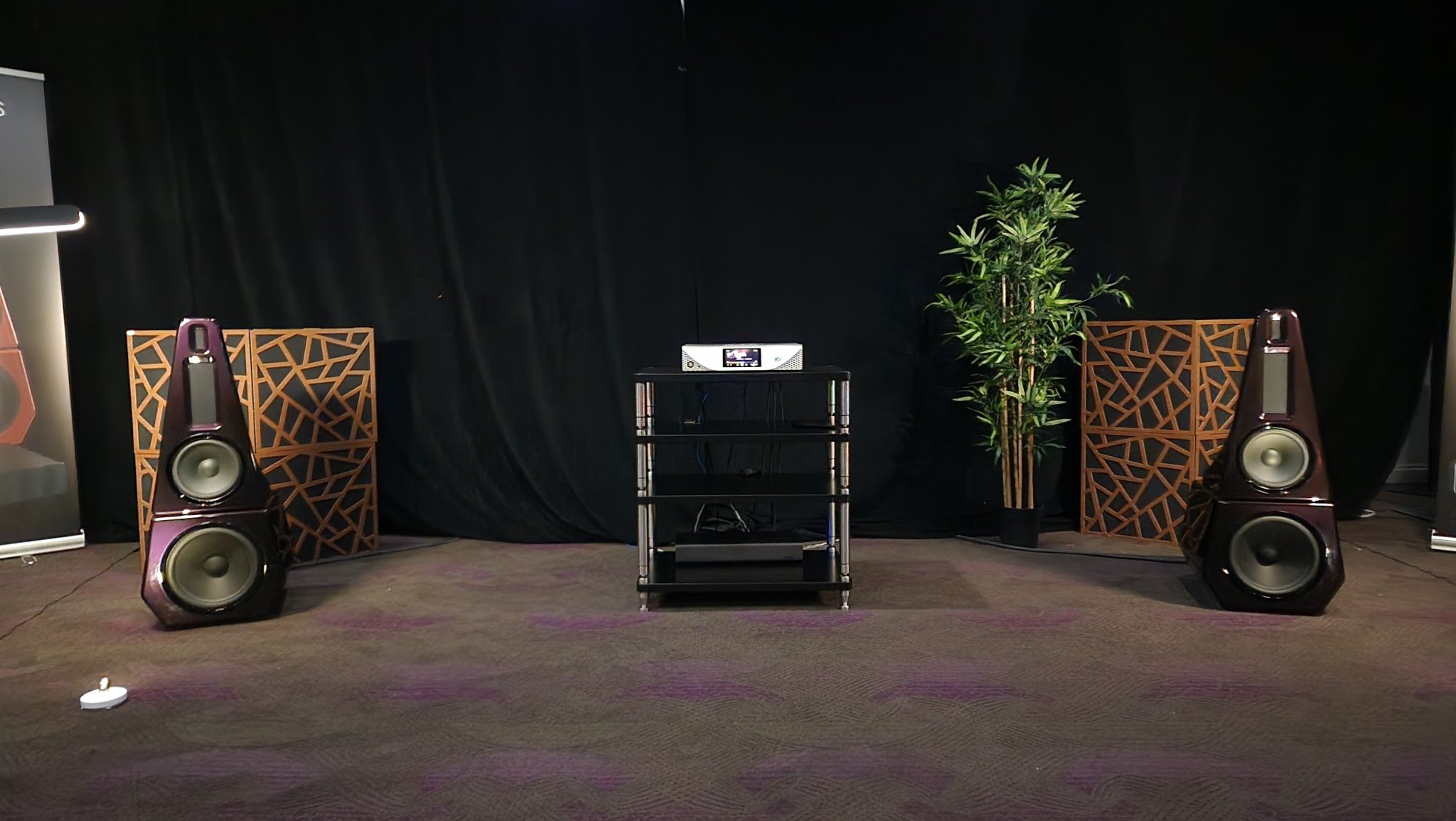

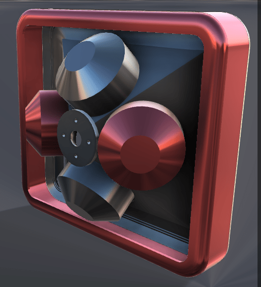

A 3 way design study
Just a thought..
Do we need that big box behind the horn.. Obviously it will have some effect on directivity down low.. But still from the looks point of view..
Or something like this with each driver in its own separate 1.5 lire enclosure is fine (ignoring the colours for the moment 😀 )..
Reactions: DorinD

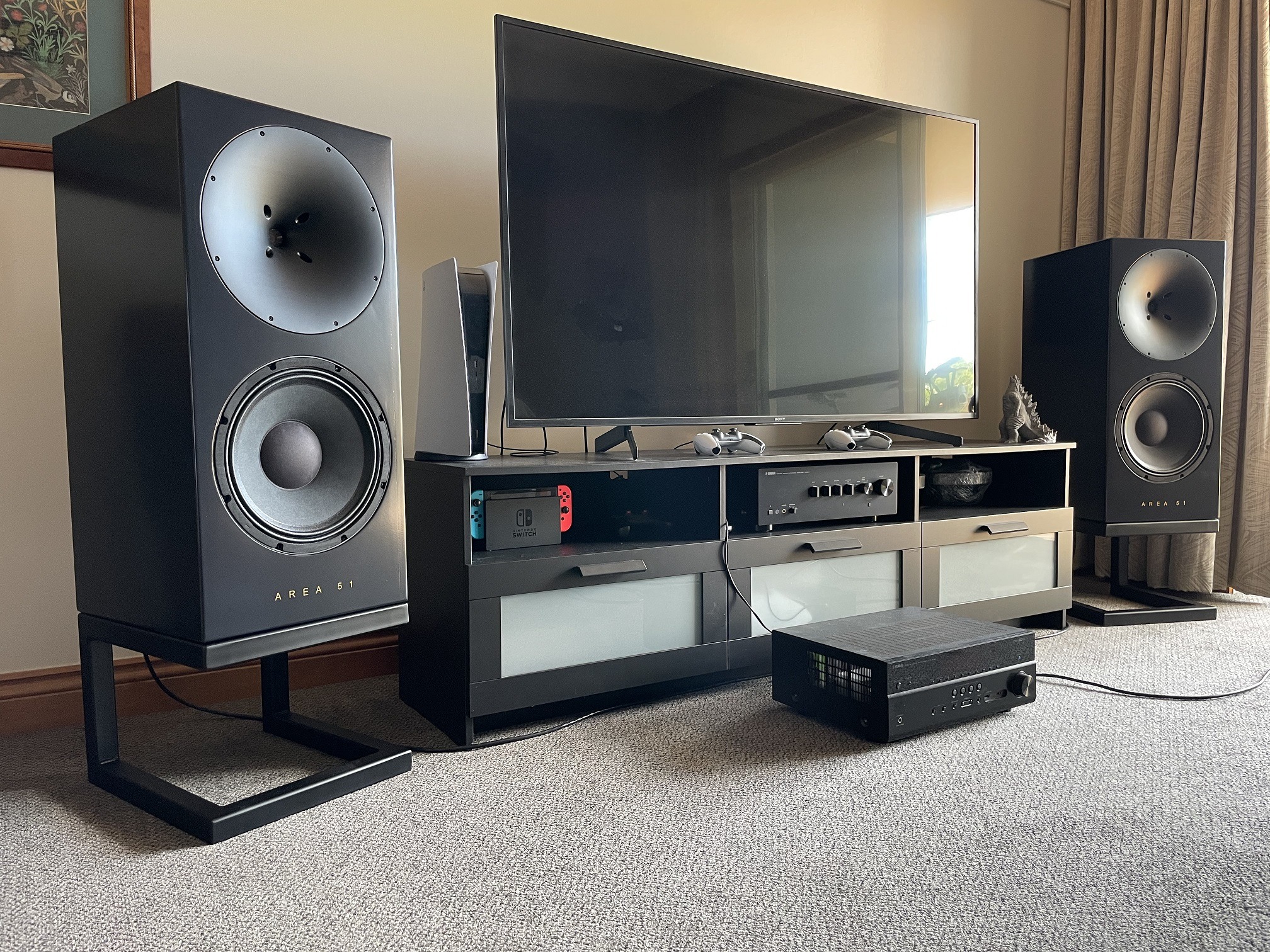

I like the Area 51 speakers as well. But that speaker was based on a 12inch woofer + MEH concept, I think..
Looked like a really good design, implemented well as a one-box solution.
The whole problem with my use case of this MEH that I am building is that I am trying to re-use the dual 15inch woofer module with the associated constraints/compromises in looks and performance..
I know it is unnecessary work when one thinks about what is possible and straight forward to do.. 😀
Make the MEH waveguide slightly wider (currently, it is 430mm in width including the "roundovers") and mate it to a good 18-inch woofer in a shallow depth closed box. Probably, even better is to put the whole thing in a shallower box with the 18inch woofer in passive cardioid configuration and the MEH mids also in passive cardioid/closed box configuration..
That way the whole struggle that I seem to have looks made up and could be avoided.. 😀
Or maybe this mix-and-match, suboptimal thing is part of the fun, I guess.. Maybe it helps us all think "out-of-the-box".. 🤓

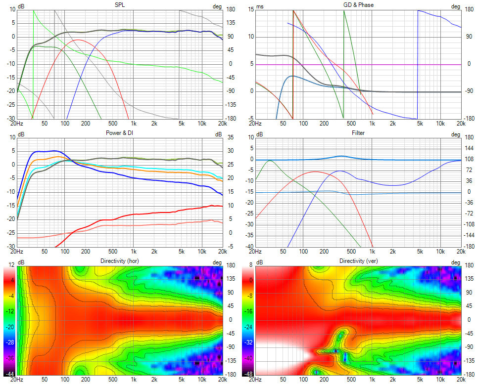

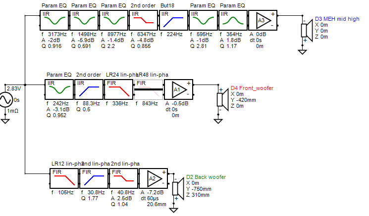

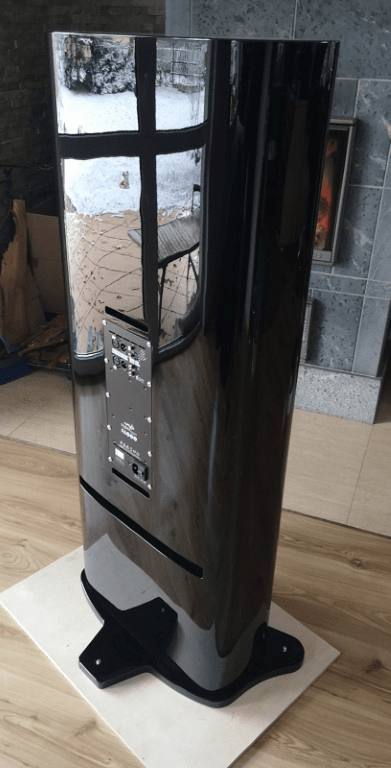

Should the MEH have a cabinet? I think it should, not for aesthetics, but to better control the rear radiation and the resulting directivity. I would shape the directivity to be cardioid-like to better mate with the cardioid-like bass you originally planned. This means at least minimal walls to contain some absorption. If you leave it completely open, I think the rear radiation will be perceived as early reflections unless the speaker is placed well out from the walls. You could close the back completely but then you have front wall SBIR to deal with.

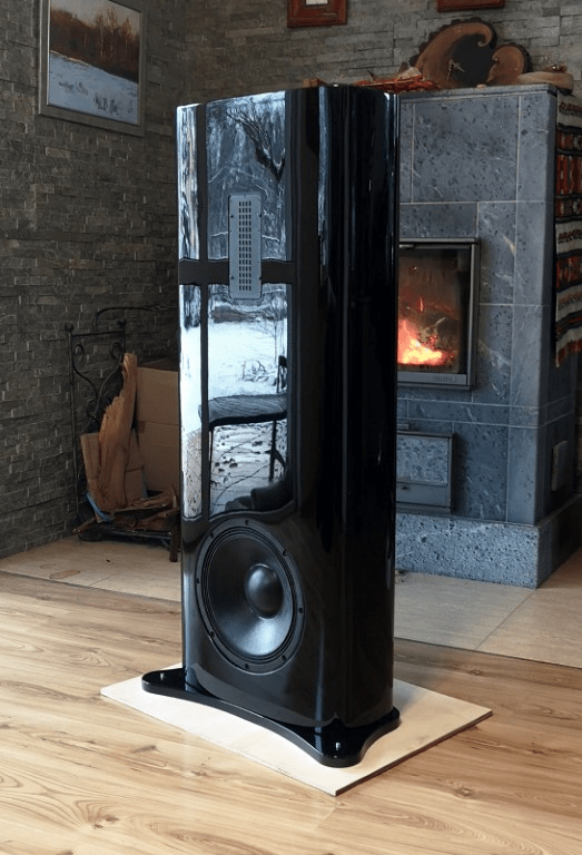

Let's take a design target of cardioid-like directivity down to 200 Hz for the MEH. The controlled rear radiation means that we don't depend on waveguide size for directivity control and can shrink it. Thus, we can have a tapered cabinet with bass supplied by a horizontally slot loaded (dual-opposed )15" woofer near the bottom of the cabinet.
I've done ABEC sims of 12" slot loaded that were clearly usable to 300 Hz. 15" to 200 Hz should not be a problem. Ideally, the MEH would be good down to 100 hz, allowing floor fired bass, but if cardioid in addition, it;s likely that some of the dynamics you are looking for would then be lost.

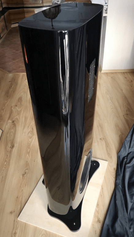

Here is a tapered cabinet with 15" at bottom, albeit dipole up top. I can imagine a horizontal slot at the widest point of the bottom cab. I can also imagine the bass cabinet being round, with an open slot on the front facing 180 degrees.

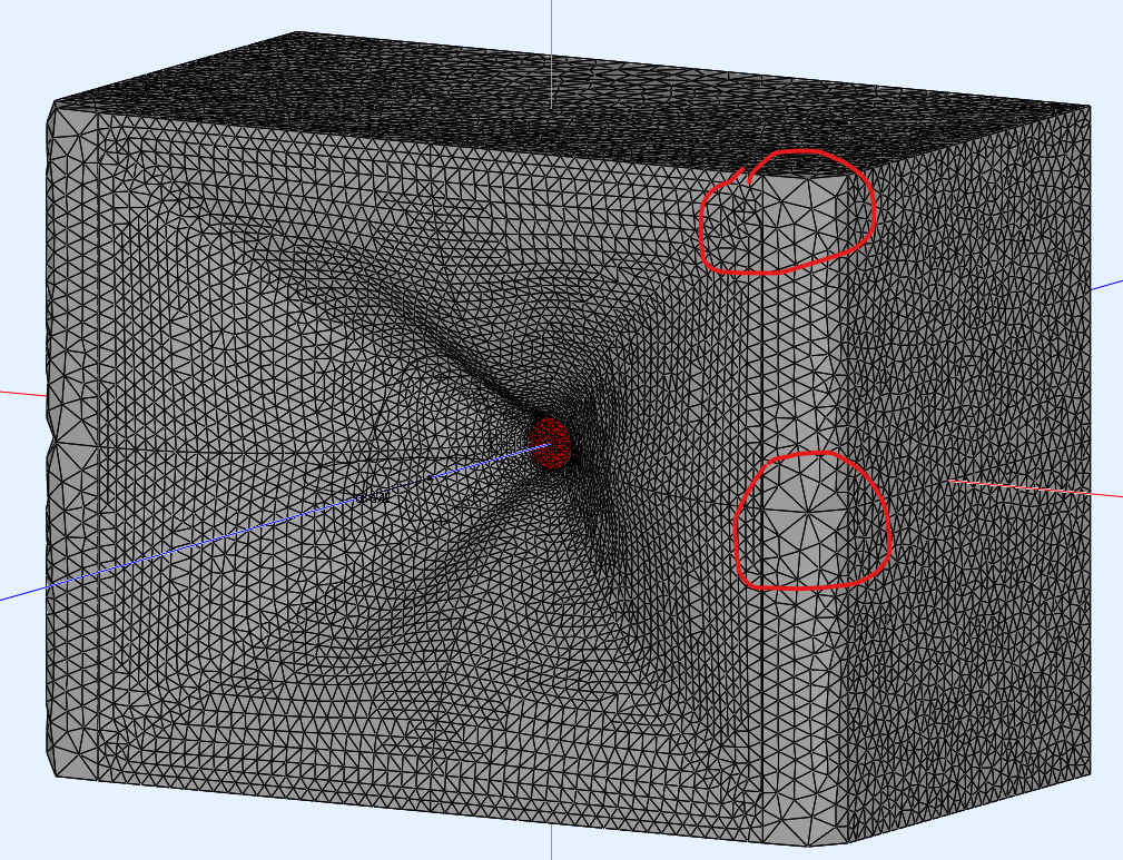

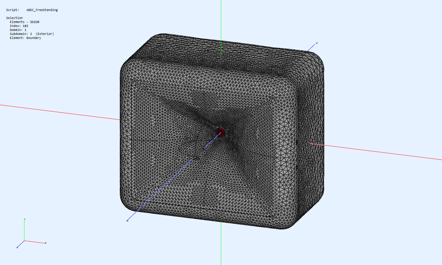

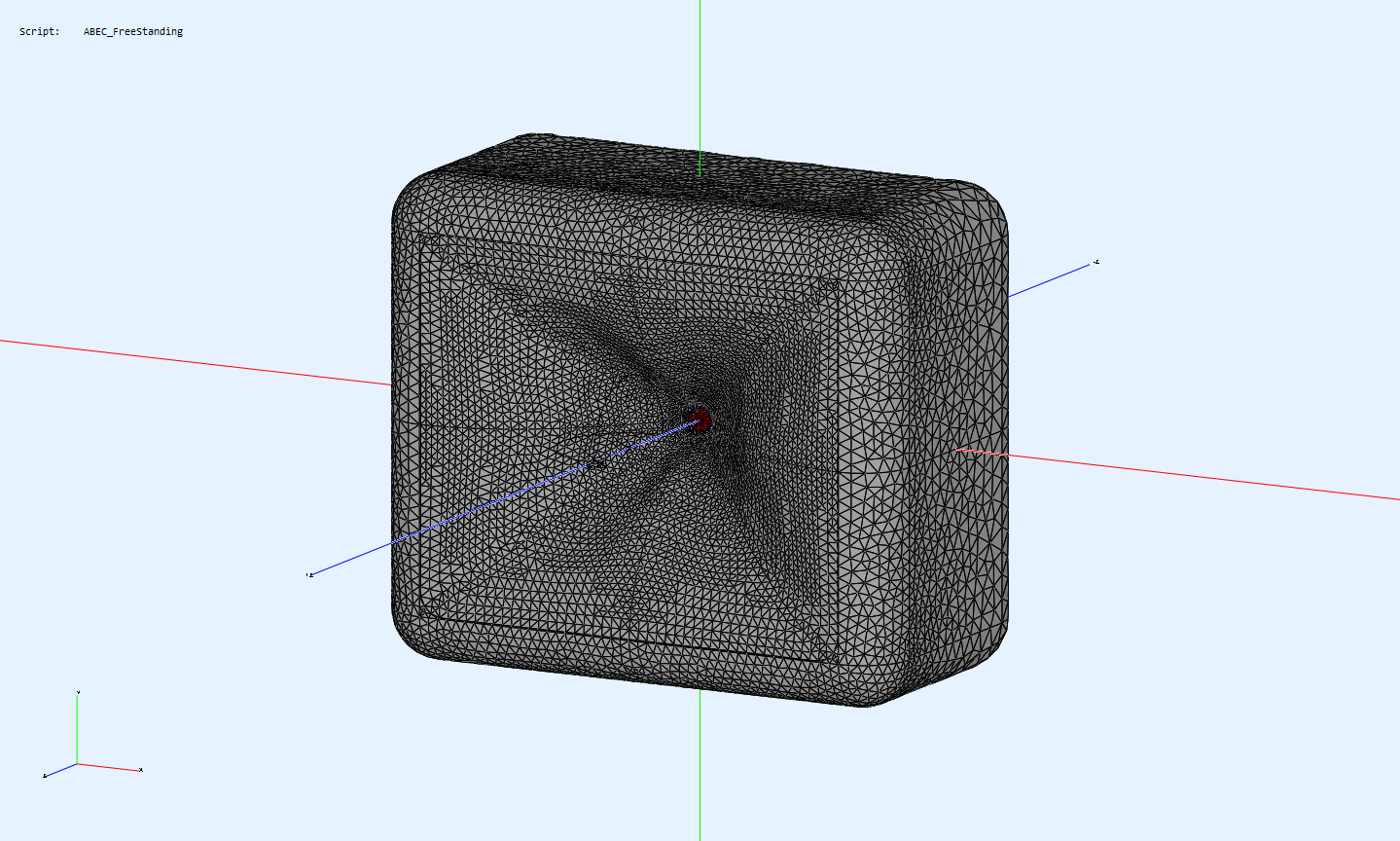

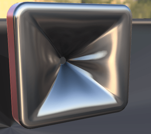

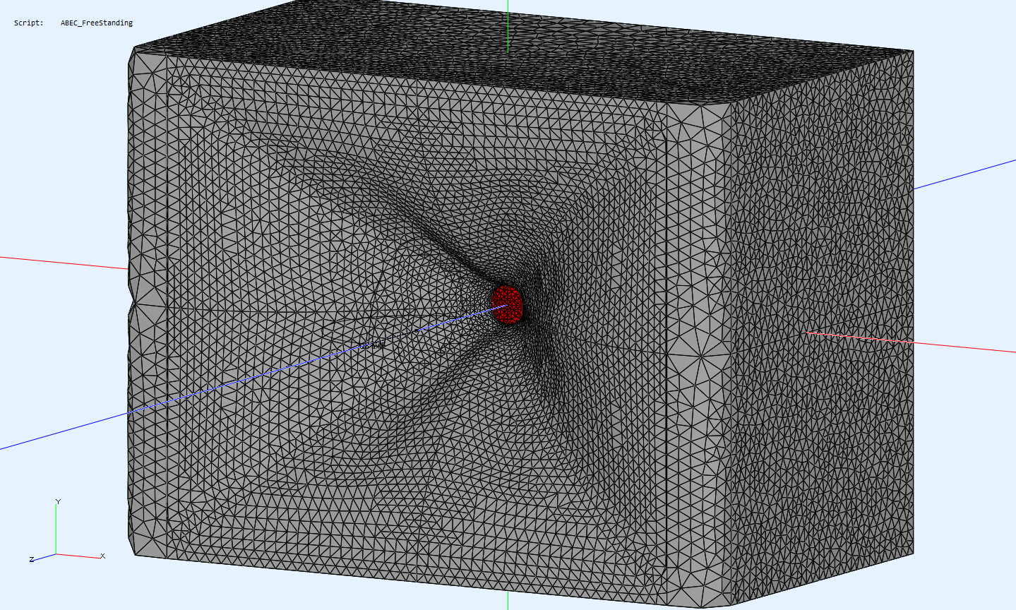

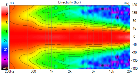

I was trying out bezier curves (because they are very nice curves... 🙂 ) for edge termination using ATH profile configs..
Can someone please tell me how to increase the mesh resolution in the circled areas (what parameter to change in ATH horn profile config file)?

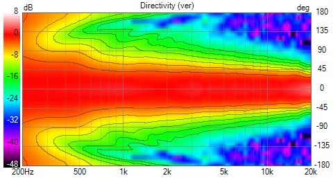

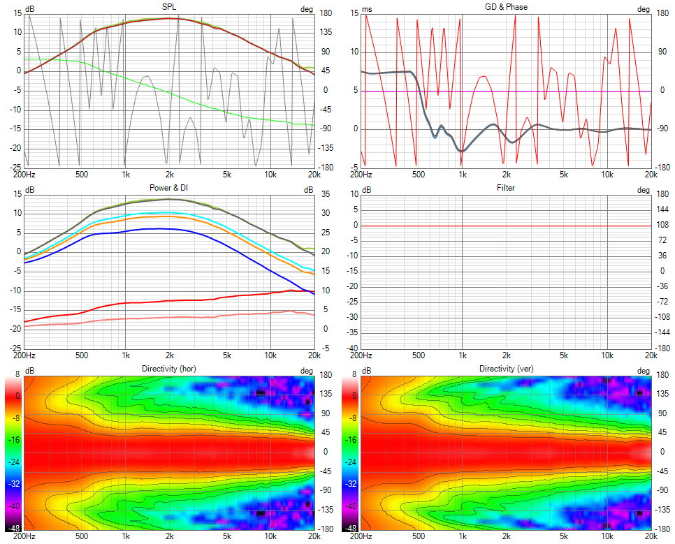

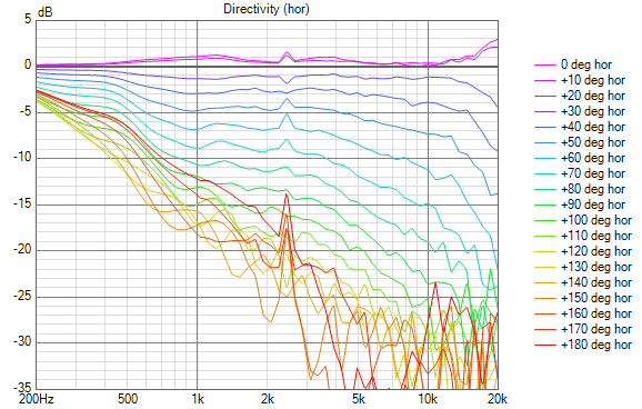

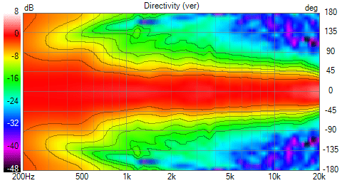

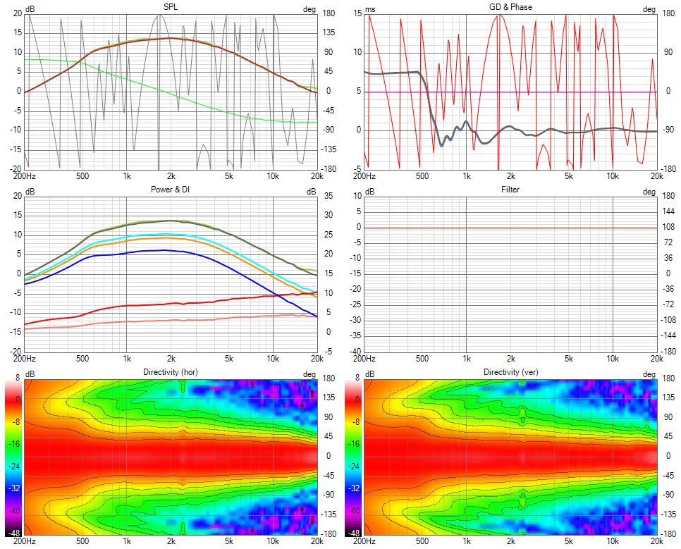

Created a 4cm waveguide termination using cubic bezier curve (probably not a surprising result)... Dimensions of the device are same as above.
Vertical polars with this one are less good-looking because of the absence of chamfers rounding on vertical edges (since I didn't know how to include this with a custom plan for enclosure in ATH)..

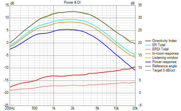

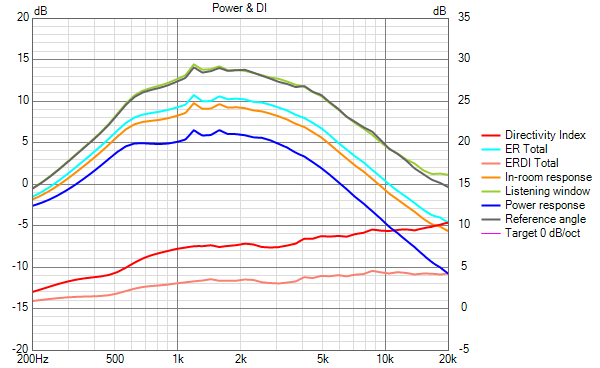

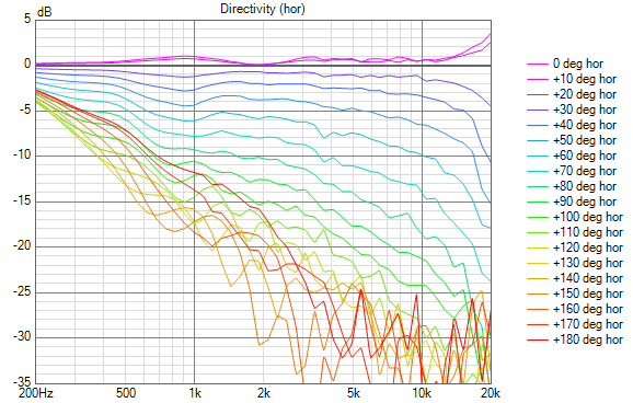

Anyway, here is a comparison with earlier 4cm rounding.. All responses are normalized w.r.t 20 degrees off axis
Rounding based waveguide termination
Cubic Bezier curve based termination
