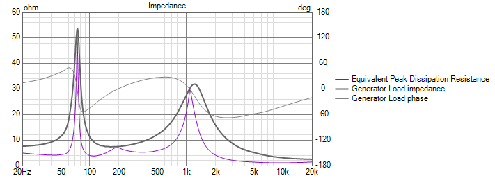

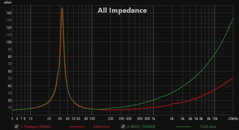

In the meanwhile, here is a comparison between the "Free air" impedance curves of the Faitalpro 15PR400 & the NERO SW800
I also sort of confirmed that the wiggle in the NERO 15SW800 driver around 28Hz is due to the measurement setup (Similar issue was there with the 15PR400 measurement also initially. When the driver was made to stand upright and not lie down like the 15SW800 during measurements, that kink vanished)

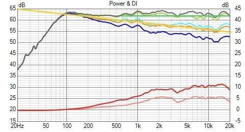

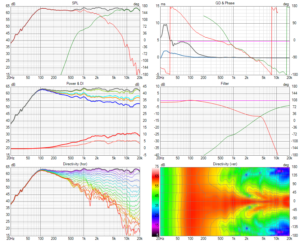

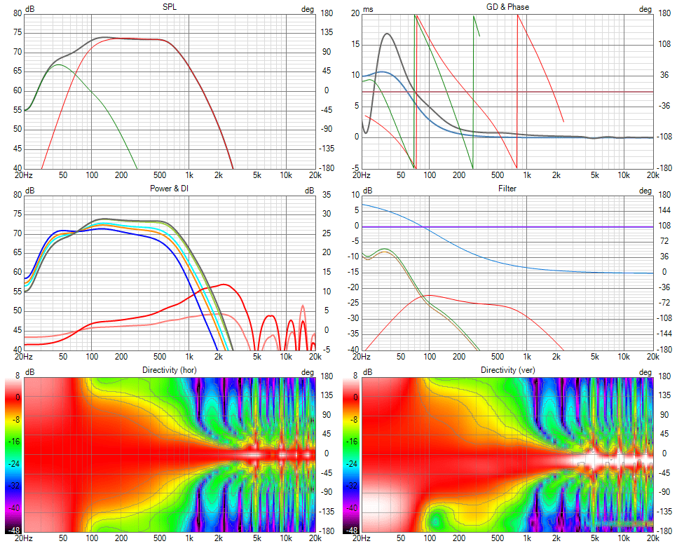

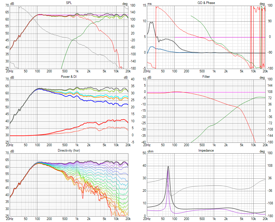

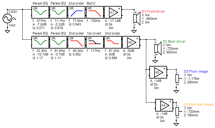

I had been fiddling around with VituixCAD for the dual woofer system and was wondering if the crossover can be done completely without explicit use of FIR linear phase filters and phase EQ (so that it can even be implemented on a DSP with no FIR capability)
In my line of work, people are interested in realizing IIR digital filters with linear phase characteristics in the passband.
There are even many papers which specify ways of doing this using IIR filters + all pass filter cascades, even optimized algorithms for doing this since long back. Just an example here: https://www.advsolned.com/linear-phase-iir-filters-analysis-design/
I was thinking along similar lines and dropped in an all-pass filter along with a normal IIR lowpass filter on the bottom woofer at the back of the cabinet and got responses like this:
This is just one example of a possibility and is close to what can be achieved with what I had done earlier using FIR filters. I haven't done any optimization on this.

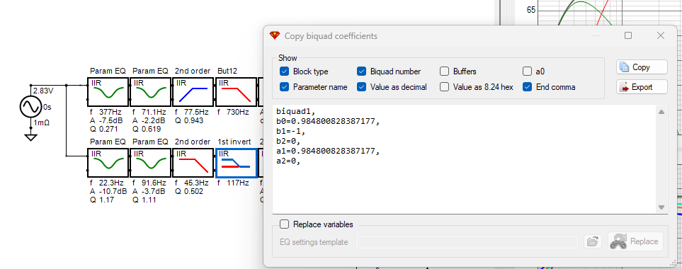

The biquad coefficients on the all pass filter block look like this for the above
By tweaking the all-pass filter and the other filters one can realize different directivity slopes in the below 300Hz region like in the FIR linear phase filter case.
However, there is a catch. The excess group delay climbs rapidly below 100Hz, which was not much of an issue with the FIR filters earlier.
So I don't know what it will sound like compared to the other kind of filtering (as this excess group delay rise is supposedly bad?)
Anyway, I just thought I would share this here 🙂

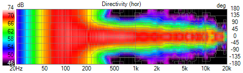

Here are the BEM sims and the comparisons with results obtained using the prototype
BEM sim-1 (No damping)
predicted polars
Prototype-1
Measured polars
BEM sim-2 (with damping = 0.5)
Predicted polars
Prototype-2
Measured polars
Now that I could see the polars improving with the addition of damping, I added maximum possible damping (but damping uniformly distributed in the slot) and made prototype-3
Prototype-3
Measured polars

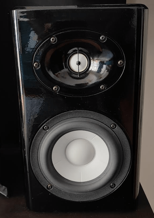

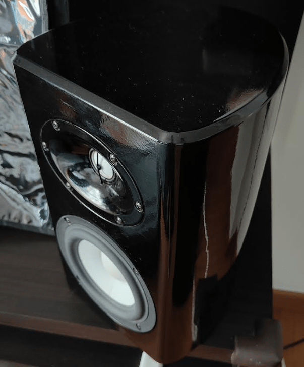

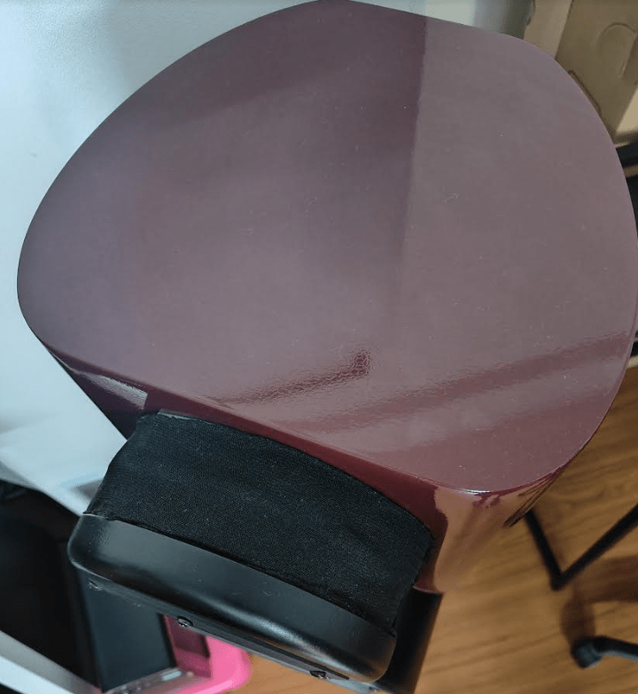

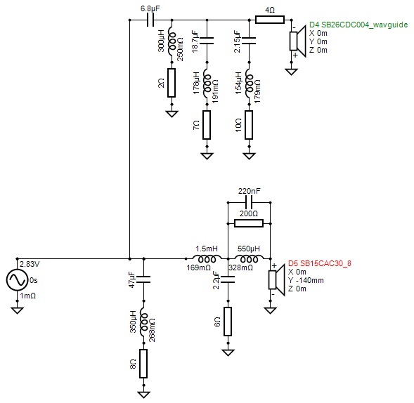

Till the big speakers are ready, I am planning to use my small SB15CAC30-8 woofer + SB26CDC on 4inch augerpro waveguide speaker (5.5L internal volume) as my TV unit speakers (I got a Sony Bravia X74L 55inch TV few days back 😀 )
Speaker has teardrop-ish shape in horizontal plane and looks like this:

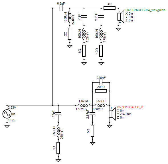

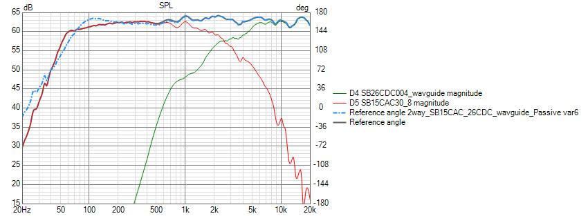

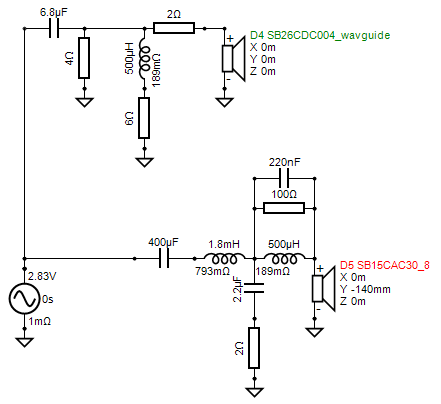

For convenience, I designed a passive crossover like this
Reverse null (although the phase matching at crossover is visible in 6pack above)

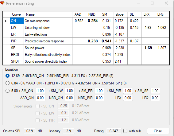

Preference ratings

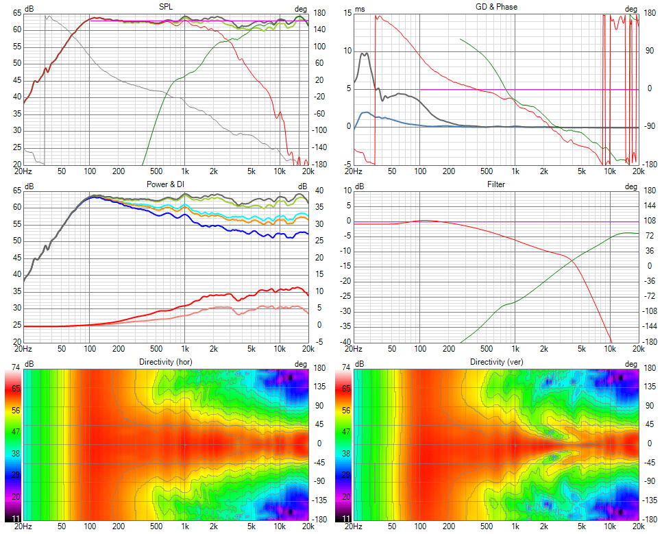

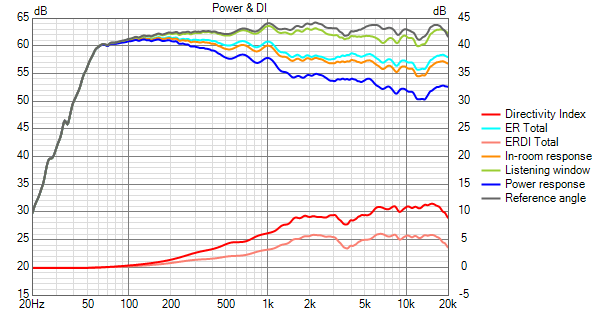

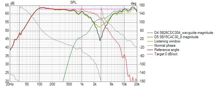

WIth a big series cap on the woofer, the response look like this
Comparison with & without series capacitor (blue curve is the on axis response without series capacitor)
Please do let me know your opinions about this design

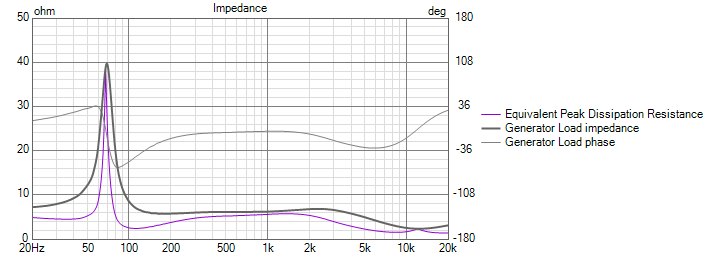

The locally available 1.75mH inductor has about 0.7ohm DCR
https://theaudiocrafts.com/x-over-p...ors/18-awg-air-core-inductor-lw-series?page=2
I think the impedance in the treble could be a bit problematic for some amps. Try to get rid of the 4ohm shunting resistor?
The bump followed by broad dip of SB17CAC35 in the 1st filter version is something of concern to me. Have you experimenten to make more flat without the large capacitor? I see it is a sealed box, so the Qts may be too high?
You could try an impedance flattening LCR for the woofer resonance to see how that influences the bass too. Needs large value coils and caps though, but DCR/ESR is not critical.
your woofer’s series inductor DCR is little high. Lowering it to 0.3ohm may help a little but the midrange/treble may still be on the high side. Depending on speaker placement I feel you need a bit more BSC:
I agree... if you could find a steel-core inductor wound with 16 gage wire, that would be great.your woofer’s series inductor DCR is little high
Depending on speaker placement and room acoustics, I feel you may need a bit more BSC: eg.

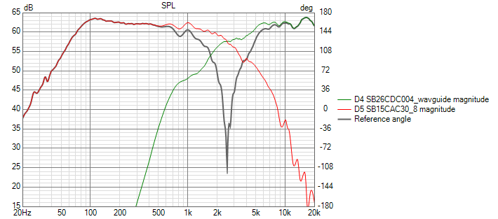

@tktran303 ,@Rallyfinnen @JanRSmit ,@hifijim : Thanks very much for the suggestions 🙂
The cabinet volume for this speaker was never really intended to let the SB15CAC driver play maximum low end. It was intended to be for that driver to act as a midrange in a 3way setup with the 2xSatori WO24P-8 acting as the woofers. So the box it not having an optimal Qts for an application like this.. I am just trying to make do with this box.
I have replaced the air core woofer inductor with16AWG steel laminated core one having a low DCR. Here are the results of crossver-v2
Reverse null
Reverse null
The enclosure volume mismatch explains the bump at ~120hz, the whole looks better, except for the broad plateau from ~500 to ~3000hz being a 1-2 db too loud, My first hunch is to tame the output of the bass/mid in that region.
The impedance dip at 11khz is still low in my view.
- A 3 way design study
