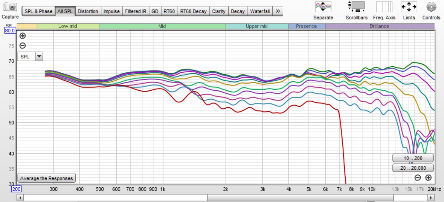

To have some more confidence with measurements and to have some sort of a reference before doing some experiments, I measured my Q Acoustics 2020i speakers today (Quasi anechoic gated at 3.7ms + nearfield wit baffle step correction applied and merged).

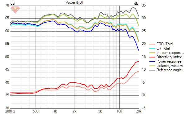

Attached pics show how the far field response looks like and the power response directivity etc from VituixCAD.

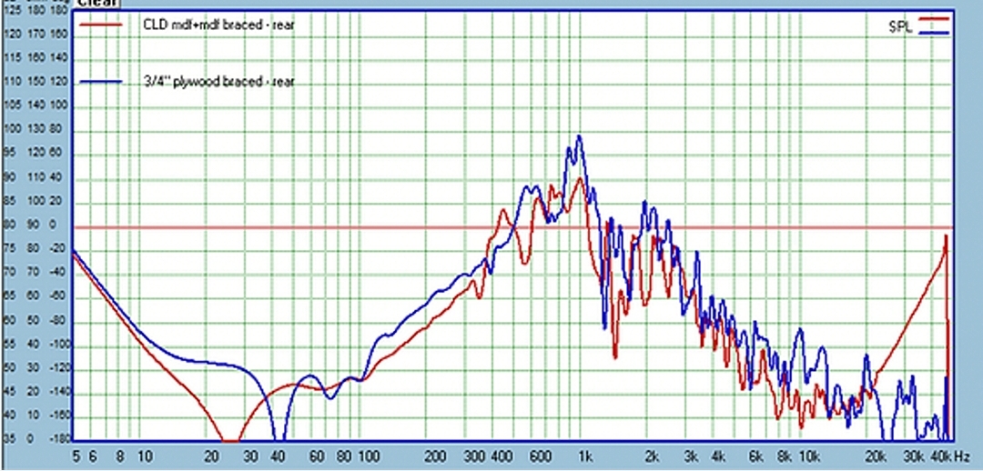

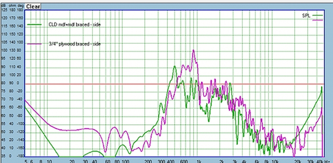

@augerpro, I got some doubts while i was reading through the last part of the box construction methods section on your website. Could you pleade help me understand more about this. I have taken a few pictures from there and attached it with this post. I hope it s ok.
In the first pic the comparison is between the CLD mdf plus mdf, CLD braced box and the 3/4 inch plywood box. I am interested in the 100Hz to 400 Hz region here since i am thinking about a woofer cabinet in a 3 way. The plot says that the rear radiation from the CLD box is more silent. Comparing with the next plot which shows reaults for the side radiation from the same box, it looks like the plywood box is more silent here. Could you tell me more about why this is so. It is because of more surface area of the sides combined than the rear. Or is it because therear of the cabinet is further away compared to the sides so that it lesser energy reaches the back?

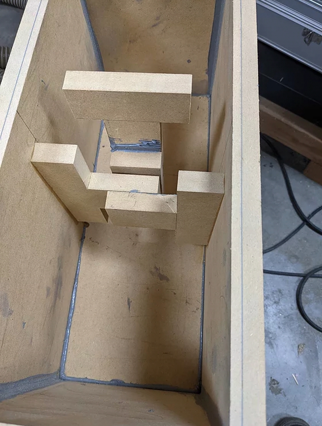

Another question that i have is regarding thd 3rd pic of the CLD box. Could you please tell me the dimensions of the box and how the bracing scheme is fixed. That is how far apart should be a set of braces (By a set of braces, i mean the four parts of the brace, each of which attaches to a wall of the box).
Also, are all the four pieces of a set joined together at the middle for thd 33% overlap. Also how are the braces joined to the sides. Is it using a regular glue or the glue used for CLD application. And how is the brace joined to the front panel of the box. Is it using the same glue?

Good questions! So don't look at anything below about 200hz, the noise floor starts to dominate there. I note this at the beginning of the tests, but I should probably restate measurement conditions whenever I post new info just to remind people.
I'm not exactly sure why the rear and side are different, that's why I just do both. What I can say is that that the rear panel is narrower, which should be stiffer - all other things equal. Sometimes I think that fact dominates the results over other variables, and so for me personally I like the side panel results as better showing the differences between materials and methods. At frequencies below the primary resonances I don't think distance from the driver has anything to do with it, it's just pressure and that is distributed evenly. Sorry I can't add more to that. I will say though that the primary resonances from about 400-1200hz should be your deciding factor. The spl is very high at those frequencies. At 200hz the levels are so low in any braced box that I'm not sure it matters if one methods looks a little better than the other.
Dimensions IIRC are 18"h x 8"w x 10"d.
Originally I used % overlap for the braces but I think the correct way to look at is the length of overlap, which would be related to the surface area of the constrained layer doing the actual work. I used 2" overlap in the example above. Too much overlap and it quickly acts like a solid brace. I have not investigated any beyond that so I don't know how other box constructions might behave differently. I did size this box to be between a standmount and woofer section of the 3-way so that results should generally be similar in those applications. But if say you were building a large subwoofer I really don't know how the overlap should be handled. Then again I would probably solid brace a sub, so maybe a bad example.
Obviously the constrained layer is the Weicon 310M Flex. I debated what to use to attach the braces to the walls and in the end I use regular wood glue. My thinking was this: I want a rigid attachment to the walls so the energy can be efficiently directed to the constrained layer. The other approach using Weicon at all connections would have different masses sort of "detached" from each other and I'm not sure how you would predict the outcome. That was my thinking for what it's worth.
A change I made with that particular example is making a T-shape instead of the simple straight "dowel" I used before. Again the thinking was by having the brace "see" more surface area of the panel, more energy would be directed to the constrained layer. Again, take that for what it is worth.

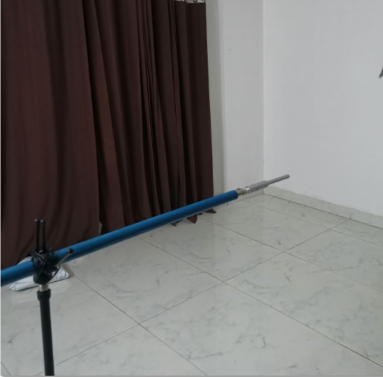

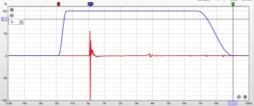

The most important part of all of this is your measurement setup. It has to be clean and accurate. So make sure you work that out. the mic should just be sticking out the end of the boom or you will get diffraction off those holders on a typical mic stand. Get everything as equid-distant from the floor/ceiling/walls as possible so you can maximize your gate. Your splicing method looks like the one I use and it works real well as long as you sweat all the details.
Thank you. I will take a lot of care with the measurement setup next time I do it.
My current measurement mic setup looks like pic-1. the mic is attached to a 1m long pvc pipe. Recently i have also tried to make transition from pvc pipe to mic also smoother instead of a sudden 3mm thick edge of the pipe. I have two rooms an almost 3m x 3m x 4m one and another one with almost 3m x 3m x 7m dimensions available for measurements. I will try to ensure minimizing floor and ceiling reflections next time. With current setup, I can get impulse responses like in pic 2 but in it the speaker was not exactly at mid height between floor and ceiling.
Currently I use nearfield + gated farfield measurements. But once I start taking woofer measurements, I may need to go for ground plane or much bigger rooms etc as per suggestions given by others. I will have to figure it out later.
Yeah that's a good mic setup.
Forget about minimizing reflections. It will never be enough. Focus on getting the largest distance possible from all boundaries, then set your gate to end before the first reflection arrives. Do you have a garage? Often the ceiling is taller in a garage than a room in the house. That might get you into the 5-7us window of reflection free sound.
Unfortunately, I live in an apartment complex in a concrete jungle of a place.
It is hard to find open spaces here and a time when all sources of noises are silent. So these days, I try to do measurements at night. I do have access to a car parking place with probably 3.5m high ceilings but it is usually filled with a lot of vehicles. Another option I have is the roof of the four storey apartment. This I will need to try out and see if it works for a better gate duration in measurements.
I will try to ask around and try to hopefully get a better place once the speaker cabinet is built by a friend who has access to tools, CNC cutting, and more experience in building speakers cabinets. If all goes well and I am able to finalize the design with all details, the cabinet building process will start by the end of this month..

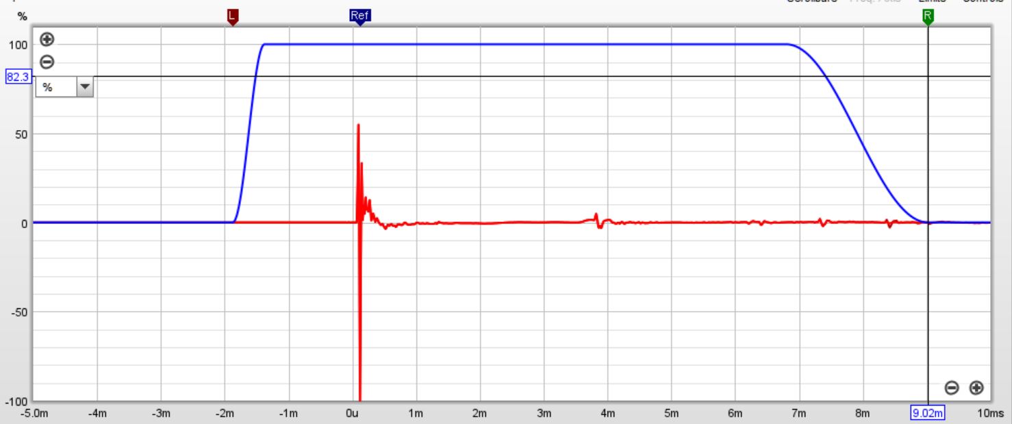

vineethkumar - I went to the effort (a significant effort) of making high resolution outdoor ground plane measurements of both a large woofer and a midwoofer. I was ~7 meters from the nearest wall, I waited for quiet periods with no wind, and I was able to get resolution down to 10 Hz.
What I found is that the Near Field technique is very accurate. When I made indoor NF measurements and then adjusted the response from 2-pi to 4 pi, my NF measurements very closely matched the outdoor ground plane measurement.
see post #124

In the future, I will not bother with outdoor ground plane measurements.

Thanks a lot for this information. I will also try nearfield method first. I was worried about the woofer-mid crossover design as my baffle wouldn't exactly be flat due to chamfers and VituixCAD currently doesn't allow modeling diffraction effects due to chamfers. I thought that this would make applying baffle-related effects on the 2pi-nearfield measurement may not be accurate. Now I am thinking that maybe because the wavelengths concerned are large enough in that frequency range the chamfers may not have any effect as they have in the case of the tweeter response.

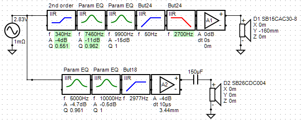

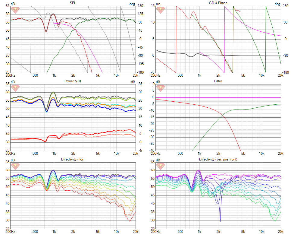

Other miscellaneous updates on this project.

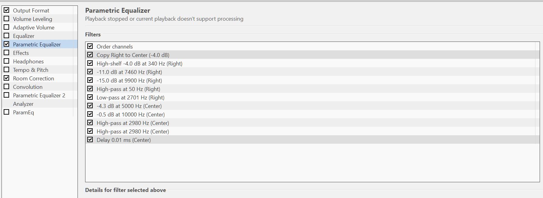

I tried to implement the DSP crossover in JRIVER software and used my 6 channel ESI U86XT soundcard for implementing it. I connected it to the current foam box where the drivers are mounted on and made it play some songs. I have attached screen shots of the crossover I designed the crossover in vituixCAD and did its implementation of it in JRIVER. The measurements used for designing the crossover are horizontal polar only ones I had taken and posted about the mid and tweeter in a previous post. I attached pics of above details below. One thing I understood from this exercise is it is really a hassle for a beginner with software dsp crossover.
compared to the plug and play approach of MiniDSP etc. But eventually I made it work somehow.

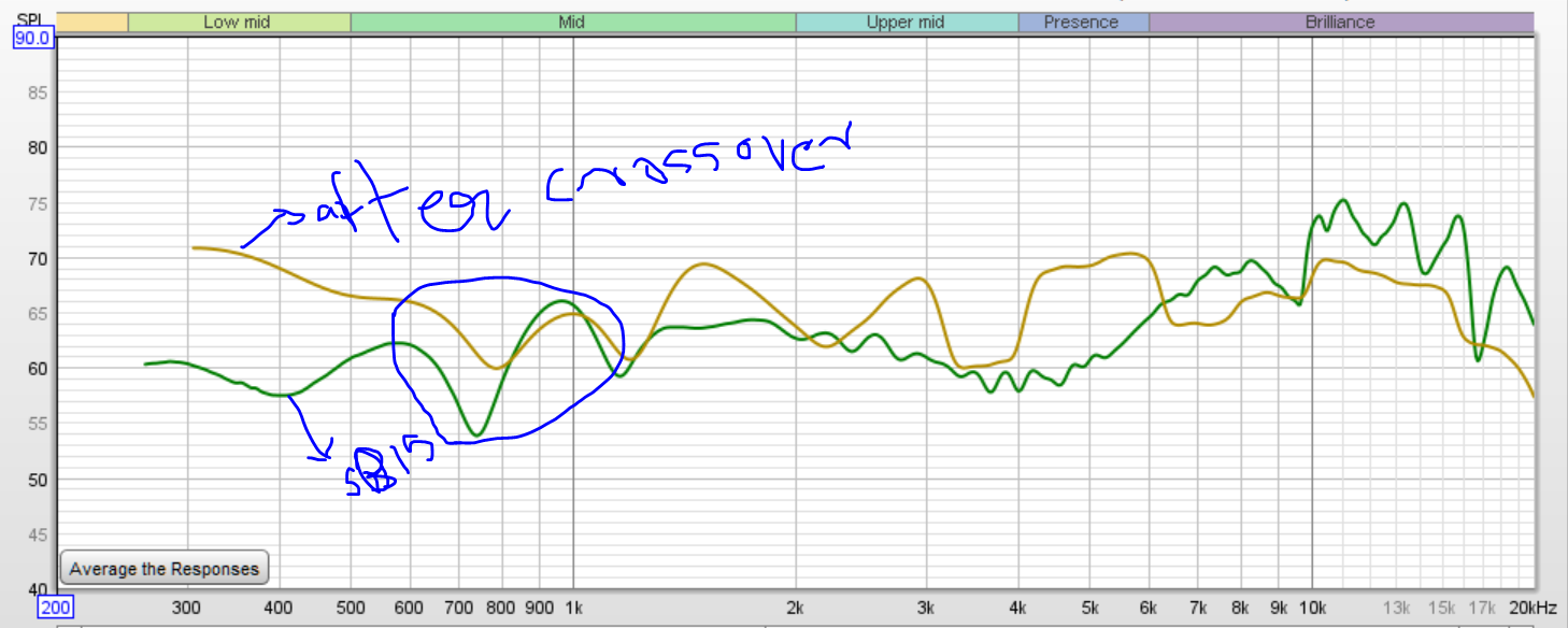

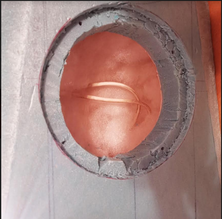

I also think I have some clue about the weirdness around 1 kHz. Thought I got some clues from measurements and graphs here which Juhazi had given me earlier. chamfering driver holes
It could be due to the llack of a sufficiently deep chamfer around the back of the mid on my foam baffle. the baffle depth is about 55mm. I attached a pic below about this.
I now made a generous chamfer at the back of the mid now and tried to take a basic on axis frequency response measurement of the full prototype speaker (except the woofer) as described above with the DSP crossover in place. The chamfer issue seems to have reduced but I see all sorts of weirdness in the response especially at higher frequencies... I have attached pics of it below. I just didnt bother debugging it since the prototype box itself could be faulty and the crossover implementation could also be the issue with whatever measurements I have. Somehow I could hear it sing well though even with all the weird measurements. However one thing I noticed straight away is a kind of disconnected sound in some sings when I was very close to the speaker. About 2m+ away from the speaker, all was sounding fine to me. Could be due to the vertical spacing between mid and tweeter I think
