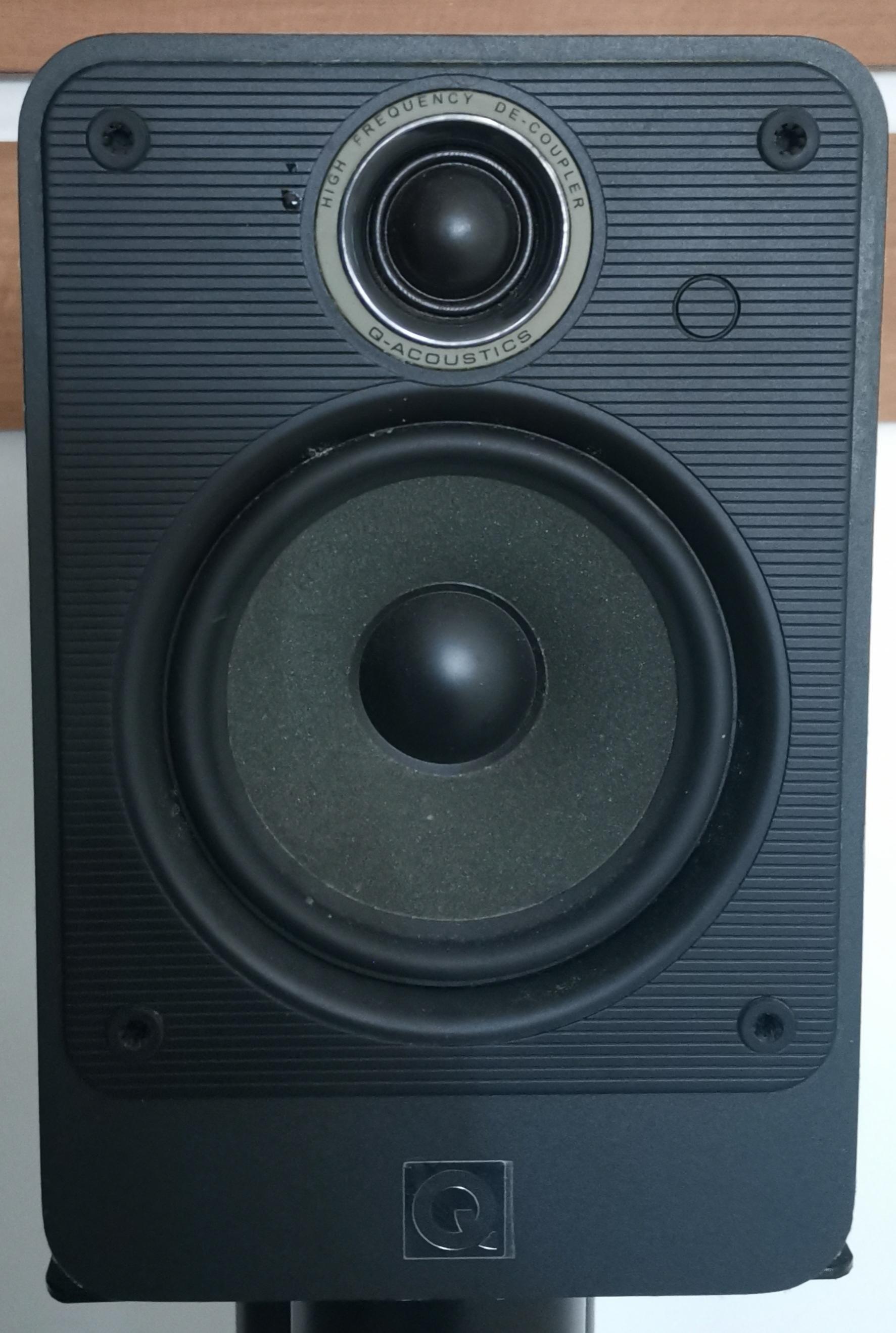

I have a pair of Qacoustics 2020i 2 way bookshelf speakers which looks to have the c-c as close as possible as shown in attached pic. The c-c spacing is about 9.5cm between the 5inch mid and 1inch tweeter and the advertised crossover frequency is 2.9kHz. So it looks like herre c-c is about 0.8x crossover wavelength.
Would this speaker suffice for this experiment? I have a largish loom of 3m x 3.5m and height 2.5m.
Yeah why not You could try but I'm not sure the room is big enough so that the changing horizontal ER wouldn't affect. Anyway, it is easy test to do for fun if nothing else. I don't know what to expect, what qualities should change.
If there is no difference in the sound, then the as close as possible is good c-c to have. If there is meaningfull difference, then you should inspect more why is it, is it truely due to better vertical ER or is it something else in the test setup.

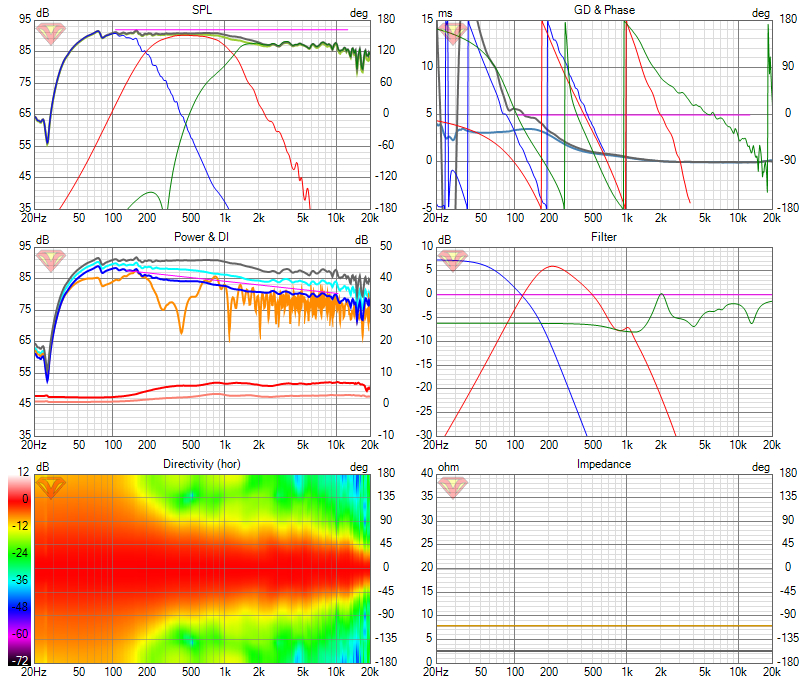

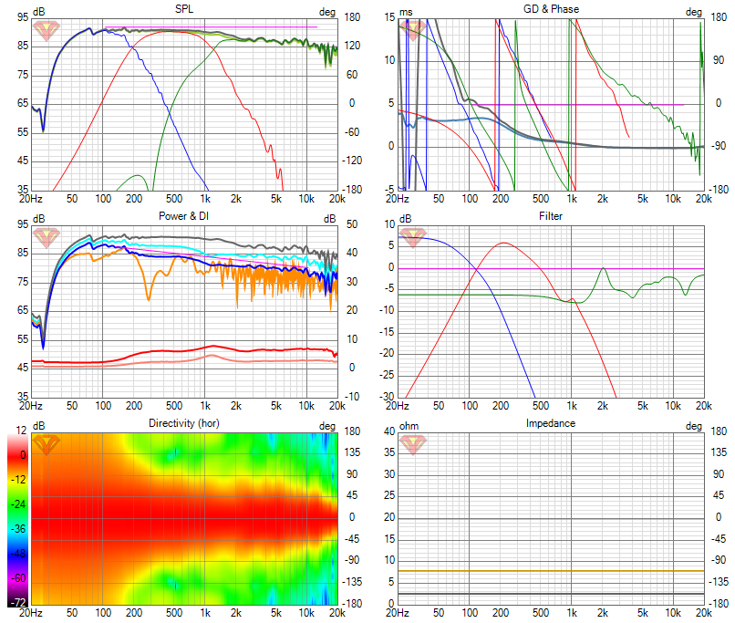

Interesting things can be tried in the simulator, but of course these would have to be implemented in reality and there might be implications that are not obvious before actually building them. Also, there might be things hidden in the simulation and the way the graphs are calculated that might not reflect the listening situation at home.
Neverthelss, attached is quick experiement where the DI and ERDI are flattened to the listening axis by tilting the waveguide by some 25 degrees. Then, increase the c-c spacing to get rid of the hump around xo. Nice flat DI and ERDI in this situation
This is 90x60 RCF H100 horn with vertical and horizontal measurements and the rest is filled in in the simulator. the mid woofer is passive cardioid, ~6dB DI, also hor and ver, as well as bass. Anyway, not measurement of real thing but all boxes separately and then simulated. Polar maps are normalized.
1. control, ~0.9wl c-c drivers flat like they would be with simple flat baffle.
2. the waveguide is tilted 25 degrees up
3. and c-c increased to ~1.4wl
Many ways to affect stuff. Very powerful thing to test out in simulator and then try to think them out what is happening and if they would make things better and how they could be implemented in reality. Even if the sims didn't reflect reality exactly, a lot can be learned.

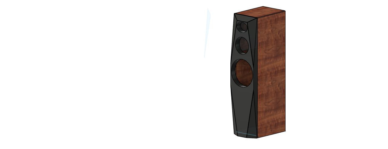

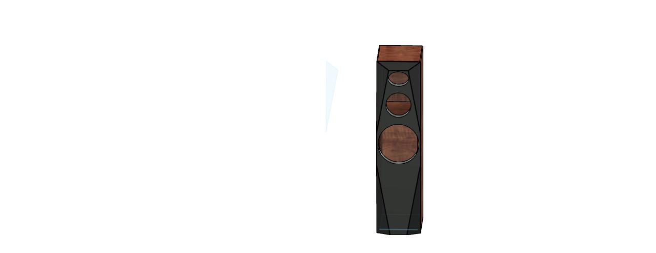

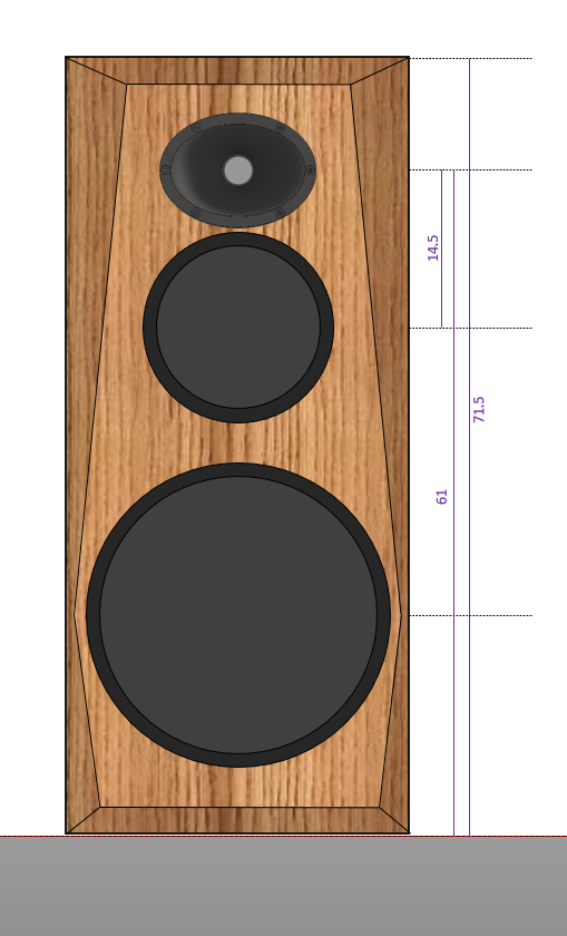

Finalizing construction plans
Attached are pics which show my preliminary attempts at sketching the cabinet (without the braces for now).
Trying to learn fusion 360 on the fly and generate a design, which I will refine further as I learn more and make progress on experiments suggested above (especially the driver spacinng )
