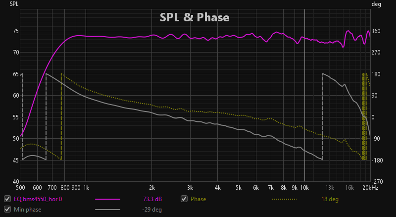

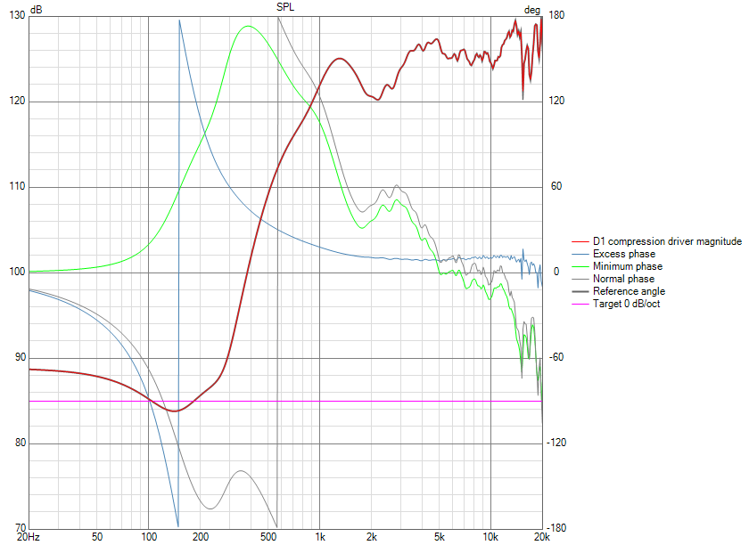

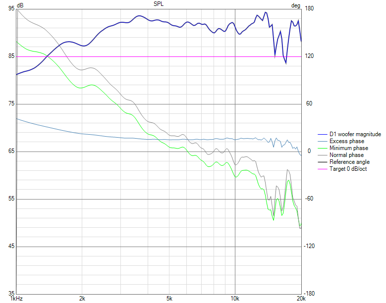

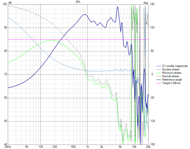

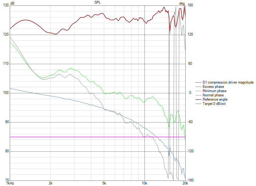

I have been following a discussion on the JMLC/Yuichi thread about horns and minimum phase response etc. I was curious about what more (if any) can be learnt from the frequency response magnitude and phase plots together (didn't want to pollute that thread so asking the question here). 🙂
Here is the on-axis response (frequency response magnitude, measured phase after removing delay and minimum phase generate by REW) of my BMS 4550 driver on ST260KVAR:
Here is the same data after equalizing the driver response to 'flat'ish using REW AutoEQ:
What all can we learn from these plots..?
looks to be about minimum phase. If there was some blip on the measured phase it would be some resonance I guess, or something. I really haven't bothered with the phase too much, mainly because it seems to be about minimumphase and haven't had problems that would have required to inspect the phase.

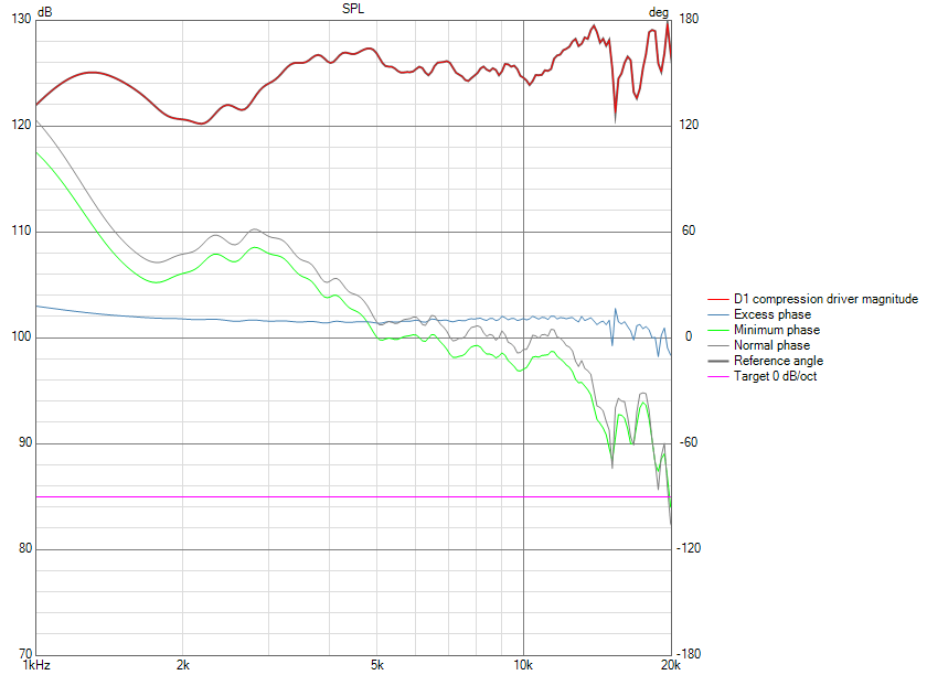

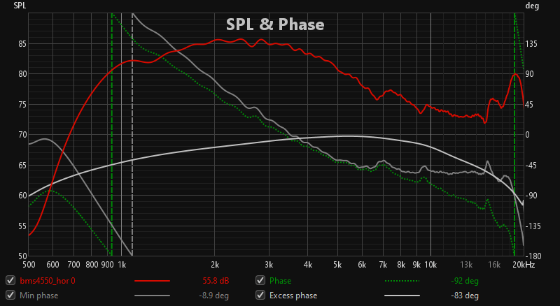

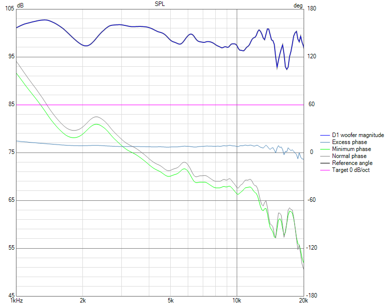

Here is some old measurement of mine, hf10ak in the sth100 waveguide on some baffle I think. VituixCAD shows measured phase as normal phase, then it automatically shows minimum phase and also excess phase which shows difference between the two I think.
Quite min phase as well
They deviate below pass band band, not sure why, perhaps due to windowing and some DC error or something in the measurements. This is from 4 years ago, about my first measurements ever.

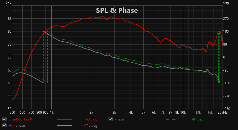

To get these normal and minimum phase draw closer on the top octave than yours I had to adjust the propagation delay with microsecond precision, millimeters. I get -180deg excess phase at 20kHz like you have if I tune the delay about 23us. 25us would be half wavelength of 20kHz, as time of course 🙂
So, the excess phase when roughly flat means all propagation delay is tuned out and now it shows how much measured phase deviates from minimum phase. My device has some resonance on the top, phase plug delays and dome breakup and stuff like that I assume.

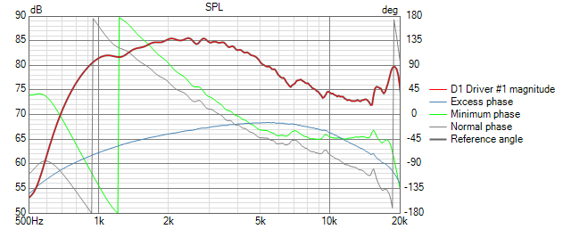

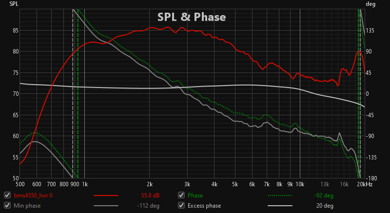

Just for reference, here is my VituixCAD plots for frequency magnitude and phase responses, along with minimum phase and excess phase.

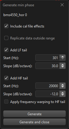

I just exported the REW measurement as a text file and saw some changes in the phase responses between REW and VituixCAD.
Here is the VituixCAD plot.
Here is the default plot in REW (without adding the LF and HF tails)

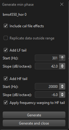

In the above, the REW excess phase looked different from VituixCAD excess phase. So did the phase responses near the extremes (close to 500Hz and close to 20kHz). So I tried with adding LF and HF tails to the minimum phase response construction with the following settings:

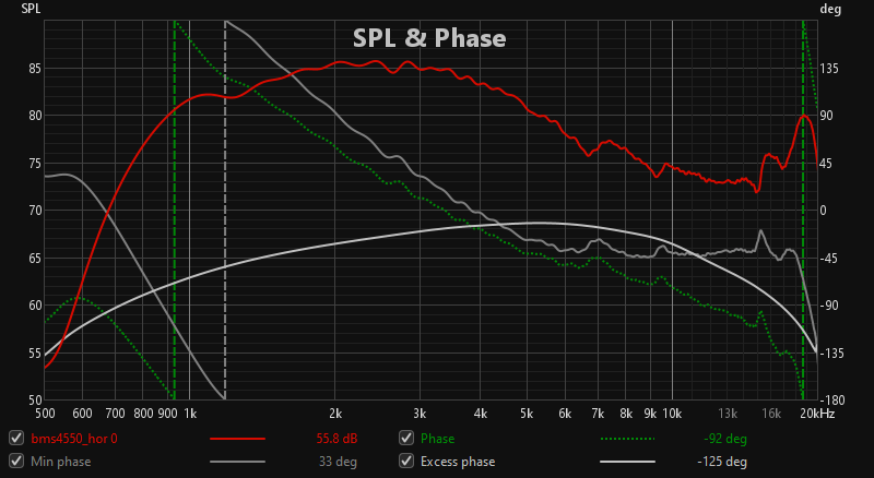

Now the responses looked like below in REW:
Now the excess phase response & minimum phase response look more similar between REW and VituixCAD. 😀
Unfortunately, I measured the CD+horn only from 300Hz to 22kHz or so (I was scared of damaging the compression driver trying to reproduce 20Hz kind of frequencies). So the real LF data is missing and probably VituixCAD will fill the unavailable data from 20Hz to 300Hz using some method and that causes the changes in phase response I think... 🙂
So can't trust the minimum phase version much I guess, especially at the extremes of the measurement range as it is program dependent about how it interpolates the missing data.
Maybe something along these lines is what Kimmosto has been saying for ages (He also advises to take measurements starting from 5Hz or so for all drivers I think).

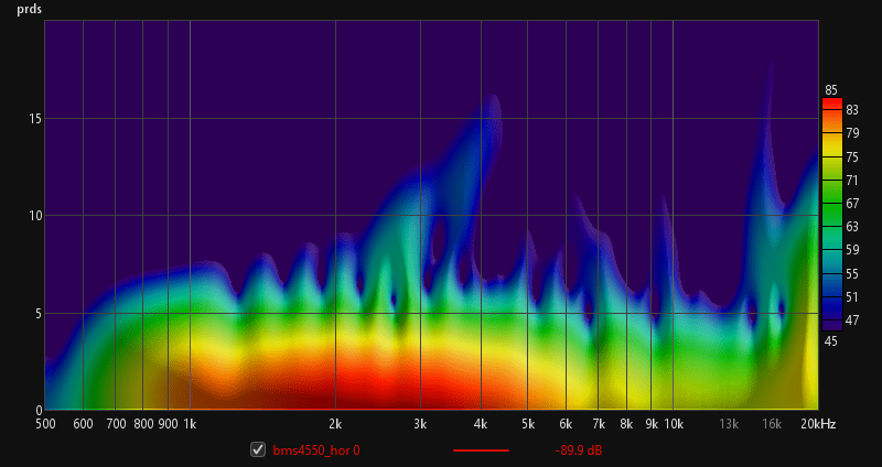

Here is an REW spectrogram (burst decay) of the same measurement
Whatever happens around 2-3k is not much visible from the frequency response I think. But the dips in frequency response around 6.5kHz & 9.3 kHz does show up in the spectrogram as well indicating some resonances (I think).
Then there is the entire question about the resolution of the spectrogram, as there is the uncertainity principle (similar to Heisenberg's uncertainity principle) that governs the time-frequency resolution. As and when we try to have more resolution in the frequency domain, we lose the resolution in the time domain since we have to integrate the signal over the entire duration of its existence as per the Fourier transform integral.
I still don't know what is an acceptable comprise between all of the factors above. 😀 (maybe, from a DIY point of view, a measurement with large enough gate duration is good enough?)
Please let us know your thoughts on what all need to be considered from temporal information point of view and if there is a better method for studying it.

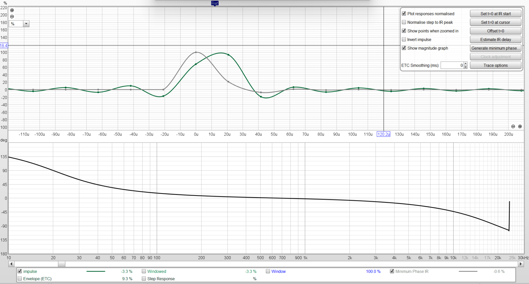

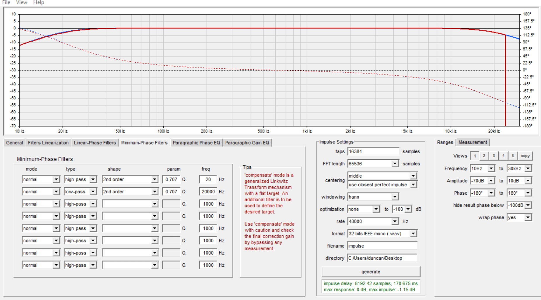

I am never really sure what to make of the differences in display between various programs other than differences in an assumption where the impulse should start.
Here is a screenshot from rephase of 2nd order filters at 20Hz and 20K. Analytically there should be 90 degree phase shift at 20K and -90 at 20Hz which is what rephase shows.
Import that impulse into REW and the phase is not the same. Generating a minimum phase response is also different. REW wants to put the peak of the IR at time zero. This corresponds with the generated minimum phase. Offsetting the time to get back to 90 and -90 at 20 and 20K puts time zero half way up the peak.

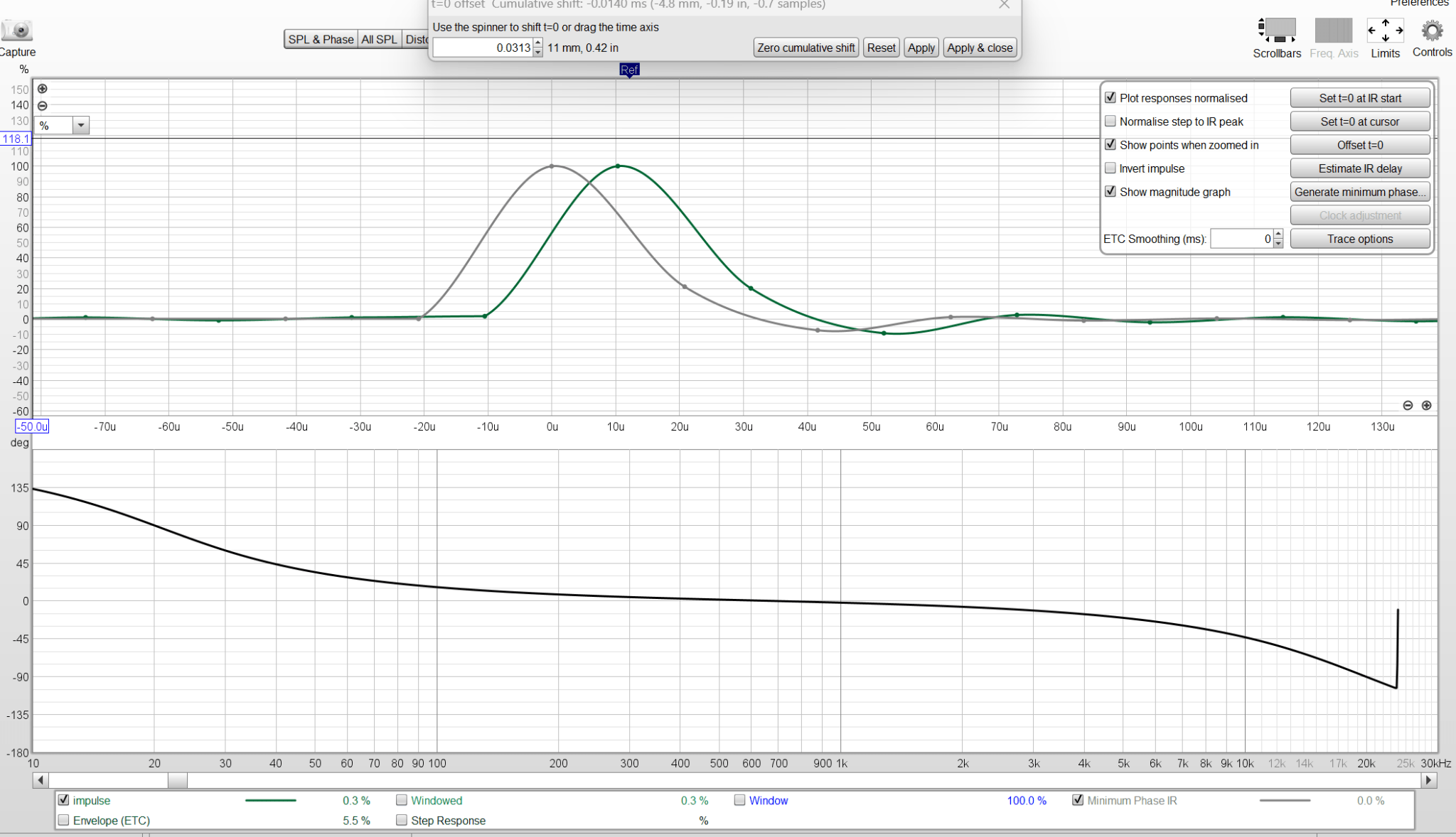

Applying that time then makes the impulse look very different but the phase is then as it is in rephase.

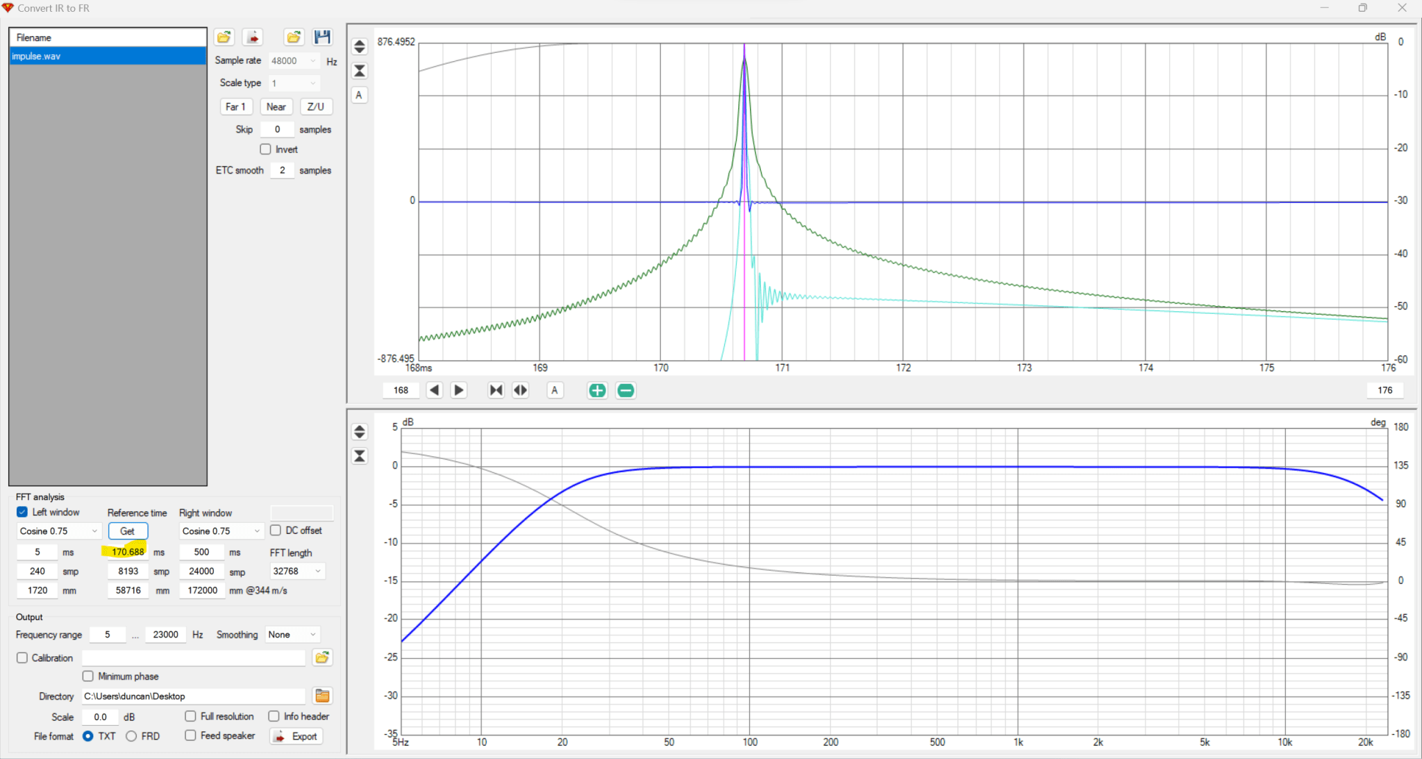

That depends on where the reference time is set. If I set it to 170.675ms the same as rephase the phase is -90 +90 at 20 and 20K, if I get the reference time which puts it at the impulse peak (170.688ms) then the upper phase goes flat. A difference of 0.013ms or less than 1/2 a sample. Images attached.Fluid if you take that impulsen into vituixcad, and do the IR2FR what is the result?
I have read the prosound article, very interesting. Note that in Arta you can show the dots of the impulse, by zooming in.
