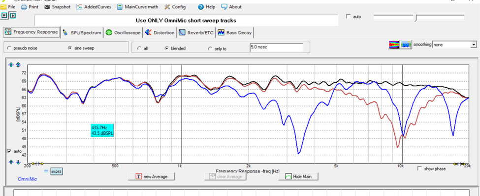

Do you see you have it set between 4 and 10K but your EQ is at 11?I couldn't find it making much difference in sibilance or anything else..

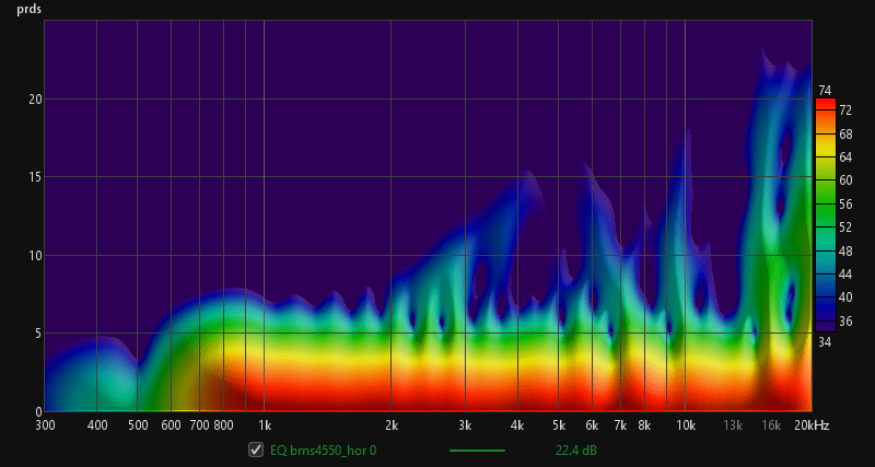

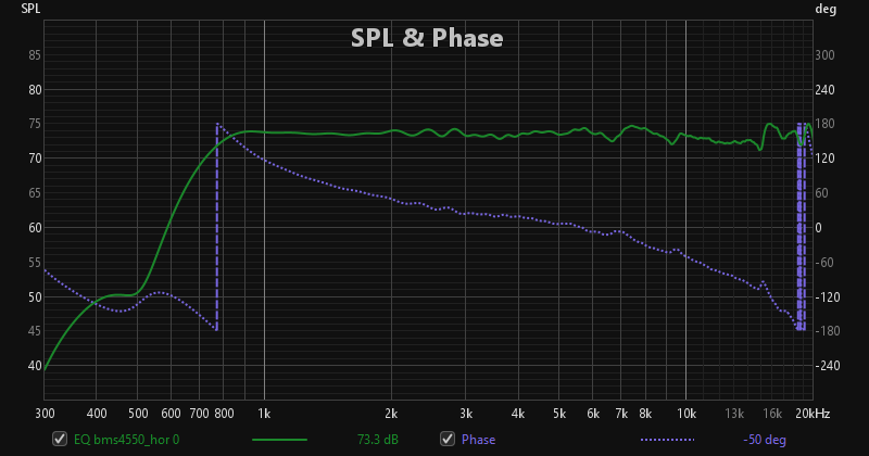

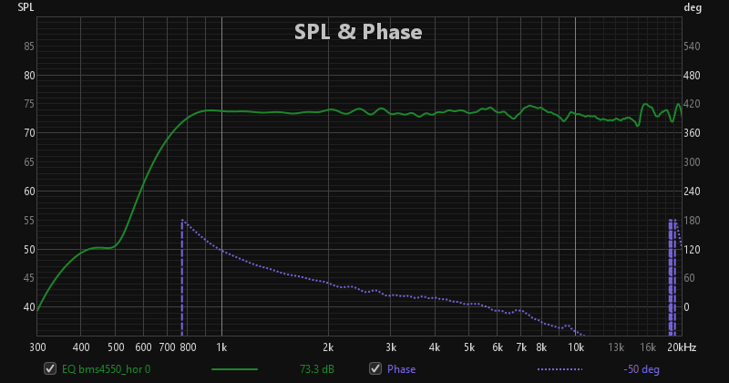

This time I equalized the driver's ON axis response flat using REW auto EQ and tried to see the plot.Because this includes the waveguide I would equalize it flat or close to flat and look again. The peak of the waveguide gain can distort the relative levels.
On axis response equalized flat from 800 Hz up (sort of)
Corresponding spectrogram
Some weirdness above 2kHz and 6-7kHz and above is now even more prominently visible.. 🤔
They all correspond perfectly with the little bumps as seen in the FR plot. That should indicate where they come from.
But I don't expect this to be at a level that is troublesome. Is this a close measurement?

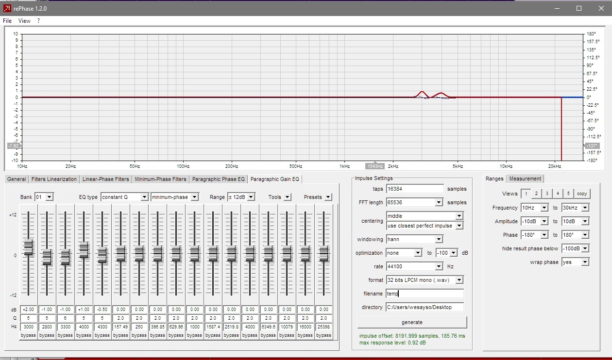

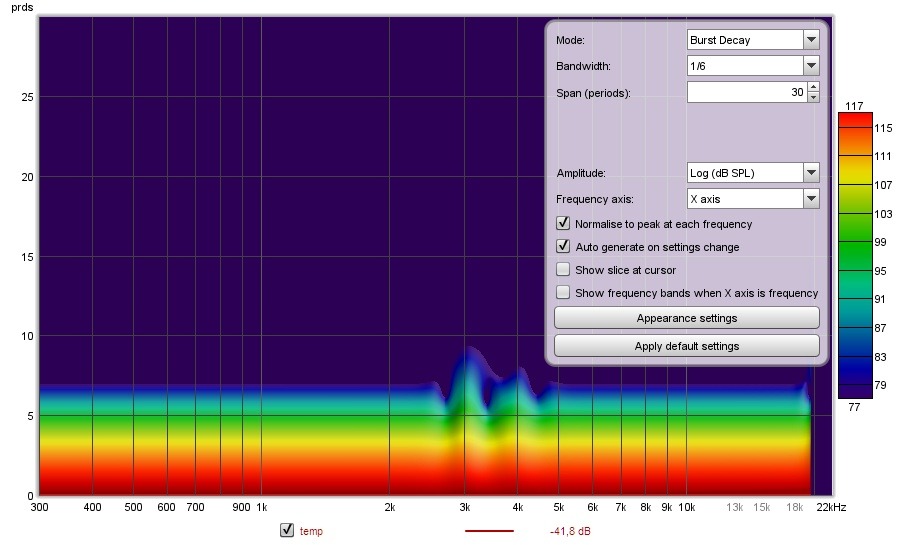

If I create even the slightest ripple in a straight FR curve:
It starts to show up in the Burst Decay view:
But seeing how small this ripple is, it is nothing compared to what a room does for perception at the listening spot...
(or the cross talk that our ears perceive for that matter!)
@wesayso: This measurement is a 4ms gated response of the compression driver attached to the ST260KVAR horn, measured at 1m away from the horn mouth.
Also there is not a lot of sibilance in anyway that is unbearable or anything... I was mostly curious even about the small amount of sibilance that I heard..
I probably need to hear more sibilant tracks like the ones Krivium posted above and then decide how much resources I need to spend on remobing this sibilance effect, if it is even possible. 🙂
The other thing is I didn't notice any such sibilance in my 3way speaker compared to the current 2 way. This is why I became the most curious 😀
But your explanations about cross talk and room effects tells me that it could be a potential reason.
I thought if it is something driver related and easy to get rid of, I should do that first.. 😀
Hence all this driver-related enquiries..

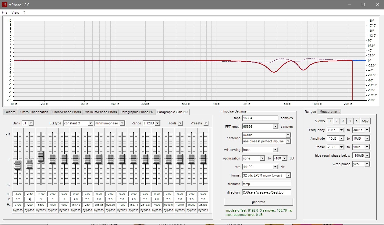

It could make sense due to having that horn on top, which will be quite different in how it reacts to a room than a dome tweeter would. Plus a dome tweeter could have varying diffraction problems that don't show up similarly in this neat horn-shape you have.
If you have a somewhat "standard" stereo setup, being speakers are about 3m from each other and between 2.5 to 3m towards listening position,
try a few simple EQ tweaks and see if you like it for the phantom center voices:
Create a PEQ of -3 dB at about 3.7 KHz, q is dependent on the equalizer, but it should span from 2.2 KHz to 5.5 KHz. If that works favourably for the center channel, do another PEQ at 7.2 KHz, -2.5 db cut spanning from 5.5 KHz to wherever that Q brings it on top. May need a small PEQ to make sure 5.5 KHz still is at the normal levels. Listen to that and focus on voices that are dead center. Do you like what you hear?
See this example:
Don't judge the side panned voices with these tweaks... this isn't anywhere near the total solution, just a quick check to see if you experience excess energy at typical crosstalk spots. The solution I use, uses linear phase EQ tweaks and is using corrections around 700 Hz as well and has way different settings for the sides.
Depending on exact speaker location and distance (as well as head size) these tweaks might have to move up or down in frequency. You can also vary the amount of the cuts. Don't feel bad if it doesn't do anything good, it is easy enough to try.

I tried @wesayso's EQ tweaks.. 🙂
Here are MLP measurements with and without the 2 different EQs (The EQ tweaks when applied together with the Room EQ is hard to distinguish in the plots below)
There is an L channel measurement, R channel measurement, L+R channel measurement, L+R measurement with the 3.3kHz dip as shown in wesayso's plot above and the L+R measurement with the 3.3kHz dip & 7.2kHz dips.
I tried to listen to a few songs, including the 'Everything but the girl-missing' song that @krivium linked in an above post.
Songs were played from Tidal and were lossless files.
I tried hard to hear if there is any change in the voices that appeared to come from the midpoint between the speakers. However, the differences would have been very minute... I hardly noticed any change. One thing I felt is playing lossless from Tidal is a good improvement w.r.t playing MP3s I have. Slightly less sibilance (even though there is not much sibilance to start with). Applying wesayso's EQ appeared to minutely increase the depth of the sound stage I think. 🤔
I honestly think that I could be imagining things at the moment since the differences appear to be very less. 😀
I kept on switching ON and switching OFF the EQ while playing the track. But only the above observations were what I could make out (if at all they are correct) 😀
