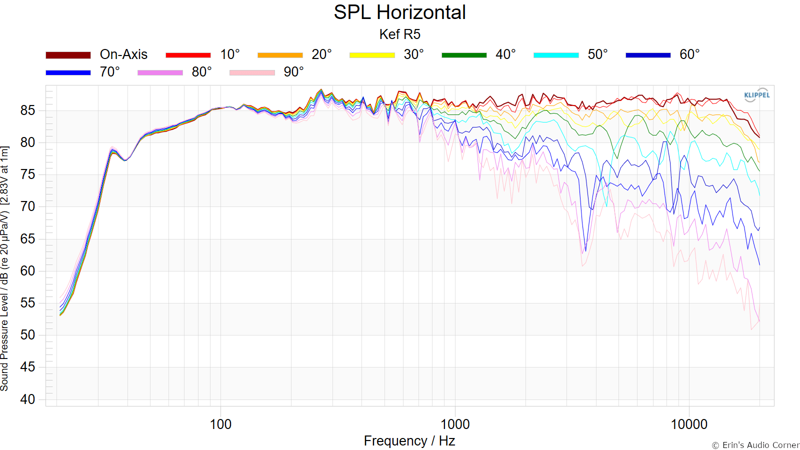

As in, can one have a coaxial with a flat and smooth on axis AND off axis. For both for the midrange AND the tweeter? Who makes one?

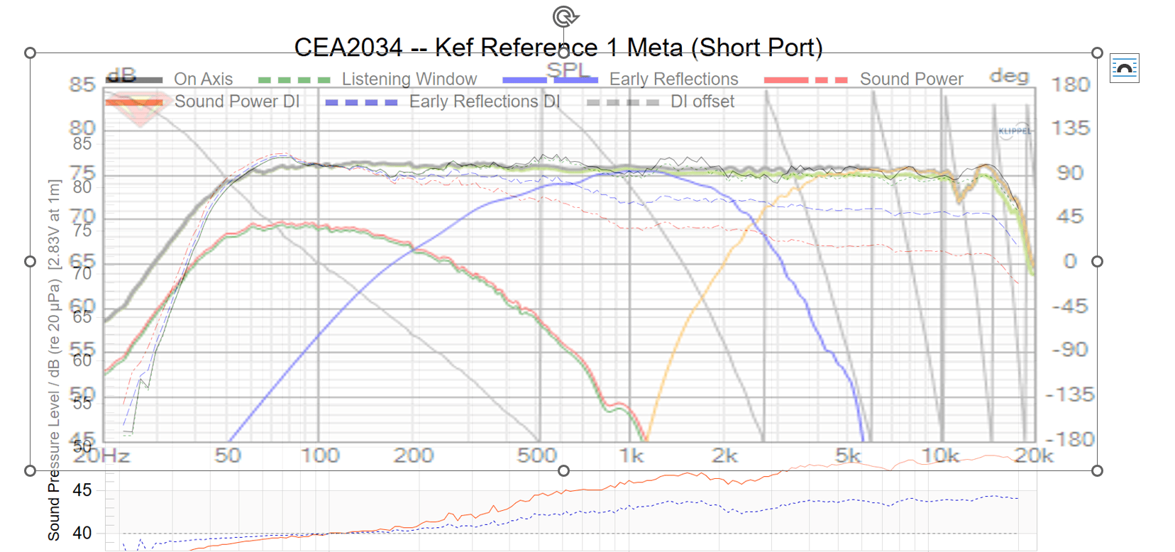

KEF and Genelec have succeeded, but those drivers are sold only as spare parts via service.
https://www.erinsaudiocorner.com/loudspeakers/kef_r5/
https://www.audiosciencereview.com/...s/genelec-8361a-review-powered-monitor.28039/
Don’t know how ‘successful’ this is though. If you take your eyes off of the top line I’d say this still has some issues & right in the most sensitive octaves too boot.

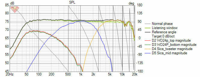

The Sica on a low diffraction baffle is reasonably well behaved but there is somewhat of a difference between the 0 deg axis and 10 degrees which I used as the reference axis. This is a gif of the difference between changing the reference axis between 0 and 10. No coaxial should be listened to with it pointed straight at you so the 0 degrees is the listening axis. When listened to 10 to 15 degrees off axis (like you get when pointing the speakers straight ahead instead of straight at you) the on axis that you hear is then generally quite flat as you can see in my crossovers.
The listening window is how the speaker should be optimized in almost all cases not the zero degree response as it contains the worst of all diffractions. On axis and 0 degrees are not always the same thing. I think this is one of those times where the words of Floyd Toole are being twisted to mean something different than intended. Smooth flat on axis does not have to mean 0 degree axis.
Kef's Reference 1 Meta is really good as coaxial's go, apart from the 12K dip in the Sica I think Vineeth's stacks up pretty well in comparison, I suspect the Kef would look better if the reference axis was 10 degrees too. I think the Sica design has been made to allow for more excursion in the woofer making it more like the LS50 driver. Kef and Genelec's top coaxials are designed to be low excursion mid tweeter drivers only.

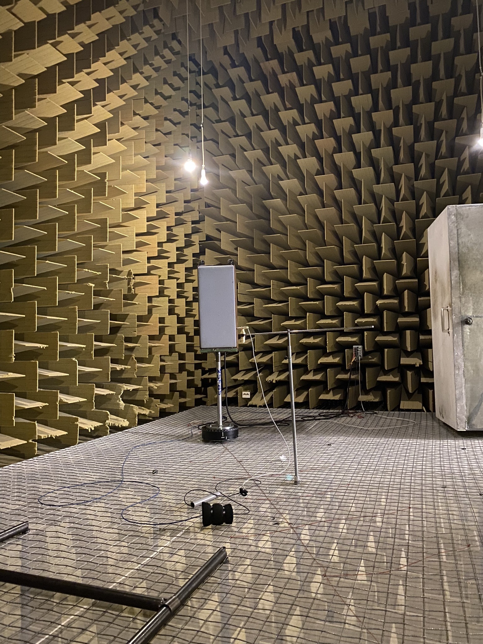

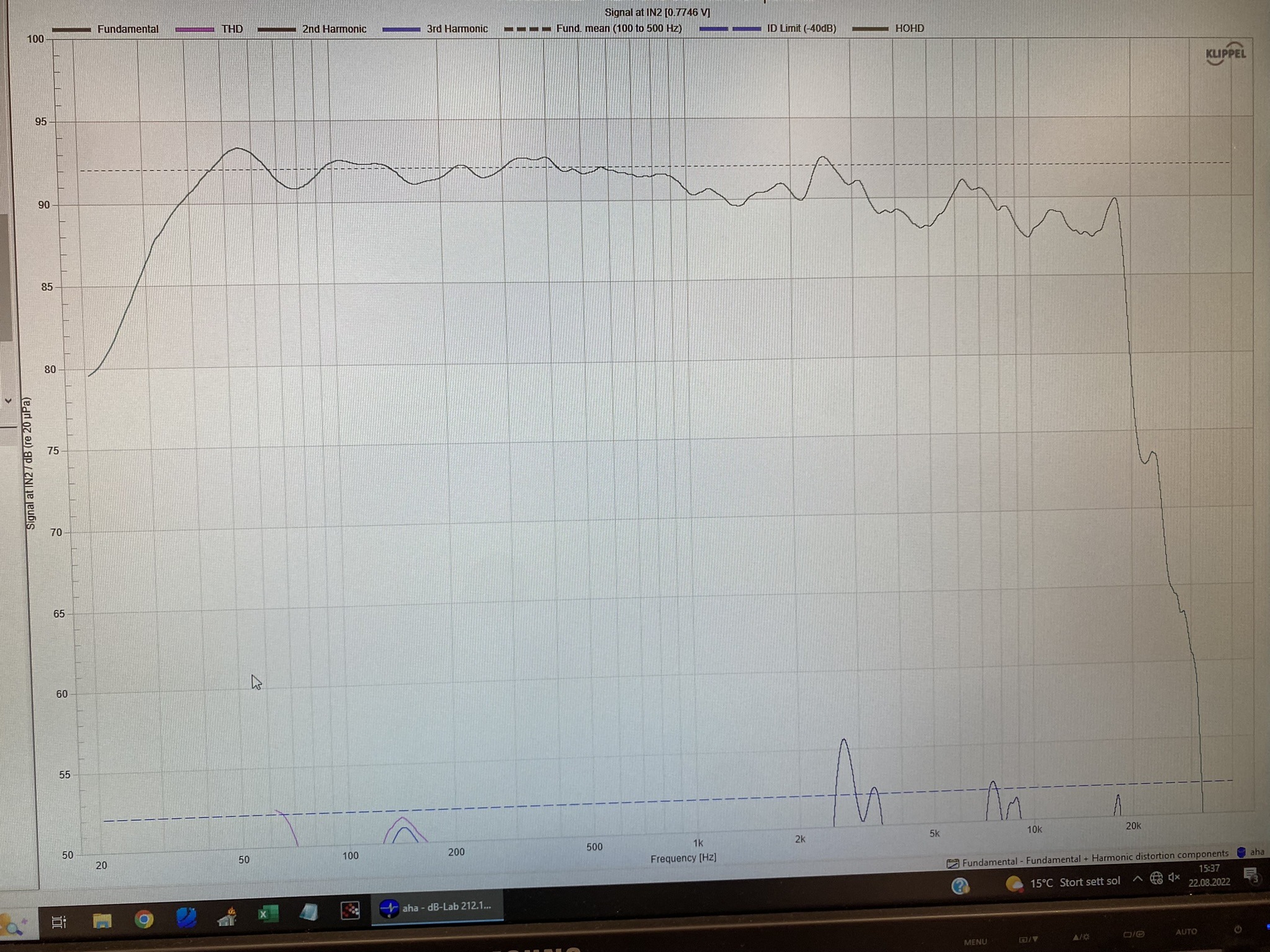

Last pic shows early development Klippel FQ at (20 degrees of course😉

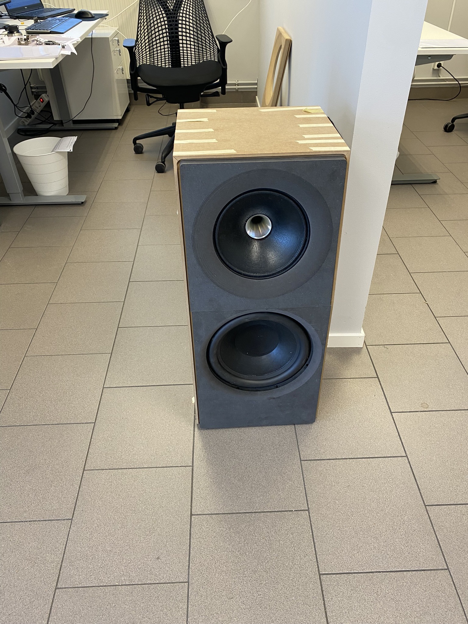

BMS 10C262 passive cardoid / 12N630 in aperiodic cab.
Nice! 10"?
Lucky you to have access to an anechoic chamber! Where it is located ( if not confidential)?
There’s a giveaway in the pic…Nice! 10"?
Nice setup w B&K mikes, full Klippel w turntable and distortion modules etc (not NFS).
Wow i didn't spoted the clue at first!
You work there?! Now i'm jealous! 😉
I was going to ask about the peaks, the other 10c362 measurements i've seen didn't had them.
