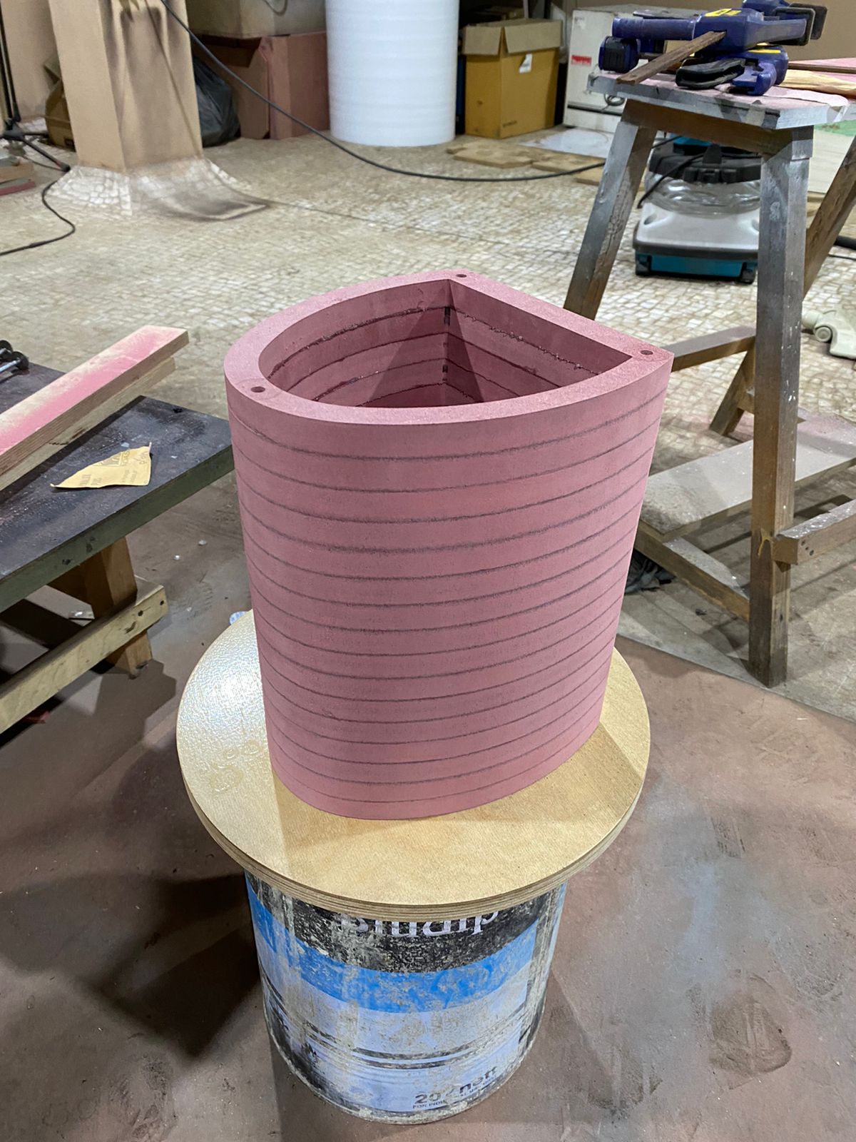

A 3 way design study

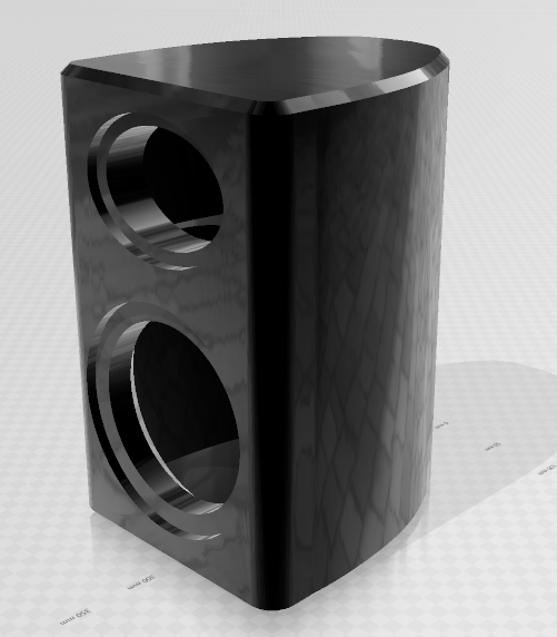

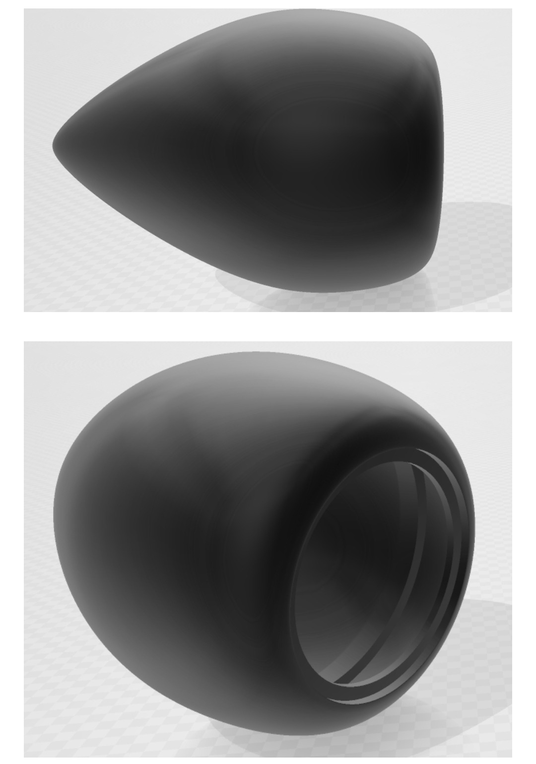

So i designed a new enclosure for the coaxial drivers 😀
Using spline and rotate tools in fusion360, i created a teardropish shape as below. Depth of enclosure = 27cm, Maximum diameter = 22cm
The area where the driver is mounted follows the slant of the driver frame. The frame slants down by about 4 degrees.

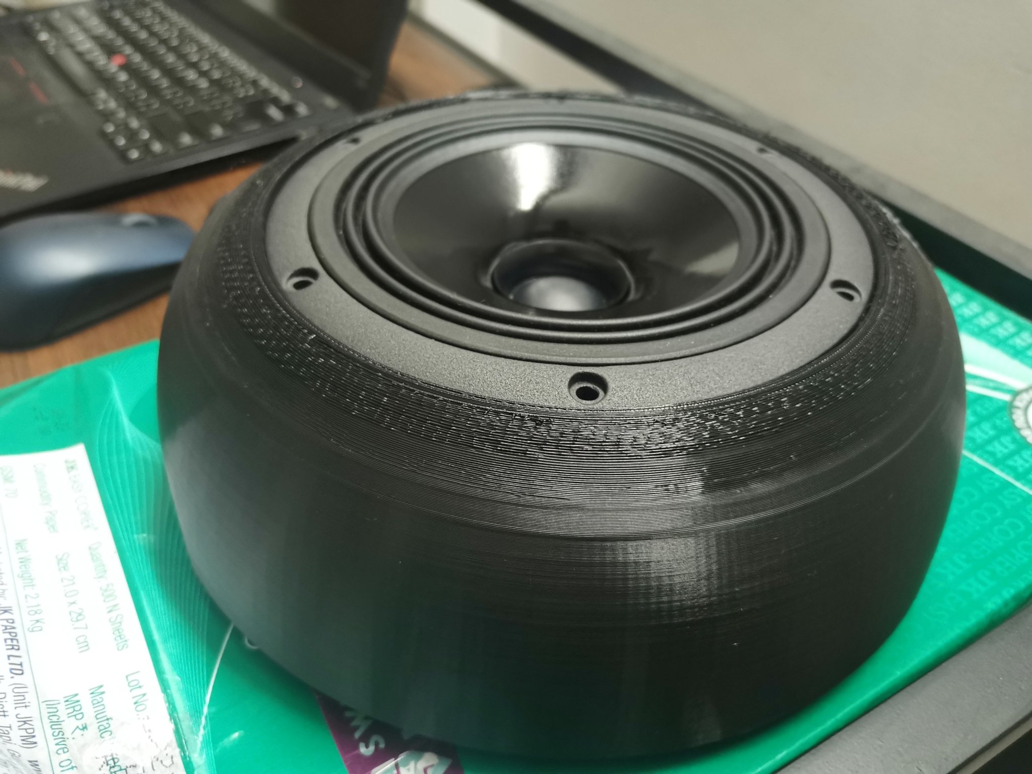

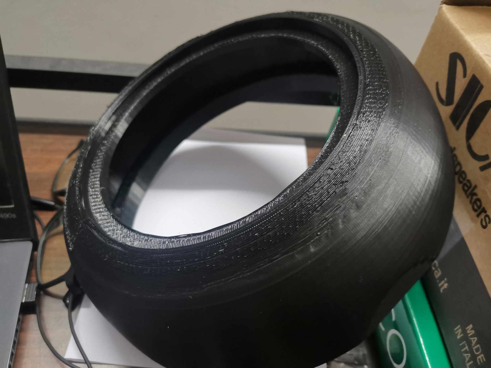

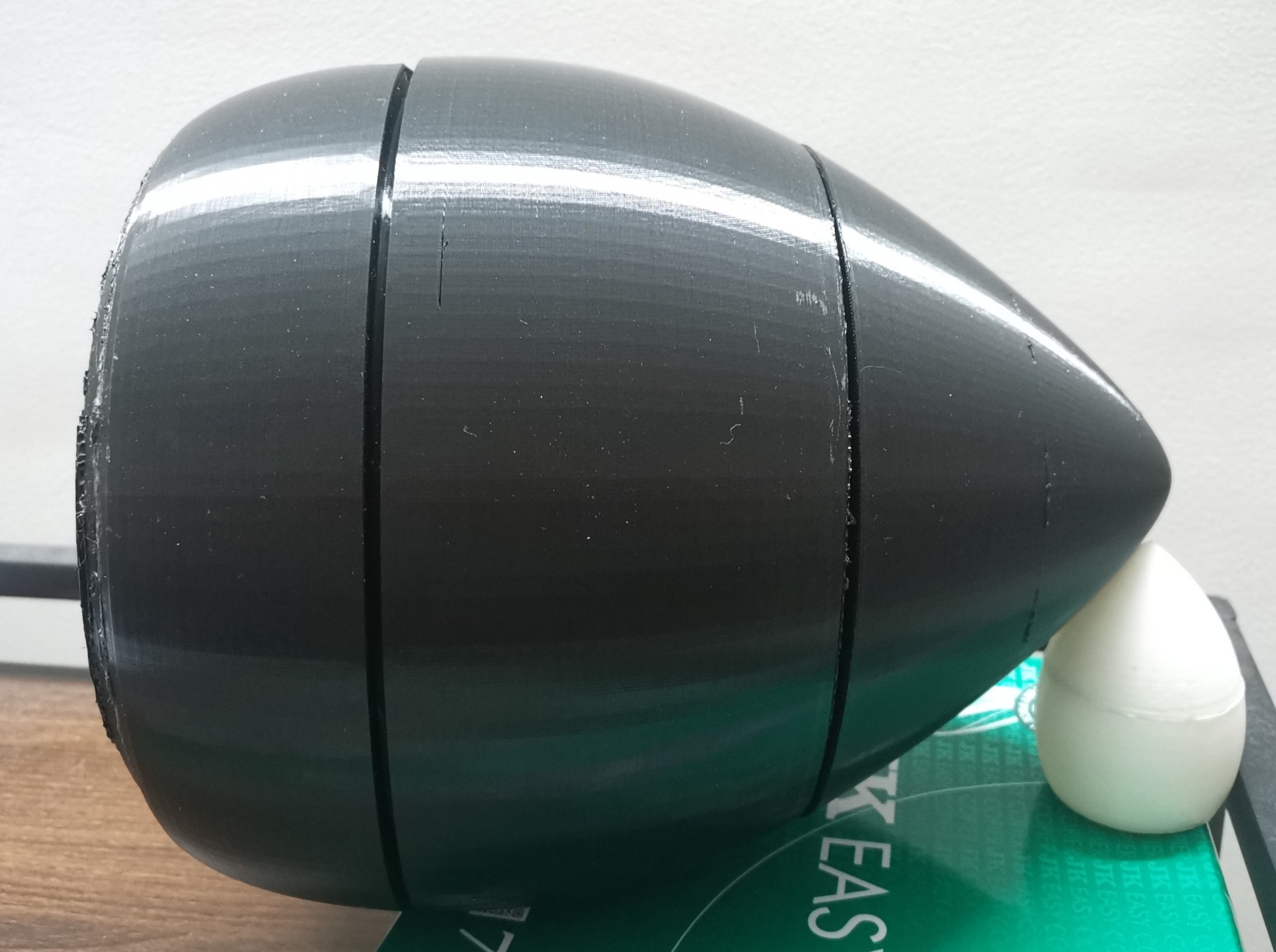

Next I tried to 3D print a prototype in 3 parts. Overall enclosure is formed by 3 threaded sections.. The first part is printed
Here is the driver mounted in above part 😀
Right now, it is missing a gasket to be applied between the driver frame and enclosure. Hence that current 2mm looking recess of the driver when it is mounted..
I forgot to create the screw fixing holes in the enclosure before printing though.. 😀
Anyway.. onto printing the next part..

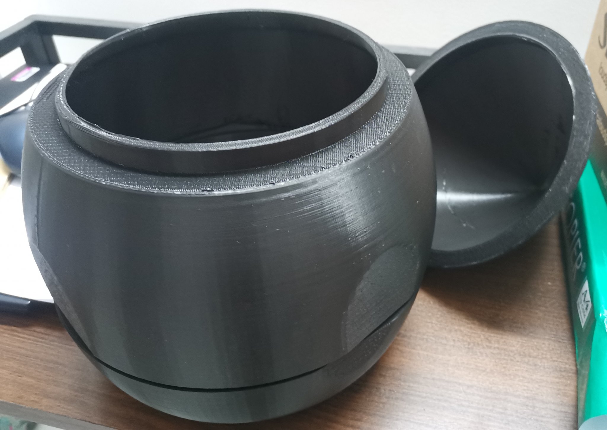

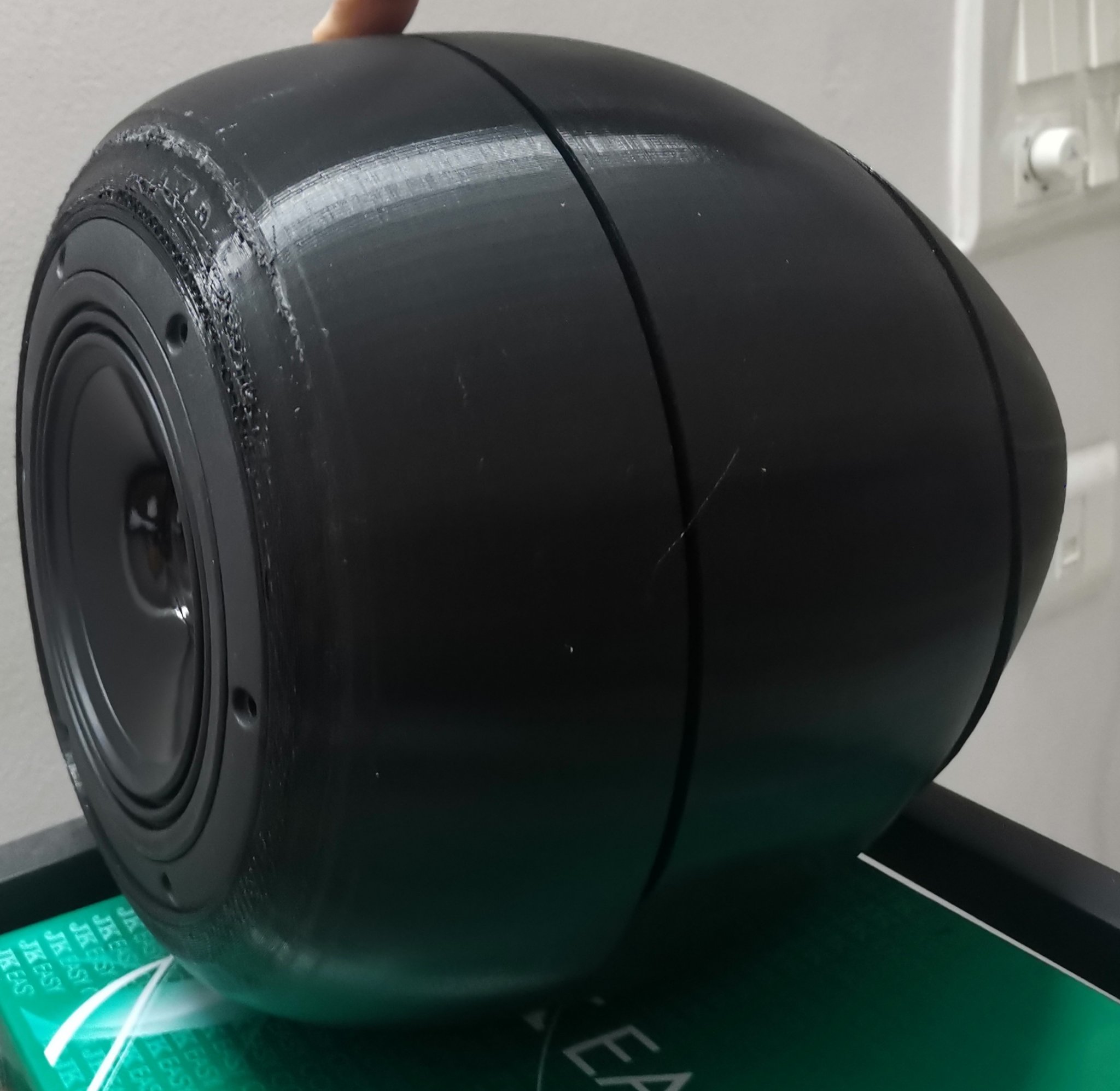

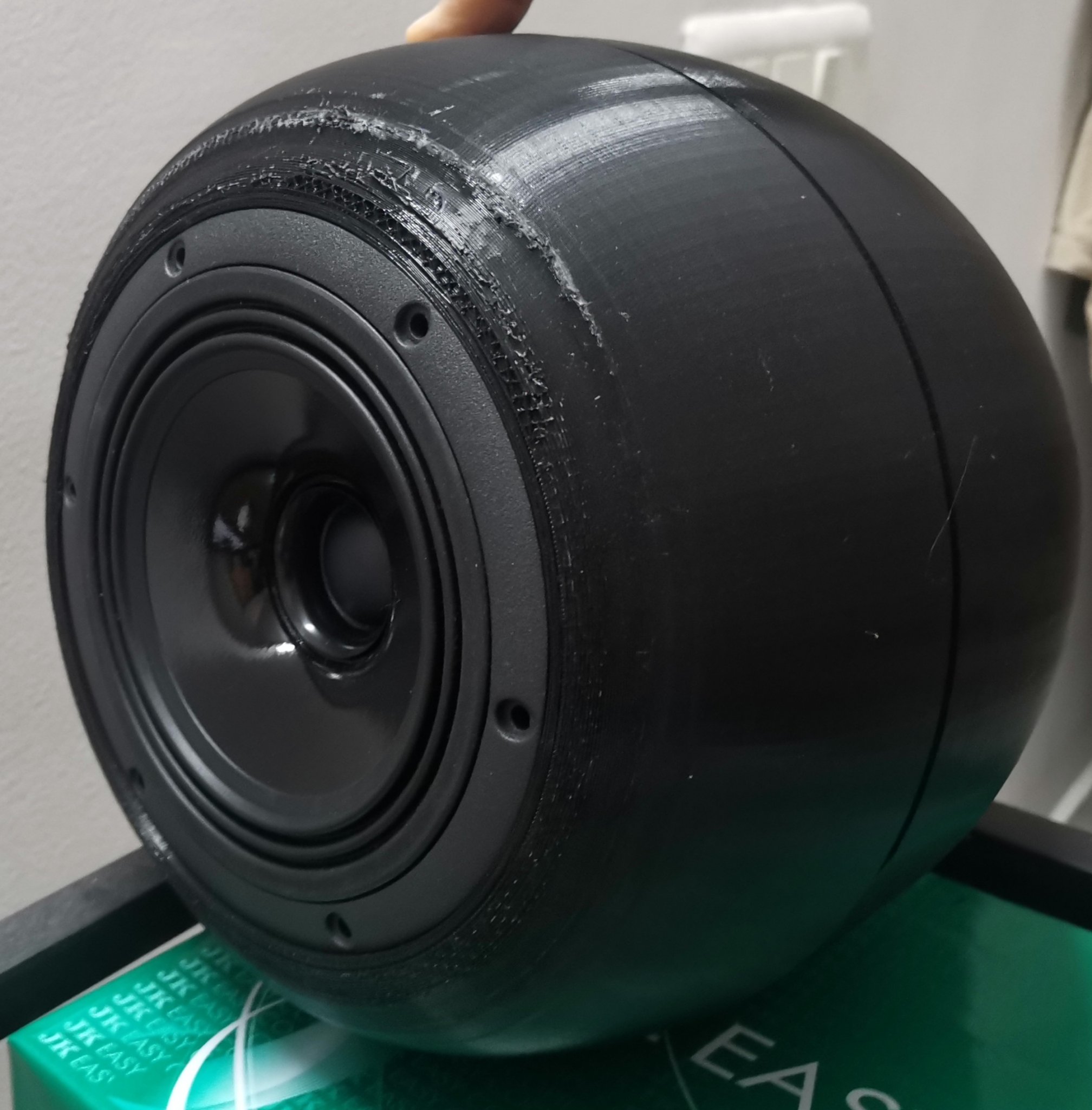

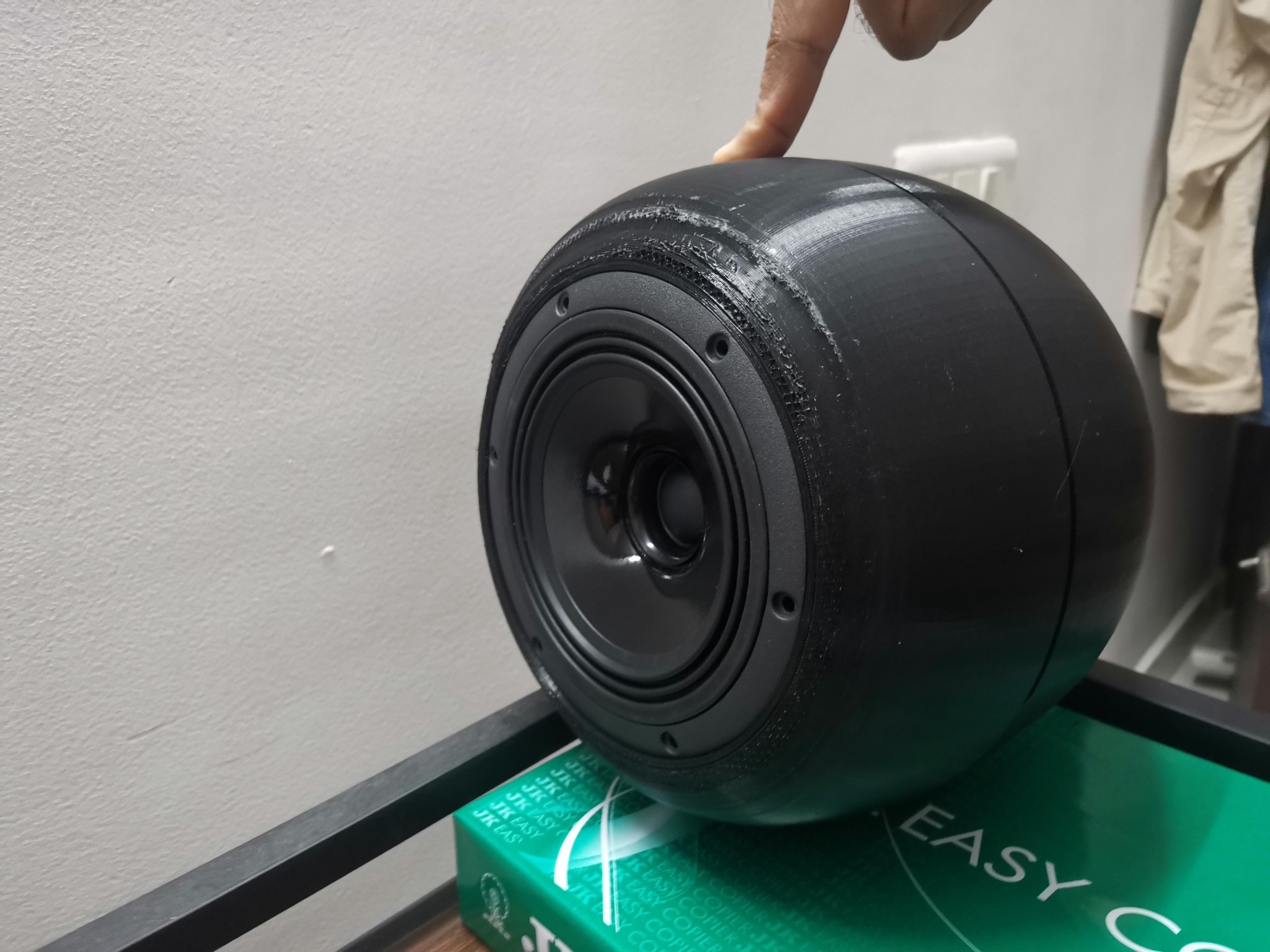

So I printed out the prototype enclosure for the coaxial driver 😀
Here it is:
Those gaps between sections is a combination of little bit of warping in the individual prints and me being an idiot an tearing out part of the threading in one of the pieces thinking it is support. 😀
Anyway, it all seems to fit together really well except for those small gaps. Since this is just a prototype, I am thinking of filling it up/covering it up with some of adhesive tape after all the other works are done.
Next I am thinking of doing a little bit of sanding in places it is needed, cover the insides with aluminium butyl sheets and put some melamine foam at the back and inside the enclosure a little away from the drivers. I also need to carefully drill holes for driver attachment and at the moment, i dont know how the plastic is going to take it, but i will try.. will also add a 2-3mm thick rubber gasket between driver and enclosure.. 😀
Here it is:
how much does something like this cost In materials I'd love to be able to make something like this its very cool
Reactions: vineethkumar01
Material costs involved in printing this enclosure is very low.. 🙂 I printed this using PLA+ filament on my Creality Ender 5 pro 3D printer. The filament cost for 2 x 1kg filaments is Rs 2000/- in india.. equivalent to approx 25 US dollars. This is more than enough to print 2 such enclosures

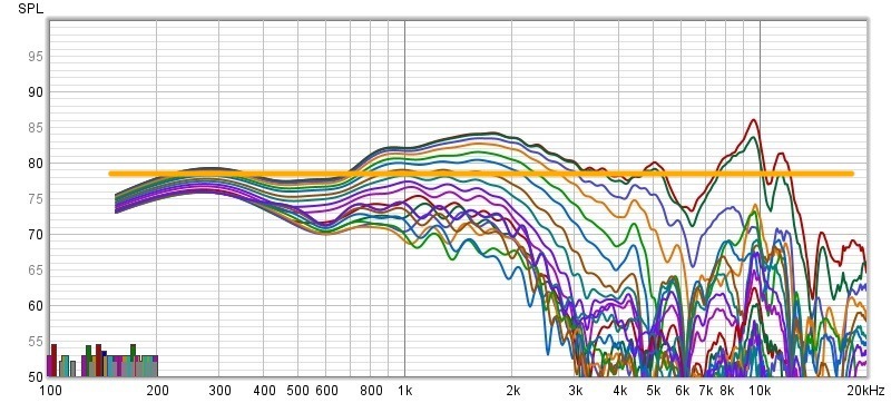

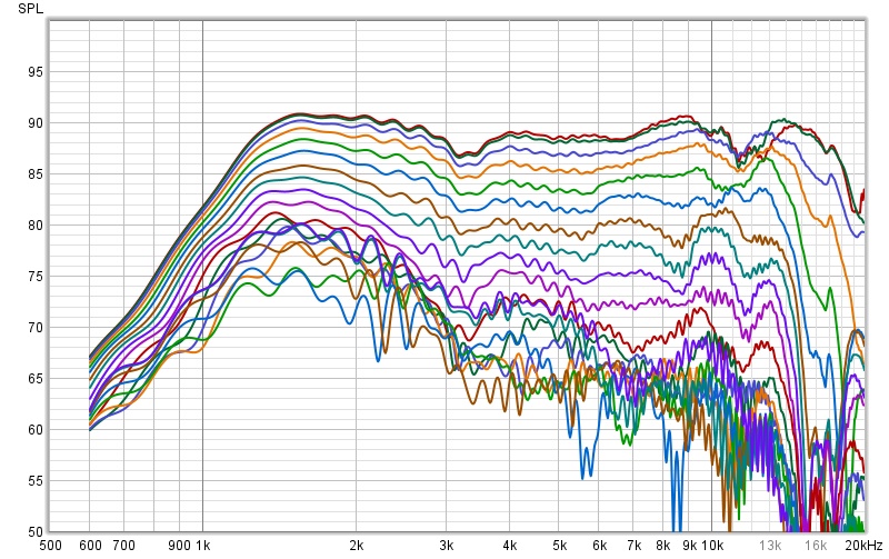

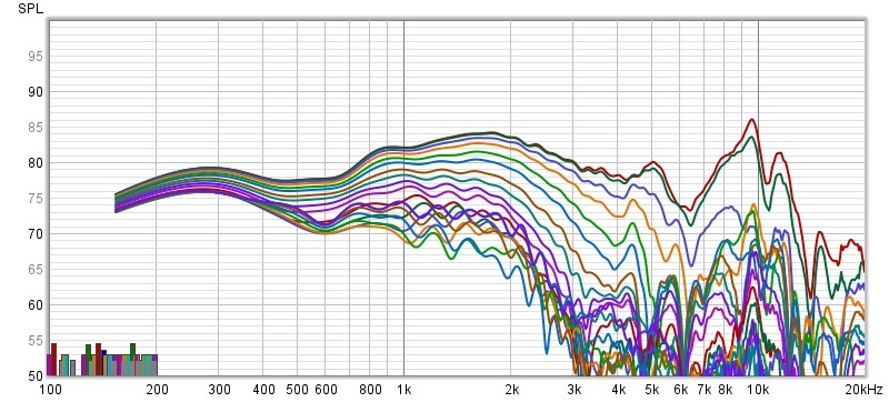

Orb under measurements 😀
All measurements are gated at 4.5ms
Woofer polar upto 180 degrees
Tweeter polars upto 180 degrees

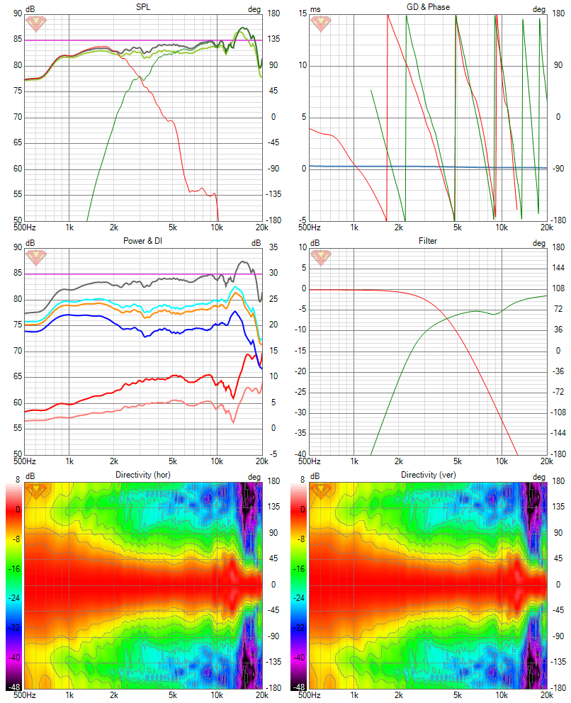

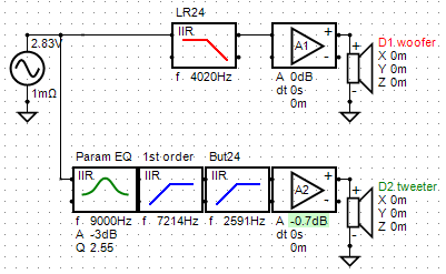

Driver response in VituixCAD with basic filters
Drivers and crossover making in VituixCAD
I really need some help with this crossover on this one. I dont know hoe the sound balancing should be done here..
I will post the VituixCad project here tomorrow. 😀

Consider baffle step compensation.
There’s are 3 ways to do approximate this-
Take a outdoor ground plane measurement at @2m
OR:
Or use TS parameters to model the in-box anechoic response in Enclosure, then subtract the diffraction response using Diffraction
OR:
Eyeball it and add a shelf filter

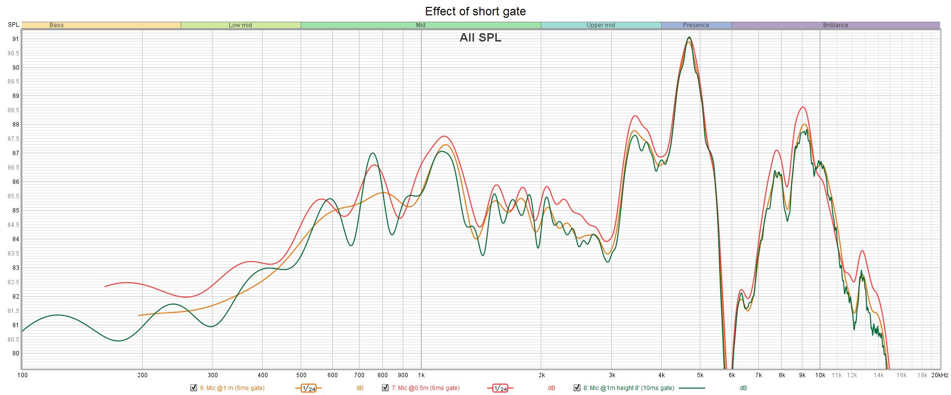

With a 4.5ms gate your frequency resolution is about 222Hz, which between there’s a lot of smoothing going on under 1KHz.
Here's an example of effects of using gate lengths of 5ms, 6ms and 10ms, on measured low end response:

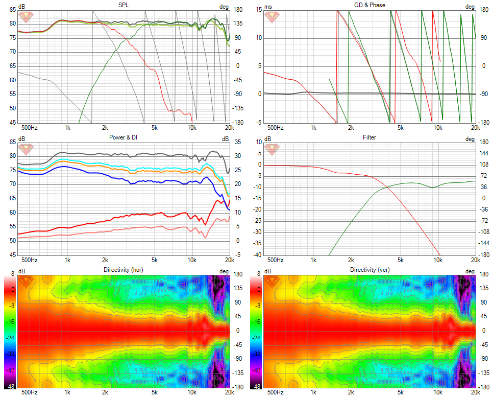

My best effort so far for the mid-tweeter crossover
Crossover
I don't know what to do with that hump in the 10kHz - 20kHz region.
Also, I don't know what is the power response target I should be aiming for with these drivers.

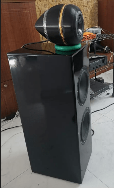

Ultimately, I want to use the Satori woofer box in a configuration like this (please don't mind that green rubber ring or the cellophane tape at the joints 😀 ).
I am trying to resolve issues with archiving VituixCAD project and upload a copy here including all drivers next
