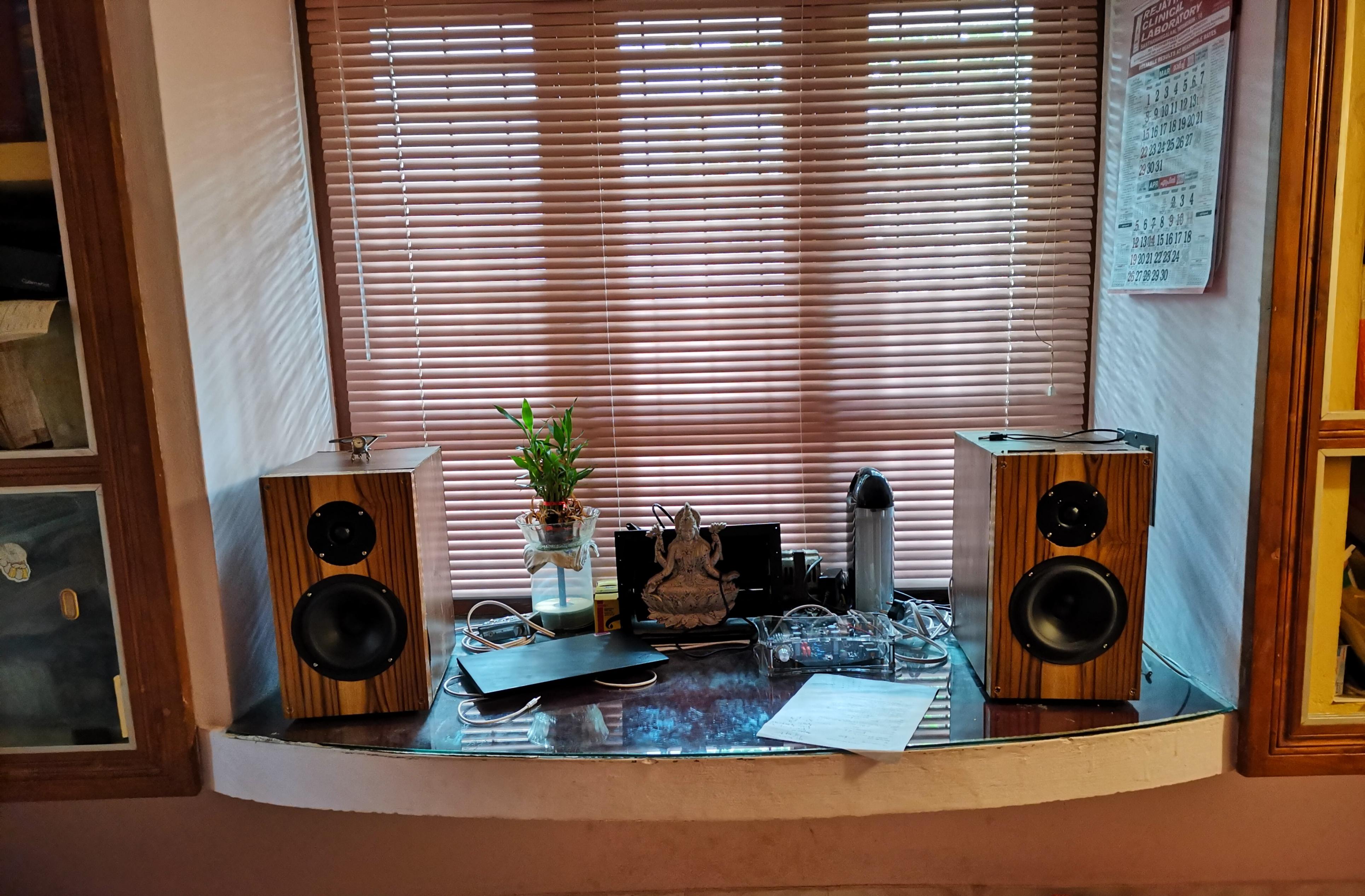

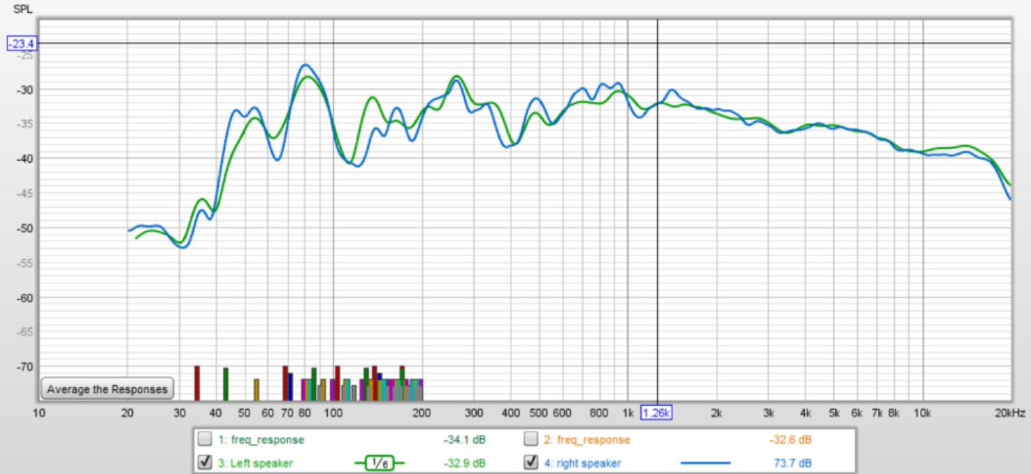

I just dug up some in-room measurements I had taken quite some time back for a pair of DIY 2 way speakers I made ('tributes' speakers designed by Jeff Bagby).
Here the placement of the speakers had been in kind of like the worst possible location imaginable for speaker placement (due to reflections from walls etc) as shown in pic-1. But my in-room measurement (for both left and right speakers) at listening position about 1m away midway between the speakers in a reasonably small room (1/6th octave smoothed) looks similar to the graphs posted in previous posts.. 😀
Hence just sharing here..
