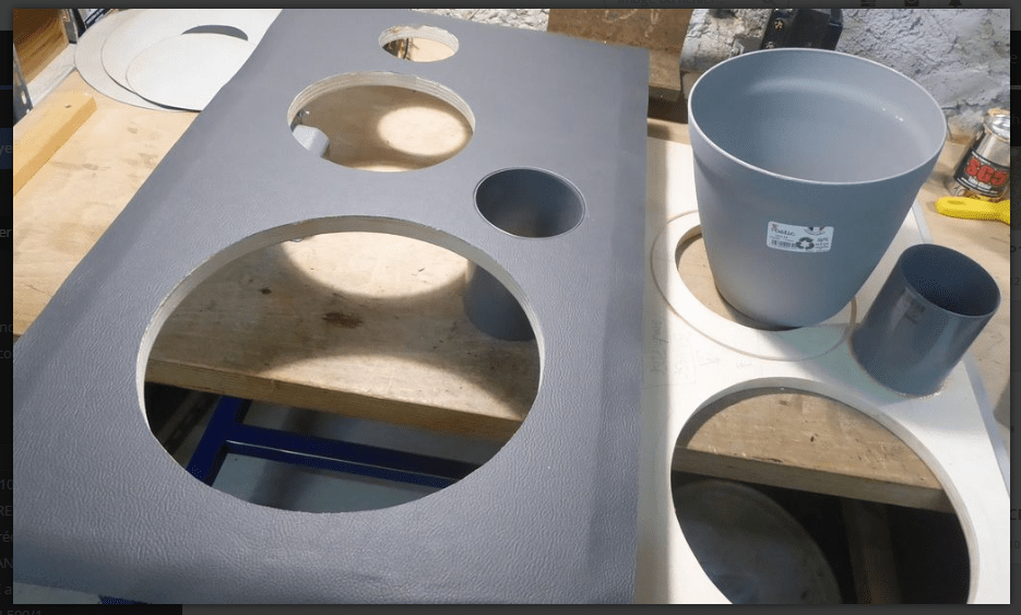

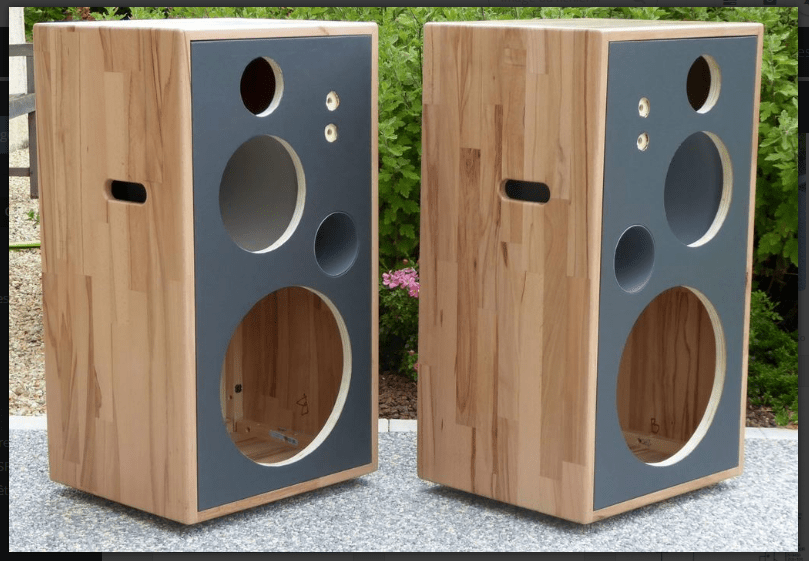

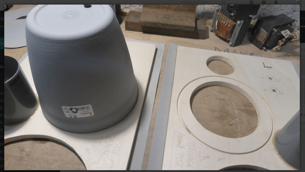

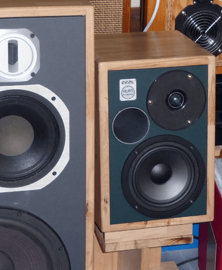

Personally, I use simili for the fronts and backs, belt being in Beechwood Glulam :
T
Nice! I like that look. Is it very difficult to apply?
No : easy - assuming you have the tools and the skills, of course. 😉
I use a harmless neoprene water-solvented glue, with a 45mn time of pre-drying / working
Work flat on a table, with a very even layer of glue put with a soft nylon brush (just like if you were painting an horizontal surface)

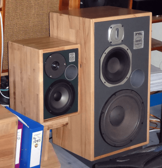

The little 2-Ways is English Green, the large 3-Ways is Dark Grey :
T
Reactions: 6L6, Bryguy and stv

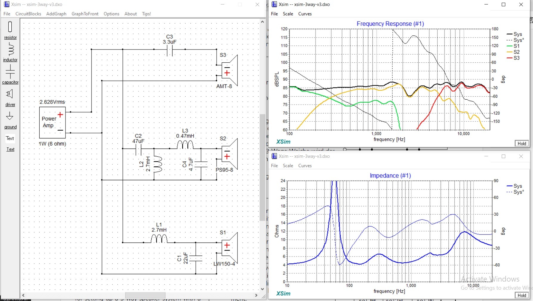

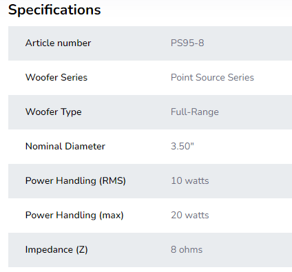

hello everyone,

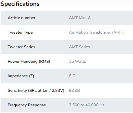

I am definitely a newb, so i want to share my design and ask for some advice ( any) before i start the build. have a vision for a stereo 3-way bookshelf. I need your help determining if the specs of these components are a good fit, espeasely in the electrical sens, can they all operate together?
The easiest way to find out is simulate it in XSIM. There are lots of simulators, this one is free and easy for XO work, and can it import the ZMA and FRD files provided by Dayton. It does not have modelling for room, baffle step, CC spacing, diffraction, or directivity but it will do axial freq response.
This took <5min to find out. The P95 has a nasty dip at 2.2Khz, the midrange filter has no HF cutoff so it's active along with the tweeter at HF. There is a bass sag due to sensitivity differences. Not good, but maybe fixable. The XSIM files and driver files are zipped.
  • xsim-3way-v1.zip
    xsim-3way-v1.zip

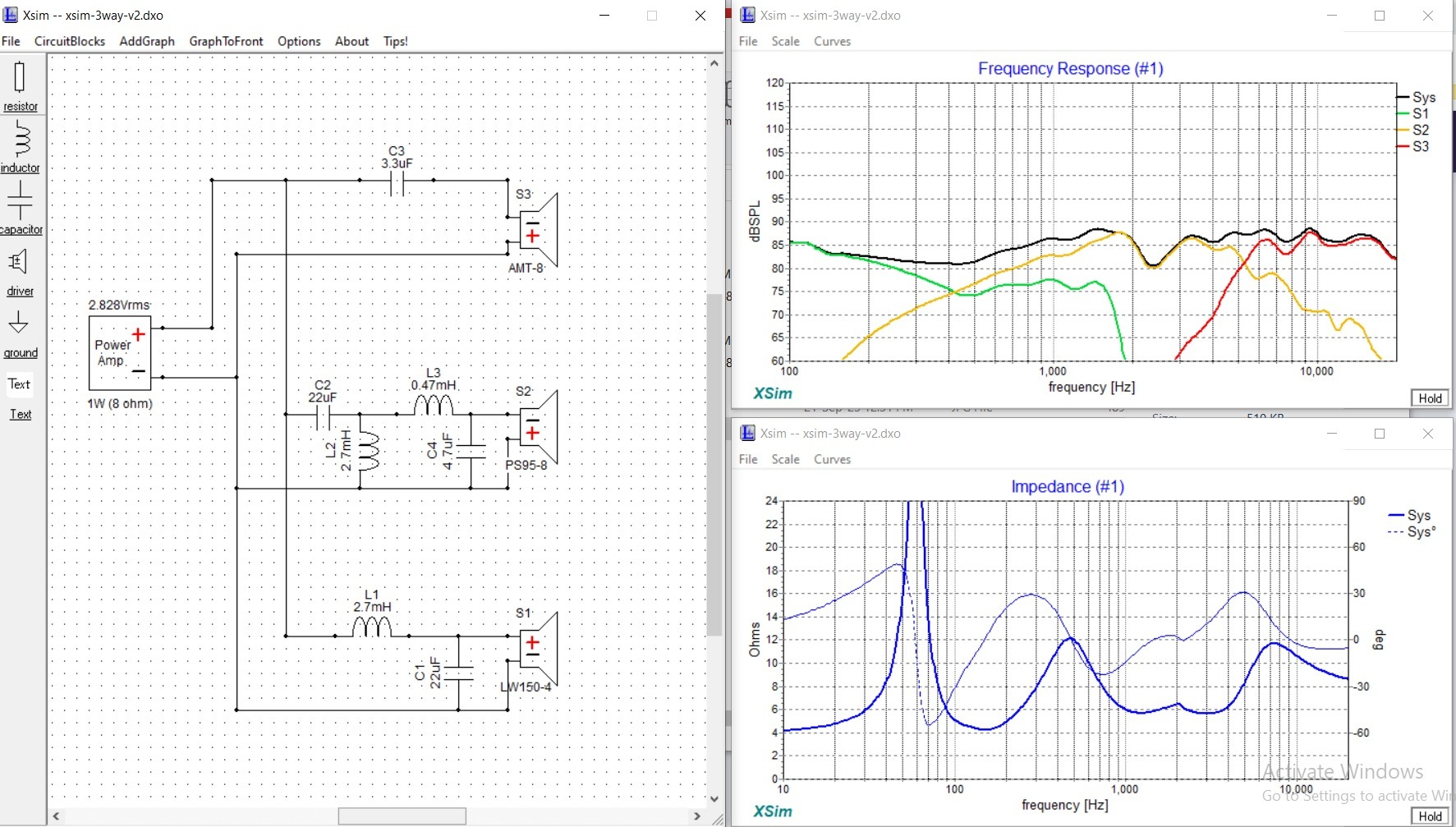

V2 : Fixing the midrange upper cutoff. Replace the resistor (R1=4R7) with an inductor (L3) and solder a cap (C4) from the inductor to gnd. It may be possible to boost the LF by placing the speaker against a wall or corner.
  • Xsim-3way-v2.zip
    Xsim-3way-v2.zip
