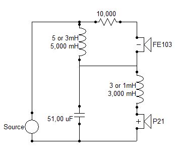

I think the crossover point is 500Hz. The R value of 10ohms is the good value. But I think you could have better result if you add an inductor on the woofer, second order. Not too complicated to test 😉
The couple 5,3mH gives 500Hz and the couple 3,1mH is 700Hz. I suppose 3mH is the second inductor from the Dayton CI board.

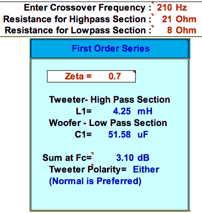

So what you're saying the Fostex is being crossed over around 500Hz via the 5.3mH inductor, but what about the 51uF cap on the Vifa? Isn't that crossing the Vifa over around 390Hz? Or does the inductor and cap work together and even out the XO point?

Sorry my writing is a little confused. I wanted to write 5mH/3mH instead 5,3mH The couple 3mH/1mH rise the crossover frequency to 700Hz.
The basic circuit 5.1mH in series with 51uF crosses at 500Hz. Add the inductor (2.7mH) don't change the crossover frequency, but improve the phase response.
I can say that because I have measurements of loudspeakers closed to the P21 and the FE103.
The inductor and the capacitor work together. It's a series crossover.

So put the other iron-core inductor inline with the Vifa like I did the resistor on the Fostex? Just to the positive terminal of the woofer?
Yes !

Anyway, I added the inductors to the woofers with great success. The overall sound is fuller and more natural, and with even more dimension than before. I find it very fascinating and satisfying that these speakers are sounding this good with such a hodge-podge of crossover components, but it works great!
