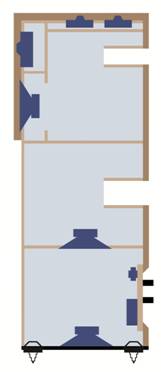

Well after going through the thread again, I think I'll go with about a 4mH inductor (air-core) on the Fostex which should get me in the neighborhood of 600Hz, and then get a 3mH for the woofer to complete the 2nd order part on the woofer.
BTW, those suggestions were from one of Jerome's posts...
This morning I decided on a pair of Erse 3mH 18awg air core inductors for a slightly higher 700Hz crossover point and ordered them from Parts Express. These will be going on the Fostex FE103E's.
I figure that if these speakers sound this good with unknown value, cheap iron core inductors, having good quality air core inductors of a known and correct value will only make things better.
As for the inductors on the Vifa woofers, I'll probably go with the equivalent iron core Erse inductors at 3mH. Their DCR of 0.178Ω is better than the air core version at 0.93Ω.
Of course, if anyone has any suggestions as to which ones I should go with on the woofers, please feel free to speak up.

And I have just finished installing the new 3mH inductors for the Fostex drivers, which from what I gather should be getting me around the 700Hz XO point in conjunction with the 51uF cap. At this point, nothing is soldered, just twisted together (and a couple alligator clips) so I can swap out parts if need be a lot easier. Once everything is totally finalized, then I'll make proper XO boards, soldered and using terminal strips.
Also, as I ran out of large enough nylon wire ties, I'm using gobs of duct seal to hold all the components in place, which possibly helps isolate them from vibrations. The iron core inductors tucked over in the corners by themselves have been sitting there in the duct seal for a few weeks now without issue.
As usual, a few pics...

Well it's been a little over a week and I am rather happy with the sound I'm getting from these speakers.
The new 3mH inductors have improved the speakers in a couple areas. For one, they have shifted the XO point slightly up to where I believe it helps fill out the midrange and give vocals a bit more body and connectivity. This is what I was aiming for and it seems to have worked.
The other thing that these inductors did was improve the impact and depth of the bass. The bass is stronger, snappier, deeper and more dynamic than before. They had great control before, but now they really have a tight grip on things and seem to have no problems at all on reaching down to the lowest octaves. And this part is hard to explain, because the natural thing to say would be that there's "more bass" for the given power. I think saying that the bass is "more vibrant" is a better description of what I'm hearing.
I'm still playing around with the ambiance tweeters. I have removed the 3.3 ohm resistors and have nothing but the two 3uF caps inline with them for the overall 1.5uF rating (roughly 13kHz XO point). I'm also still playing with their positioning.
