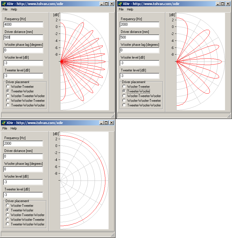

With a 4th order Linkwitz-Riley crossover two drivers are overlapping over about 2 octaves. With a 2nd order they overlap over 4 octaves.
Here's a simulation in xDir of a vertical polar pattern between a mid and tweeter. On the top graphs they are spaced .5 meter apart and crossed over at 2kHz and 4kHz.
The bottom graph shows the sound originating from the same point in space(coaxial).
The cancellation is insignificant. At most, there will be a slight dip in response but there will be so many other problems in the vehicle's transfer function that any cancellation will be irrelevant. The software that you're using may be relevant for home speakers but the auto environment is far more complex.
Improving the system would depends on your talent as an installer. It is the positioning of the seating amoungst other, that make sound quality difficult. Leave speakers where they are. Replace tweeter with highest quality ur willing to pay, modd x-over to tweeter to lowest & safest point, modd mid accordingly. Stero presence should improve.
