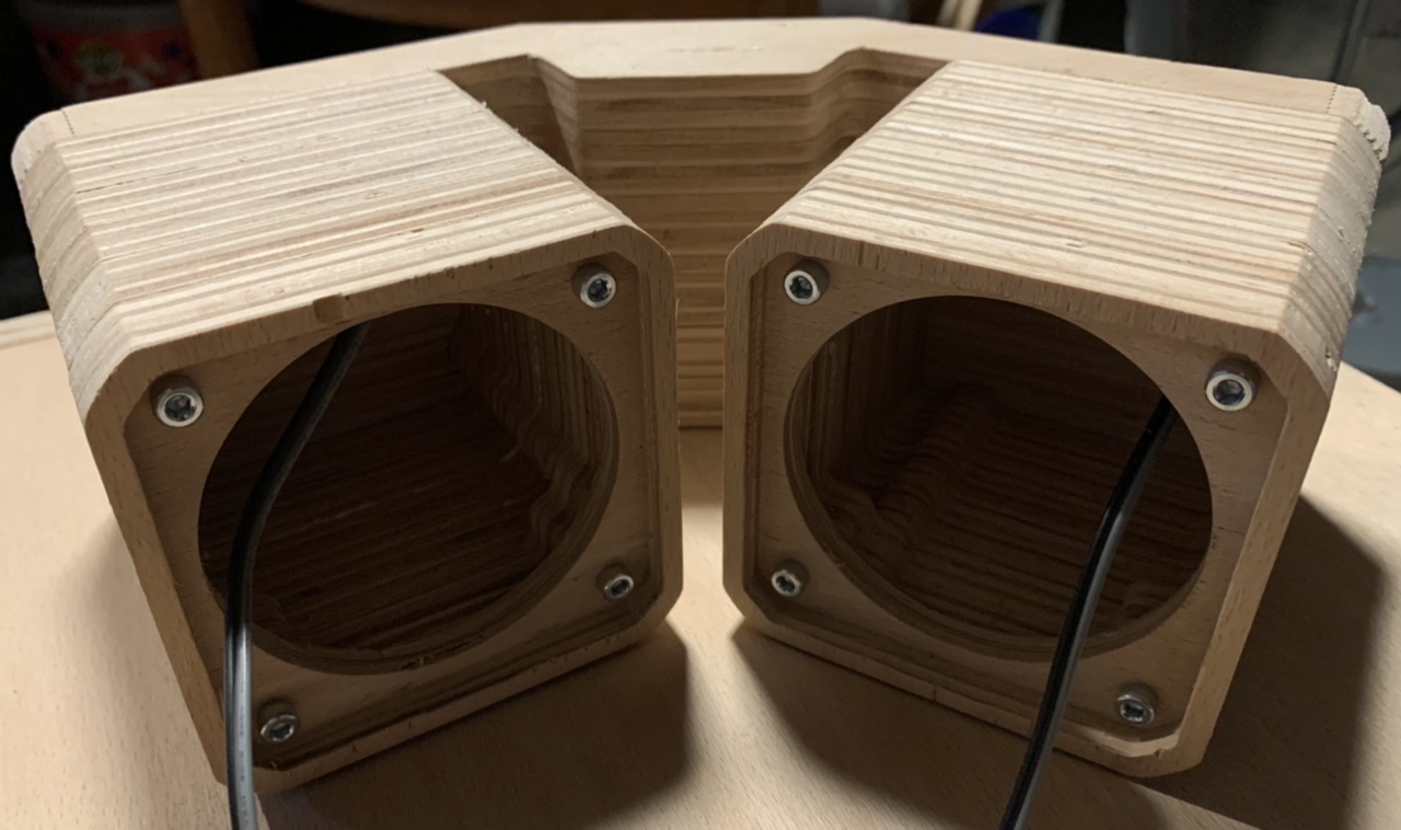

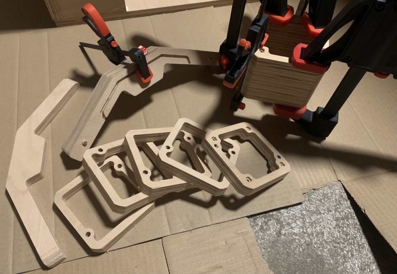

I have the CNC program ready and I also found a suitable piece of plywood. Tomorrow, I will machine all the parts.

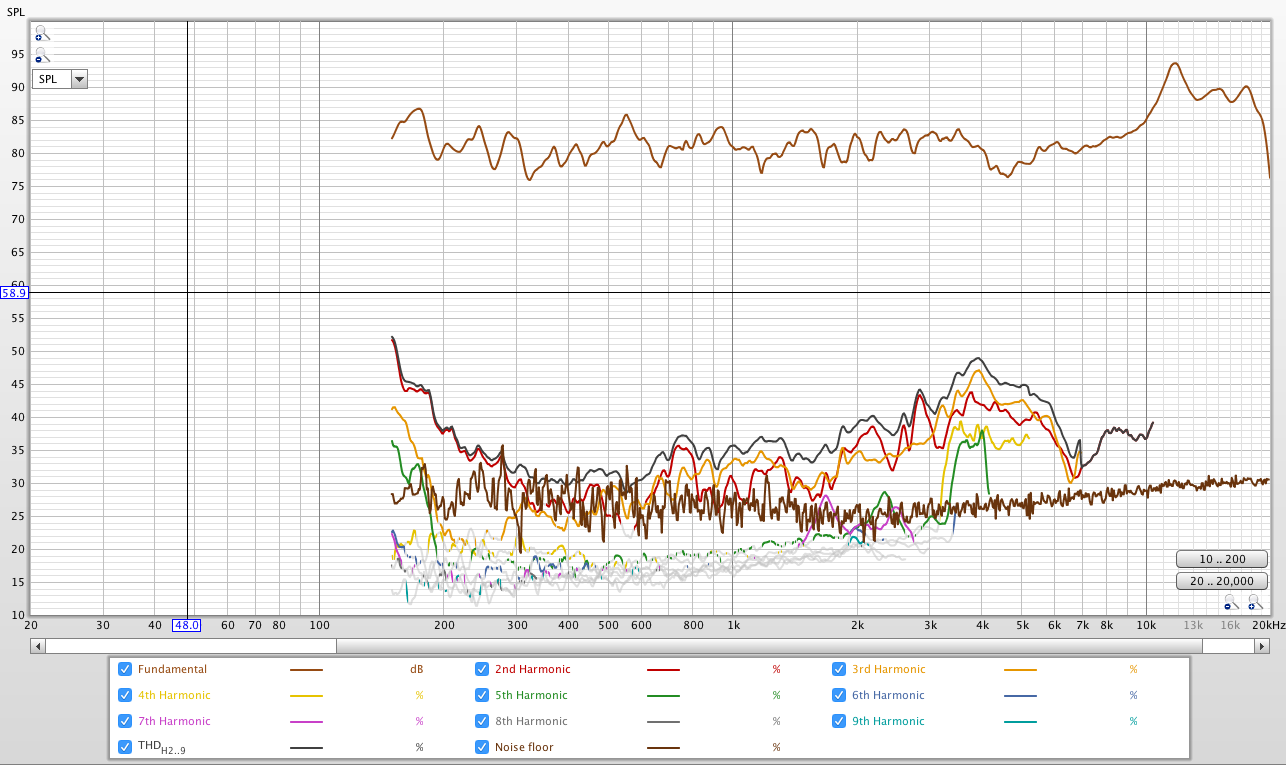

I have had the SB10 since they came out with it.
It's nice and well-behaved enough if not pushed too hard.
But it has a strong distortion peak at 4kHz, and would probably be annoying if it is pushed a bit.

I missed this thread somehow. Thanks for the measurement. That’s too mediocre for my purposes.

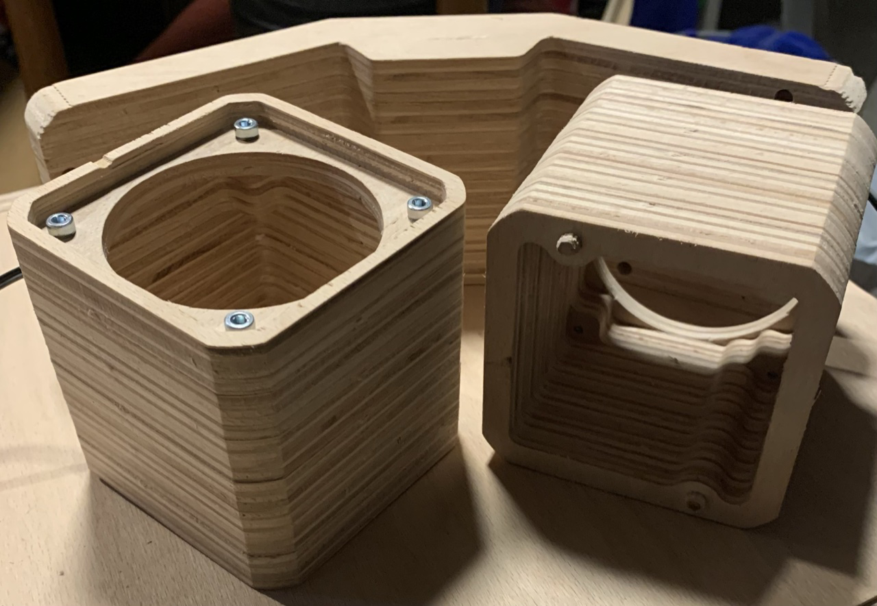

Some more progress🙂 The only problem is, that the 15 mm plywood is really more something like 14.8 mm. I can really understand, why they say these are handmade, there will be a lot of sanding🙂 I must say that the layered plywood construction looks really good and feels very solid. I learned a few things in the process through making mistakes.
This little project could be made on a small 3018 CNC. The intended use will be in a two way system with a mono Karlson bass box. And maybe over time, two dedicated midbass units using the same construction will be built, maybe with a built in 1st order crossover. A 6" - 8" driver with matching sensitivity would be used.
I still do not know which connector to use, an enclosed 6.3 mm jack would be one option.
